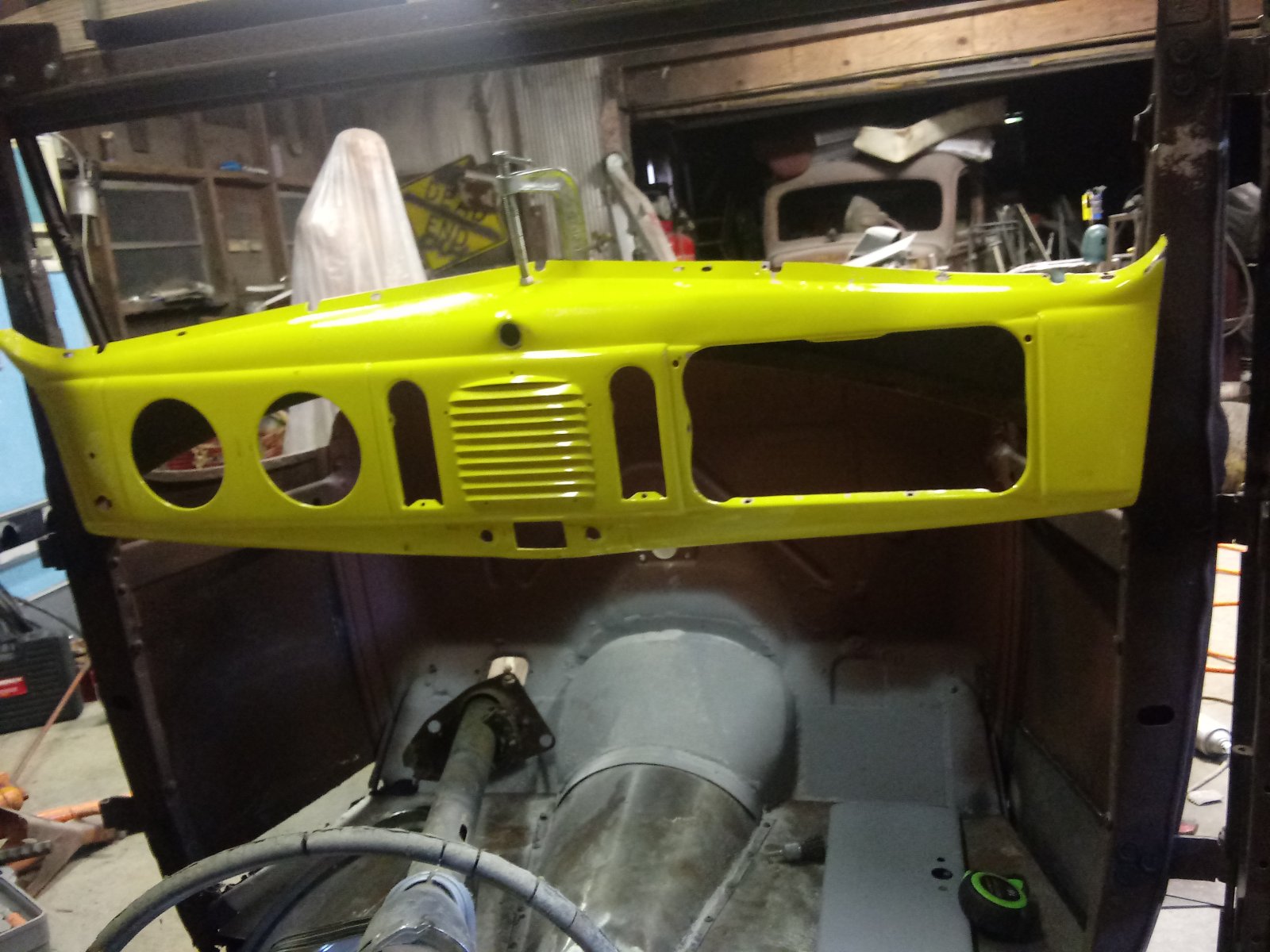

    First pics are of the dash sitting in the car, nothing remotely fits and is too long.

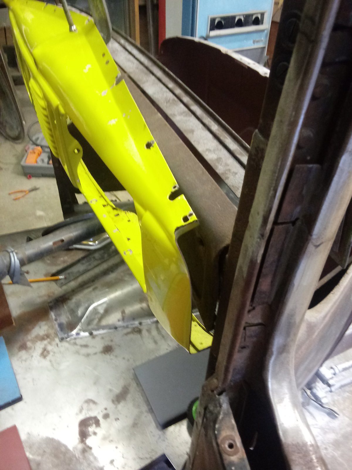

    So first up was cutting it down on width, then I cut a straight line down the top of the dash side to side to get rid of the windshield v.
    Then I took some 18 Guage metal and bent round corners to add to the ends of the dash to roll back into the original A pillar.

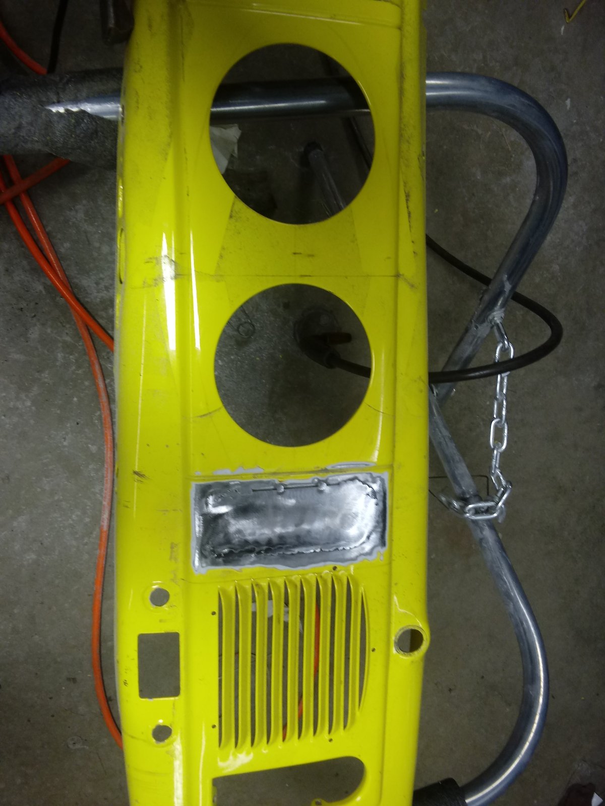

    Due to the shape and size of the stude panel I had to fill in the drivers side hole where the choke etc was. At this point I'm at a fog in design. I'm not opposed to the gauge panel but I'm not sure I like loosing the symmetrical look of the dash with the filled in hole... but push on.

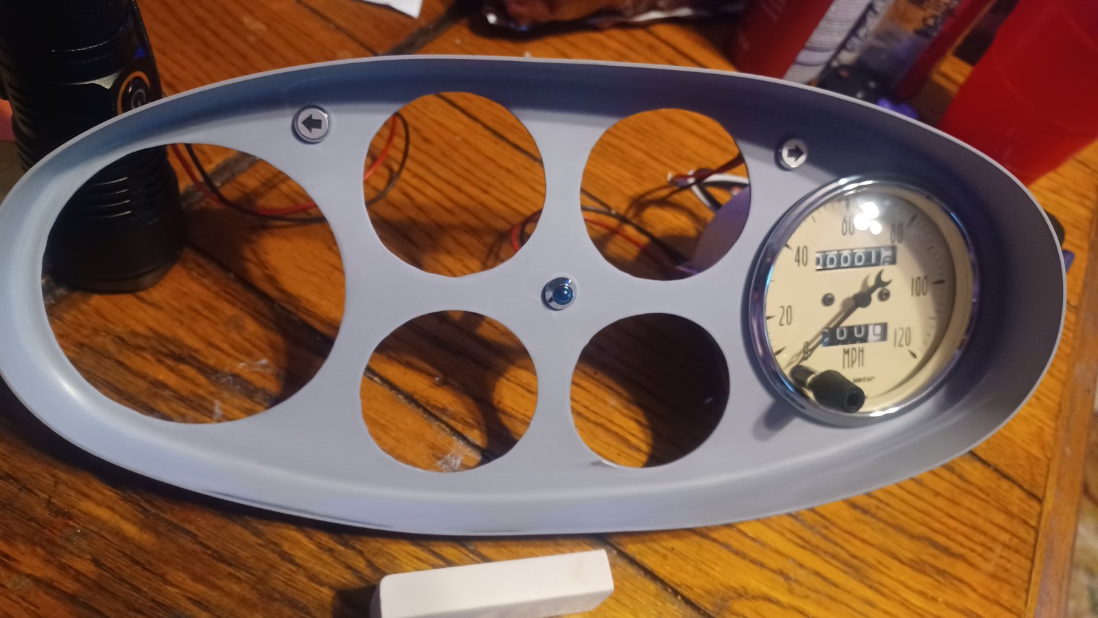

    So what's a fella to do?.... so I built a scaled down version of the stude gauge panel, ended up shrinking the dimensions by an inch each way, now that will fit !
    I got the new gauge panel built and the body work done and in primer... life was good !

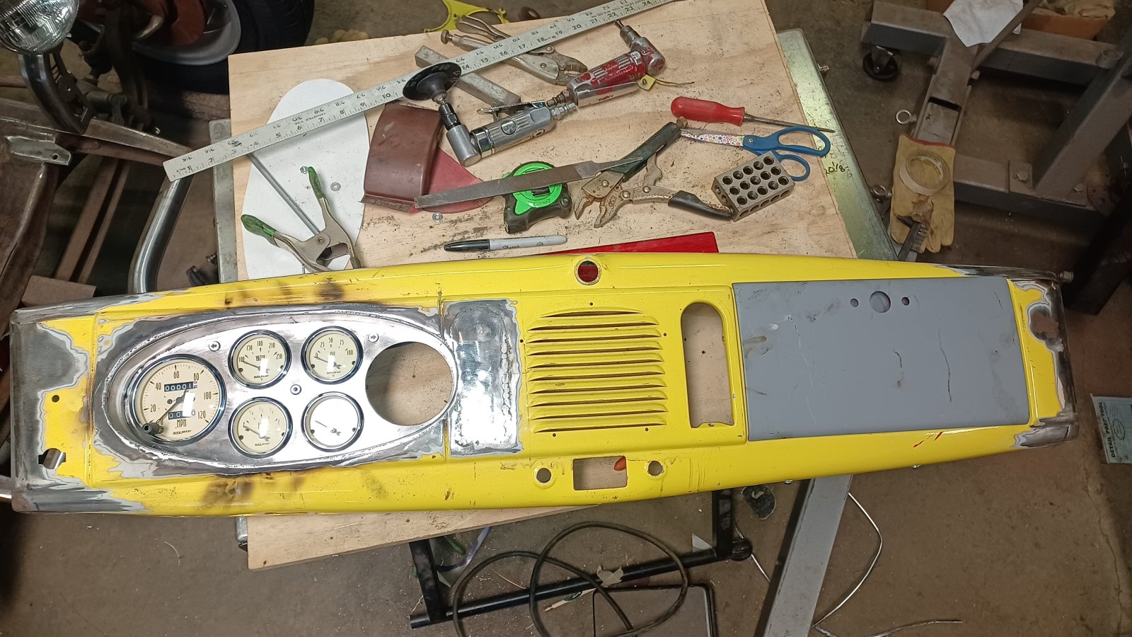

    20230711_184832.jpg Next up was cutting the dash to fit my new panel, cut the hole then took a piece of 1/8" rod and bent it to fit the panel then welded it into the back side of the new dash opening.
    Once that was done, time for a test fit and look see ! Gauge panel fit perfectly BUT due to the small curvature of the dashboard side to side the gauges sat at an angle, out with the gauges, gauge panel reinstalled and then I marked the gauge panel to match the angle of the dash, cut the angle into the panel, reinstalled, perfect fit and angle with dash !! 20230711_185127.jpg

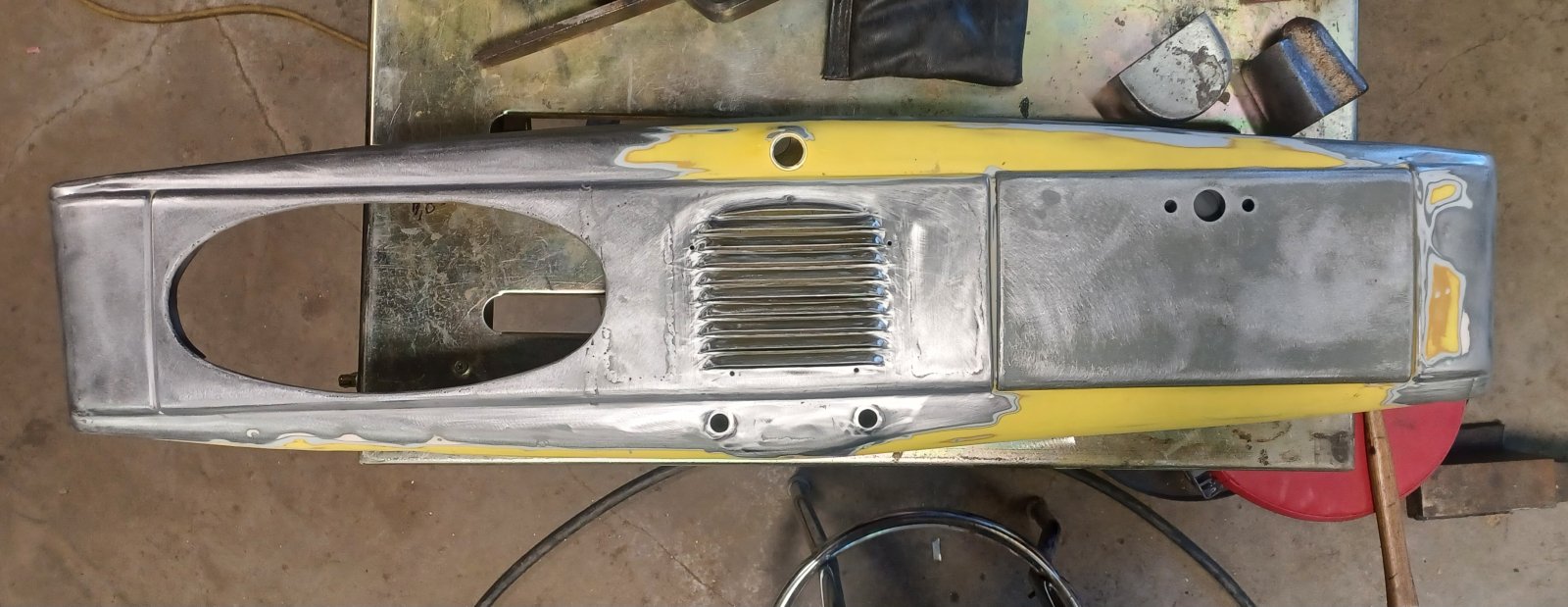

    I got it to a point where I was done! Well atleast done with the mods. And I liked the looks, although wish I could have kept more of the 38' features. The old radio knobs holes will now be the wiper and headlight switches with the ignition switch mounted between them. The old hole on top of the dash will be for the heater blower motor.
    Today I spent it grinding paint, welds and lots of 80 grit so I can put epoxy primer to it tomorrow and start adding bondo.
    Also I forgot to note earlier, the gauge panel bolts in with 2 bolts AND there is a plexigl*** panel that will go between the dash and the gauge panel also.

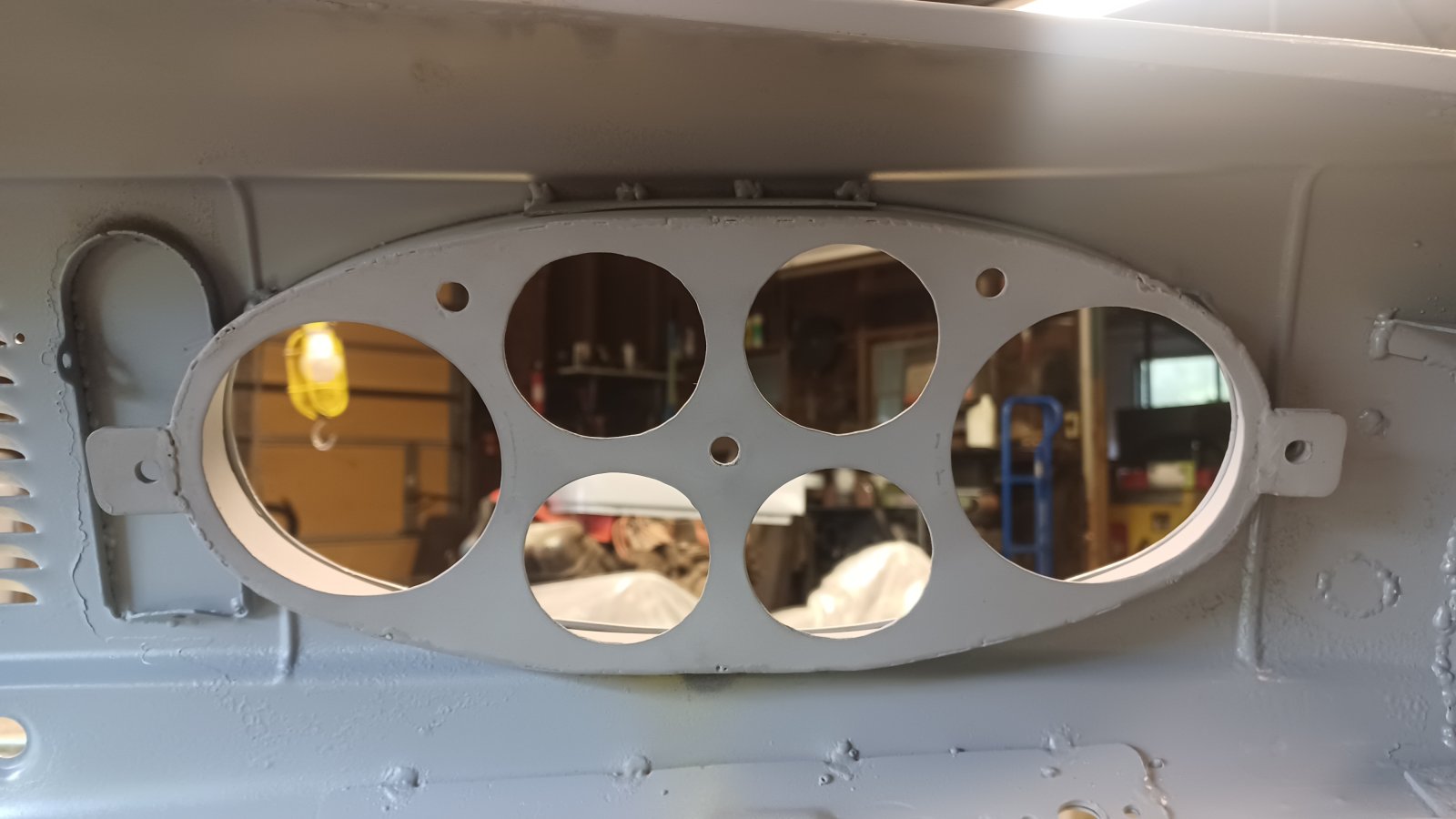

    More progress, got it epoxy primed yesterday, got the plexigl*** panel built for the gauge cluster.
    Here is a pic to of the gauge panel mounting inside the dash. It's pretty much self explanatory on how it works. Also notice the mounting bracket in the corner that mate's up to a mount on the A-pillar.
    I'm posting this as when I started the project there isn't much actual how to info out there especially on building and mounting a custom gauge panel...
