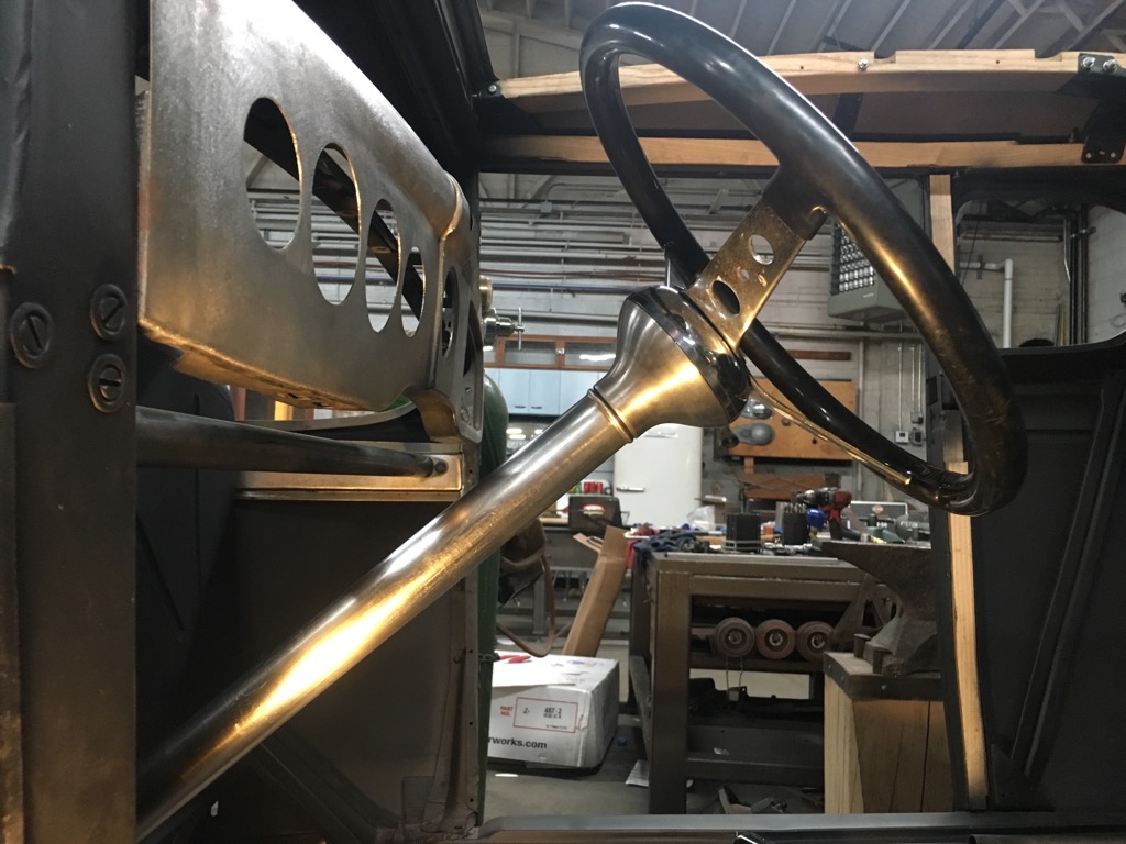

    @Joe Blow THAT'S a hell of a collection of threads!
    @buickbuilder a common steering box and column would be to use an F1 steering box and either the column that comes with it or a belled column from an earlier year Ford.
    I can't remember what year my column was from I think it was 39/40. I remember getting this and the box from a swap meet. I only wanted it for the column because I using an F1 box.
    Also, look up @NealinCA 's posts. He's the resident steering box guru.

    note the crossbar under brent's dash , i think that is the way to go... support your column from it and not ask the dash and its anchors to take the load...
