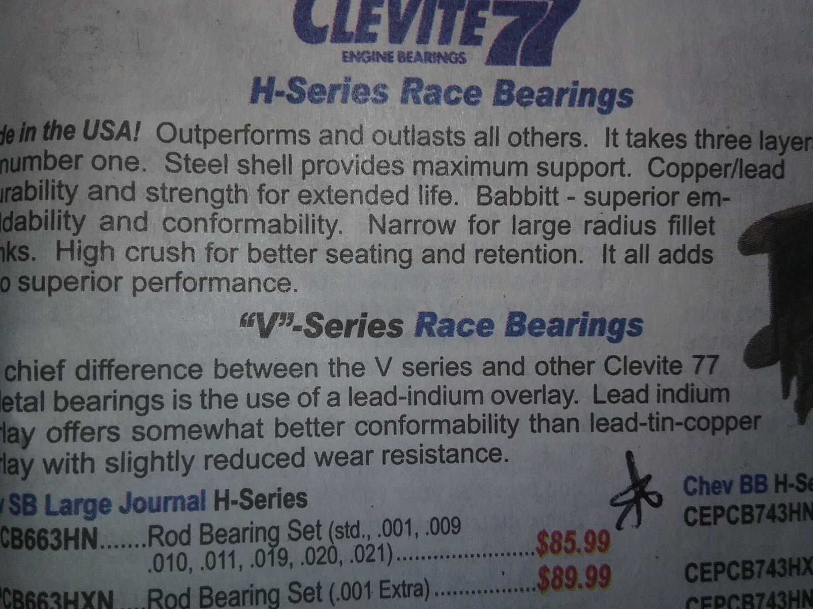

  16. brigrat
    Joined: Nov 9, 2007
    Posts: 6,069
    brigrat
    from Wa.St.
    I bought a crank from the late great " I am Butch" for a 301 302 old school build a few months later he e-mailed me saying I needed radiused bearings, not familiar, fill me in please!
    Deuces and GlassThamesDoug like this.
  17. GlassThamesDoug
    Joined: May 25, 2008
    Posts: 1,959
    GlassThamesDoug
    Racing prep, cranks would have larger radius in rod throws. Check with "Compe***ion Products" catalog on line, ...bearings have great descriptions.
    I just put a set in my 406 for a Stealth Crank build.
    Deuces and brigrat like this.
