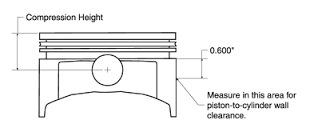

  25. I'm really digging your enthusiasm but the understanding is lacking. Here to helping you grow.
    Small block chevy`s had 5.703 inch rods, except the 400, which ran shorter 5.565 rods.
    The journal size changed and the cubic inches changed& the stroke changed but not the connecting rods. Connecting rods do not lower or raise compression, the shape of the piston does and the size of the combustion camber also does.
    When the stroke changes the piston pin's distance from the top needs to change also, that's called compression height.
