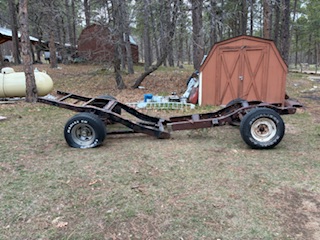

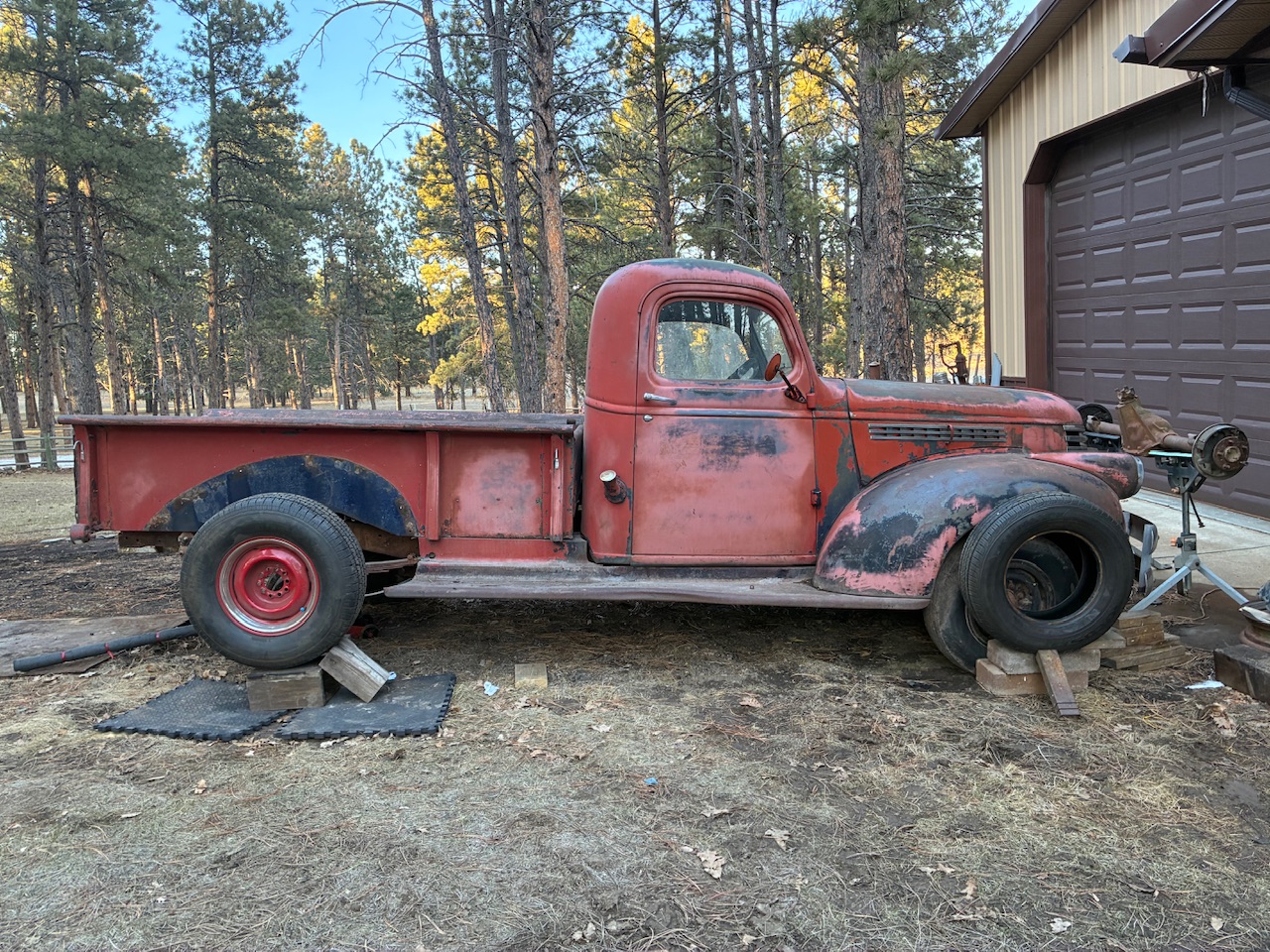

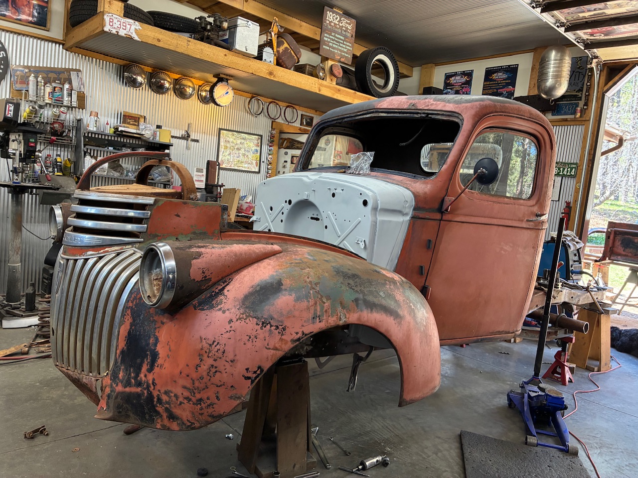

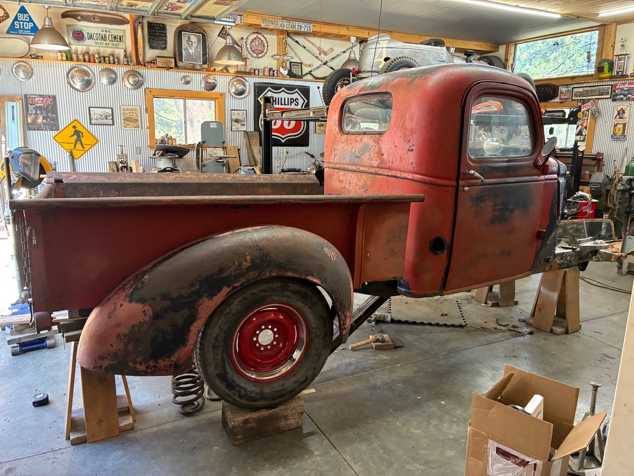

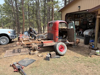

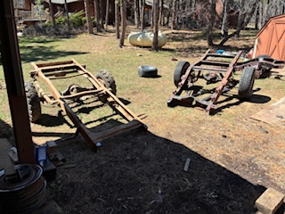

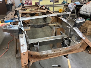

    I have a friend that knows I have hotrods and always bugs me to build one for him. I told him I do it for fun and not a job. Well he finally broke me when he said he had his grandpas 46 Chevy. I told him if he leaves it a patina truck I would build it. So here’s the progress so far.
    the truck is getting a mustang 2 and we cut the frame and backhalfed it with a 70 c-10 frame. IMG_4274.jpeg IMG_4366.jpeg IMG_4386.jpeg IMG_4387.jpeg IMG_4390.jpeg IMG_4391.jpeg IMG_4396.jpeg

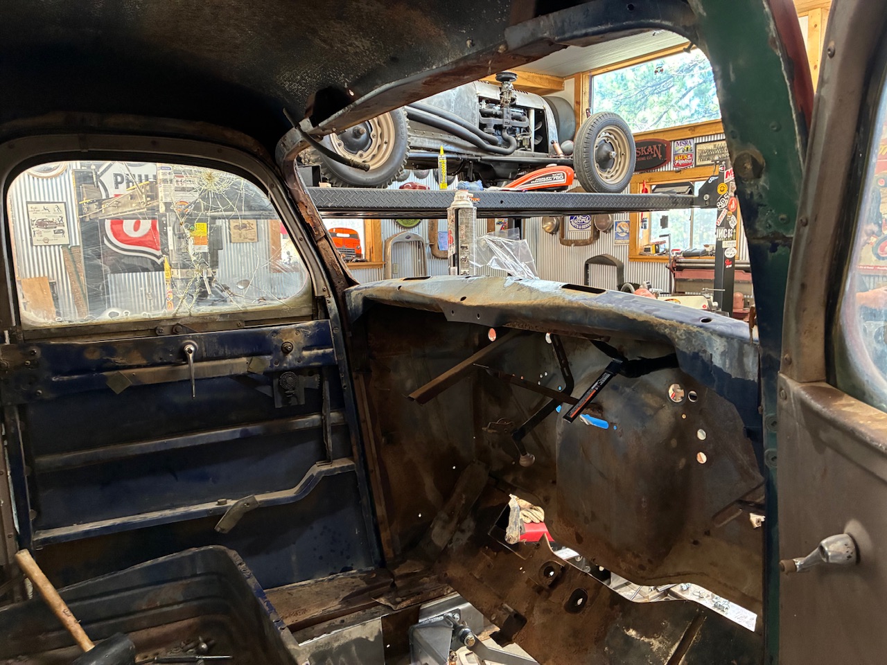

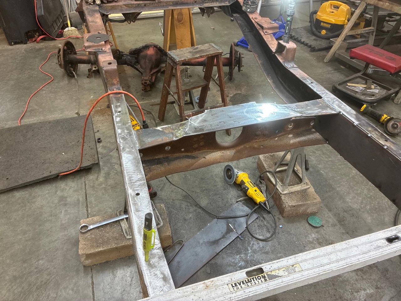

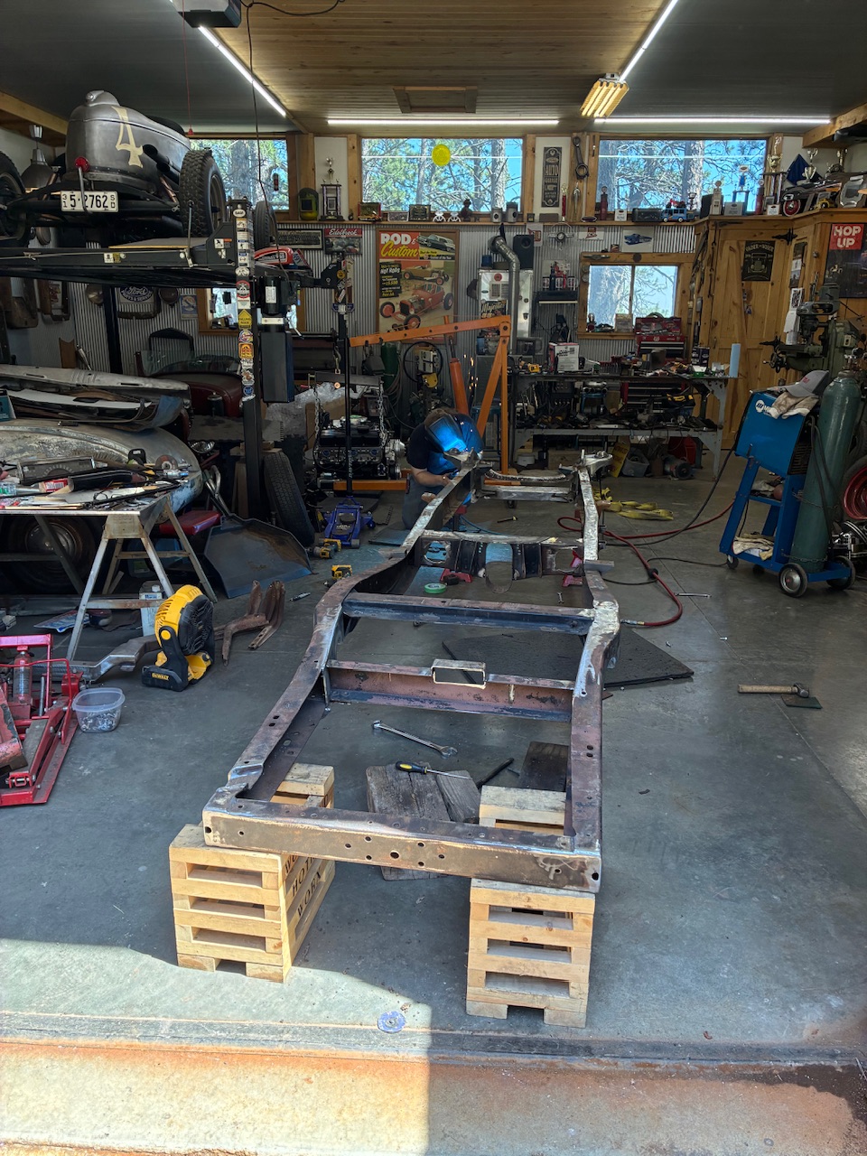

    Today I modified the middle crossmember by cutting the top off and making it flat so it doesn’t interfere with the cab floor. I also got the rear suspension off. Have to do some welding on the bottom of the frame after we flip it over and then off to the sand blaster. IMG_4396.jpeg IMG_4398.jpeg

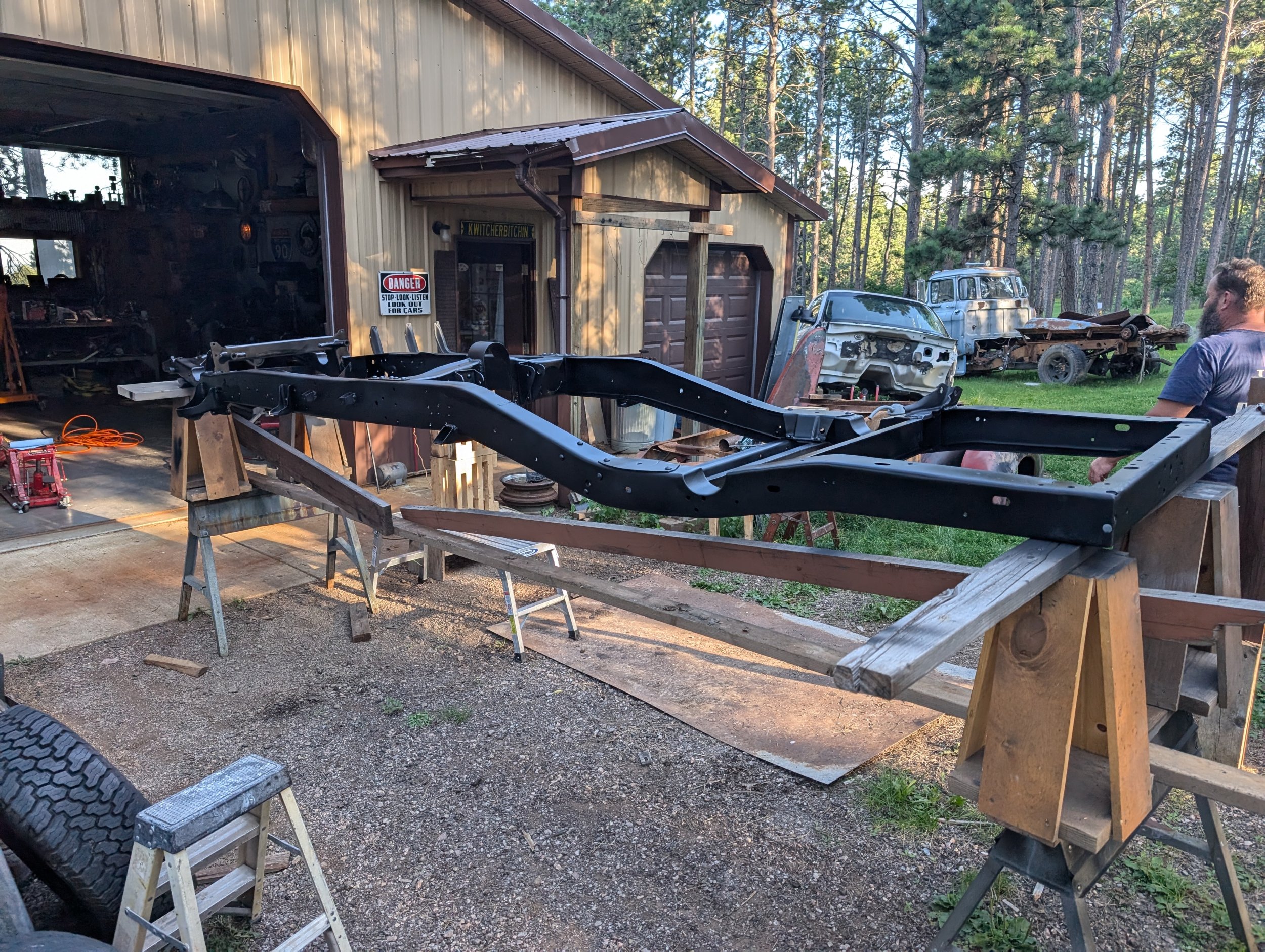

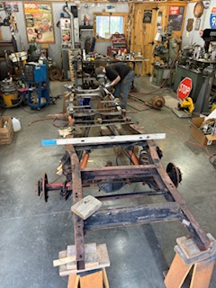

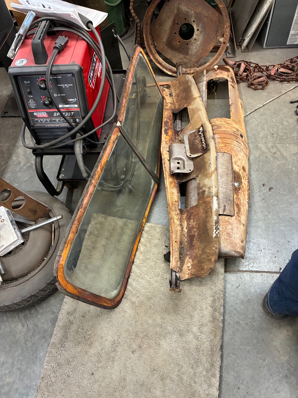

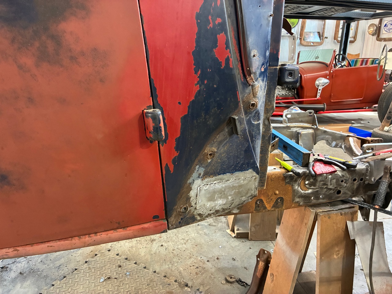

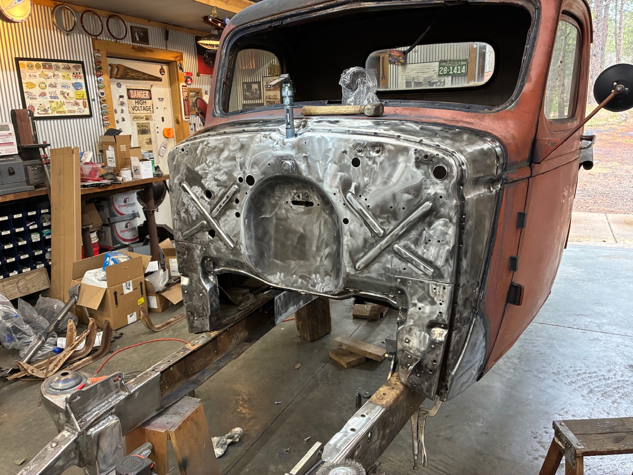

    Ch***is is final welded. Brooks my son has been helping me, he’s a welder by trade so he laid down all the welds(not with the Lincoln 110 welder). This morning we put the cab back on the frame took off the windshield, garnish moldings and dash. After that we took a rough measurement on the box and cut it to short bed length. IMG_4410.jpeg IMG_4409.jpeg IMG_4408.jpeg

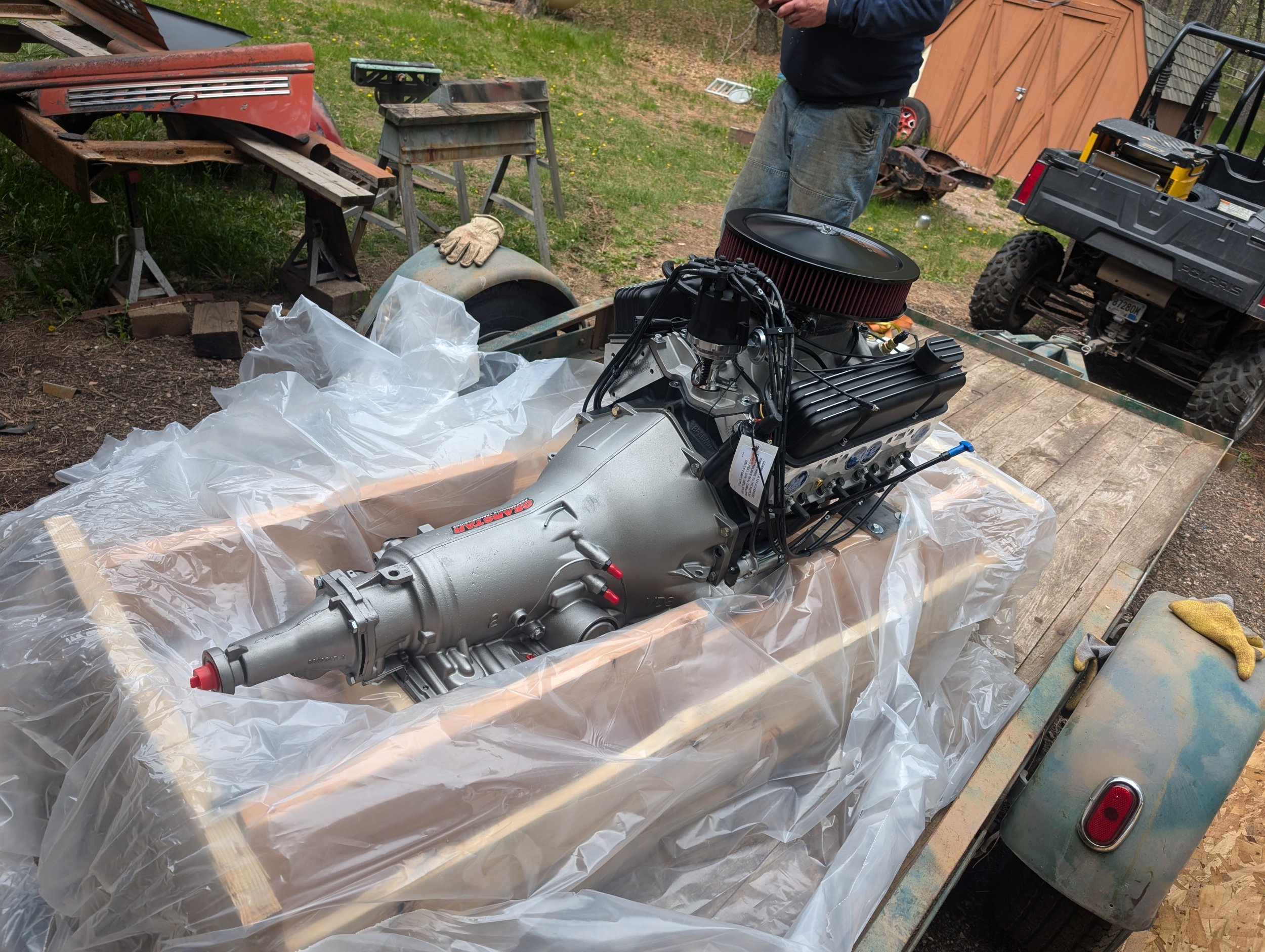

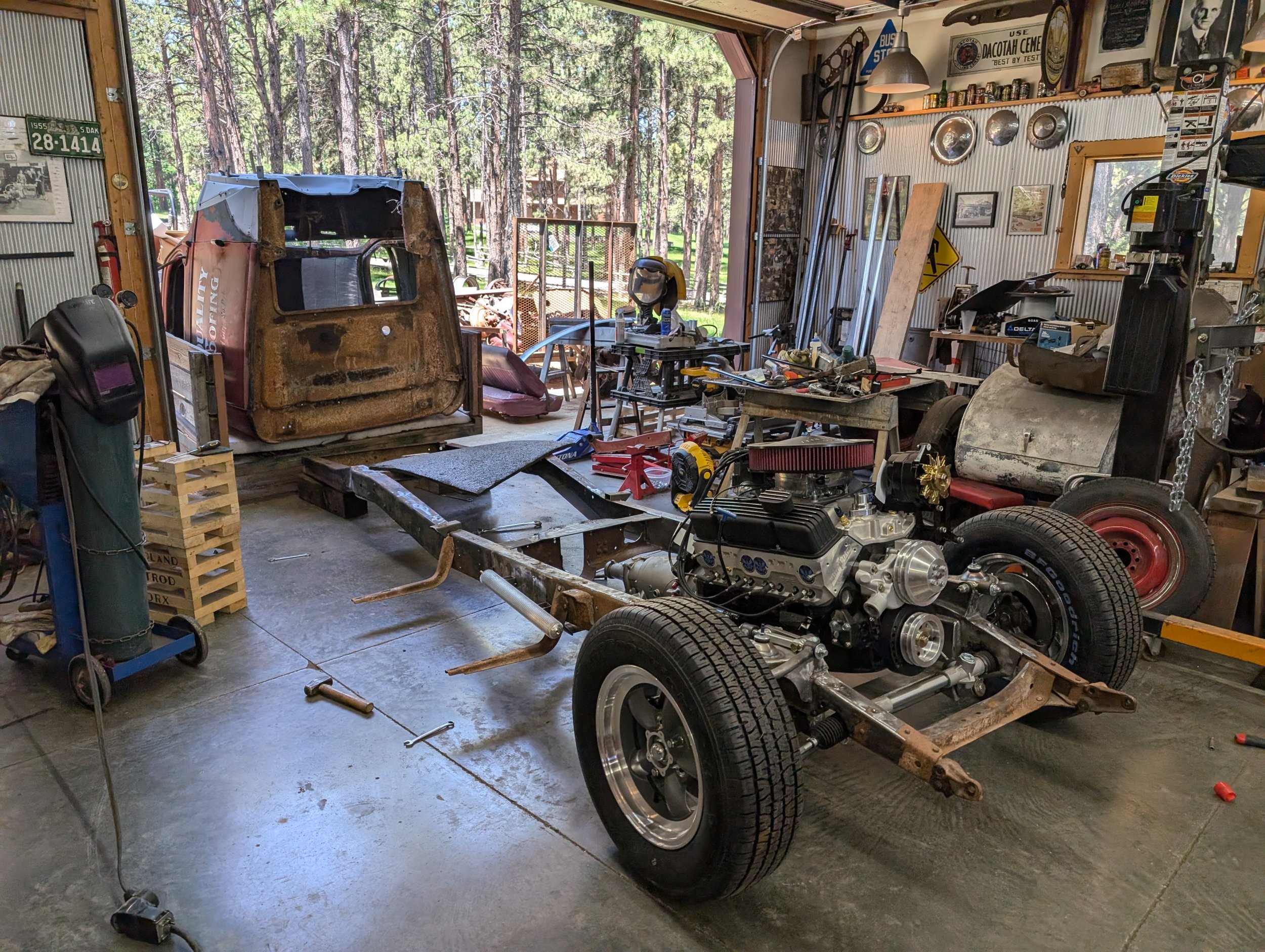

    Lost of stuff happened since May PXL_20250625_222104793.MP.jpg PXL_20250517_154947162.jpg PXL_20250517_205536288.jpg PXL_20250625_223745802.jpg

    Whoa, not so fast, Greenie! Beautiful engine and trans, is that a 350? Or did you go all out with a 327?
    Nice looking power plant there...let me crawl back under my rock...

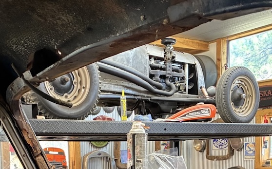

    IMG_2164.jpeg What’s the story on this machine ? Looks like a lot of good clean fun .

    @Okie Pete that cool single seater has its own build thread on the main forum if you want to hunt for it. It’s pretty neat!

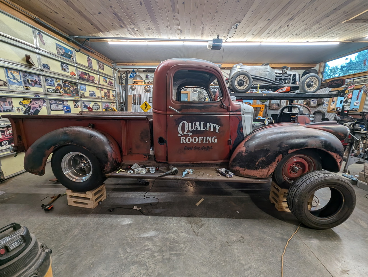

    IMG_4288.jpeg 462813651978532701.jpeg This has been a fun project especially since I almost have an unlimited budget. At this point I have it roughed in and it’s ready to blow apart for a frame final weld, sandblast and paint. Three months from being a totally stock truck to being a fun hotrod truck.

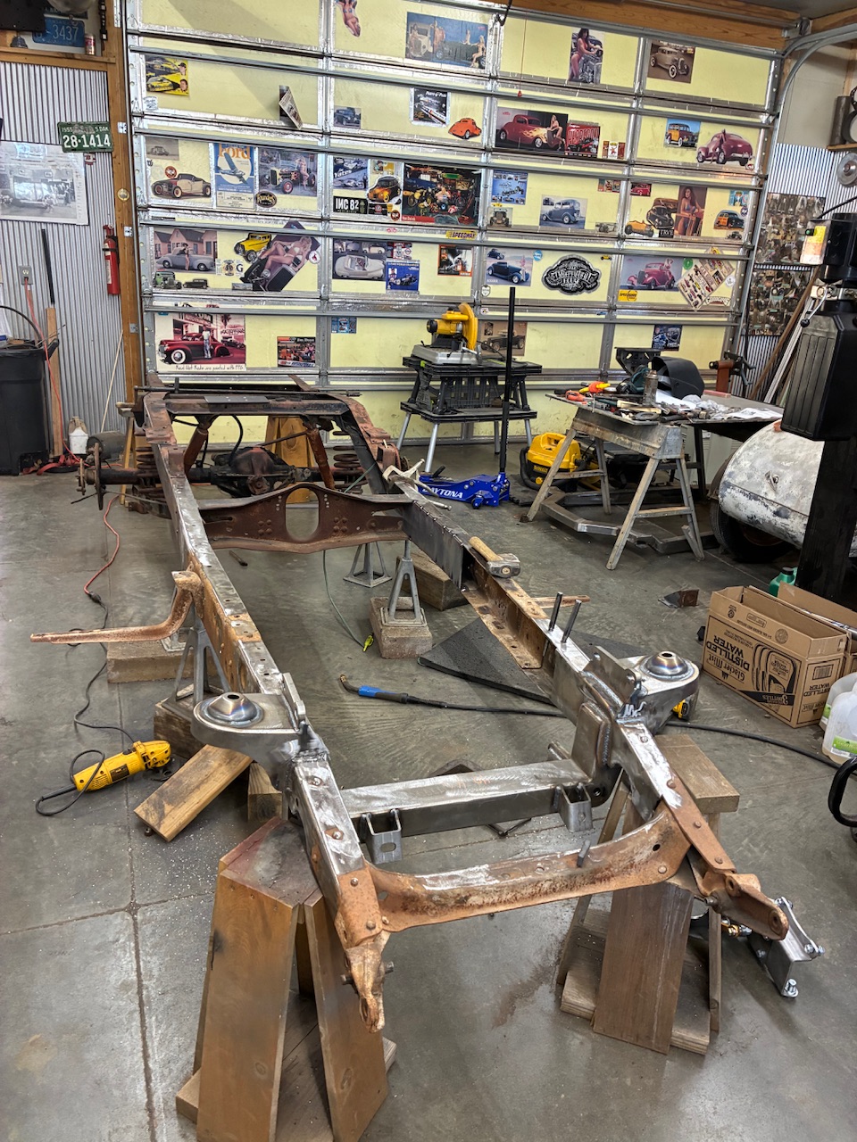

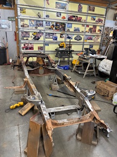

    It was a truck yesterday. tear down, final welding and sanding. I’ll have the frame sandblasted and then paint and re***emble. IMG_4535.jpeg IMG_4538.jpeg

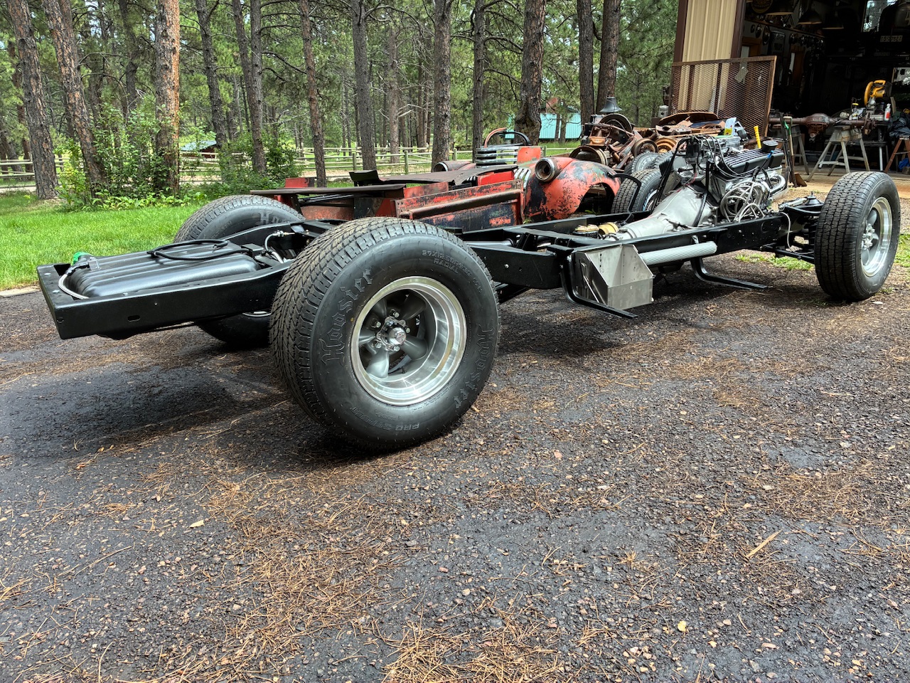

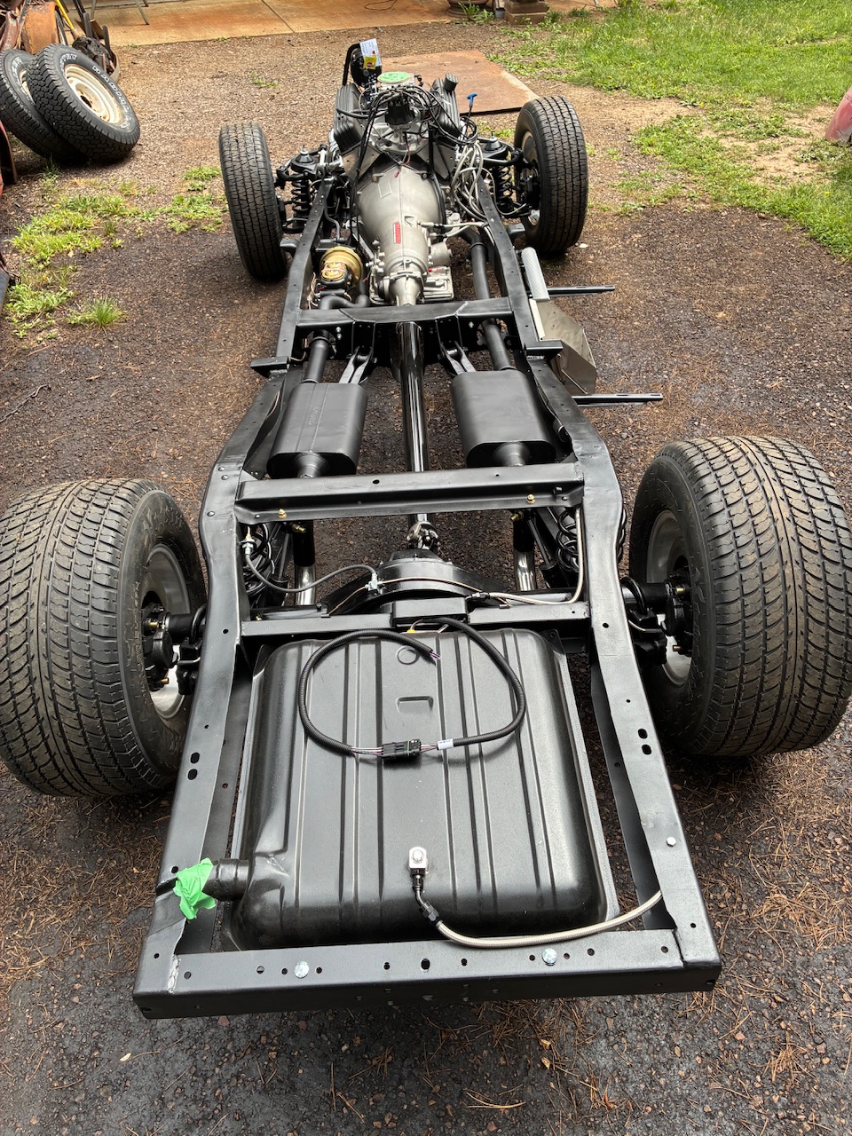

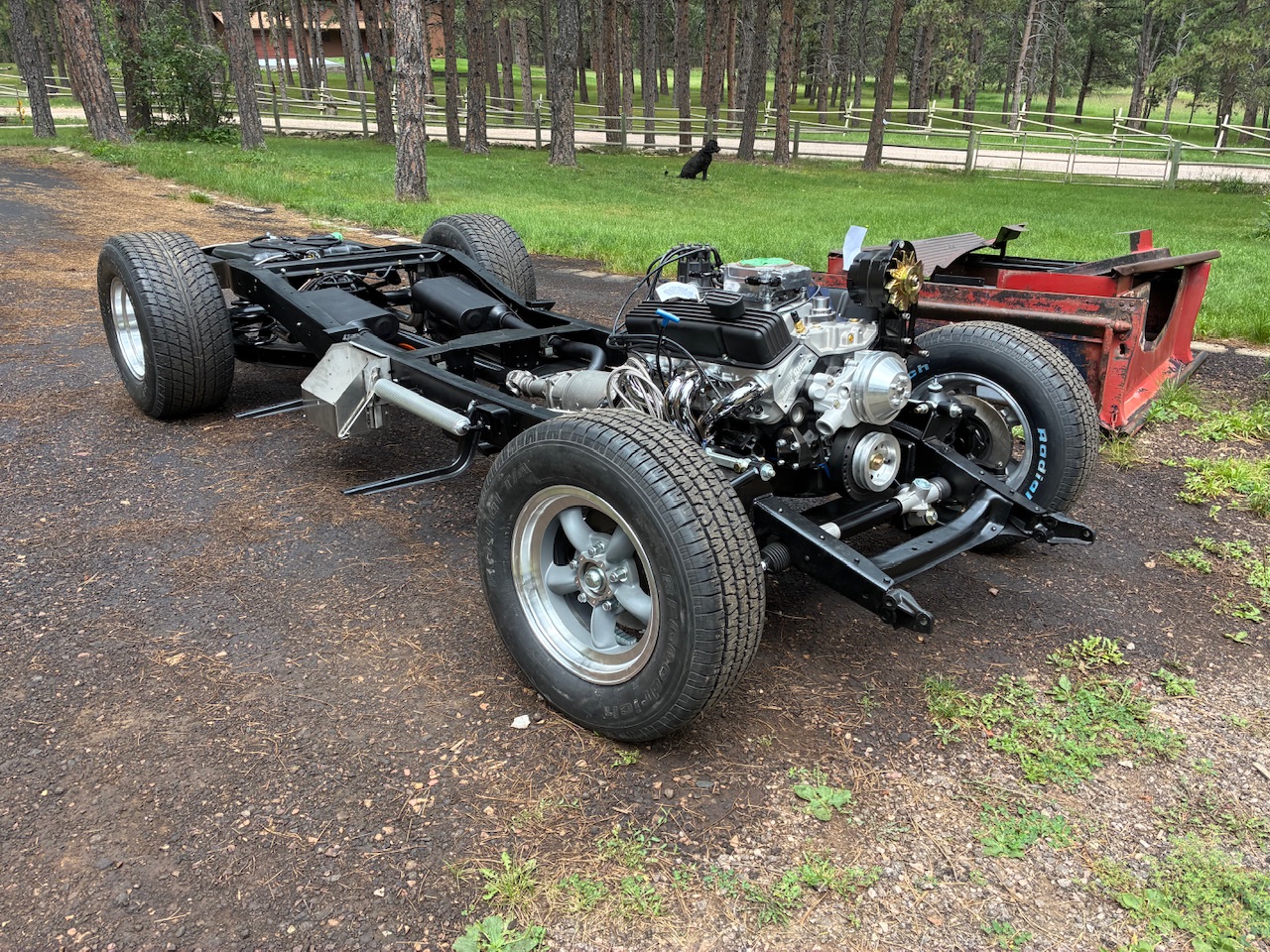

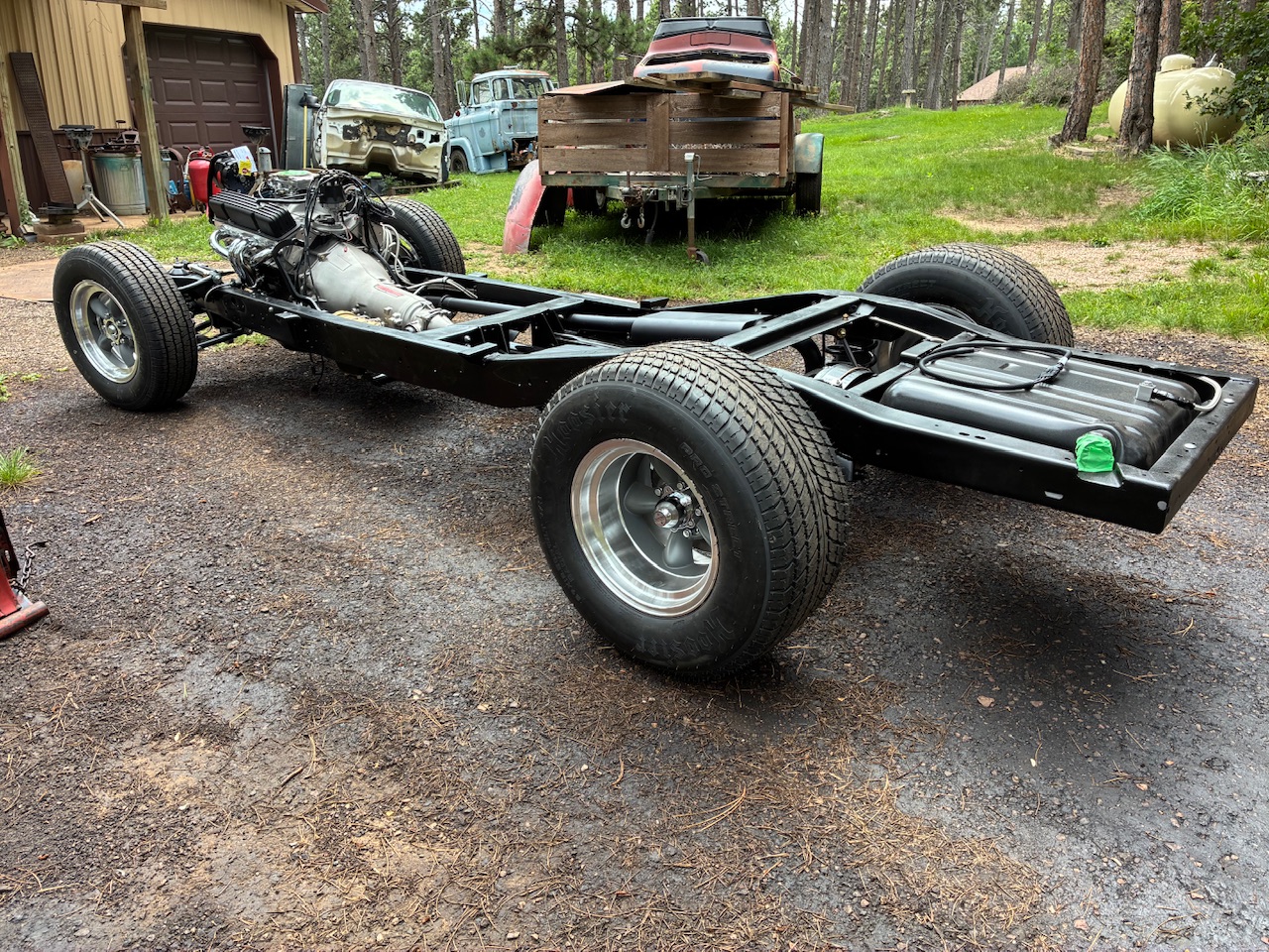

    IMG_4572.jpeg IMG_4573.jpeg IMG_4574.jpeg IMG_4575.jpeg Ch***is is all put together.. time for sheetmetal to go on for good.

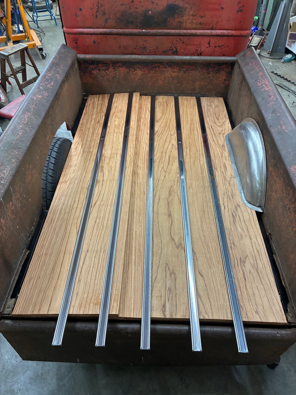

    Been doing a bunch a little stuff. Cab and box are mounted for good, fuel lines are all built, battery cables are done and on the truck, brake lines are all plumbed and I finally got wood for the bed. Using red zebra wood. IMG_4600.jpeg
