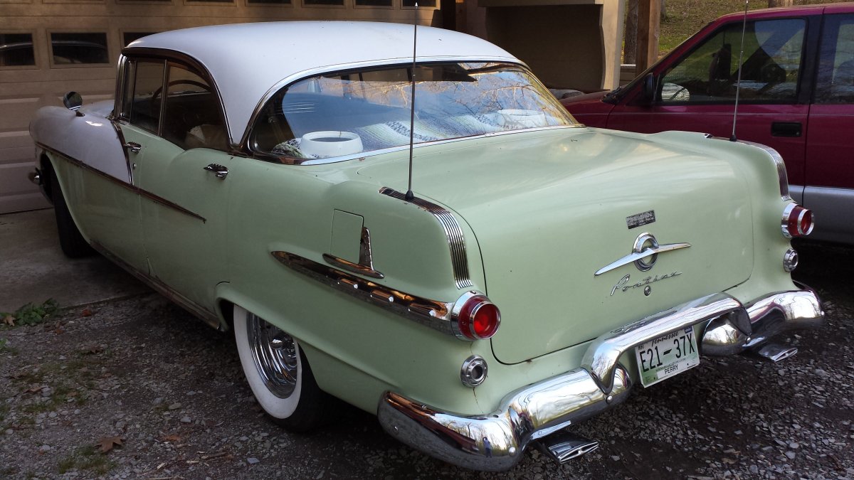

    Here's mine that I picked up couple years back. All original 316 engine, hydromatic trans, paint, upholstery. I tuned it, went thru the brakes, added dual exhaust, chrome reverse wheels, WW's, and a few extra pieces of shiny trim and I have been driving the heck outta it! Run's easily on highway. No rust thru but has a little surface rust around some of the trim pieces. Get's a lot of admirers and fun to drive while I work on my 57 Pontiac project.

  5. Yep, I replaced all wheel cylinders, rebuilt master cylinder, new shoes, and replaced any rusty brake lines. I can attest to the drums- a dude ran a red light in front of me just as I was about to go thru at about 45 mph. My buddy who was behind me said he saw smoke from my front and back tires when I stomped the brakes.

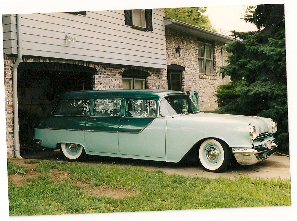

    Flypa38 ain't jivin when he says to double check that park brake. I've had 11, 55-57 Pontiacs and the brakes were barely serviceable for a bone-stock car. A hot rod Pontiac will need an upgrade to discs to be safe. Those cars generally weigh 35-3600 lbs and a 4 door hardtop may go 37-3800 lbs. The skinny 2 inch original brakes are scary on a long hill....I've lost my brakes coming down a really steep, slow hill in 2nd gear before....plenty of pedal, no stop!
    I had one of those 56, 4 door hardtop as a parts car for my chieftain hardtop. It came with the early dual coupling 4 speed hydro trans....the one with no park position on the quadrant ...great transmisssions. The star chiefs came with the "other" trans with a park position at the top of the quadrant....not a good trans.
    Have fun with it!

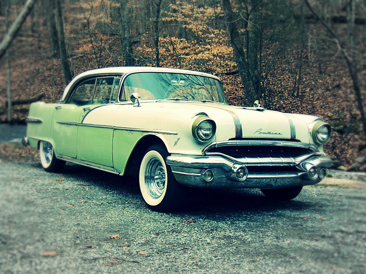

    Cool thread and cool car, I'm going to follow along. Here's the 56 4 door hardtop I just got! image.jpg

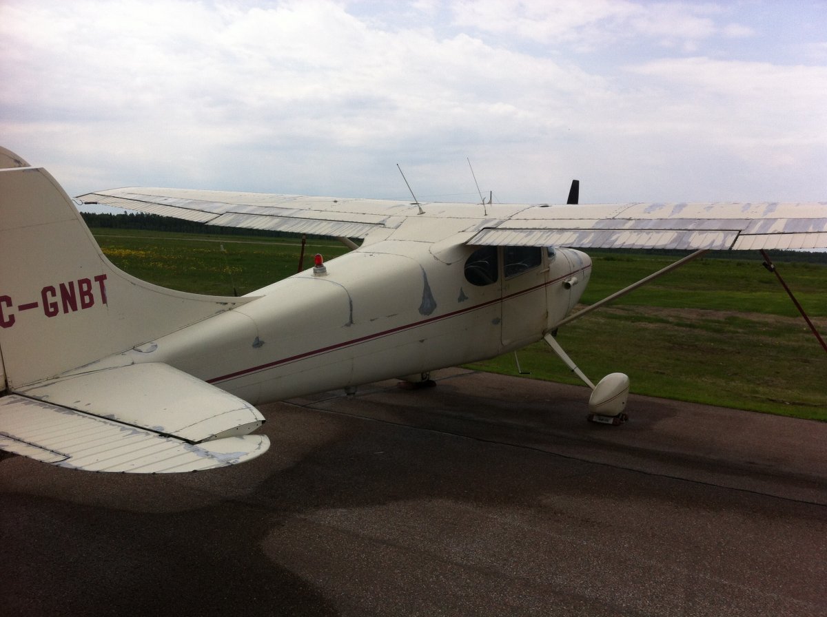

    Wow that's weird!! I work on AT-802's used to fight forest fires, along with their scouts (called bird dogs), Aerostars and Cessna 337's. I also do a little on Cessna 188's, and my buddy's 1953 Cessna 170B. It looks like something that belongs on here! lol
