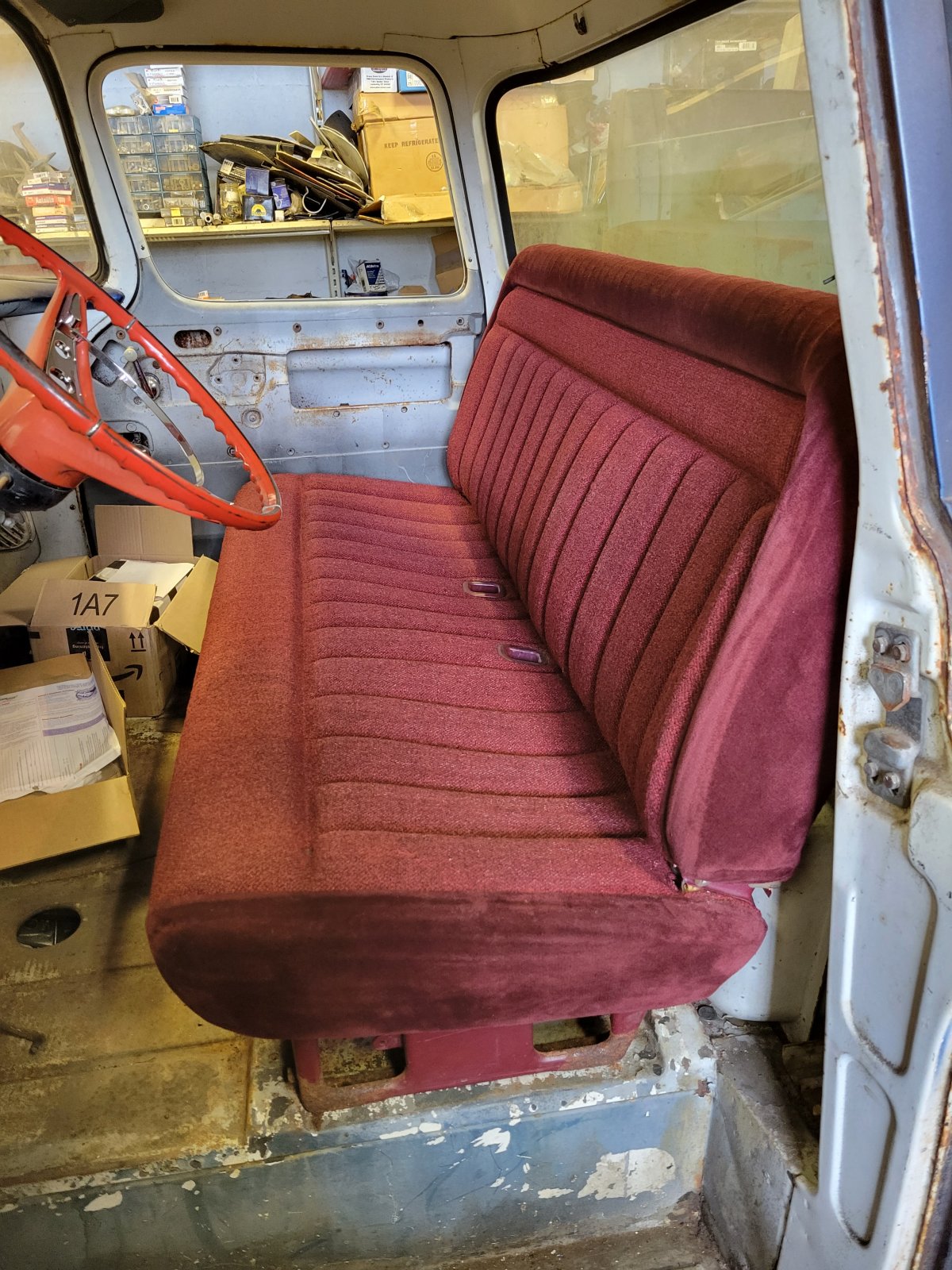

    I also swapped the 88-94 60/40 seat for one with an armrest, but it was kinda like the 60/40 where it made you sit a little left of the steering wheel.
    I sold the 60/40 to a young guy that was buying it for his tall uncle so the wife could drive his truck, turns out I knew the uncle and later he drops buy to show me his new seat. He came the next day and gave me the bench seat he took out, which is the seat I originally wanted to start with, so that all worked out great.

  14. Swade, what is your new bench seat out of? It fits great!

    It's out of an 89 chevy truck, it does really fit well, probably put a black vinyl cover right over the cloth.

    How much lower or taller is that seat compared to an original…any idea?

    Which part, the bottom where you sit or the height of the back ?

    My bad…bottom where you sit…looks like maybe a couple of inches? Thanks for the comparison pics.

  28. I've got the 40/60 split version in my '51 Chev pickup and really like it (had to have it narrowed for the narrower cab, though). Comfy and wears well.

    That's the exact same seat I used in my '58, right down to the color. It's a perfect fit in a TF truck and about as comfortable as a bench can be. Yours looks to be in much better condition...
