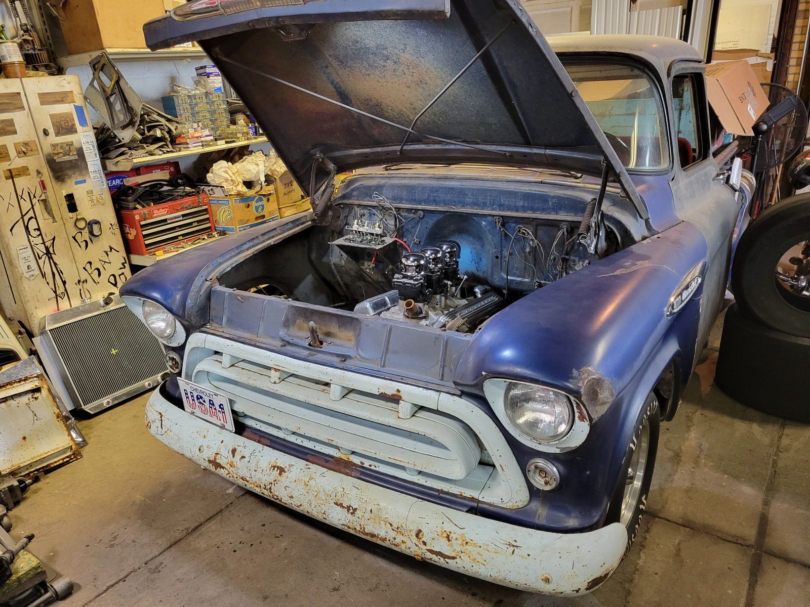

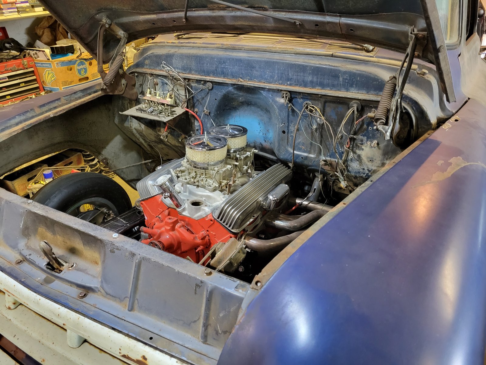

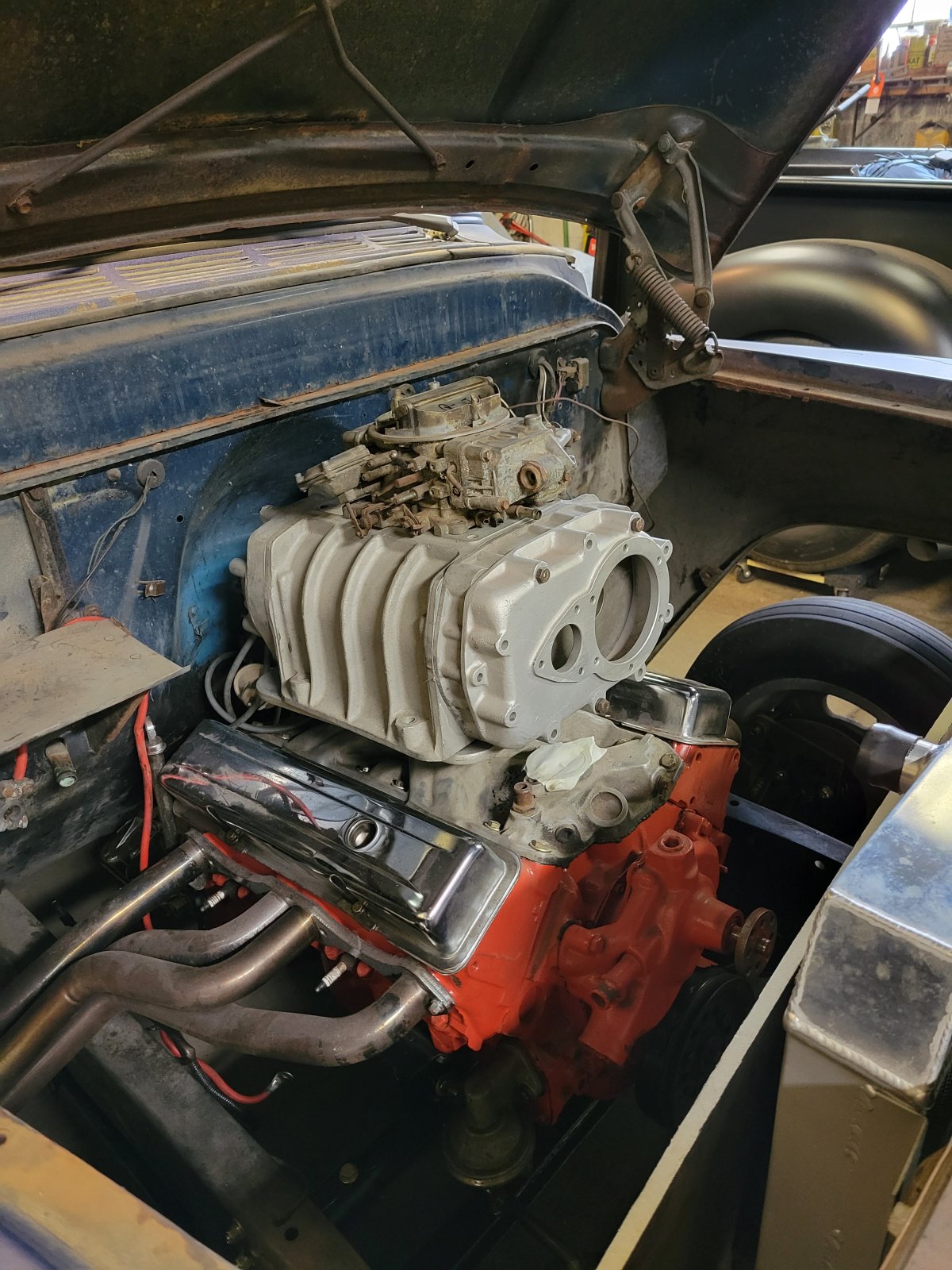

    The "X" brace hits the scoop before closing, 9 billion degrees in the garage and I decided it was a great time to put a dummy blower on to see how a blower would look, like a soupy sauna.

    I had to do some fiddling around to get the hood to close on my shop truck project as well. This setup will give me about an inch of clearance between the air cleaner and hood underside.

    Years back I was called to be a helper on my friends ‘56, he’d put a tunnel ram on it, and the x brace was hitting the air cleaners.
    He had some round stock set up and bent , I held it in place while he gas welded it. Then he cut the center of the X out and the hood closed fine.
    It turned out real nice and kept the factory tension on the hood.

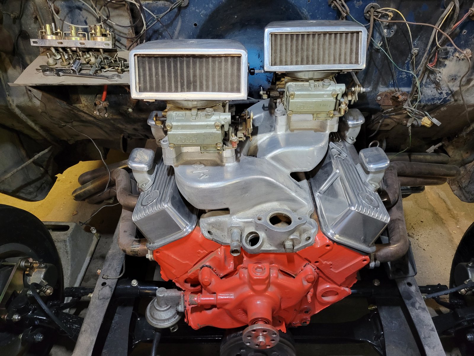

    Waiting on parts for the Henry J so I decided to pull the intake on the 307, it revealed it's just a used motor that someone threw new gaskets on and gave it a paint job.
    With the intake off I decided to mockup the parts that will eventually be under the hood, I dig it.
    Then since I'm gluten for punishment I dragged out a few more intakes and valve covers to see what all the "backup plans" could look like
    20230721_160333.jpg 20230721_160352.jpg 20230721_160915.jpg 20230721_160827.jpg 20230721_161802.jpg 20230721_161821.jpg

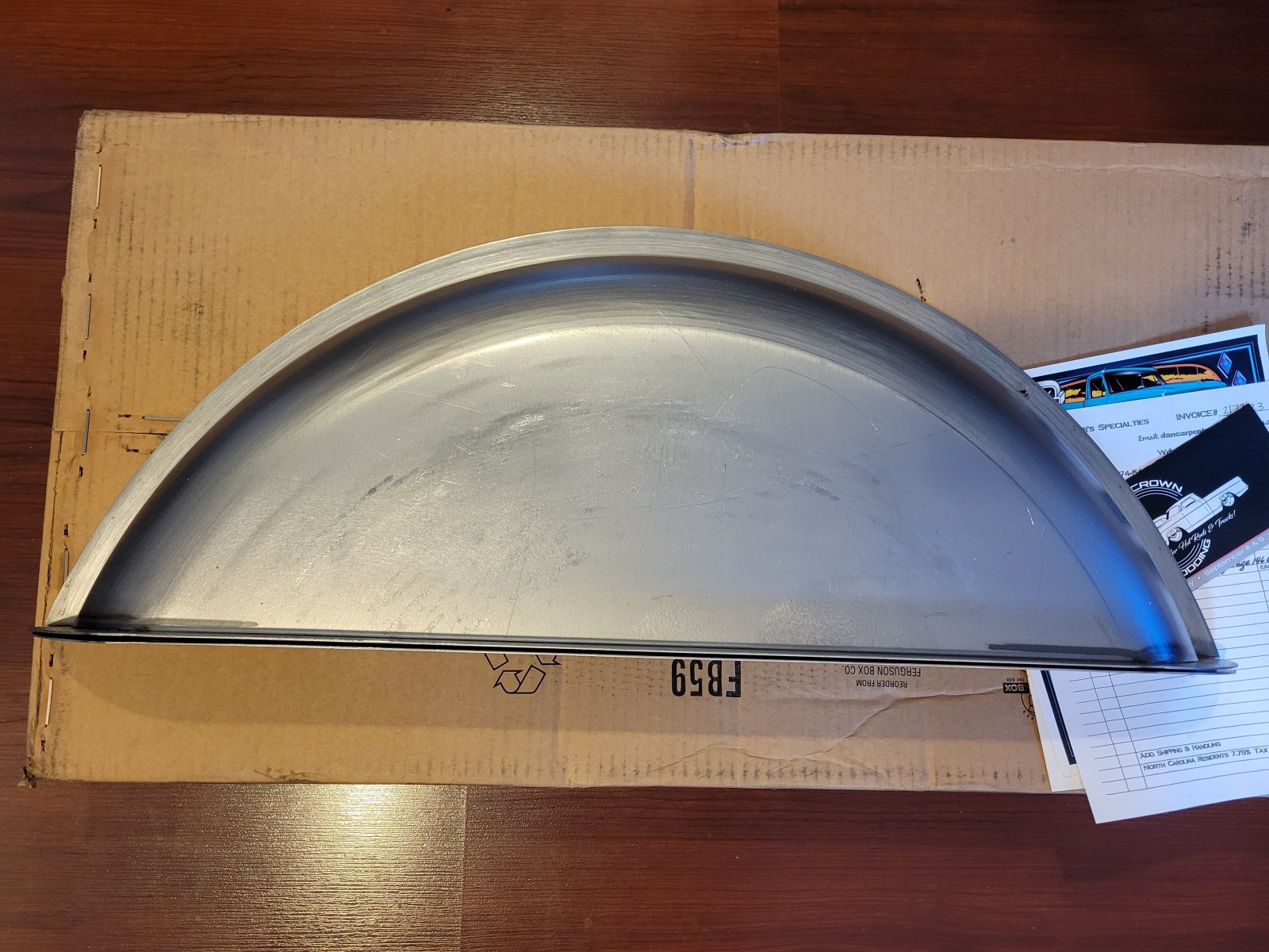

    Yup, no such animal, nobody sells a patch panel so either find a bad fender to use as a patch panel or buy a good fender and just replace it.
    When you think of the man hours involved in finding a sacrificial fender, cutting both pieces out, welding back together and then bodywork, you'll be way ahead to just find a good used fender.
