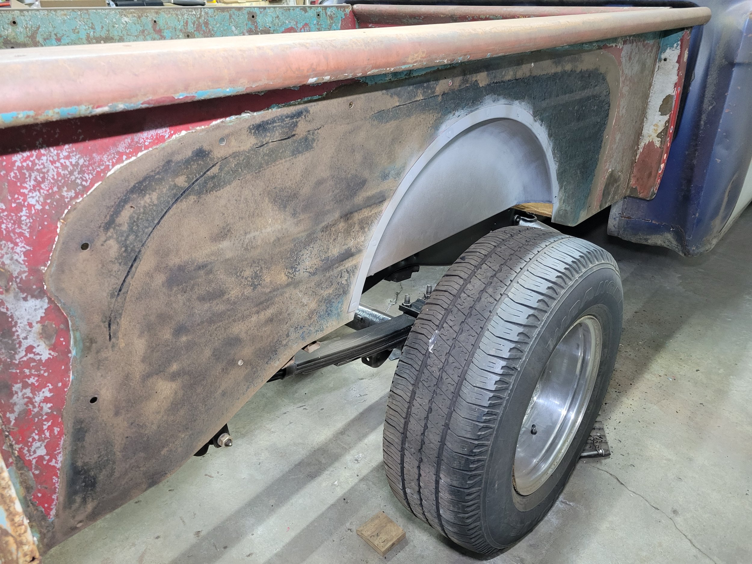

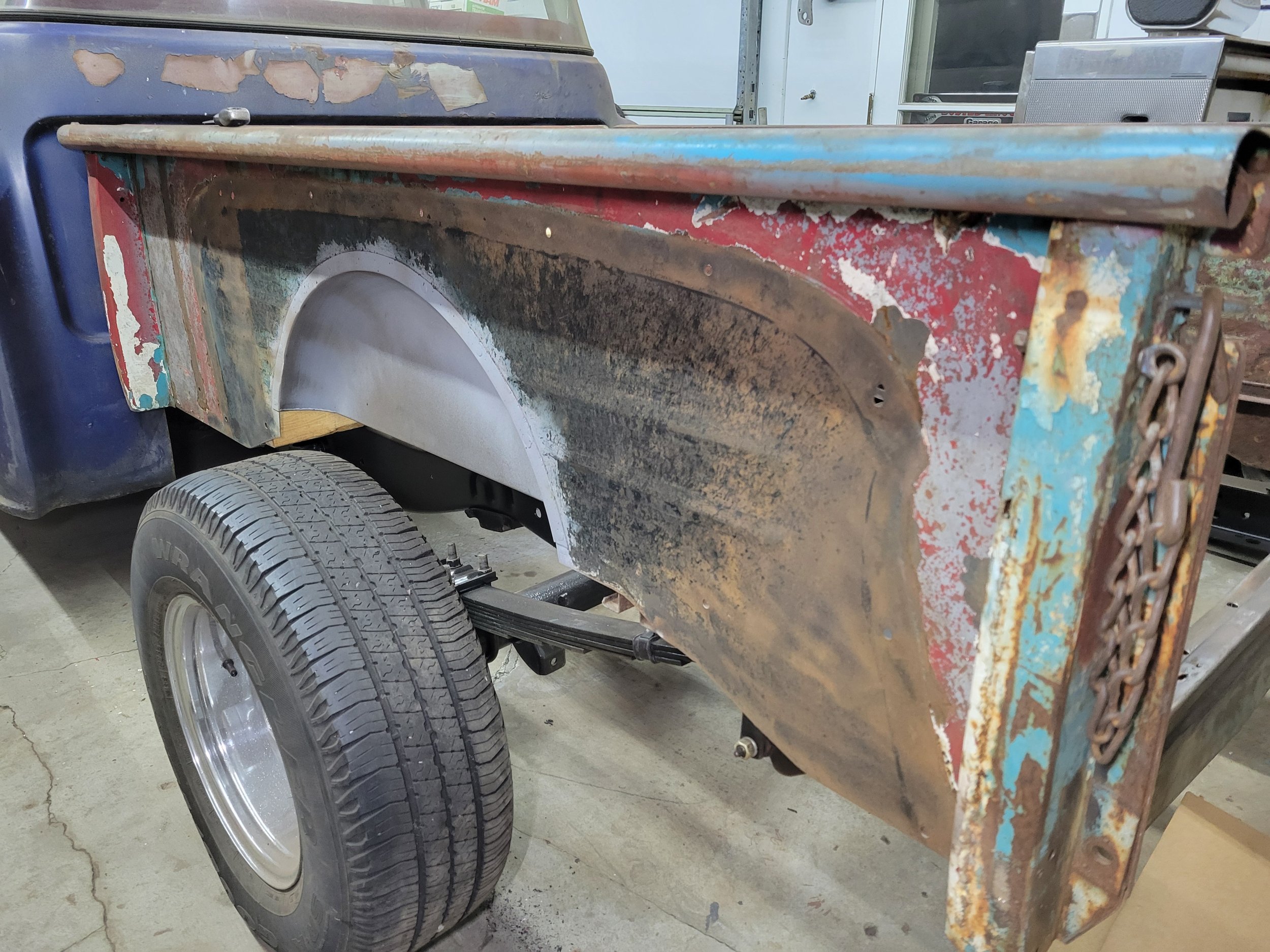

    I got the wheel tubs welded in, one stepcloser to hotrodism
    And knocked all the puncture holes flat in both bed rails, also noticed this bed was also a spare tire bed, so some extra holes to weld up one day.

    Doing dirty work, got the majority of the undercoating s****ed off
    20250118_170508.jpg 20250118_171432.jpg 20250118_171204.jpg 20250118_171444.jpg
    Wire wheeled the rear crossmember, probably pull the bed back off and stand it on end to wire wheel the rest of it. That's got to be easier than trying to do it where it is.

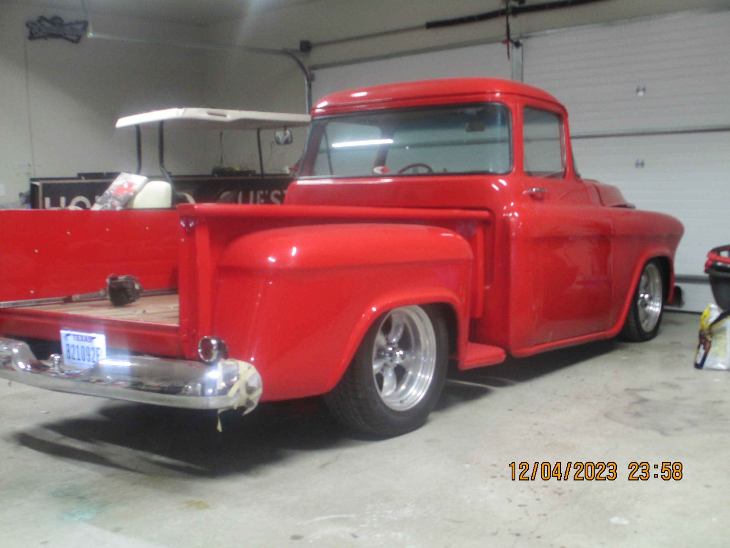

    Mine, almost finished, need to finish tailgate, Firebird clip, SBC/700r4 10 bolt with 336 gear IMG_2092.jpeg

    Looks nice
