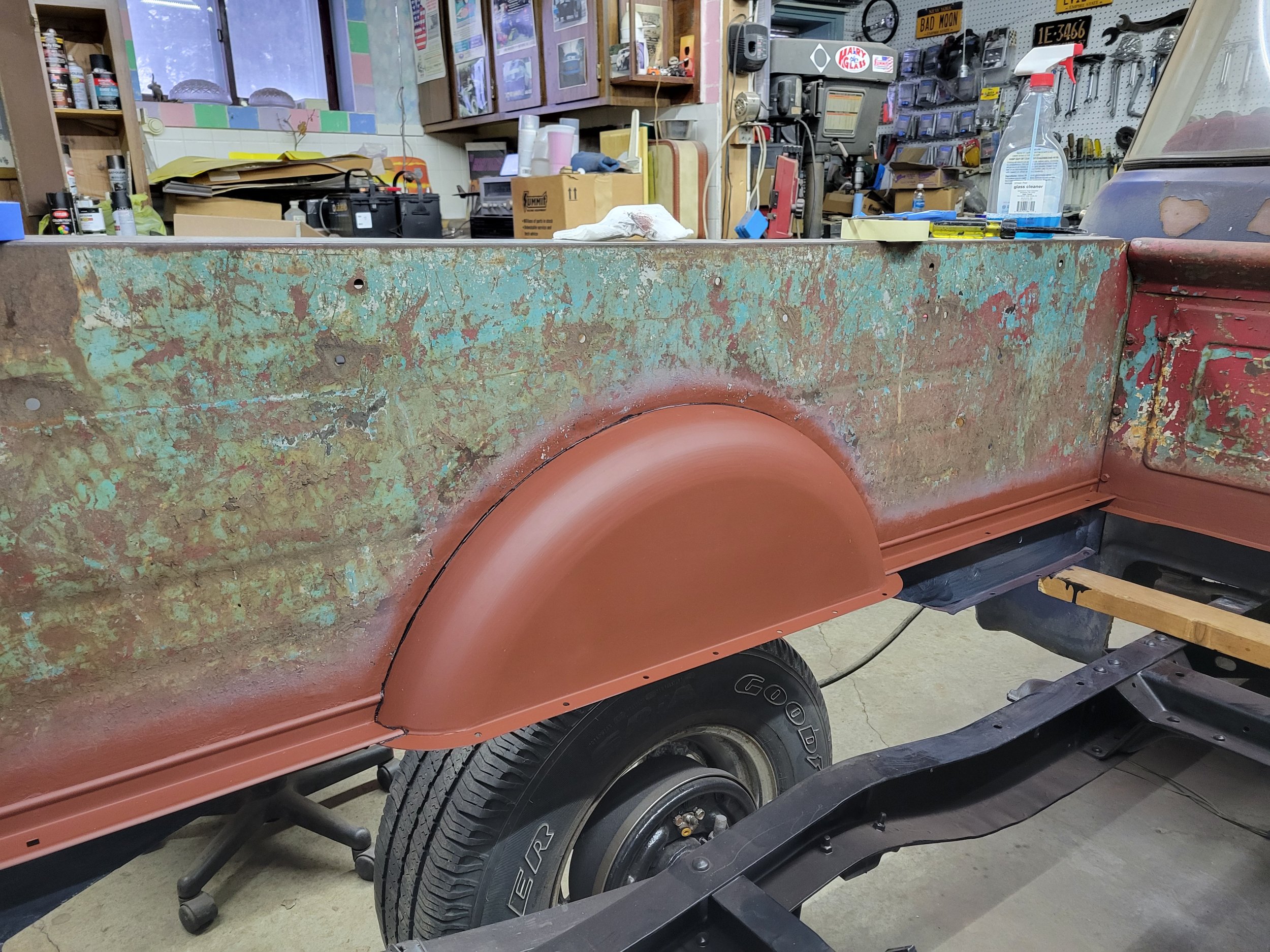

  6. I cleaned up the angle strips and wheel tubs then gave them 2 coats of gray primer sealer then 2 coats of red oxide.
    Then I taped them up and seam sealed the gap in between wheel tub and bedsides
    Picked up some seaside and burgundy paint and wadded up some shrink wrap. The burgundy quit spraying almost immediately, but none the less I wasn't to impressed with it, although I didn't throw any dirt at it yet lol

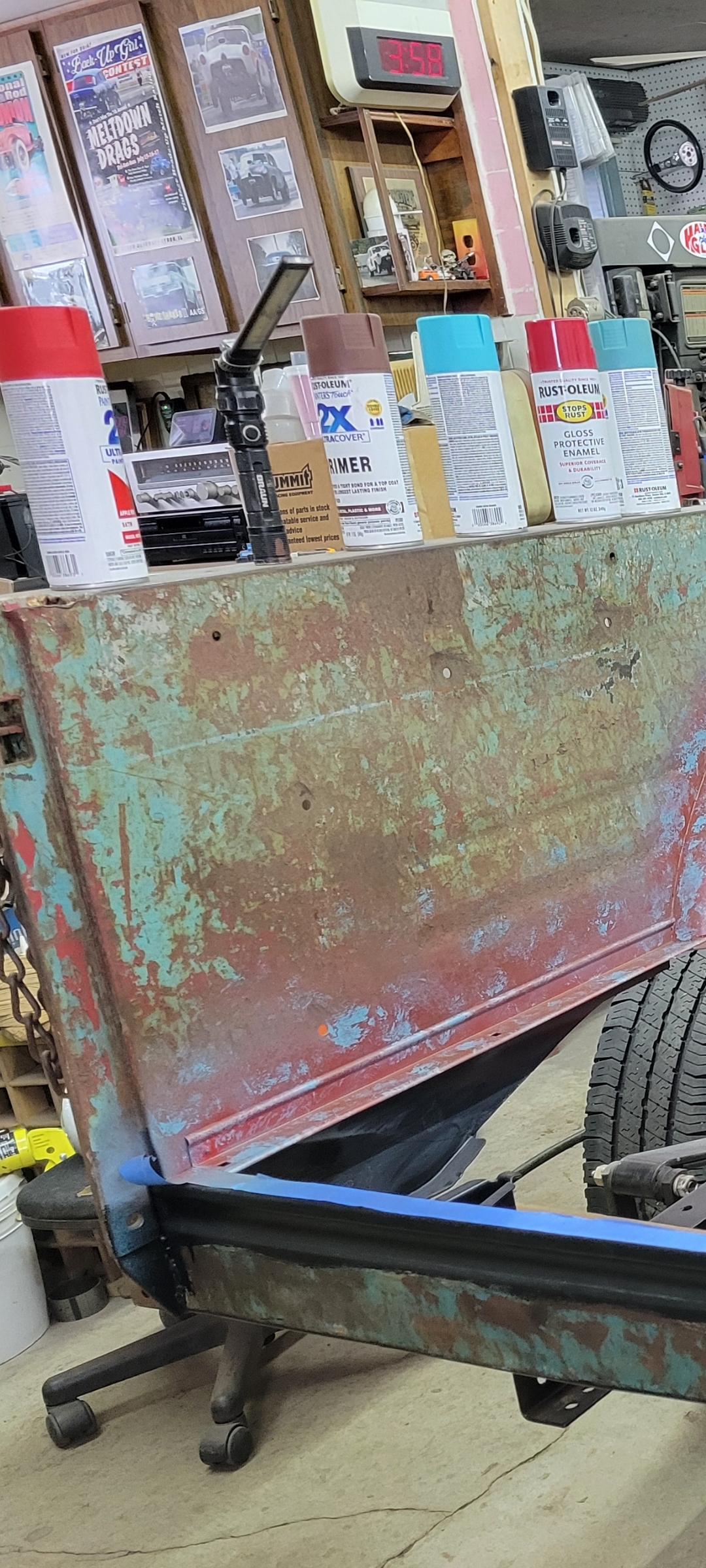

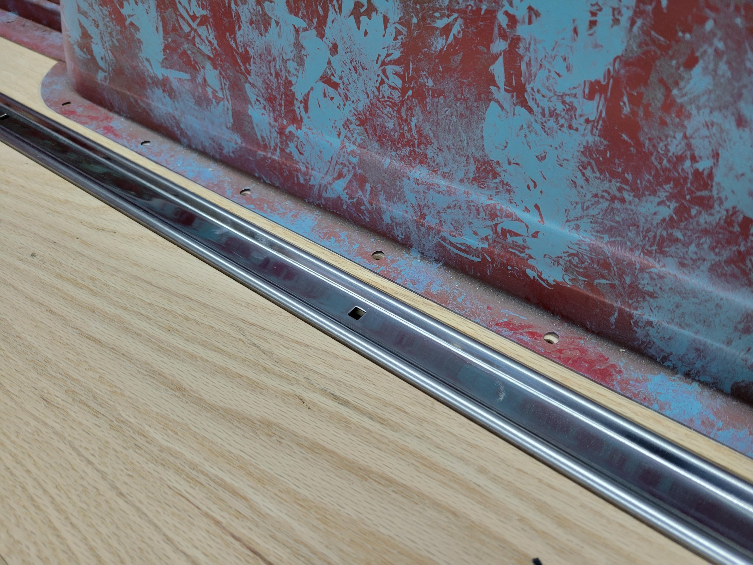

  9. Round 2, satin teal followed by some kind of satin red, shrink wrap dabblin, then a little primer dusting followed by some teal sprayed directly on the shrink wrap and more dabblin.
    It might tone down a bit once it's completely dry, at any rate there's a few layers of paint on it for protection.
    20250224_155124.jpg 20250224_155150.jpg 20250224_154816.jpg Screenshot_20250224_164501_Gallery.jpg
  10. I messed with it more today, tomorrow I'll scotchbright it then move onto further adventures

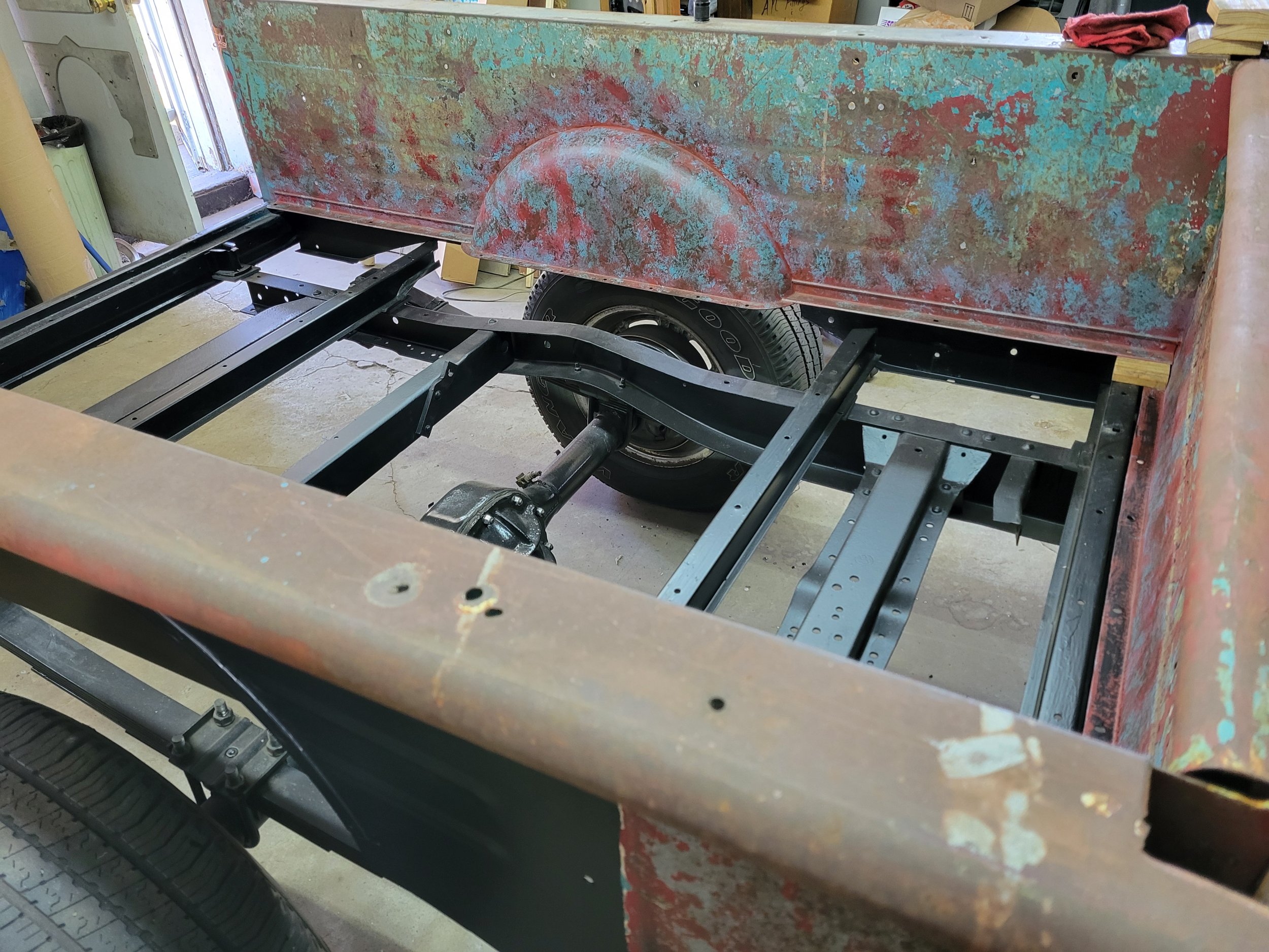

  11. I mocked up the new crossmembers that hold the box to frame to get an idea of how much they need trimmed backed do to the new wheel tubs.
    I used the wheel tub templates I had made before welding them in. Cut out with an exacto knife it fit over the end of the crossmember and made for a perfect pattern to trace.
    Lop it off
    And see how good a job you did

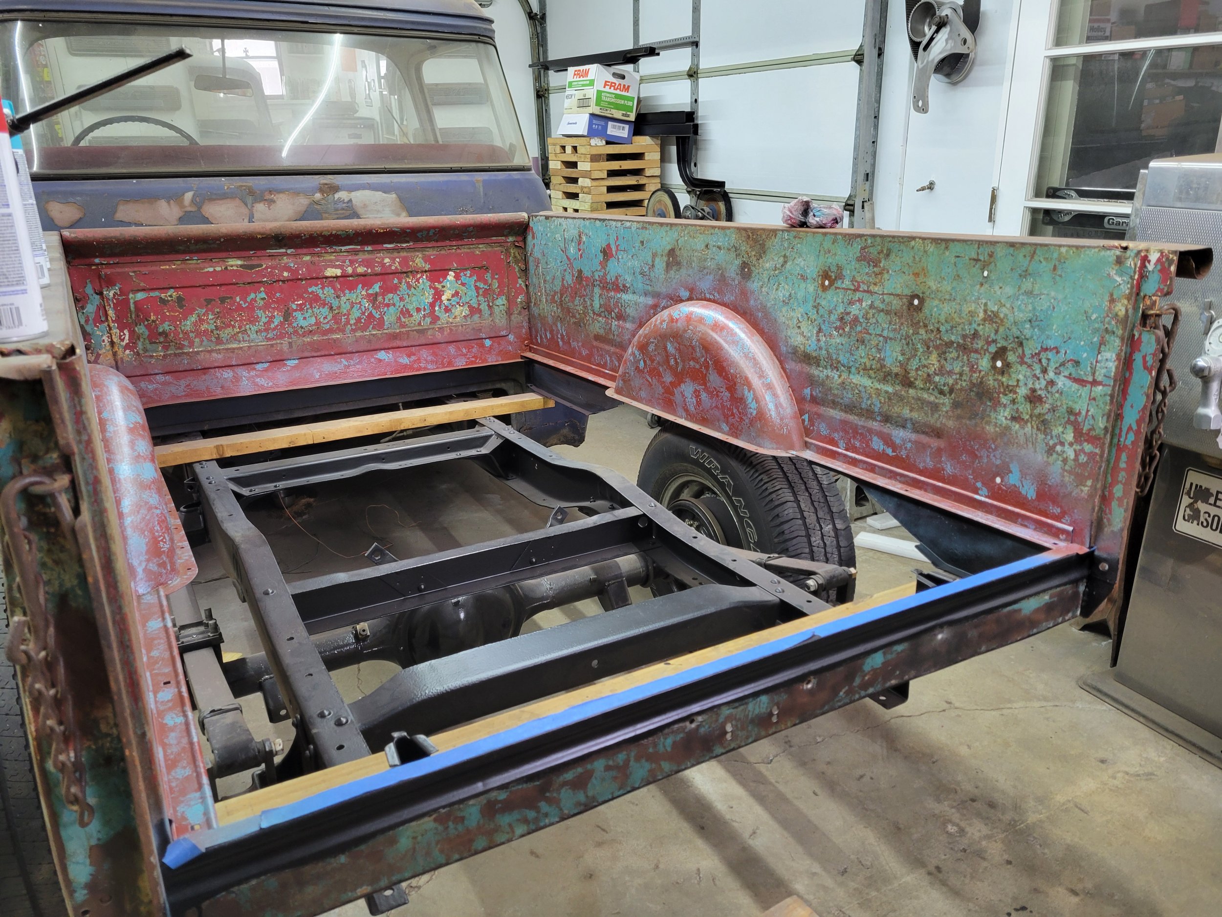

  12. I spent the afternoon making my bed so I could mark the cuts needed at the wheel tubs and holes drilled in the outer boards.
    It was kind of a pain in the ass to be honest with you, I squared the bed to frame, figured the bolts would just drop in the holes, nope.
    But in the end I got there

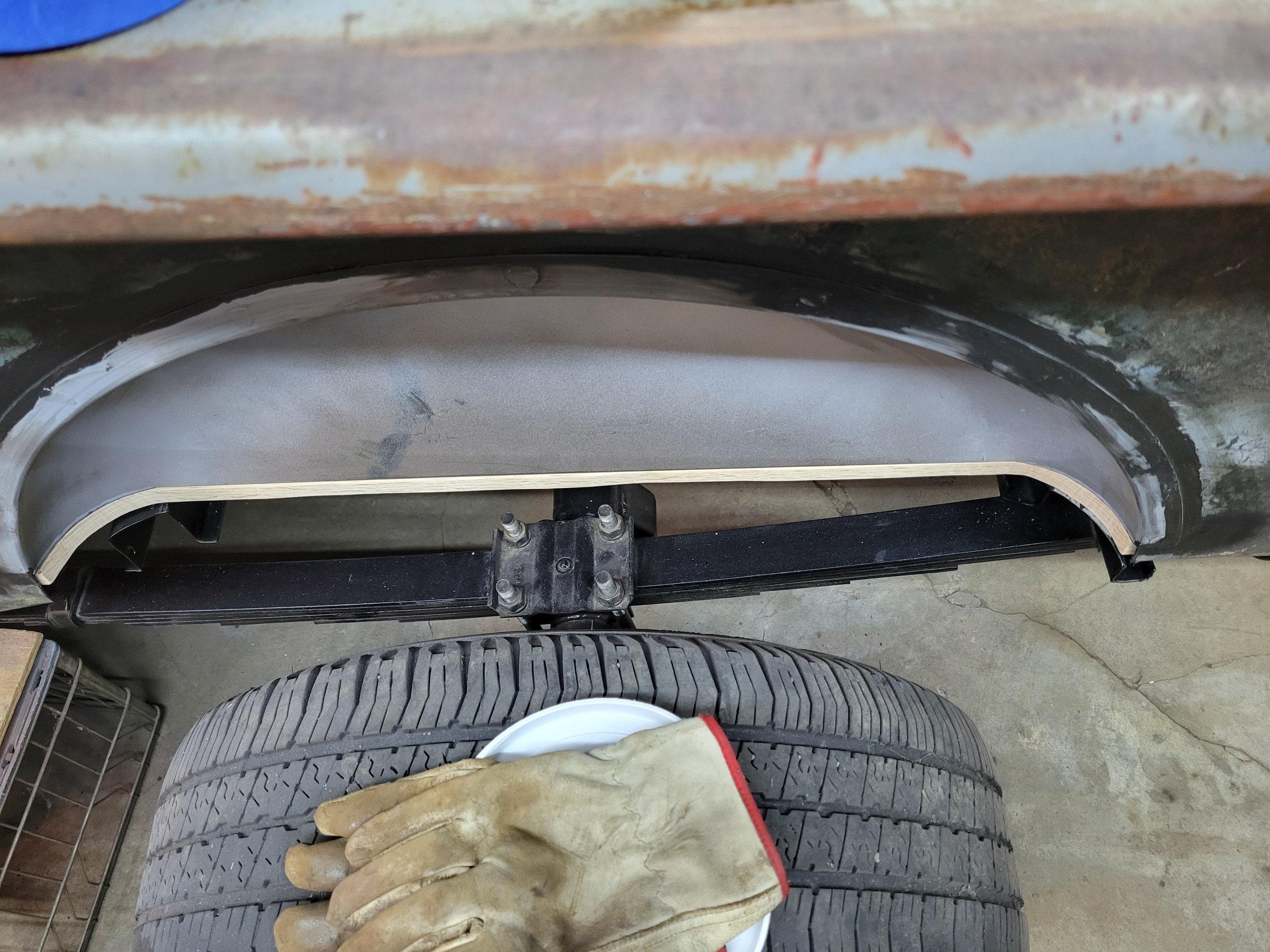

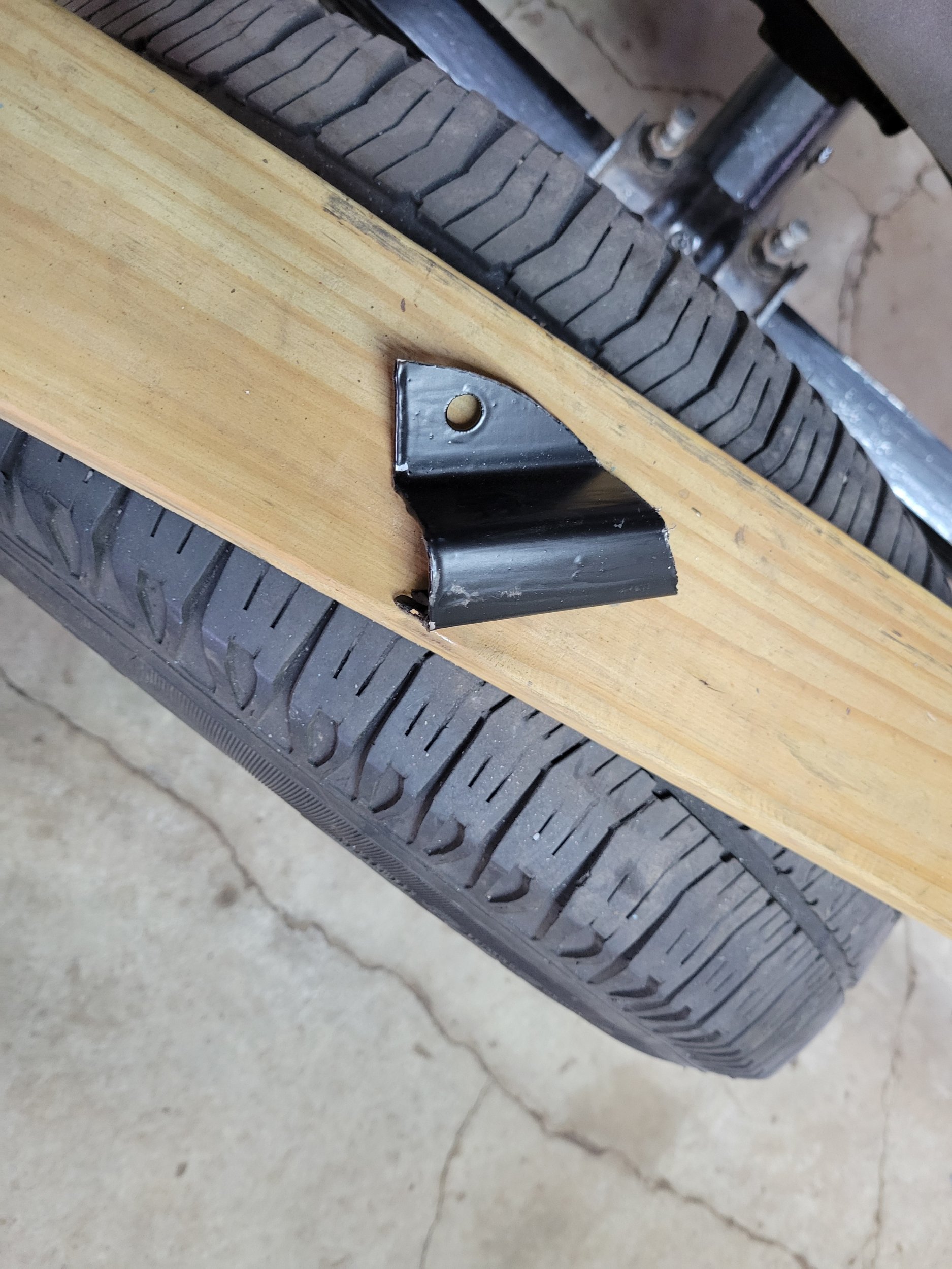

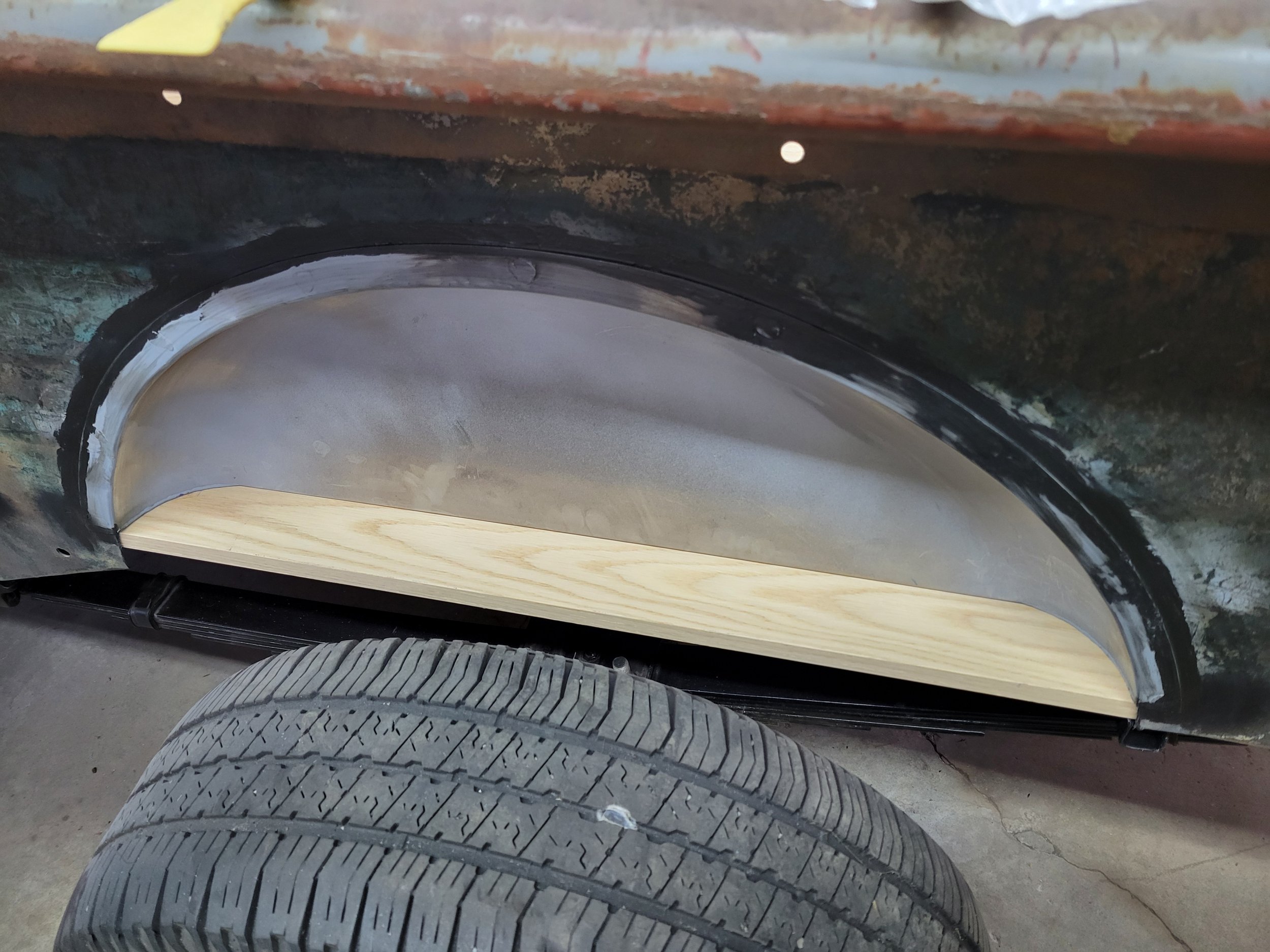

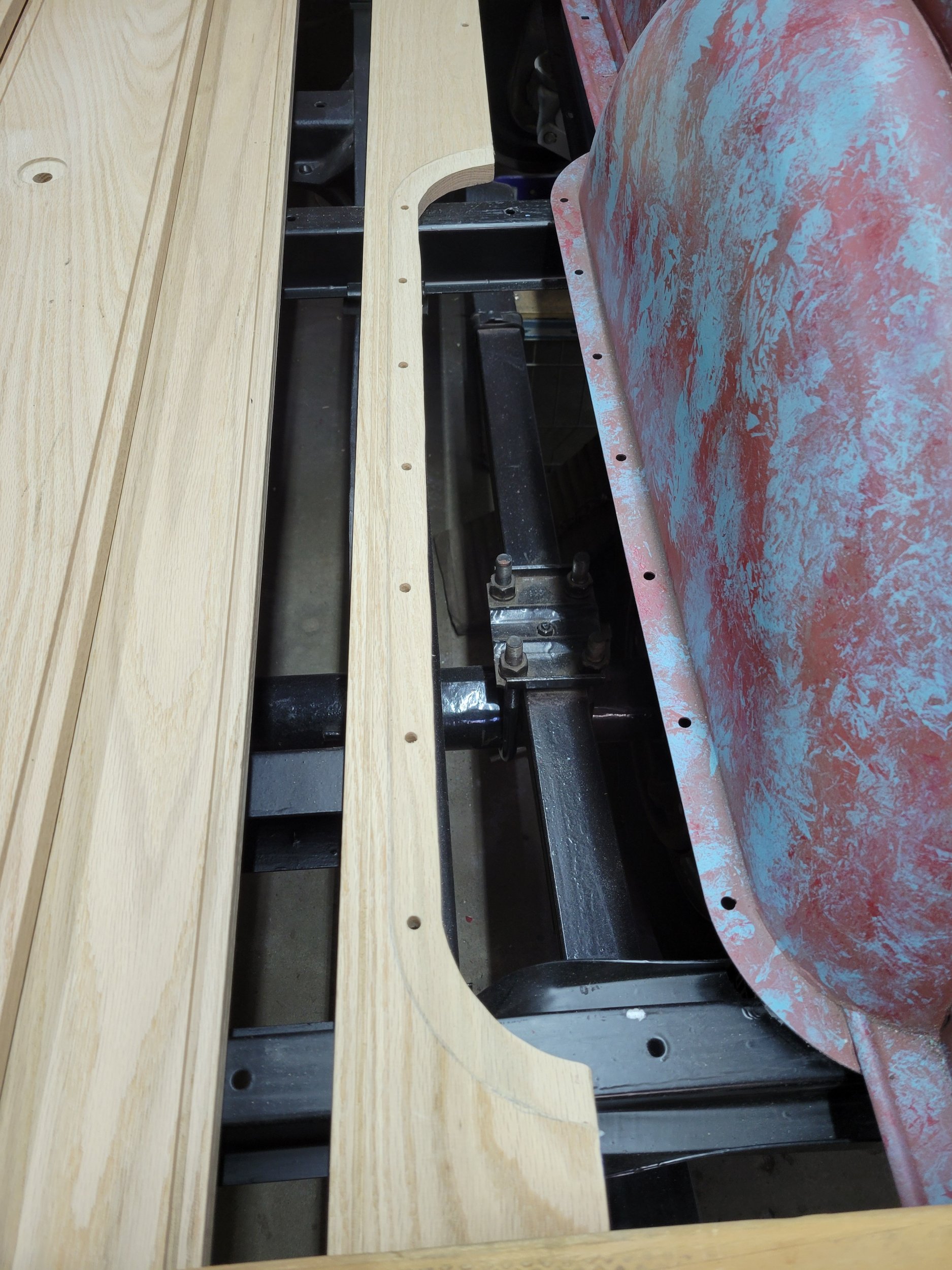

  17. Took it back apart this afternoon and cut and drilled the boards
    The holes even lined up
    Next step will be to recess the board so the wheel tub can sit down into it, leaving the angle strip flush on the surface

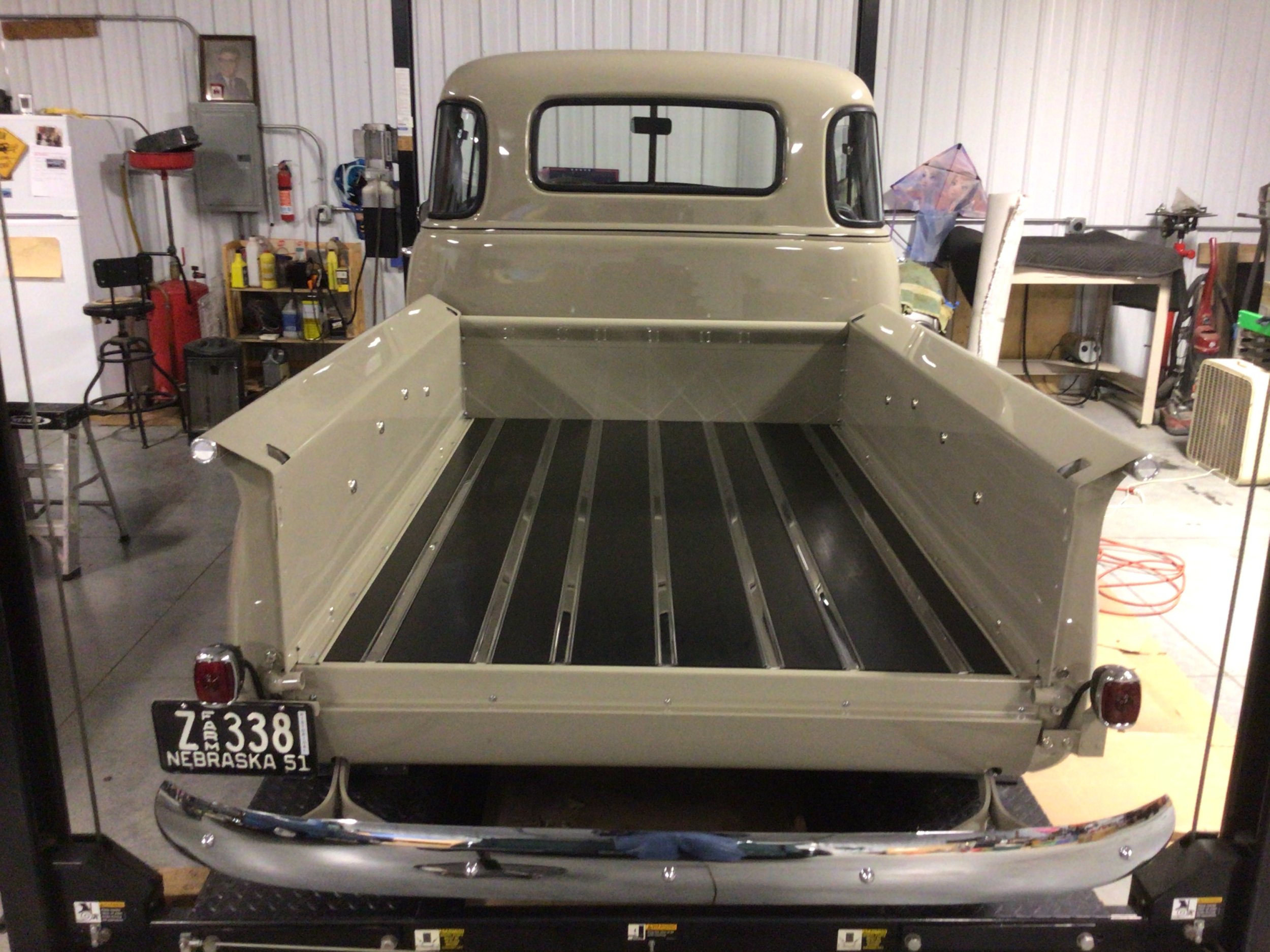

    rod1, Paul B, porkshop and 4 others like this.

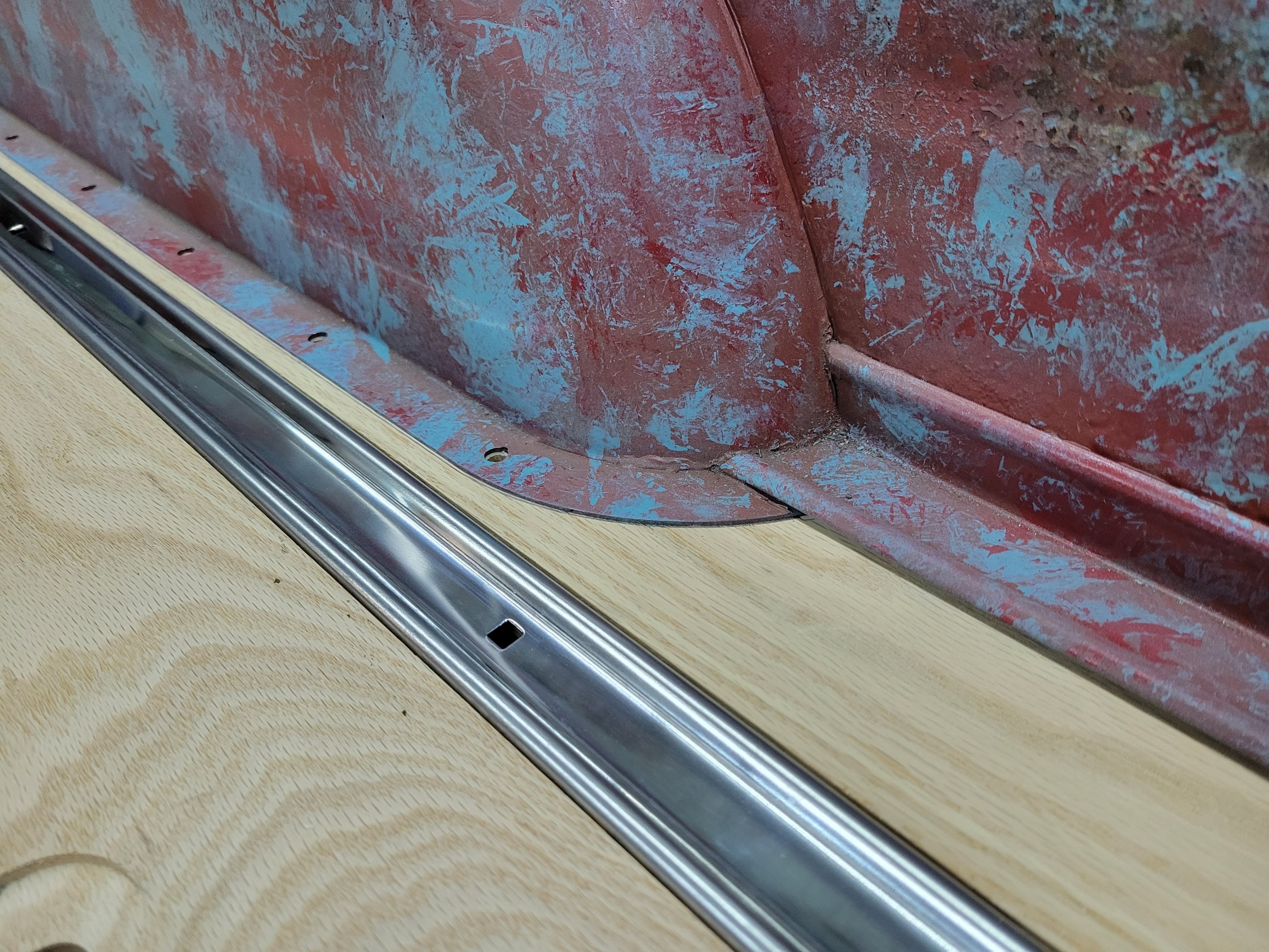

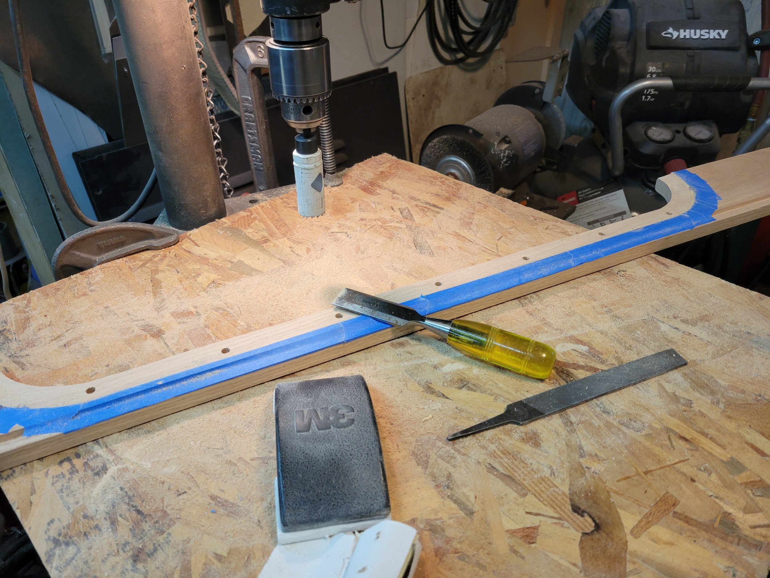

  23. I got the two planks recessed using the good ol drill press hole saw mill hack method, worked much better than doing it by hand that's for sure.
    All that's left for the boards are sanding and stain, but undecided if I should wait till more of the truck is together to pick a color or not.

    I was thinking you were going to use a grinder to recess them..turned out good. You and the hole saw are your own cnc machine

  27. I tried that first with a flap disc, then a cutoff wheel, then a regular grinding wheel, a sander, that yellow wood chisel.
    Then I smarted up lol

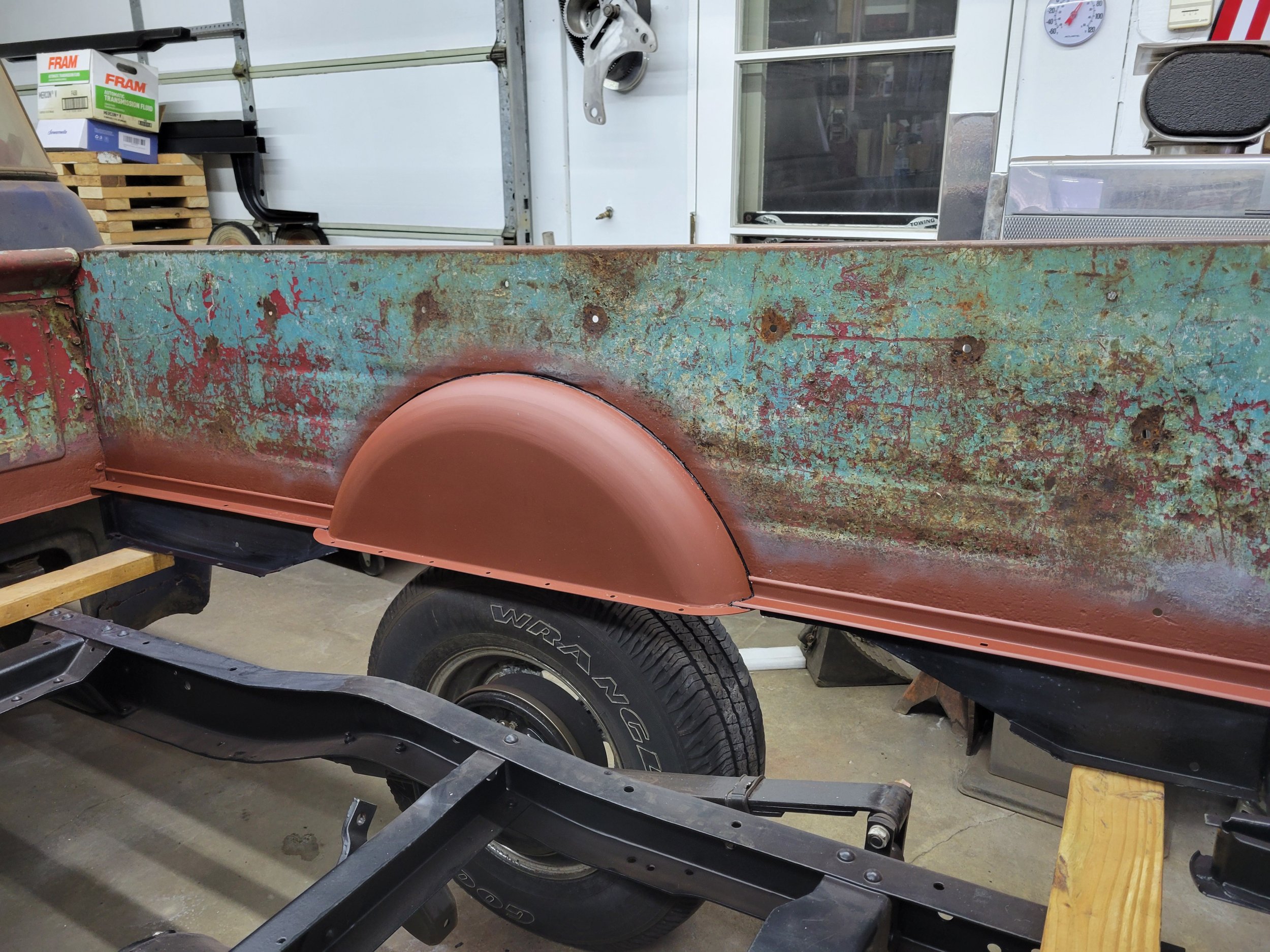

  29. Added some brown to my ugly fake patina, toned down the new colors a bit and kinda blends in better now
