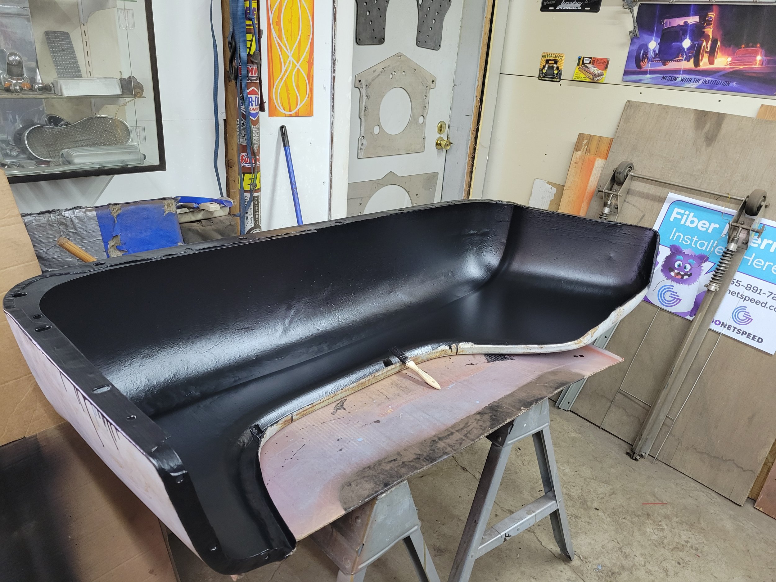

  1. Next I finished stripping the outside of the bed under the stepside fender areas and gave it a coat of Eastwood's rust encapsulator, followed by 2 coats of satin black.
    20250316_154023.jpg 20250318_124026.jpg 20250316_153650.jpg 20250318_124004.jpg

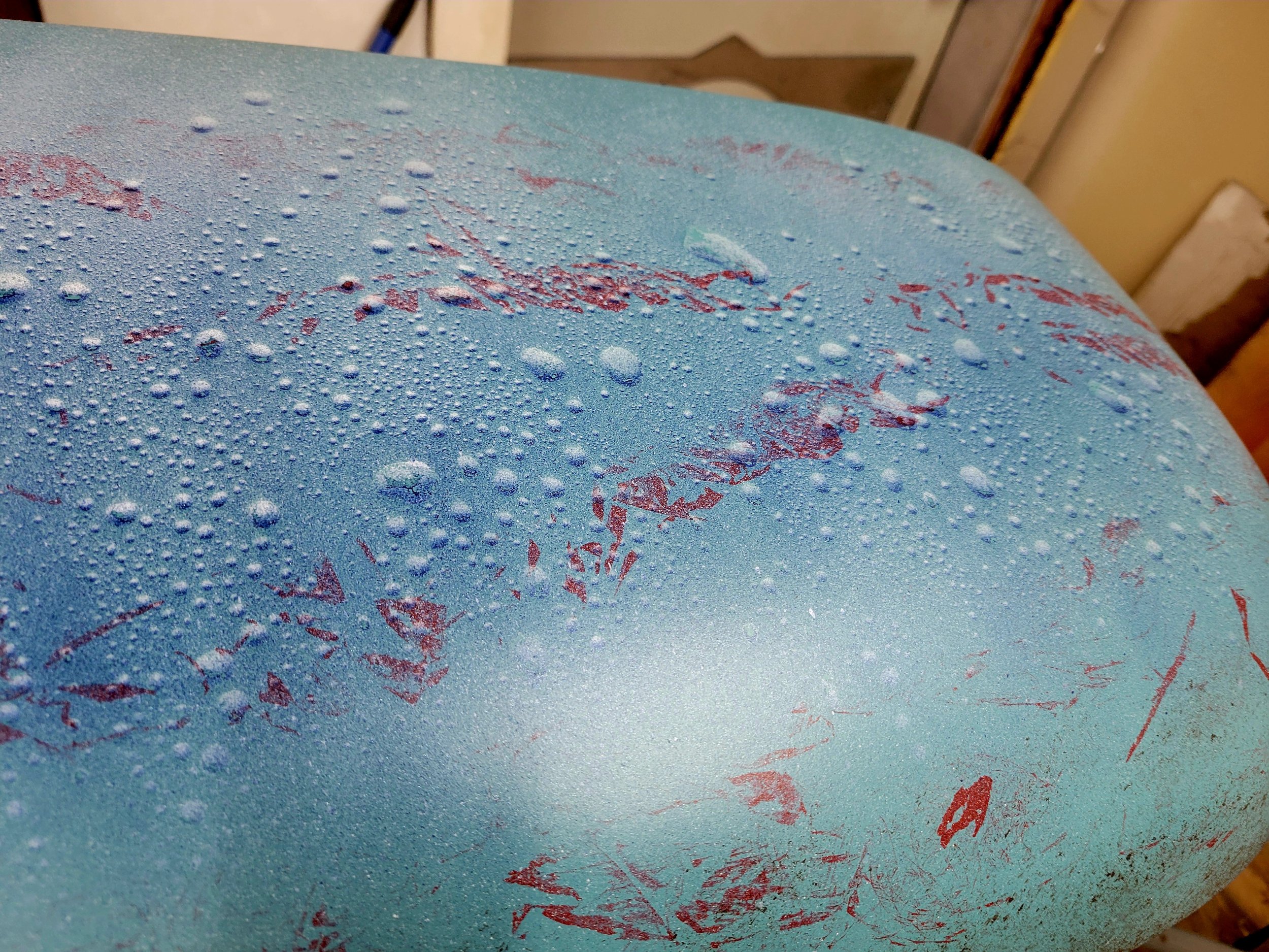

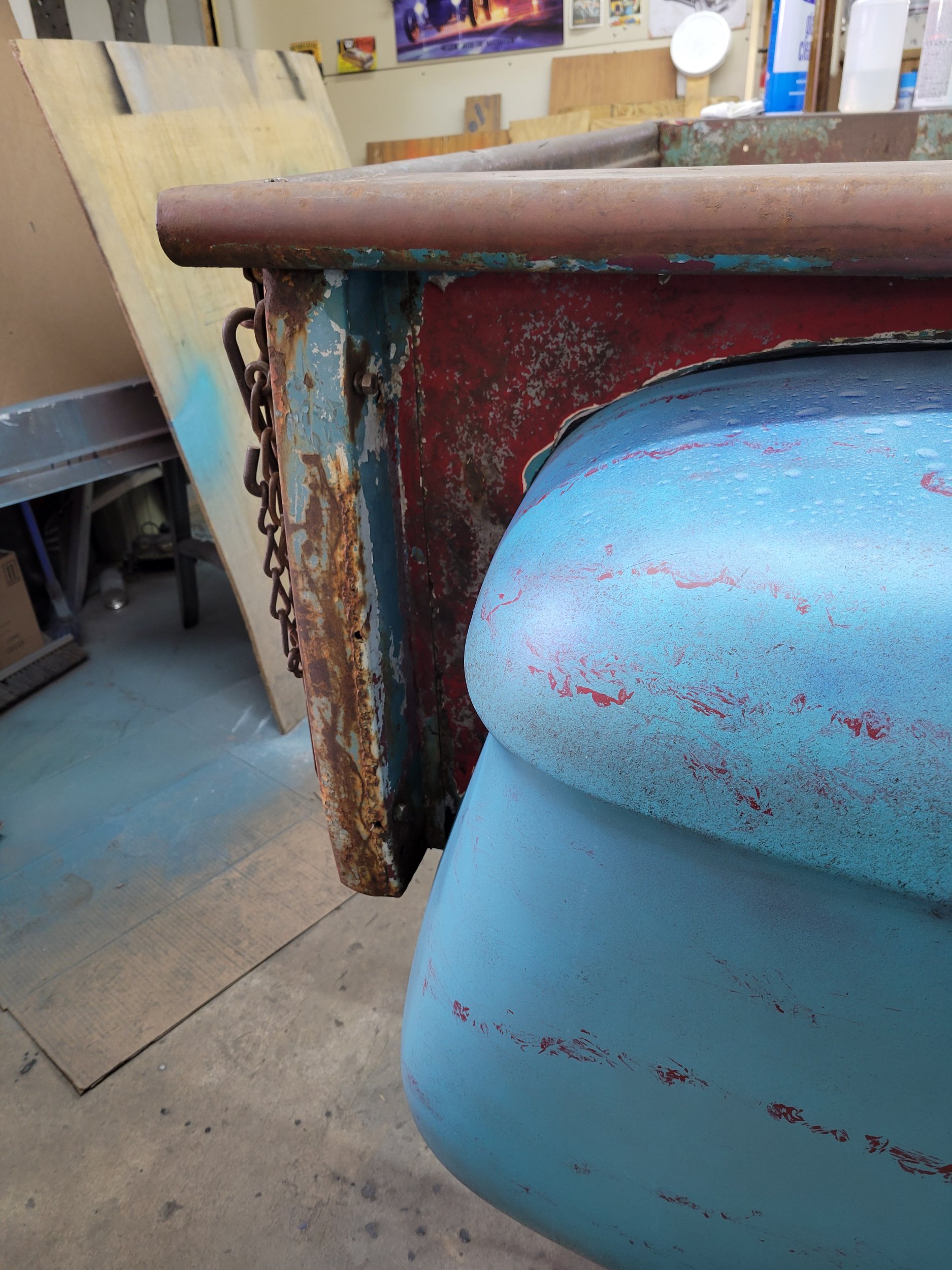

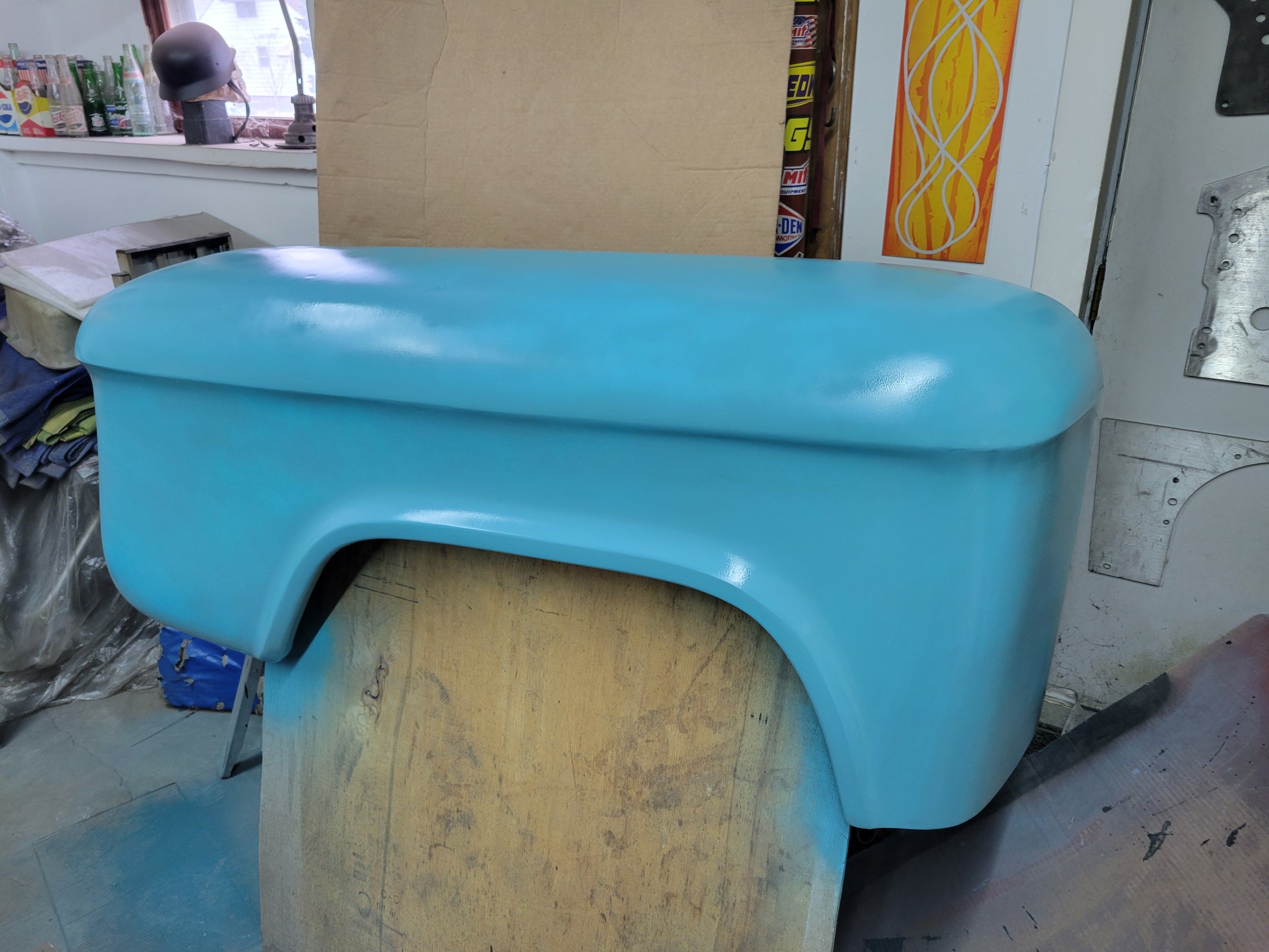

  6. I sanded out the rust on the outside of the fender and gave it a coat of rust encapsulator
    Then I rolled on 2 coats of primer
    Scuffed it with 320 then dug out the paint I used on the inside of the bed, I'm not to serious about this paint so I'm just going to have a bit of fun with it.
    First coat was that brighter turquois that was to bright.
    Then I fogged in that flat teal just like I was doing on the inside of the bed
    Next I sprayed the top red and tried to lift it with shrink wrap but I had let the teal dry to much so it didn't work. I grabbed the two cans of the turquois and gave it a cover coat, then sprayed the shrink wrap with the red and dabbed it around to put the distressed red in there.
    Then I gave the top and edges some "rust" using a brush, that actually turned out pretty good.
    20250411_184952.jpg 20250411_185041.jpg 20250411_163124.jpg 20250411_185025.jpg
    mad mikey, X-cpe, Okie Pete and 2 others like this.

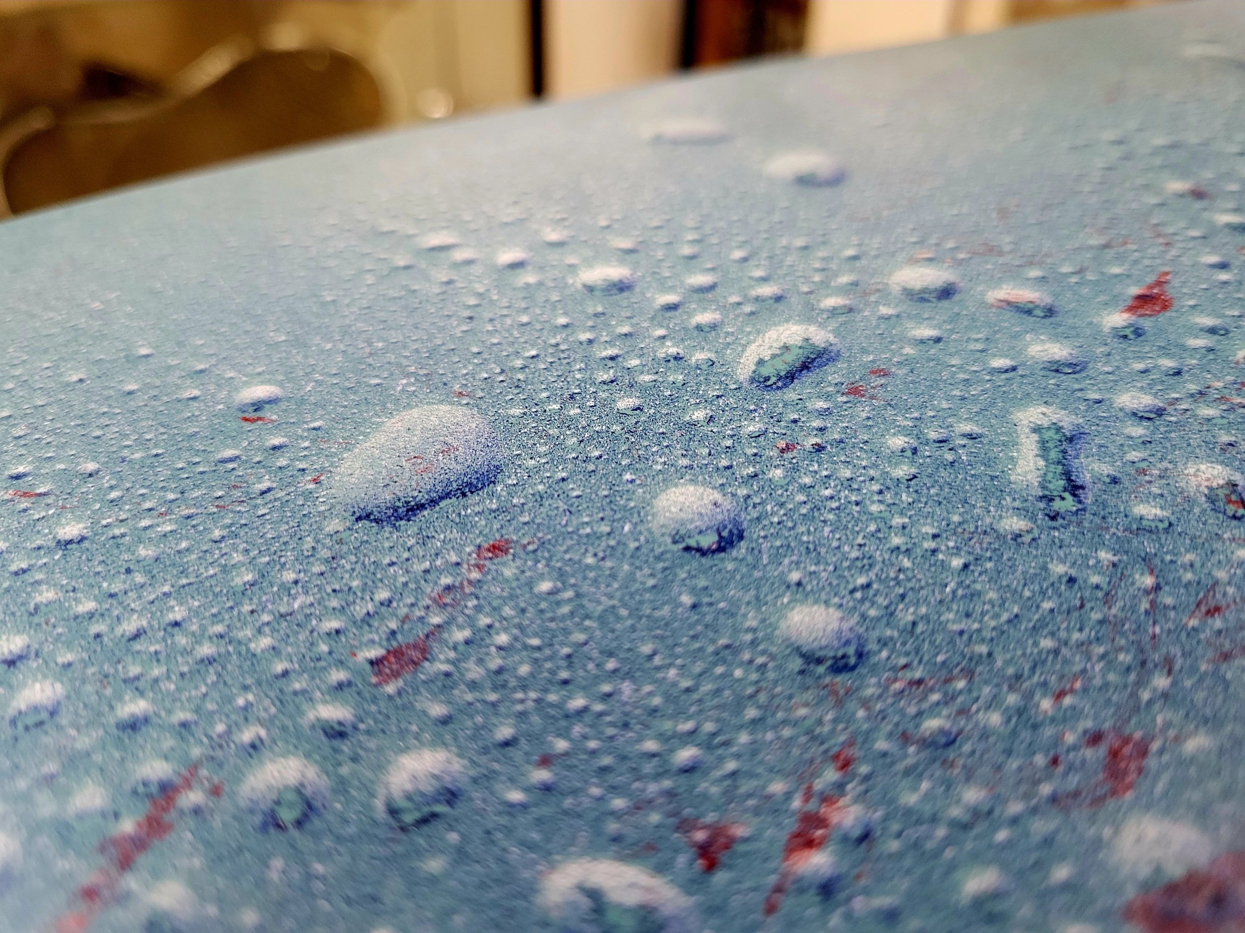

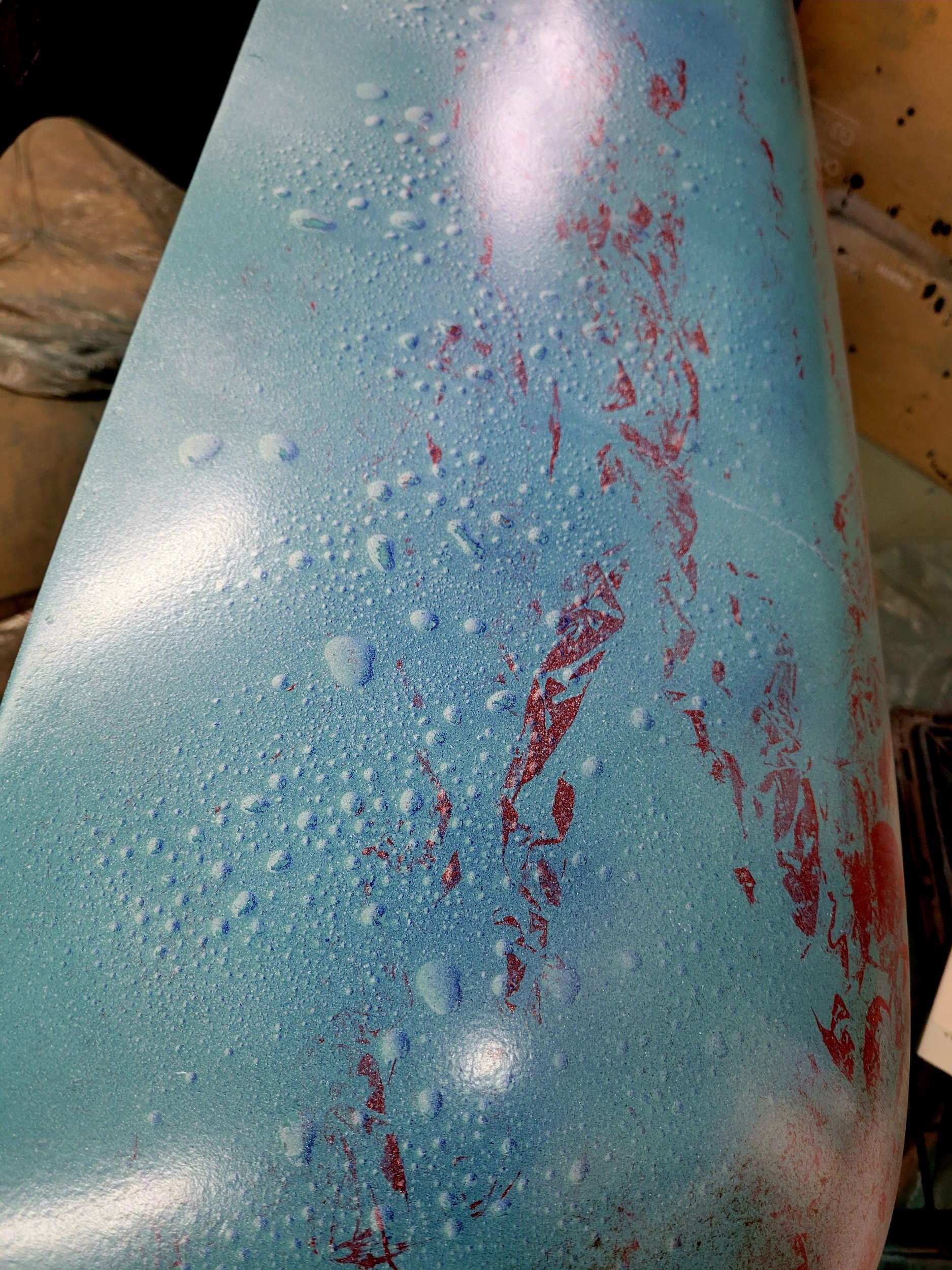

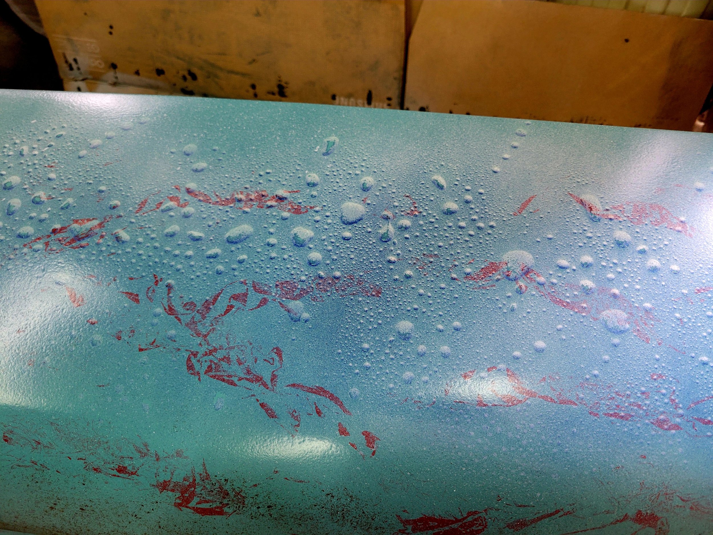

  7. Following the having fun theme I decided to try my hand at making water drops, rummaged the rattle can cupboard and found white and a dark metallic blue.
    I figured this might work since there was blue on the truck and I had it on hand. I did a test panel to see if I could even pull the effect off.
    I think it'll work, just need bigger water drops, I liked the outcome so well that I gave it a coat of flat clear to protect it.
    It actually kinda blends in to the bed sides and looks more 3D in person than on film
    mad mikey, Okie Pete, pila38 and 2 others like this.

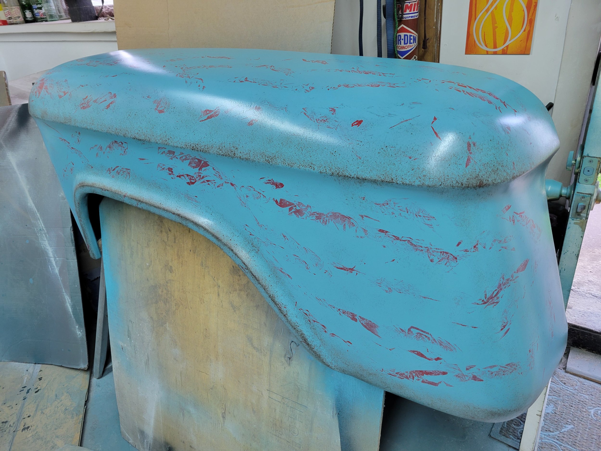

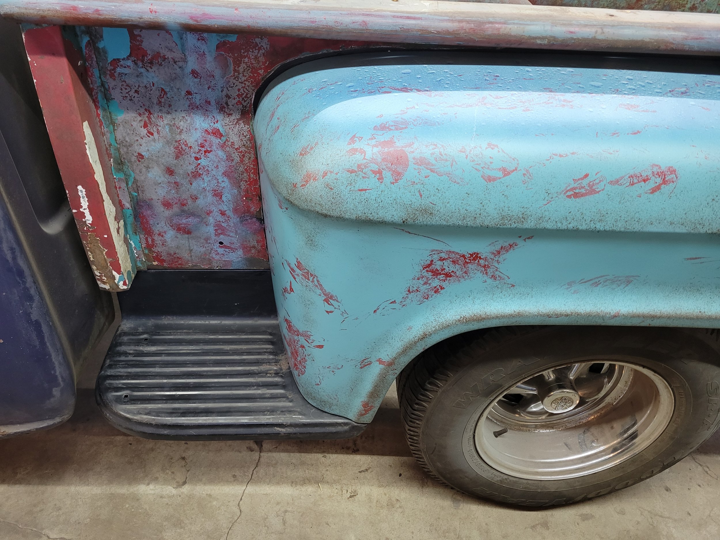

  11. Started the process on the other fender
    same thing with sanding the rust bleed out then using the rust converter on it, then 2 coats of primer with the roller
  12. First coat of color is "satin seaside"
    2nd coat of color is "satin teal"
    Then added the red and dark brown for the "rust" around the edges
  13. Fender #2 is done

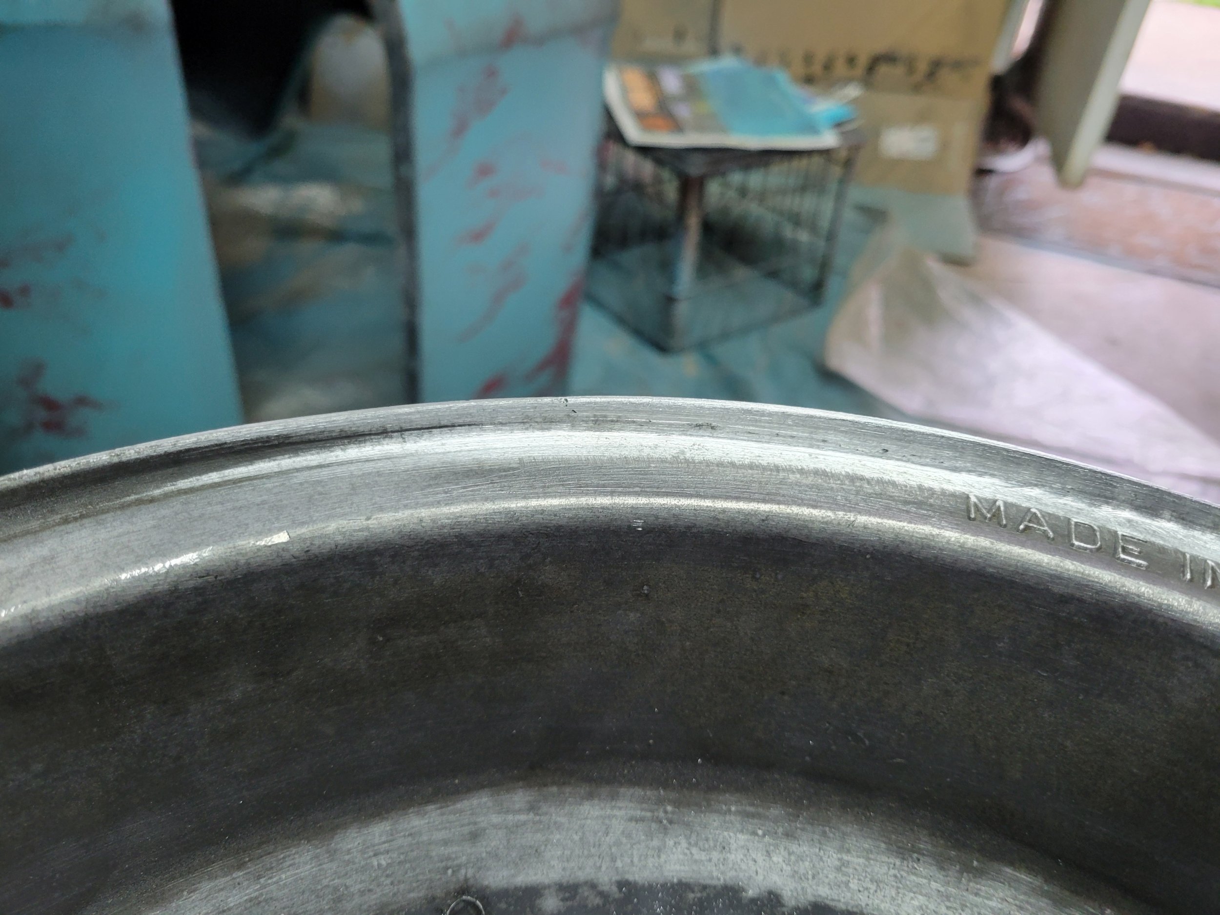

  20. I bought some 15x8.5 ET slots as a partner for those 15x8.5 Ansen Top Eliminators, I do have a few different pairs of skinny slots I can use up front to match up with them.
    They arrived today and both rims got damaged in shipping by the gorillas at FedEx, bastards.
    20250502_102400.jpg 20250502_102838.jpg 20250502_103429.jpg 20250502_124245.jpg
    mad mikey and loudbang like this.
  21. Got the rims welded up, he did a great job on that, more than pleased with the outcome
    20250505_181410.jpg 20250505_181457.jpg 20250505_181616.jpg 20250505_181547.jpg

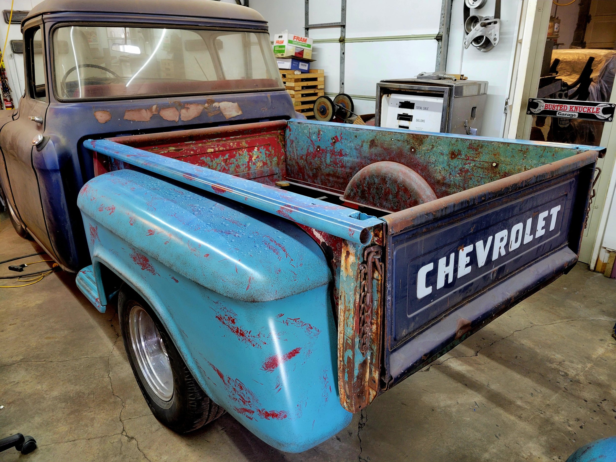

  24. Got the top rails painted

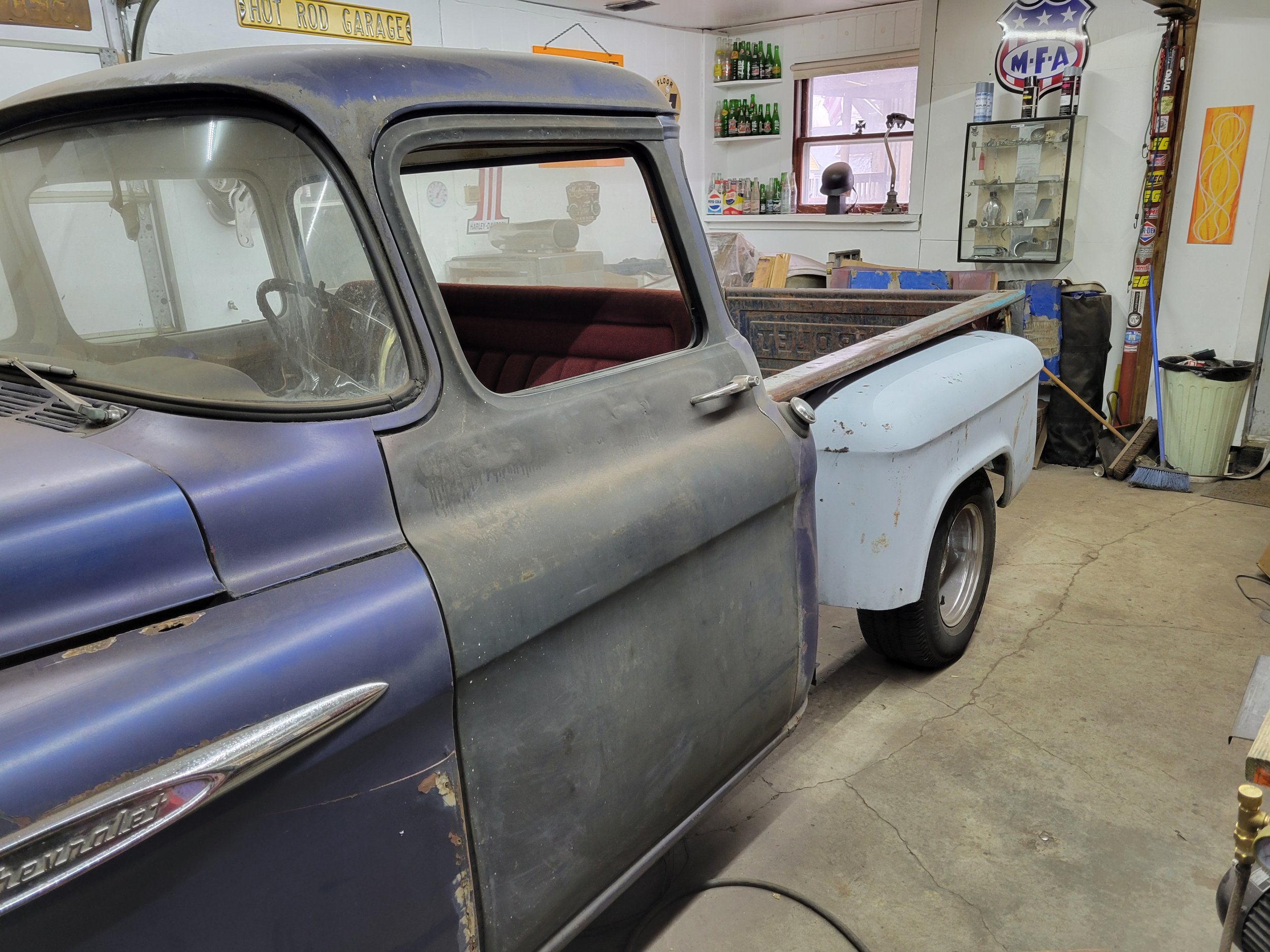

    And mocked it all up together for the first time

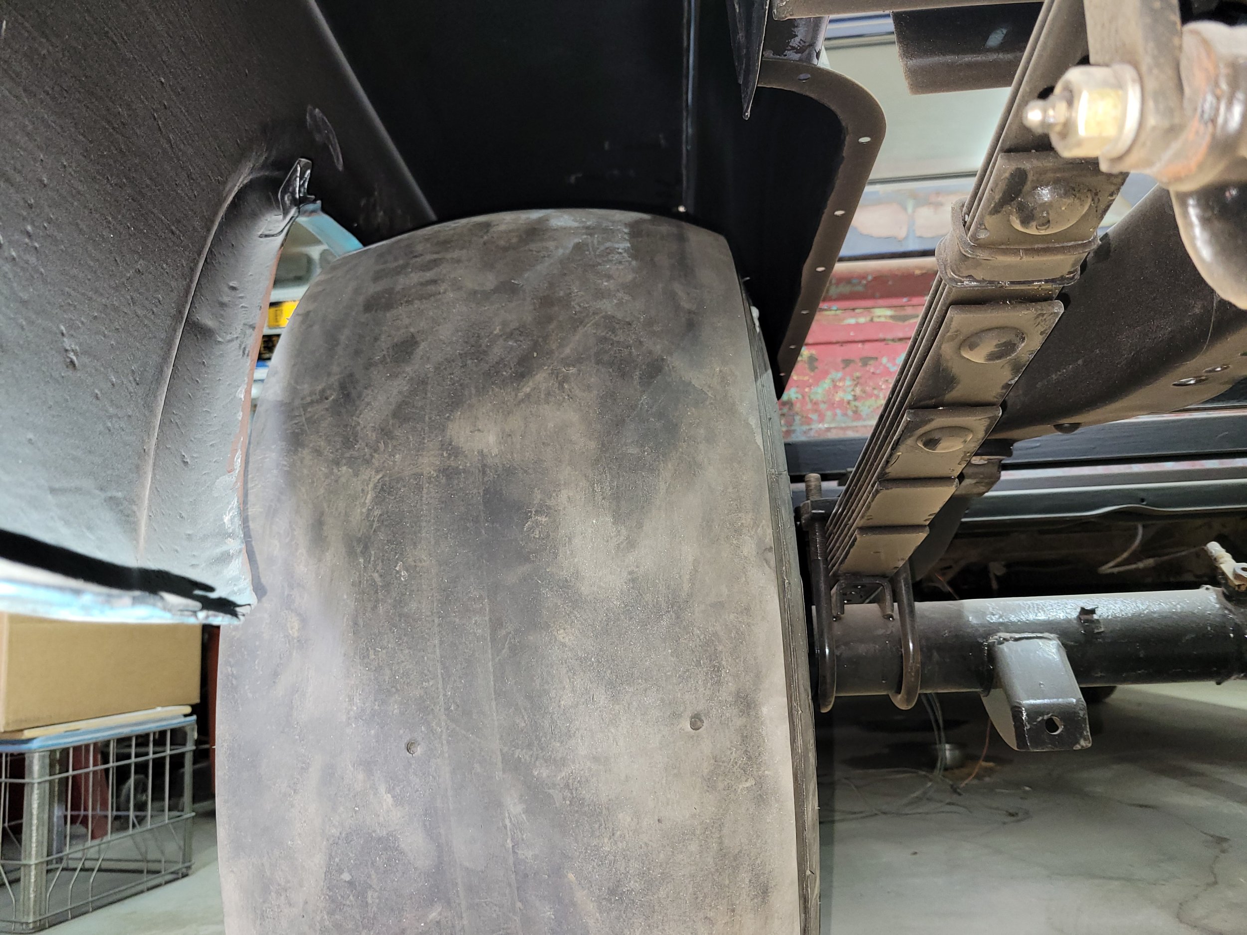

  26. Big bolognies don't fit
    My Hoosier tire dealer friend thought he had some 29x10 or 10.5 takeoffs I could use for a size test fit on the 15x8.5 ET slots. But he had 9 wide or these 29.5x11.5 which have a 13.5 sidewall width, they had 1.75 clearance on the backside but no clearance on the front.
    I think I'll try and find some 31x10.5 all season truck tires and see how those fit.

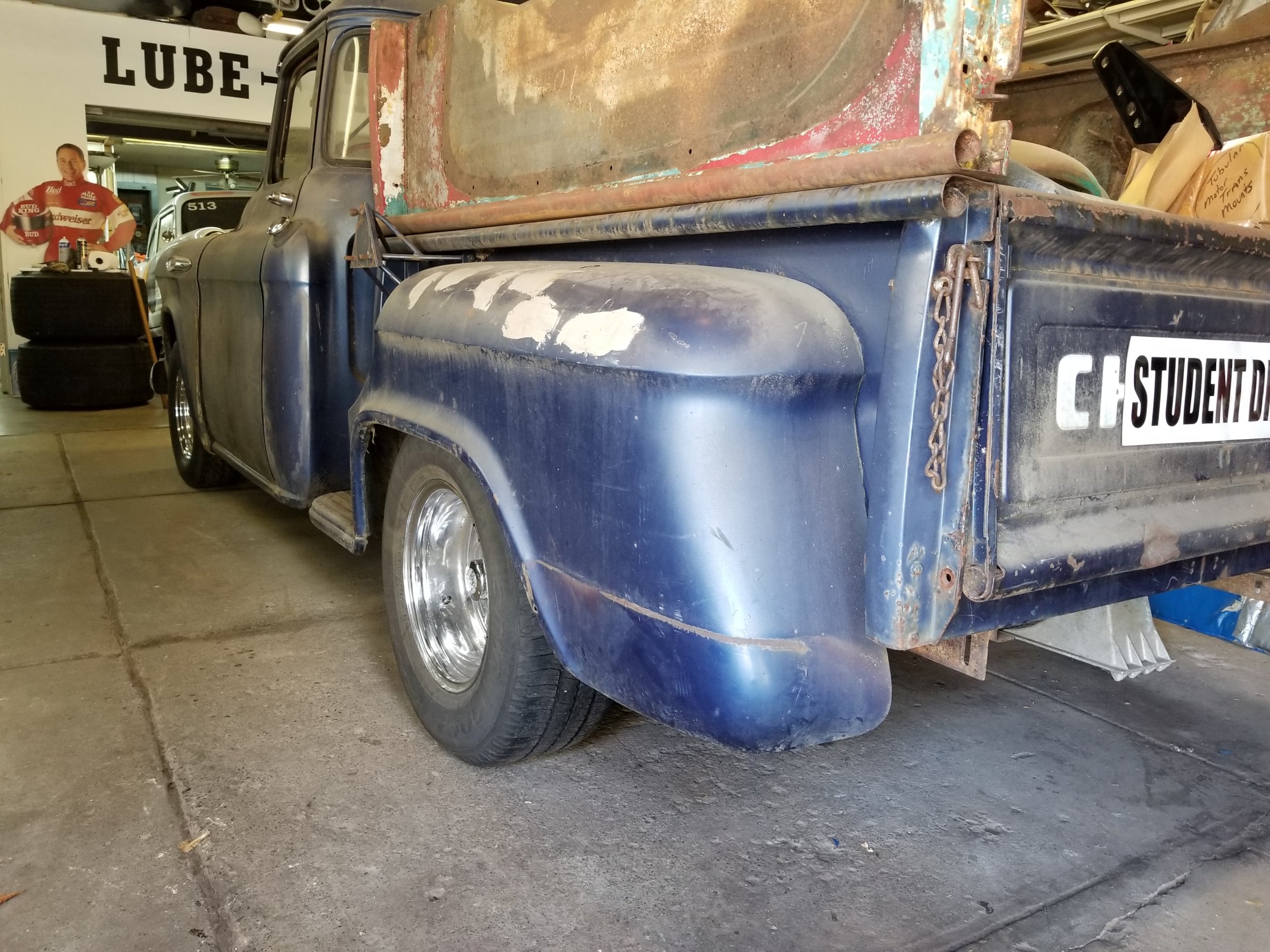

  29. I think the 235/75/15 is perfect for the stock wheelwell, just enough room on either side
    With my particular rear end that's 4 inches narrower than stock it took a 15x8 wheel with 1.5 inch backspace to put it centered in the hole. Since I plan on hauling stuff and don't want to be married to that rim I added the mini tubs to more center the wheel mounting surface of the rear inside a new wheelwell space.
    I like my vintage rims which often don't allow the optimum backspace but I've got a good starting point to figure it out.

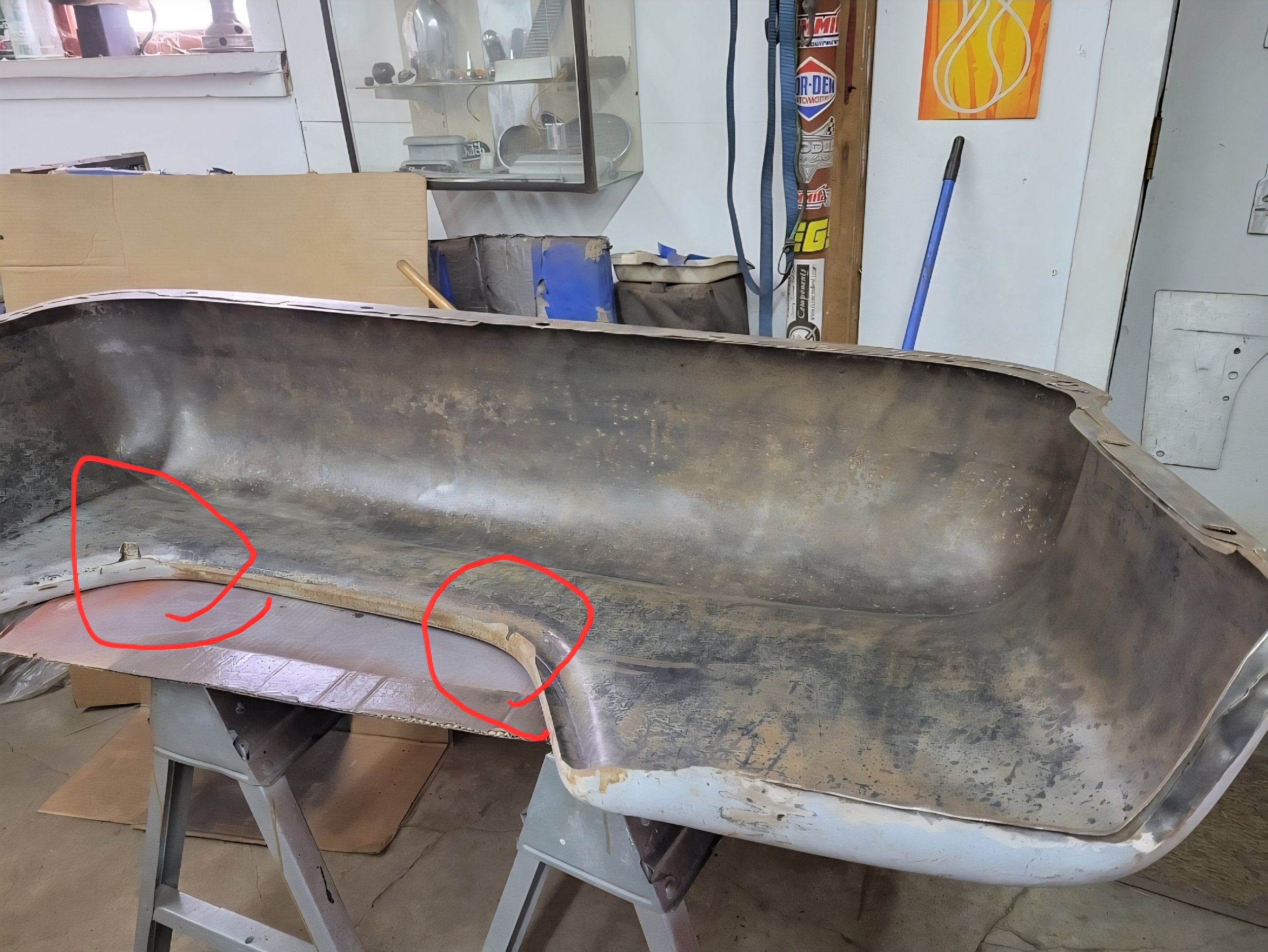

  30. Between the 2 beds I came up with enough fender braces so I got them stripped and Por-15 primered, followed by satin black
    I kinda forgot that the one fender had the brace attachment point ripped out
    So I cut it from the old blue fender and welded it into the newly painted fender
