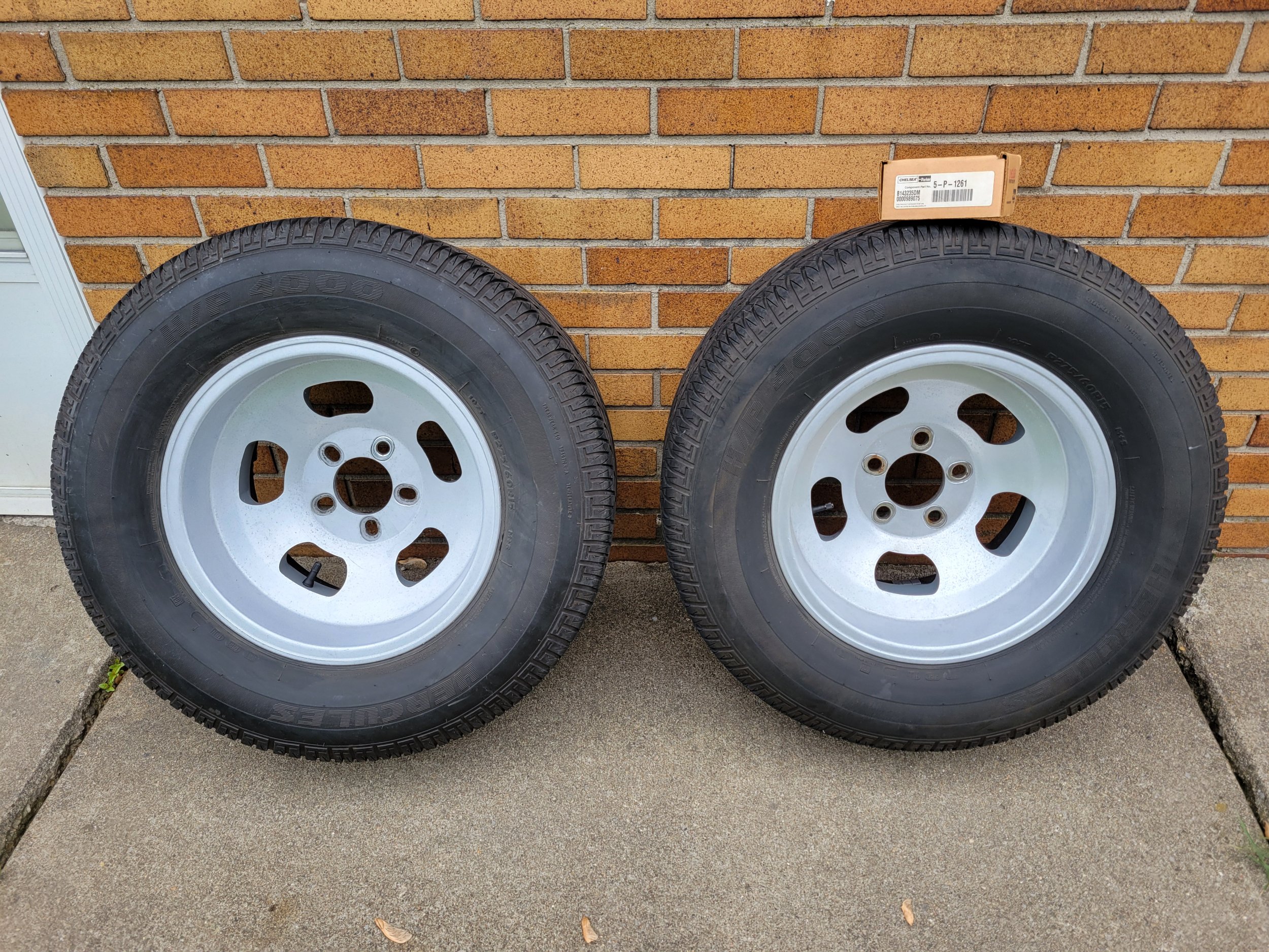

    I was having no luck finding any used 31x10.5's to try out but I did run into a friend at a cruise night that was changing rims on his ride.
    He happened to have the same exact rims I had just bought (of course) with 275/60/15's. He shot me a decent price so I bought the rears, fronts were 15x7.5 and I had no use for those.
    I wanted just a little taller tire to tuck the top of the tire behind the fender lip but these actually worked out pretty good.
    20250601_165219.jpg 20250601_165001.jpg 20250601_165036.jpg 20250601_171236.jpg

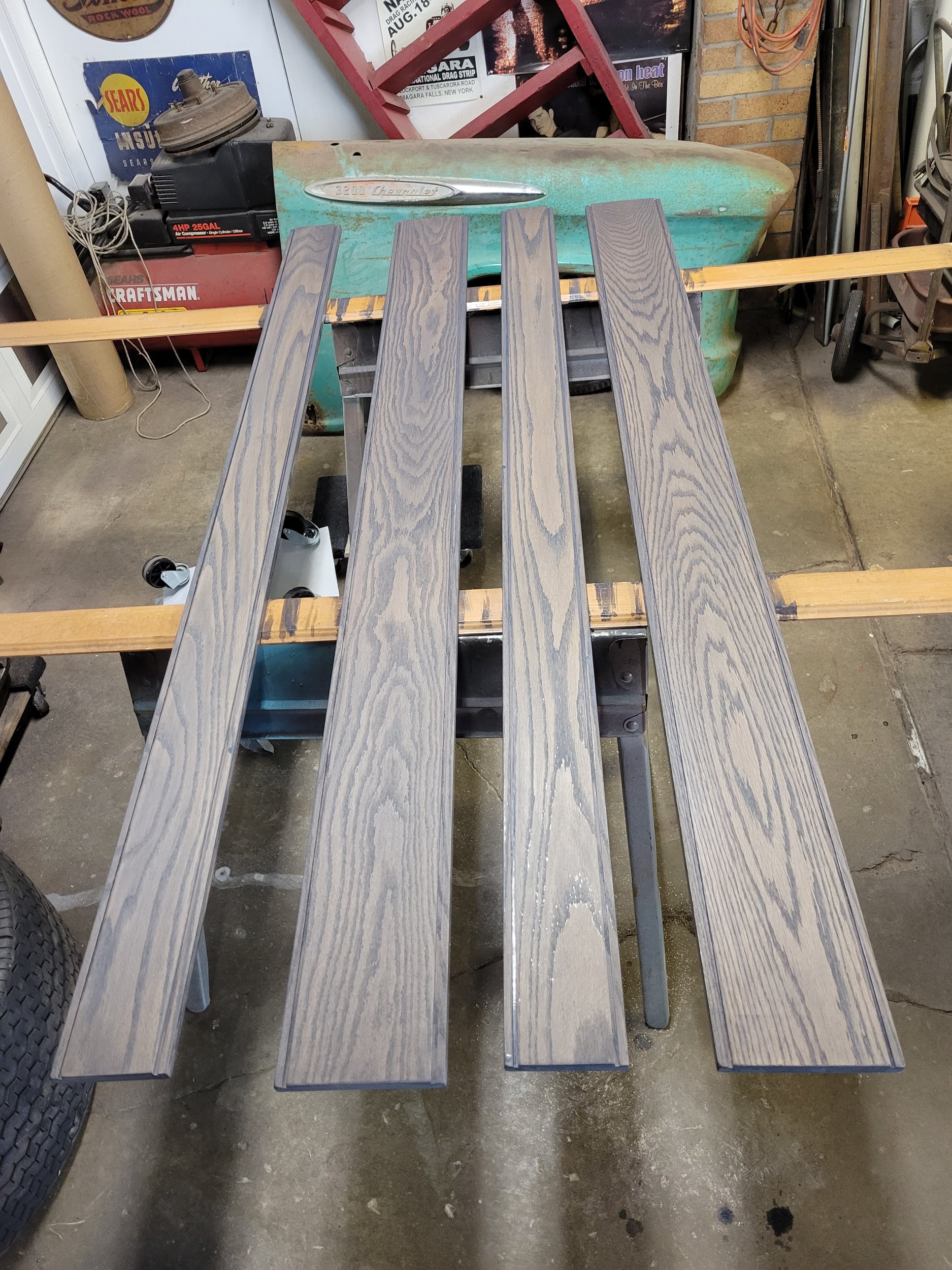

    Sanded all the boards with 220
    I started on the bottom of the boards to practice and to test how long to leave the stain on before wiping it off.
    20 minutes far left board, around 12 on far right.
    Next 4 boards I let the stain sit for 10 minutes, looking better
    Practice is over, time to do the tops, I let the stain sit for 5 minutes and like it.
    Some weird little shiny spots showed up in certain angles of light, they would disappear once wiped over with the stain rag but would return a few minutes later.
    Tomorrow I'm starting the urethane regardless of those weirdos.

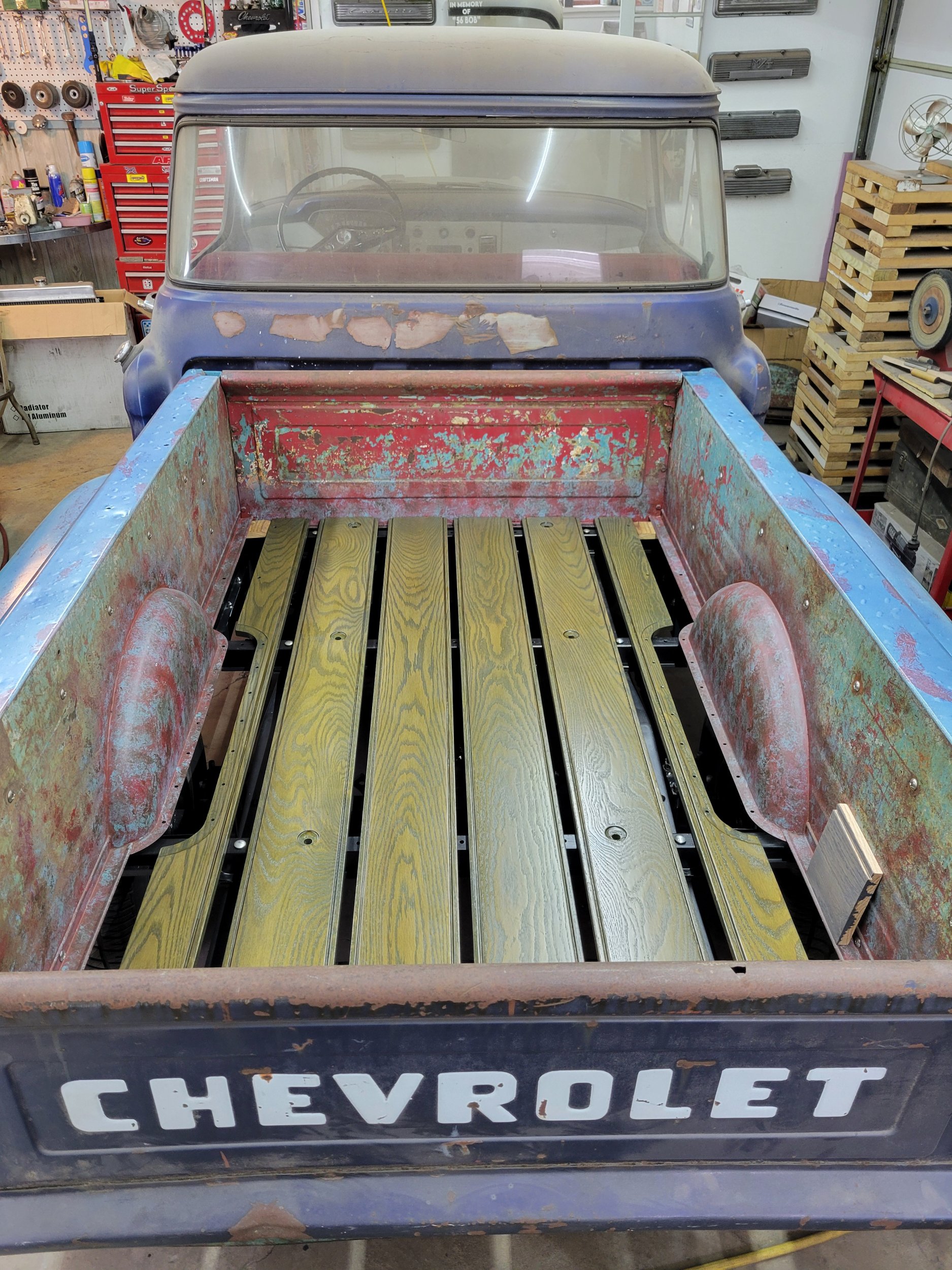

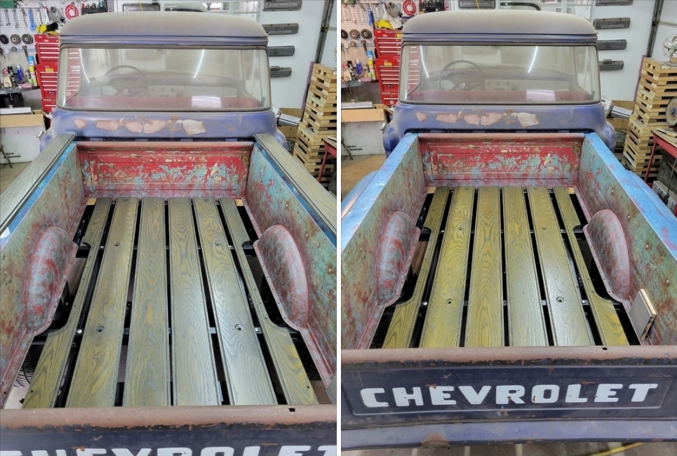

    Laid some of the boards in the bed to see how it goes with the paint or lack of and it just looks green/yellow/brown, if the truck was olive drab then it might look OK.

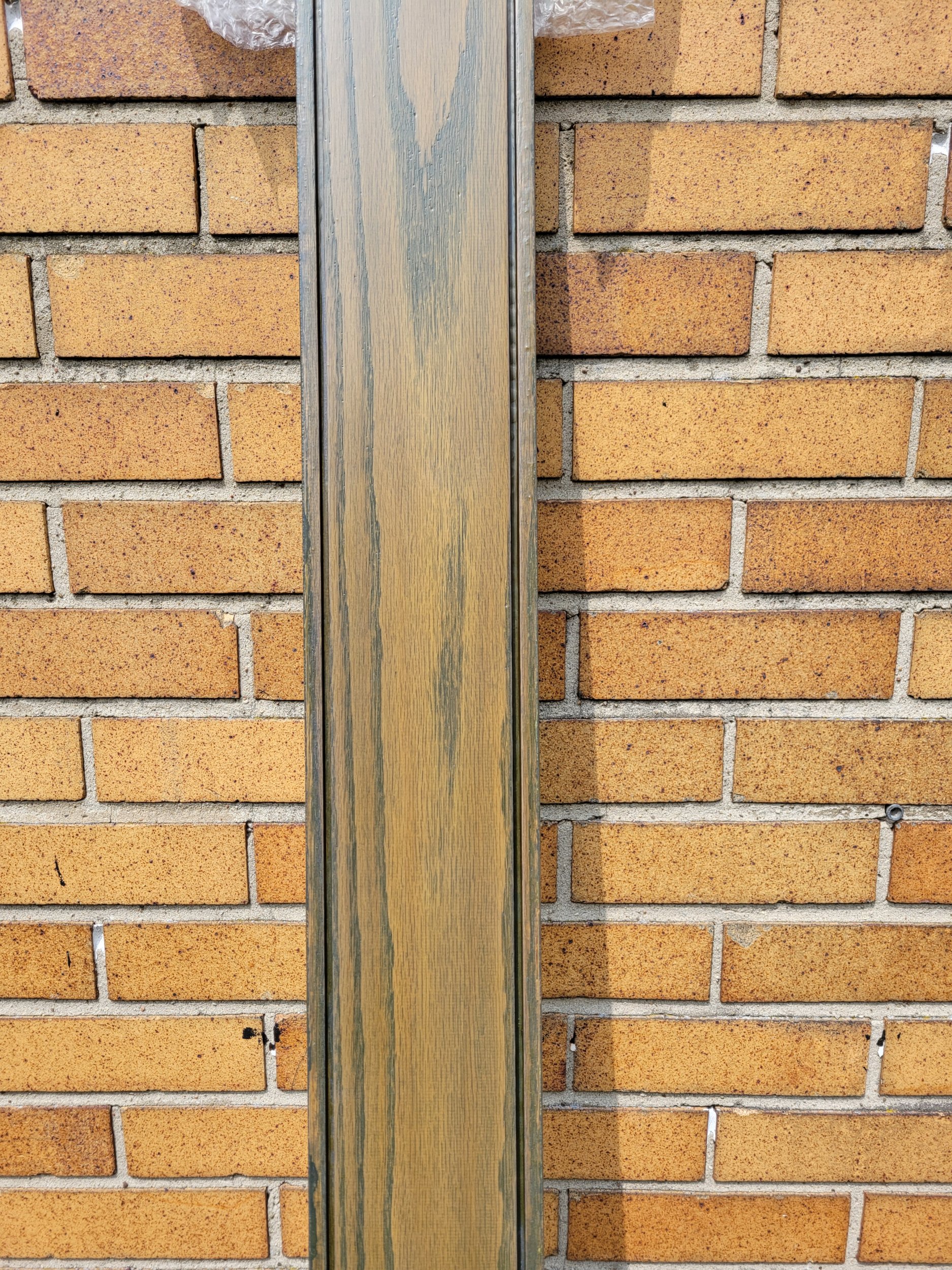

    I thought maybe the l.e.d. lights might be effecting the color so I took a board outside, looks more brown and less green.
    rod1, guthriesmith and Johnny Gee like this.

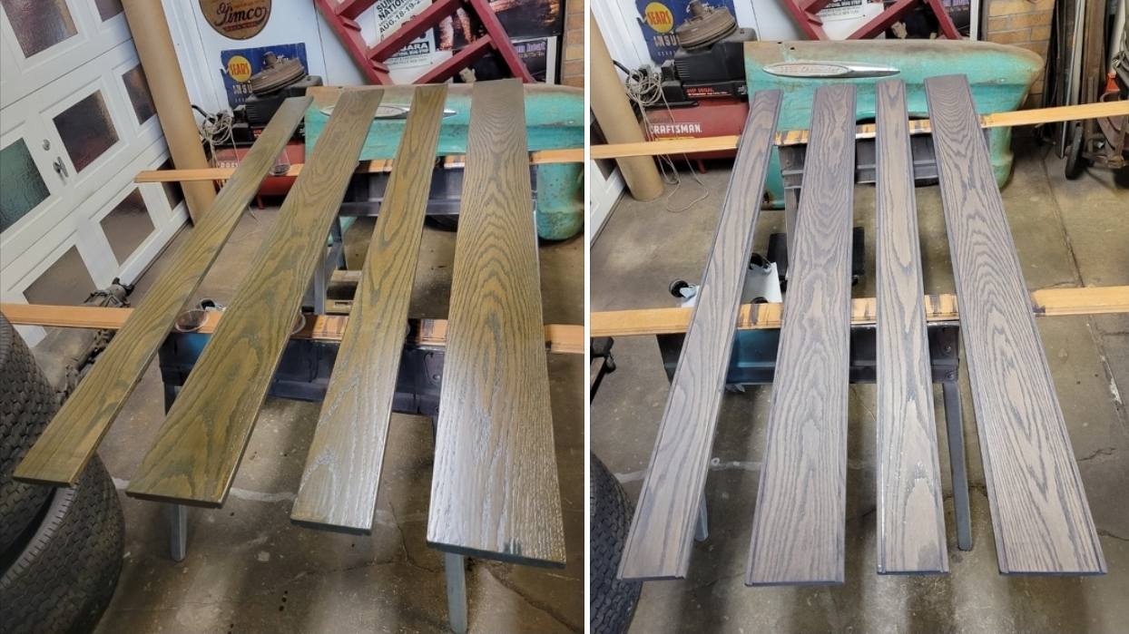

    Then I decided to try some of the gray stain on the underside of the board to see if it did anything. At first I didn't see much of a difference, took it and another board outside for a side by side comparison, again I didn't see a drastic change.
    Took it back inside and laid it over a couple of the other boards and it looked a little better.
    So the next thing ya know I'm staining the tops of the boards
    Still no where what I wanted but it's better
    And a little side by side comparo of before and after

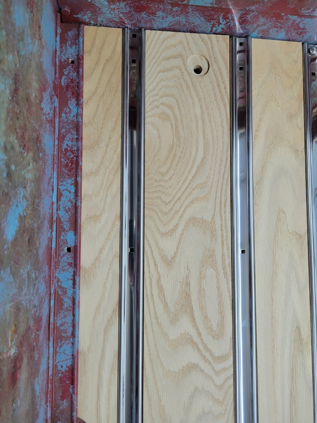

    Mocked up the wood and stainless, the cross braces under the wood line up with the wood and the holes in the frame but DON'T line up with the stainless strips.
    They're off enough that the bolt has to go in at an angle and of course the carriage head won't sit flush. I'm going to see if I can draw them in, if not I'm going to have to open the holes up and hopefully the nut doesn't jam up against the side.
