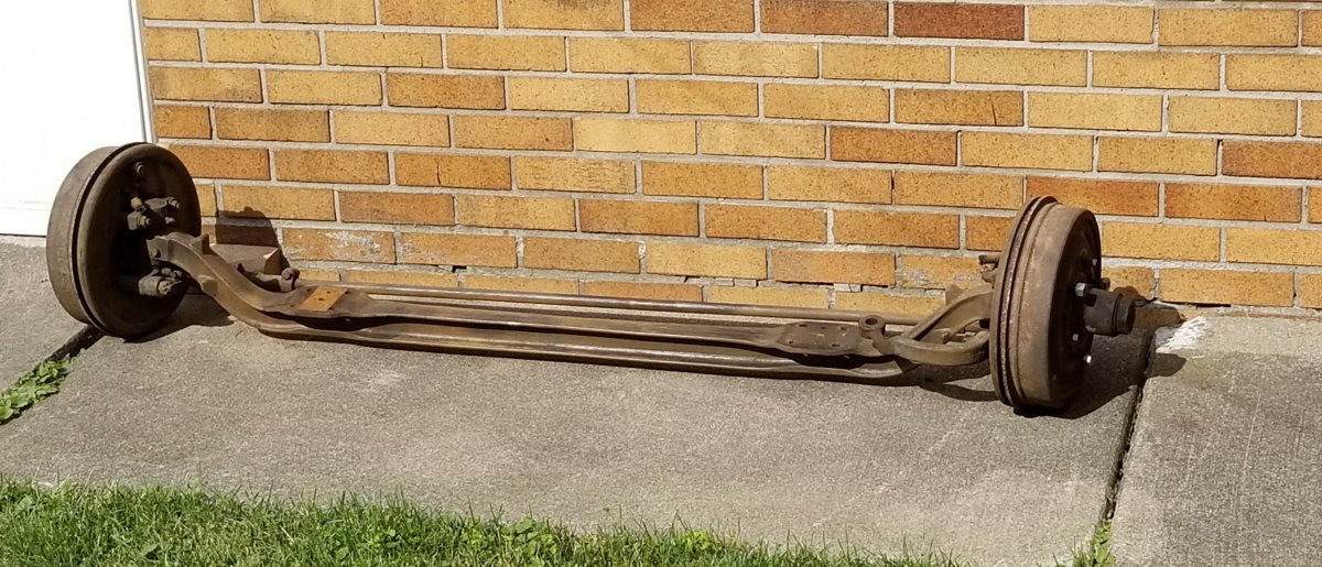

  16. You know the old saying "idle hands are the devil's workshop" so let's pull the whole freaking axle out and clean that up too, so much for only cleaning the attachment points. Once again nuts came loose and brake lines had fluid still in them, so not to bad other than manhandling it out from under the truck.
    Next day I took a wire brush by hand and started knocking the 62 yr old crud loose.
    Today I broke out the power tools and went through 4-5 wire wheels and cups, not something you should do in shorts, those pieces of wire really stick in ya.
    Tomorrow I'll try and get into the nooks and crannies I couldn't reach, really don't want to disassemble the axle but you remember the first part of this update and how this stuff gets out of hand..ha ha ha

  17. Clean enough for Rustoleum and a brush, for a fleeting second I thought about clearing it the way it is but the bucket and brush prevailed. Sweated my ass off today getting it all in primer and a first coat of black, tomorrow after doctor's appointments I'll hang the other spring and put another coat on the axle, hopefully by Wednesday back under the truck. 20190818_120701.jpg 20190818_120707.jpg
  18. Shiny black
    And back under the truck, couple days later than I thought, but it's back on 4 wheels
