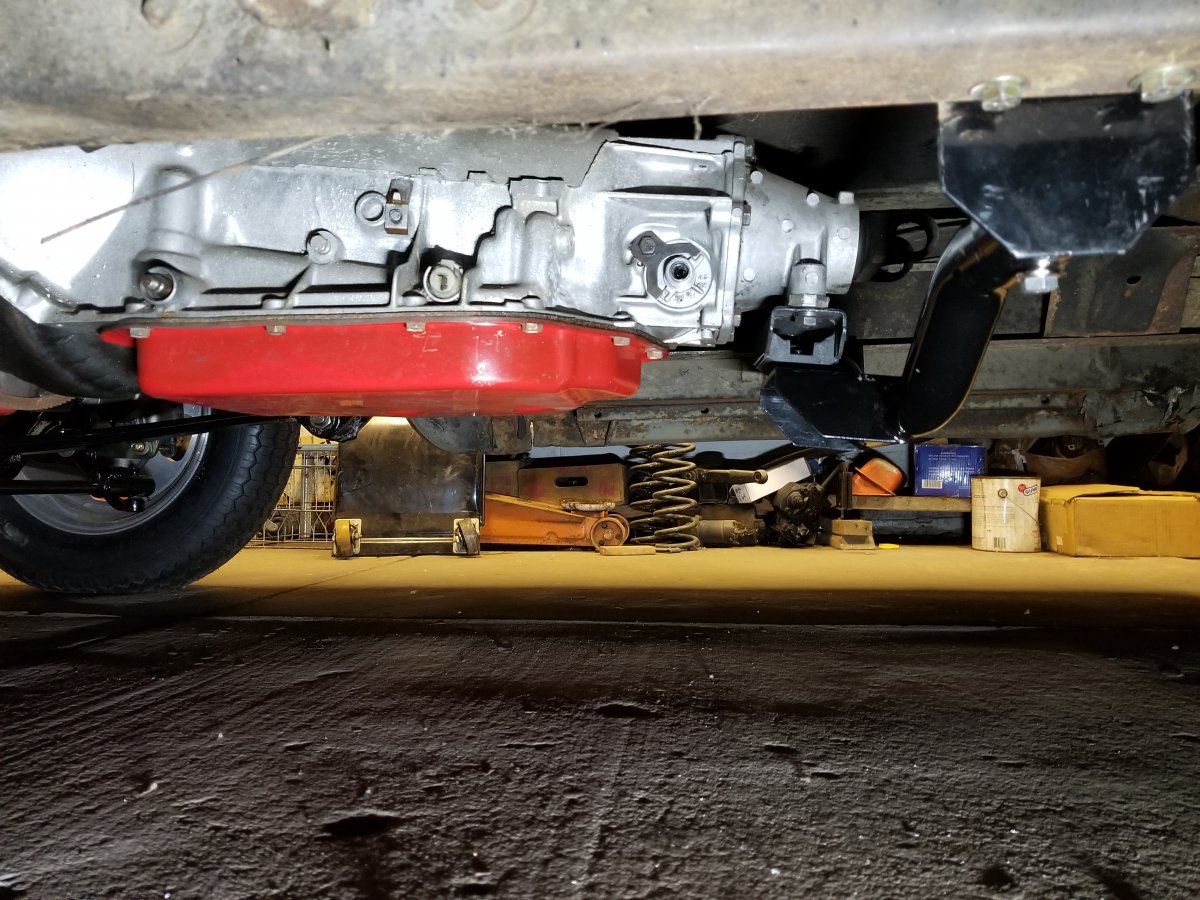

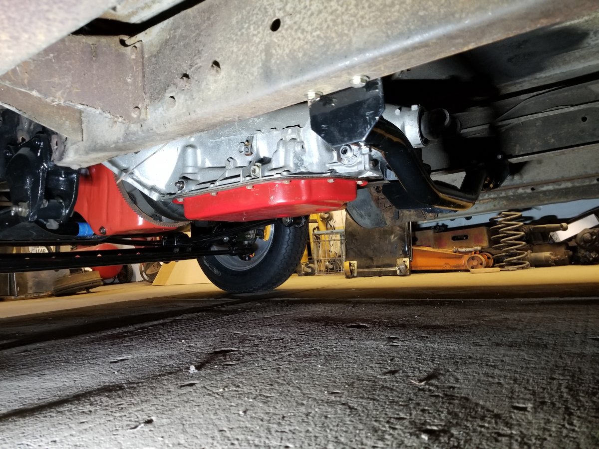

  1. I almost forgot how much fun it is chasing a 1/16 of an inch side to side of a 600 pound block of steel, but I've almost got it were I want it, just need to bring it forward a 1/4 of an inch without losing that centerline.
    It's as high as I can go without the trans contacting the floor and I like to have an inch behind an hei distributor, even though I'll run a small cap. The theory in that is that a big block should drop in on the same mounts and have passenger side valve cover clearance if I decide to do so in the future.
    I raised the engine 2 inches and the trans 1.5 inches from yesterday, carb pad at zero level to the ground, I think I can live with this.

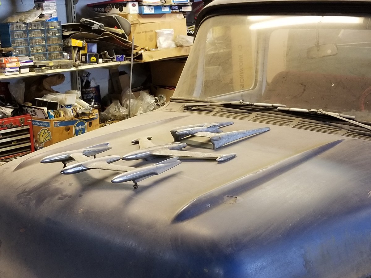

    Today I decided to try a hood bird, then got carried away...lol take flight baby !

  15. In and done, it takes me a little longer but I'm still getting it done, my garage floor has a 4 degree pitch so that carb pad is right on the money, the ol truck and me can rest easy with it's first ever V8 swap.

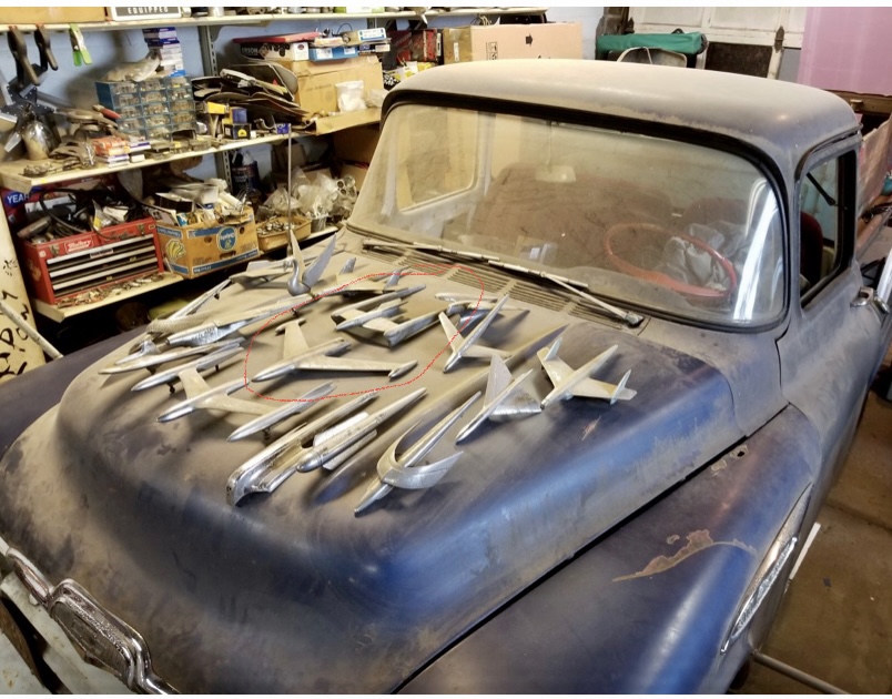

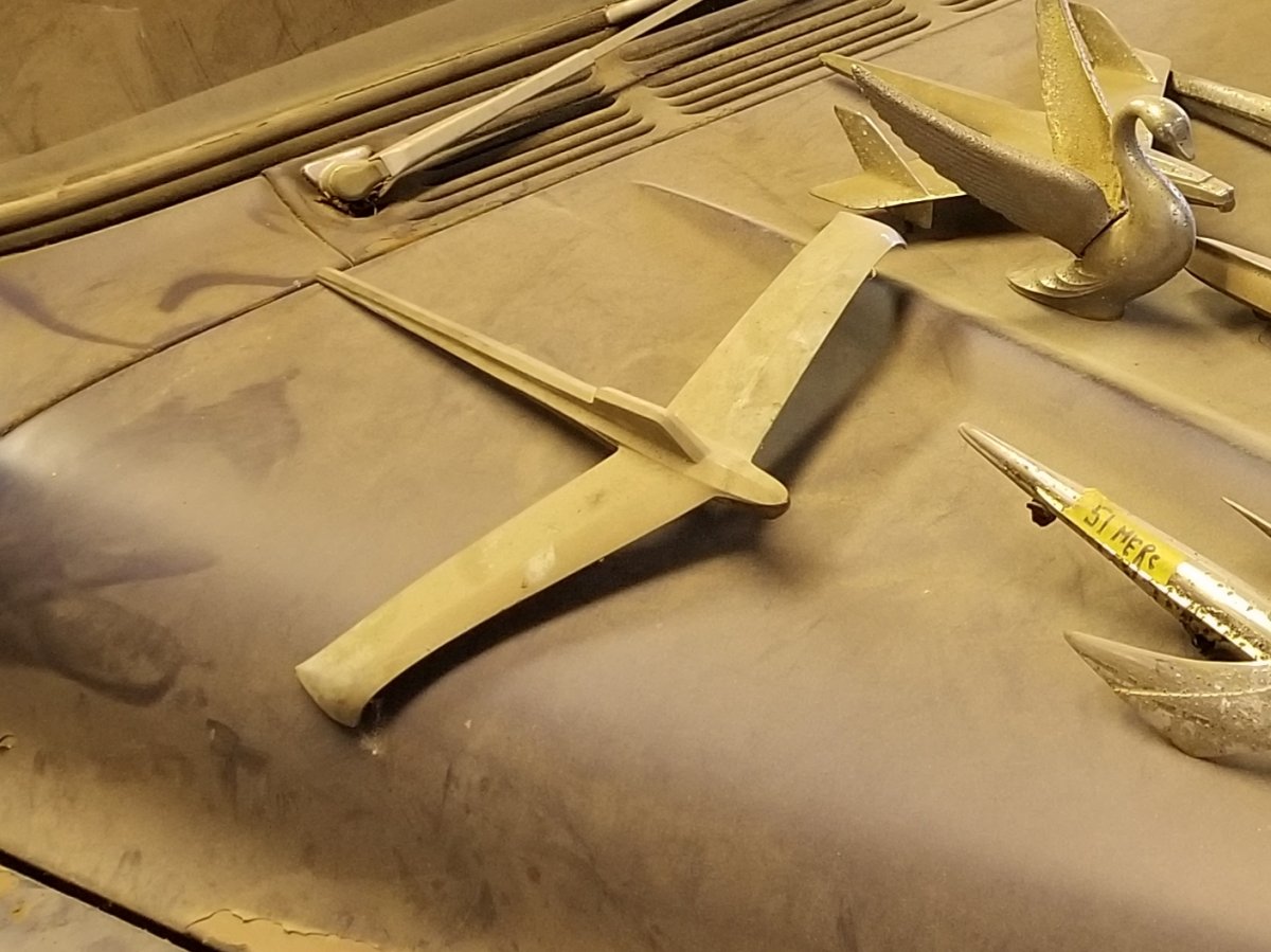

    I have to say the front one would be my pick and the one behind would be my second choice 1A8A3149-AB06-4380-A507-11DC14E29804.jpeg

    Poor little mouse looks lost, almost enough room for 2 in there. Damn! Nice collection of ornaments
  18. Little better view of those center ones
    Could do a plane or a chief

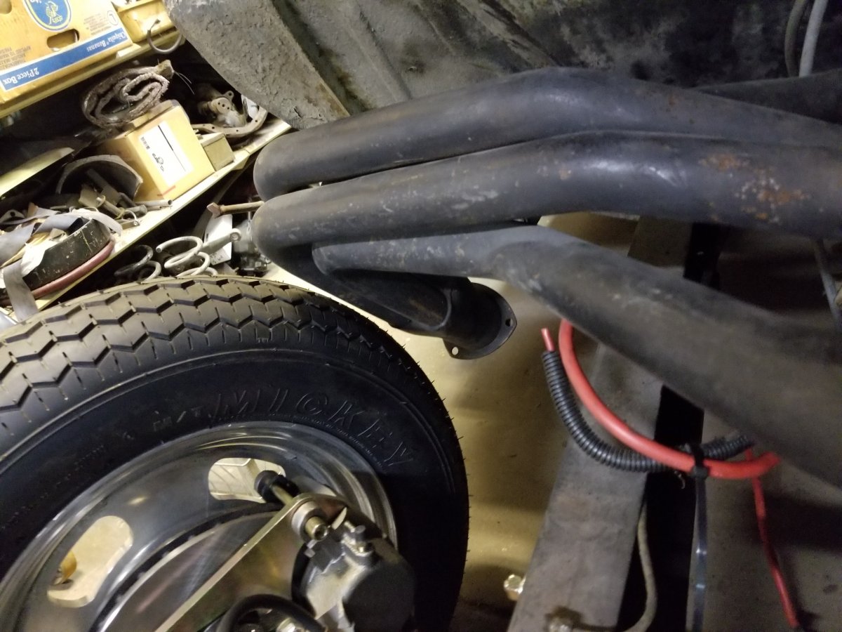

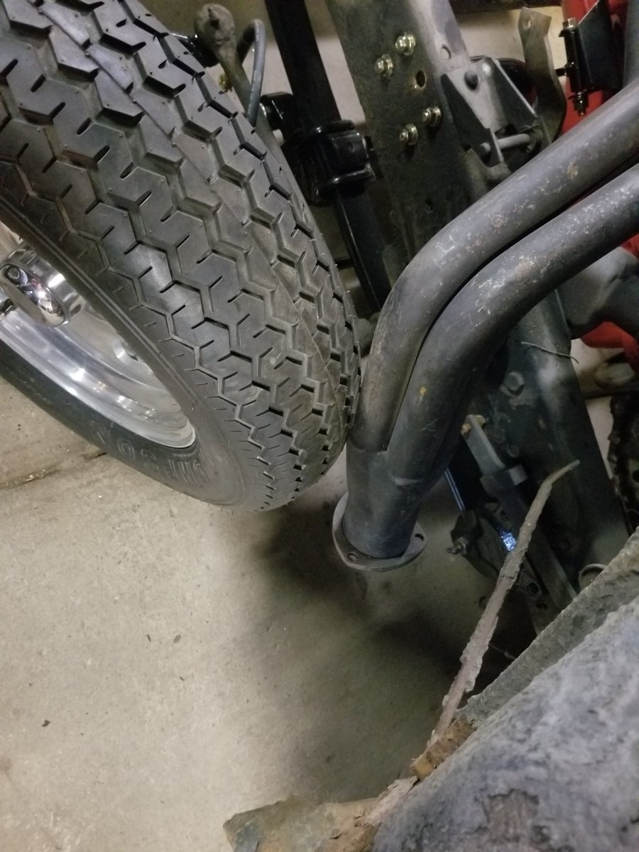

  24. Yup, these tires are about a 1/2 inch shorter and a couple inches narrower than the 215/70/15 tires I have that are the intended tires for it.
    I do have another set of fenderwell headers I'll try tomorrow, they don't look as good as these do in tube layout, I really liked those Mr. Gasket's.

  29. Well that was a bust, these hit the steering box
    I went as far as getting out the tire spoons and mounting my tires ( which turned out to be 205/70/15 ) to get a look with the first set of headers. As I expected, more interference with the greater backspace and a shorter turning radius, plus they are an inch taller.
