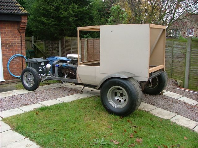

    this is how I did mine, although mine is very square!
    cardboard!!
