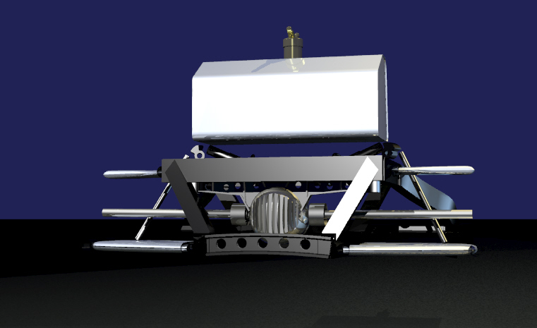

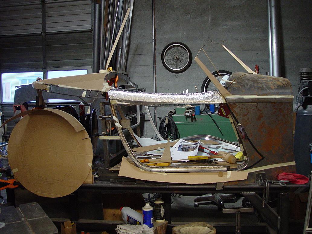

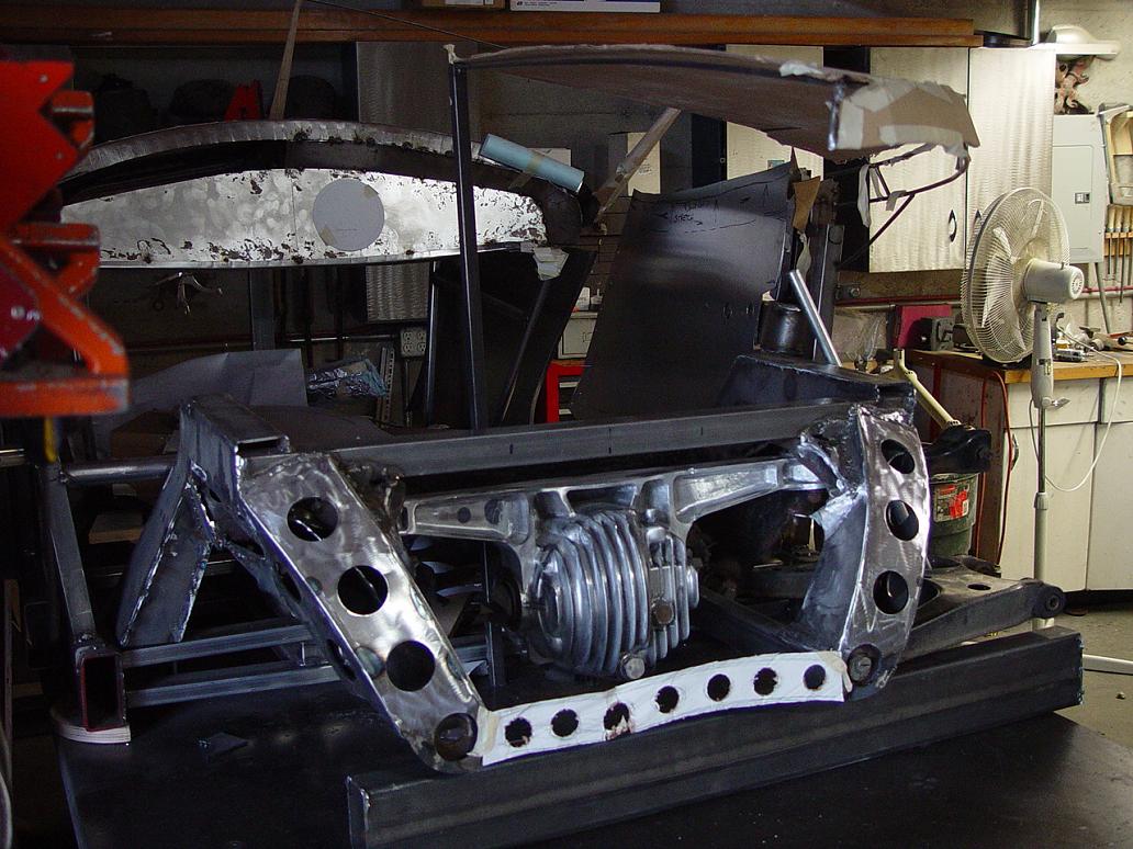

  7. CustomJ
    Joined: Dec 10, 2008
    Posts: 103
    CustomJ
    Well I have always wanted to build a car from scratch. The chassis's were built at James Bowlers shop in Richmond VA. I am going to try and post more details with this method... I ts not going to be a replica i think I want to put a body line in it and change some simple things This ones on the back burner tho because i have a more original design for my next project

    You got a good start there Jay! I'm looking forward to seeing the progress. I'm glad to see the use of the projector. I keep a mini projector as part of my tool inventory and use it for laying out flames, logos, etc.

    Are you going to work right off of the buck?I hate working off of bucks I have to have a flex pattern or I'm screwed.

    I was thinking more about your buck.I think if it was me I would flush screw some 2 1/2'' inch strips of sheet-metal over the ribs of the buck so I could cleco the panels to the wood buck.It would help you visualize the body as you are working on it and help with the welding process.

    Maybe it was just because I was a beginner but when I made some scratch panels that were just slightly complex in nature - I found that going the extra mile to a full surface buck was a HUGE help in understanding the exact transition - not just for fab but for the visual. Getting the compound curves to blend together and lookign RIGHT from all angles wasn't as easy as I origionally thought. I had them lookign great from the TOP and SIDE views but the INBETWEEN angles the transition looked goofy - I never realized this UNTIL I made a full surface buck. I was much happier to tweak my buck BEFORE starting any metal shaping - once I was happy with the buck - the shaping part went much easier.

    Like many folks, I use bristol board over the buck and transfer the pattern to metal. I use push pins to hold the paper to the buck.
    Or if I'm copying and existing panel I use a lot of magnets.
    Anyone have some other ideas?

    CustomJ
