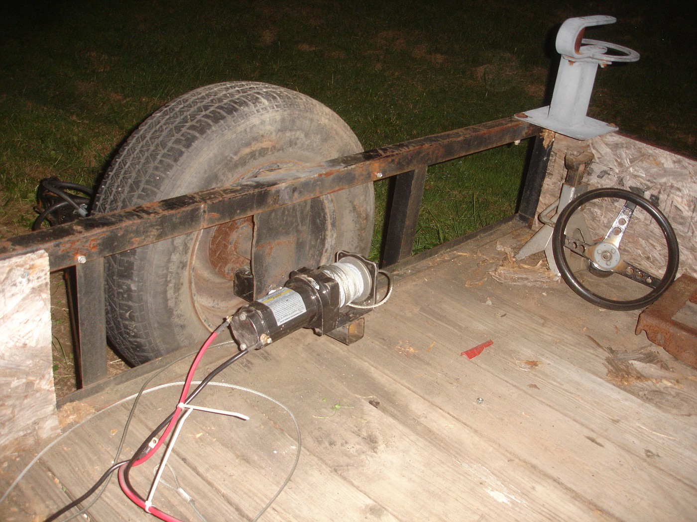

    my only suggestion is to weld the winch on. or it can be stolen like the one on my fathers trailer, that i was borrowing and now have to replace :mad:

    I'm planning on putting a small electric winch and aircompressor in the trailer tongue box along with a small car 12 volt battery.
    i need to use a brake away system and am wondering if i can use the car battery? or can a brakeaway system like the one pictured be used to charge a car battery in the tongue box?
    what i don't want it the Tow Field Battery to equalize with the Trailer Battery, i originally planned to use an isolator for chargine the battery to prevent this,
    just looking for other/better ideas..................

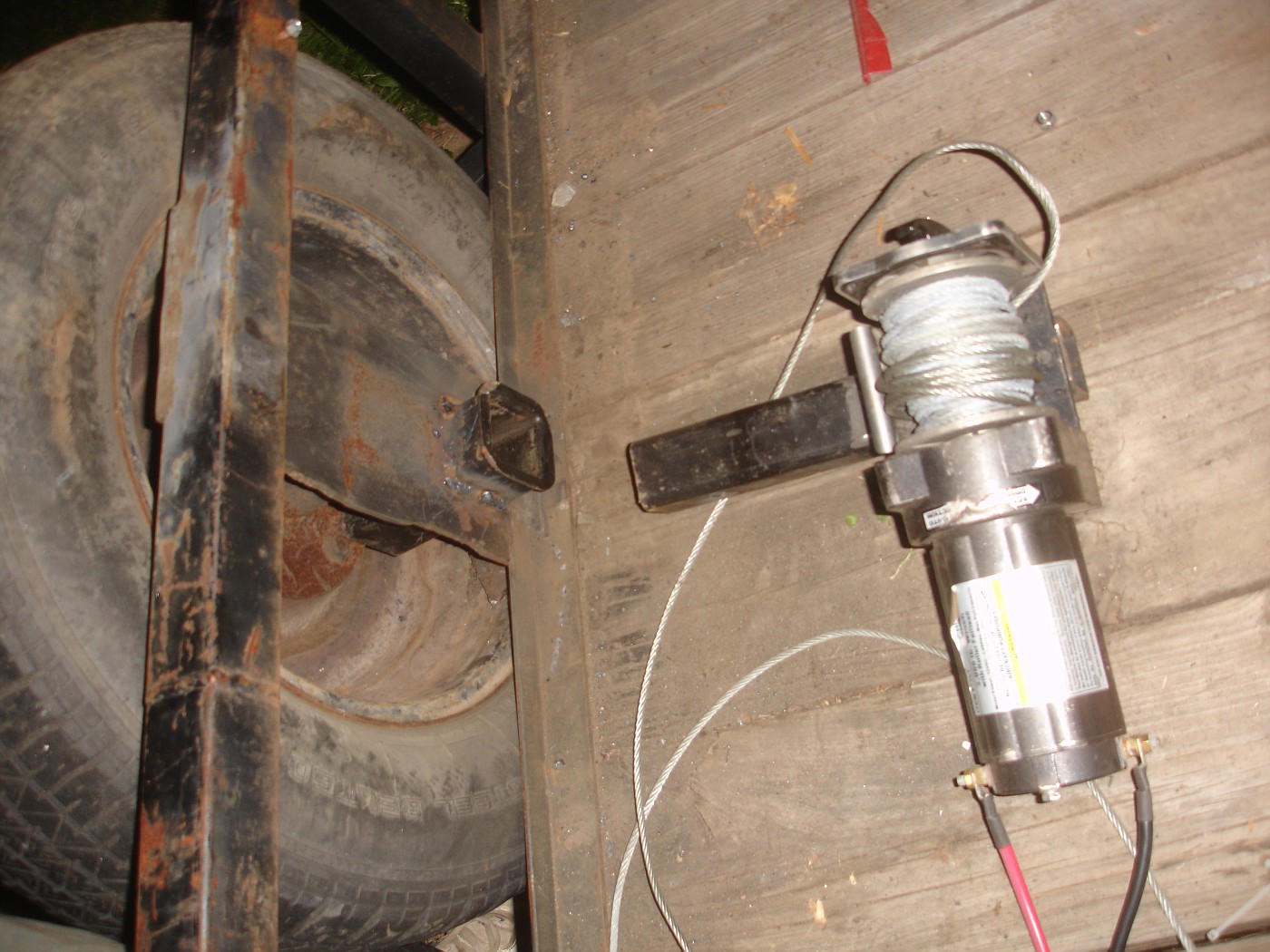

    gotta agree.. I've roached several straight welded jacks.. and I am pretty careful..
    I dont have a great winch.. and I have only used this two or three times.. but this was my solution.
    the winch is mounted to a plate that slips into a trailer hitch receiver that I welded into the front of the trailer bed..
    this way it can be removed.. and stashed in the truck / garage. If I had a GOOD winch I'd worry about it getting wet / stolen.. etc..
    somehow I hope to integrate something similar into my new enclosed..
