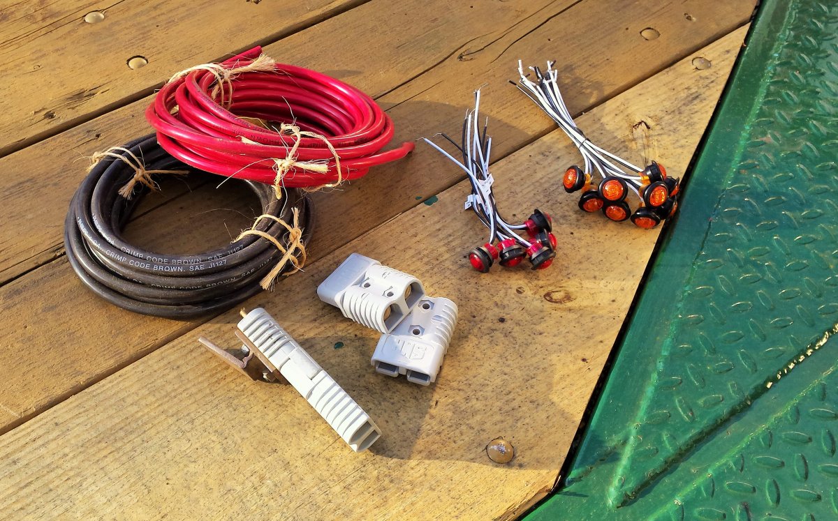

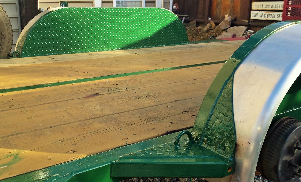

    bringing back my old post for a few updates and lesson learned after 5 years and many miles.
    the ramps were too long, I cut them in 1/2 and they work fine.
    trailer had more flex than I suspected, causing inner fender rivets to work loose allowing inner tire rubbing/smoke a few times.
    winch battery keeps going dead and along with issues with recharging from tow vehicle.
    1 of the 6 boards rotted (other 5 are still good).
    used 1/8 diamond plate for new inner fender wells with 2 x 3/16" flat plate around. plan to install some cough couch LED mini lights around perimeter (bomber lights just keep getting smashed/burning out etc...) putting winch battery in tow vehicle with an isolator and large plug to trailer

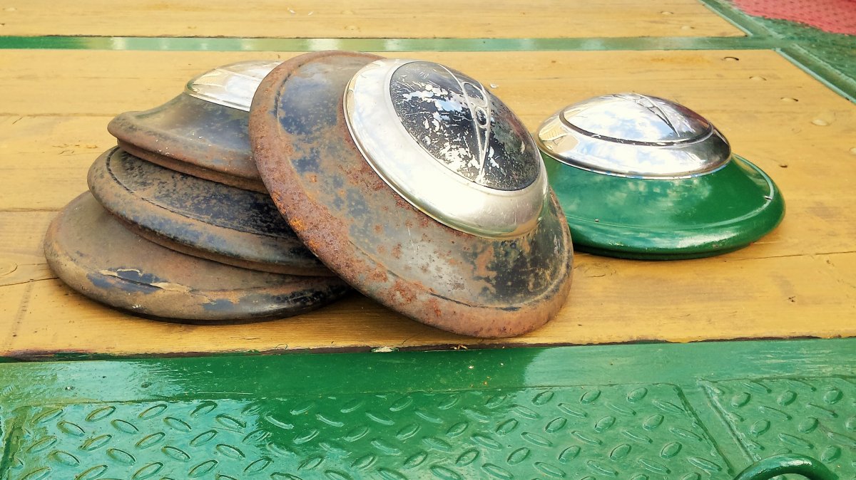

    I can't tell exactly but I have a set of good condition old RV trailer 4-bolt wheels that may match the ones on your trailer, if they are and if your looking for a spare you can have'em.
    so i'm trying to figure out how to mount these 36/37 hub caps on my wheels. I have the correct clips, but they hold the cap about a 1/2" off wheel. 20151121_083829.jpg
    Okie Pete likes this.
  13. '52 F-3
    Joined: Sep 30, 2007
    Posts: 961
    '52 F-3
    from Central PA
    got wheels back on and installed hubcaps, still have pretty good to-do list, but at least I can use if needed.

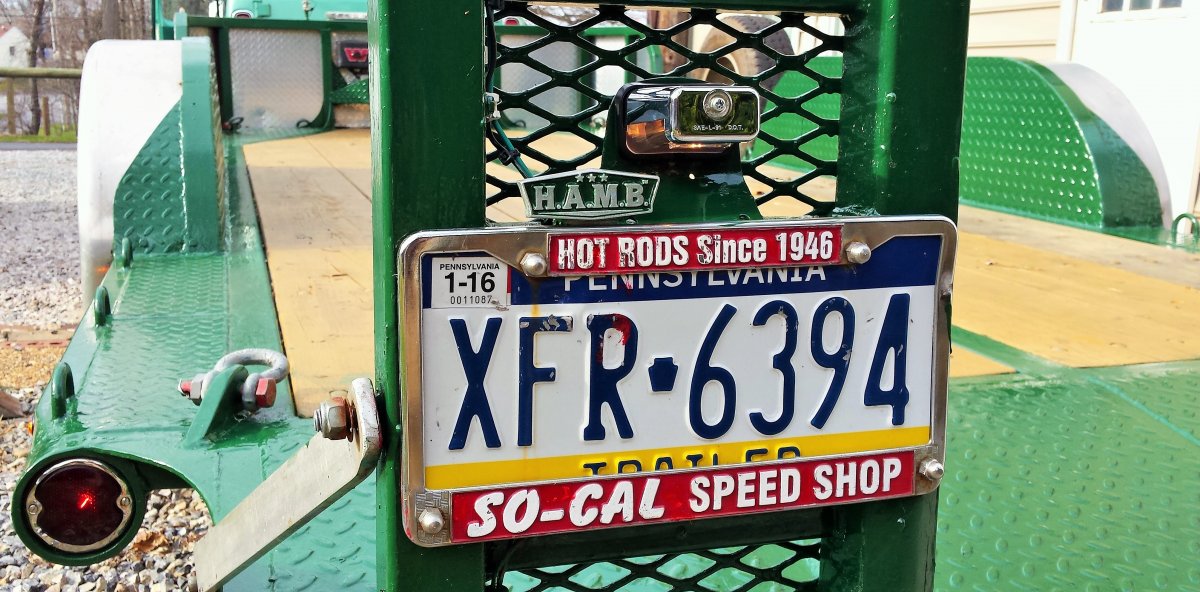

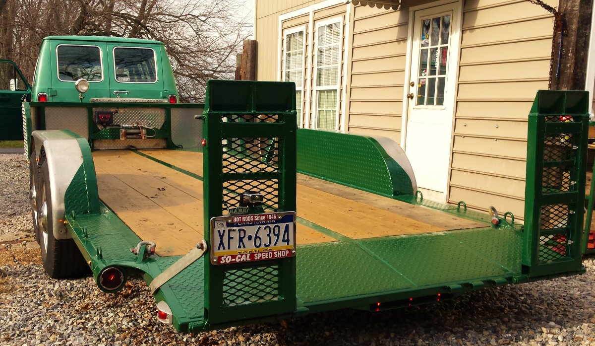

  16. '52 F-3
    Posts: 961
    '52 F-3
    from Central PA
    well I finished painting it green.... and repairing/adding LED lights.
    also my new HAMB topper just came in the mail, I figured what the hell.

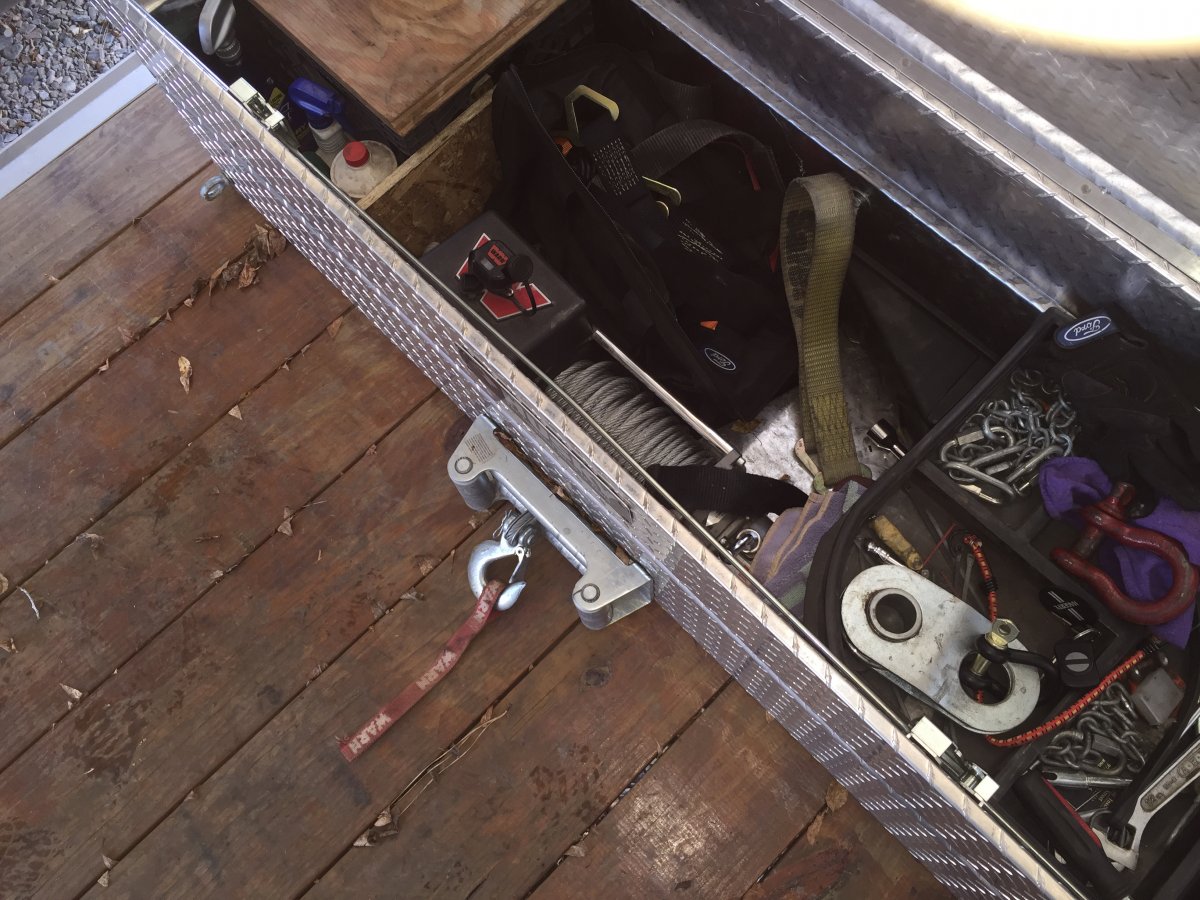

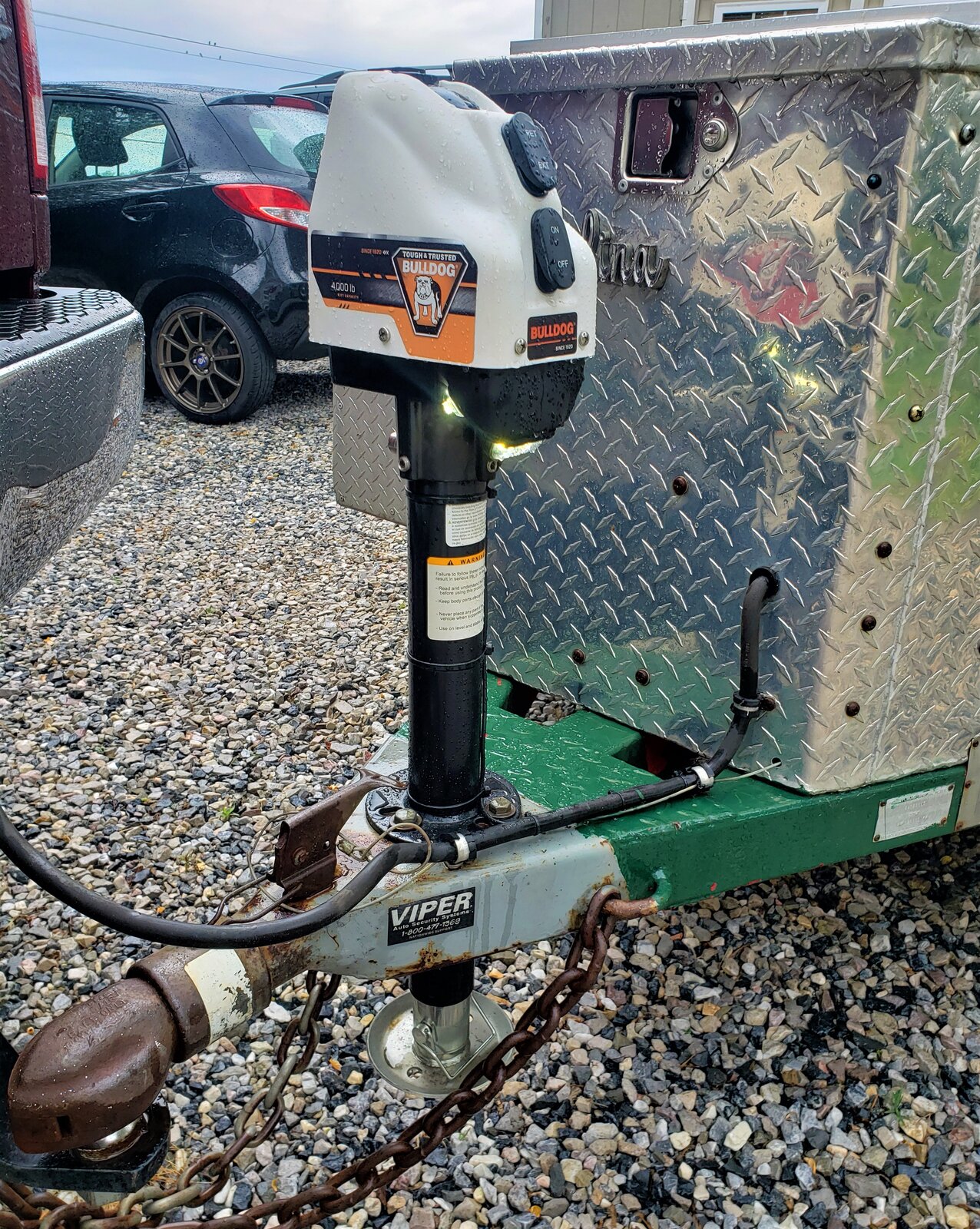

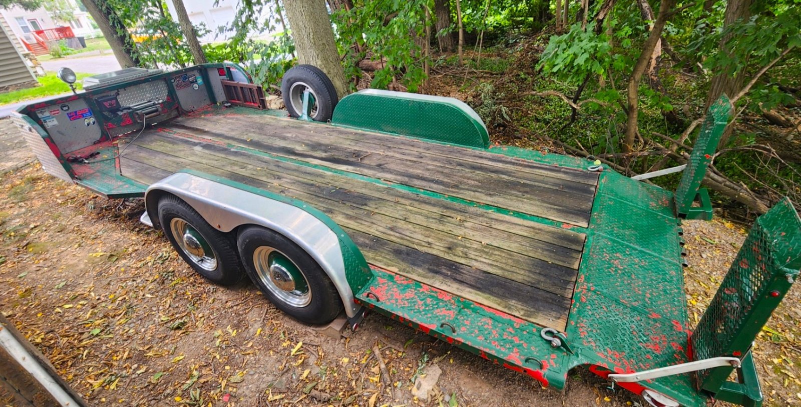

    Trailer is still working great, hauled a car for a friend today. Is it safe to discuss building custom trailers again?
    Anyway, I'm starting to plan a big clean-up, repaint, re-do some wiring/lights and change a few little things. I'm happy with how the Rustoleum Red has held up, but the Green just hasn't stuck well over the years. (it does live outside)
    any thought ideas?
