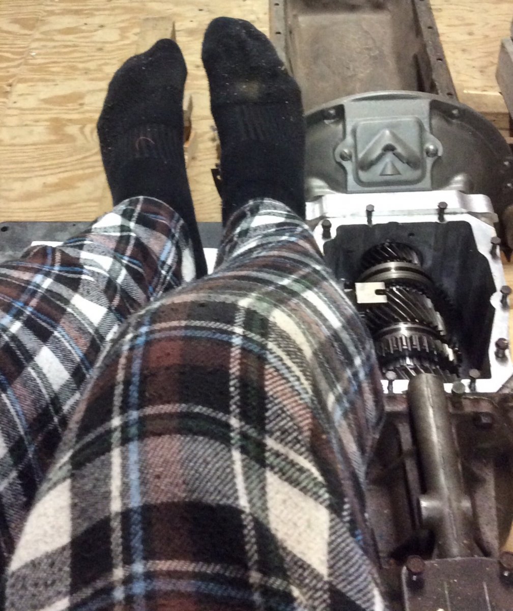

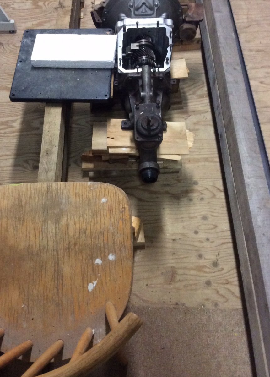

    Lol. Saw this thread and felt the same. I'm 6'-6" and have the same issue with the car I'm building. I did a lot of drafting/layout work with some crude mocking up. Because I'll be building everything from scratch I have the luxury of making the car bigger, but with that comes other issues that can negatively impact the look. As others have mentioned, moving seat as far back as possible and keeping it low help immensely. In my case with frame rails at 28" outside width, and a body width of maybe 36" foot room also became a huge issue due to trans. To solve the problem in my case, I raised the floor pan to be almost flush with the top of the trans to give me that couple extra inches for my right foot. I also dropped engine/trans down as low as I could based on ground clearance and driveline angles. Every bit helps.

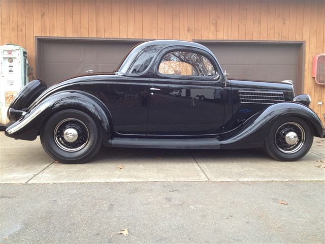

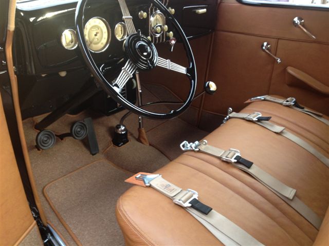

  23. Blown35
    Joined: May 20, 2008
    Posts: 236
    Blown35
    I'm 6'4" and specifically chose a 35 Coupe - kept stock body, shortened the package shelf and moved the seat back - have tons of room - super comfortable PETER_MARTIN_022(1).jpg PETER_MARTIN_001.jpg !

    Tell you what, dude, that vintage oak seat is gonna be really uncomfortable on a long drive and you gotta do something about those pants;)

    Wow, just wow!
