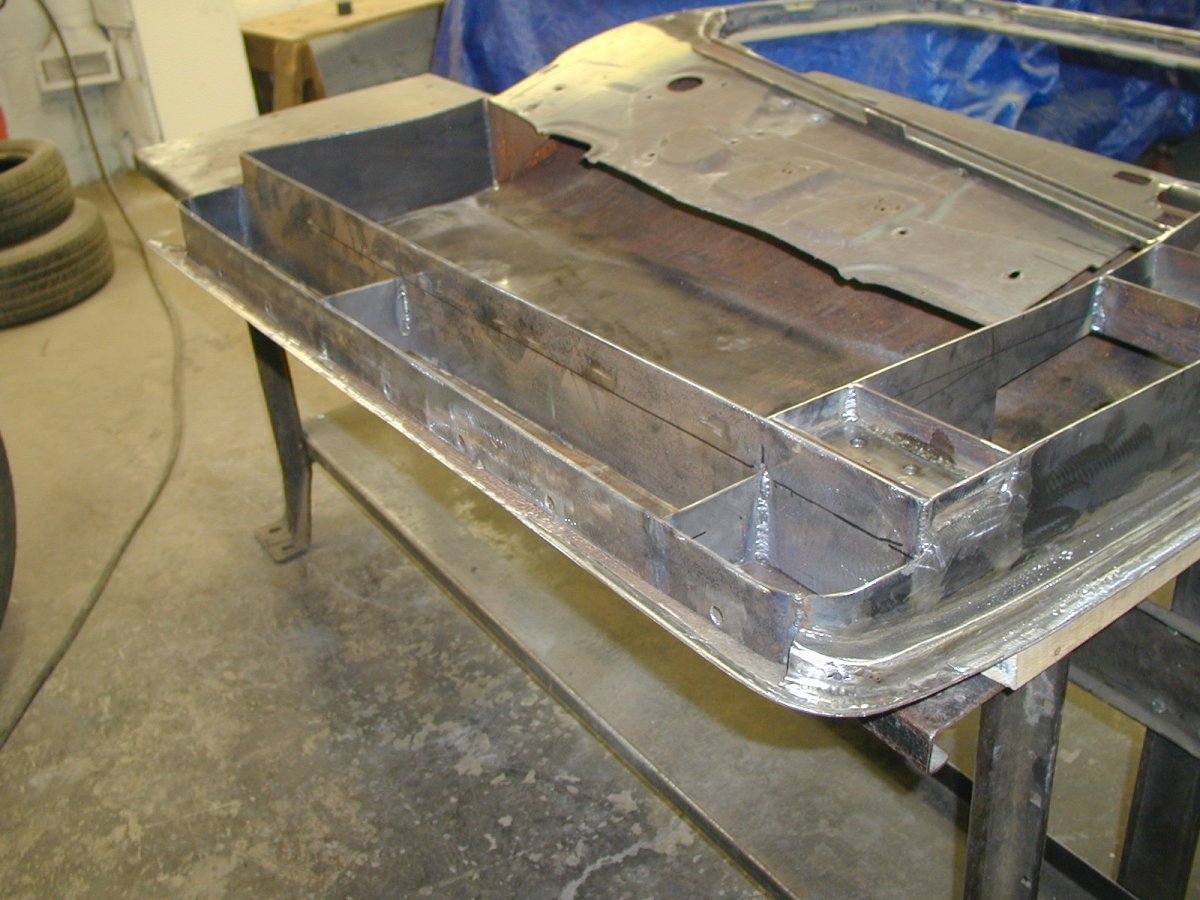

    we get the inset in the firewall in the car and are really happy with the way it turned out P1010042 copy.JPG so we plated the firewall. All this steel plate was stuff my friend's employer threw away...…..It was all 14 gauge and 16 gauge steel...………….this thing is going to weight a ton

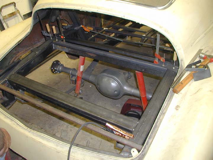

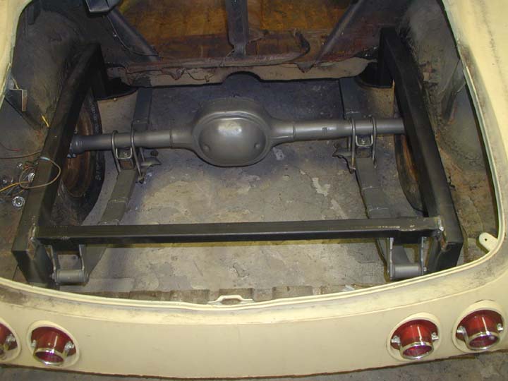

    We had built a new rear clip as the original frame was rotted away. Since we knew we wanted bigger tires in the back, we decided to mover the rear leaf springs to an inside the frame rails position.
    This allows some really big meats to fit inside the wheel wells. Did I mention this thing was a rust and bondo bucket ? Of course all the normal pieces needed to be replaced
    This picture shows the amount we lowered the body over the frame

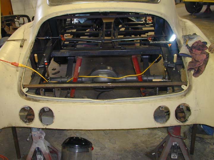

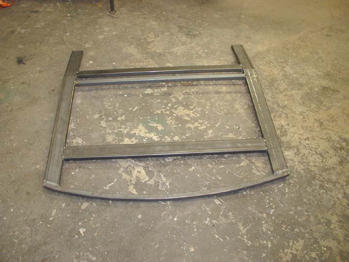

    Like all the rest, we built 1" X 1" square tubing frame including what will become the wall between the interior and the trunk.
    We cut the spring perches for the trunk lid...…...more on this later
    All of the clamps shown were holding the basic structure of the trunk together for tacking. Shown below is that welded structure
    lothiandon1940 and chryslerfan55 like this.

    Just like on TV, we got everything welded and installed. We over engineered this thing like nobody's business.
    The big hole you see is where the gas tank is going. We choose to use a marine grade aluminum tank. About the thickness of copier paper. So we built a steel container to protect the aluminum tank. Around the edge of the hole, you can see bolts in the structure. That is so we can drop the tank out the bottom.
    The 2 eye hooks allowed us to lift the body off the frame with a modified engine hoist
