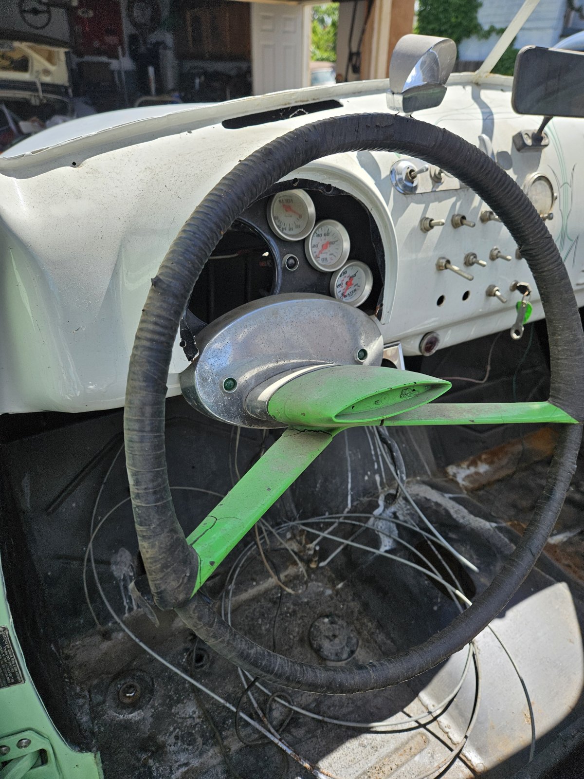

    I bought a 53 GMC kustom. The dashboard was modified by the previous owner(s) and wasn't to my liking, so I'm trying my hand at customizing it.
    I had a complete '52 Buick dash laying around so I figured I could use pieces from that.
    Here are the before pics of the truck and dashboard. I just bought it a couple weeks ago.

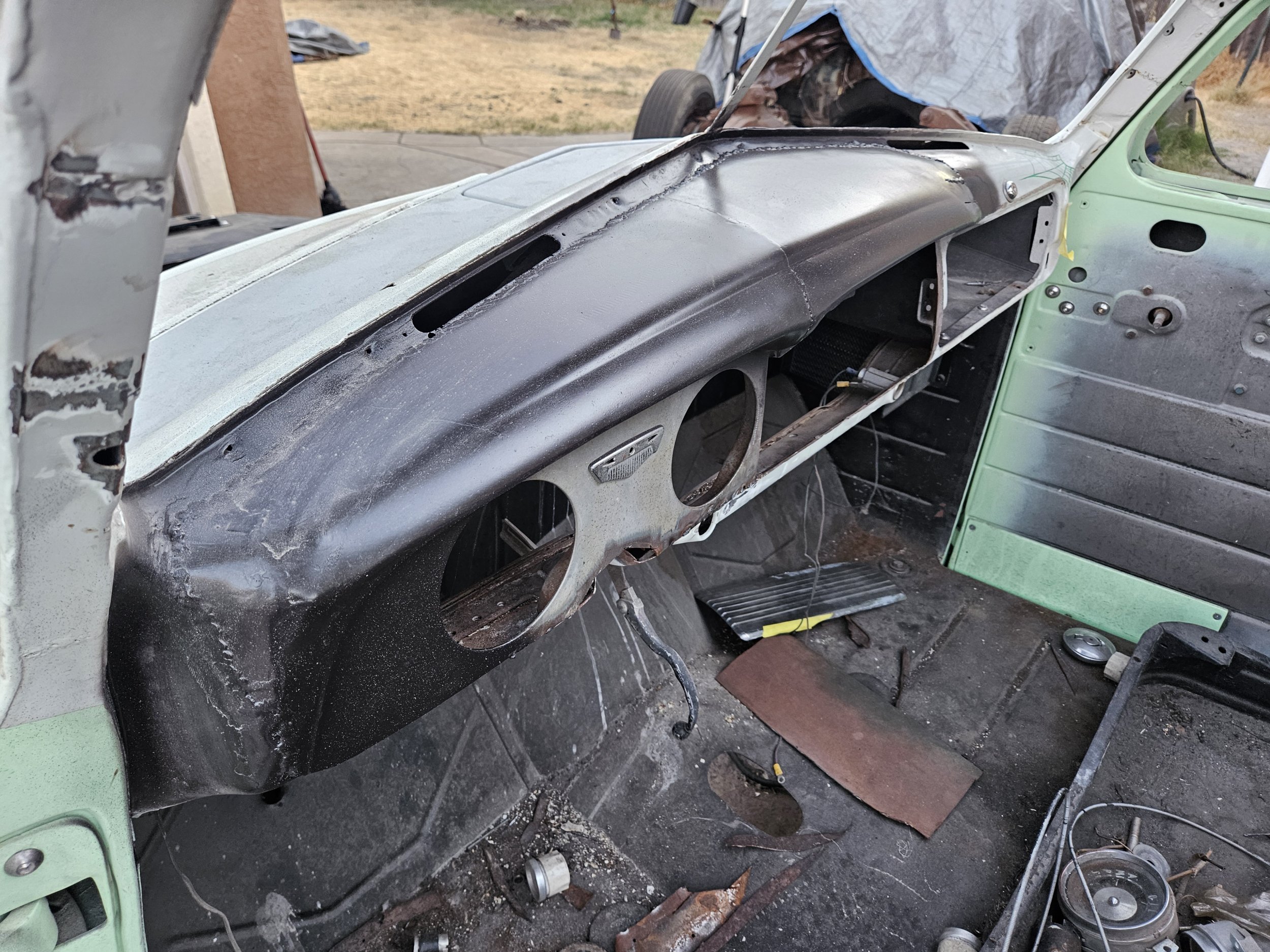

    I started by taking all the switches, knobs, and gauges out. I went ahead and cut the Buick dash in half, but wish I would've got a picture of it before that.
    Next a lot of cutting happened until the Buick dash started to fit.

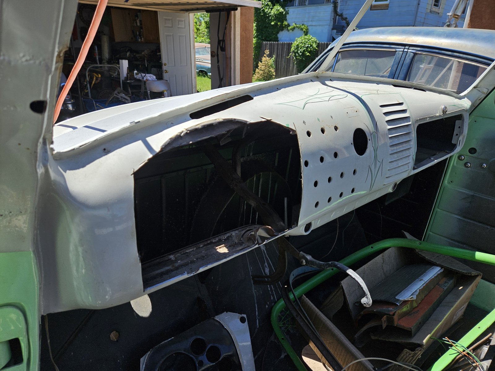

    I should've just used the whole Buick dash instead of grafting the two dashboards together, would've been easier. :confused:
    This was about two Saturdays of cutting and fitting to get to this point. That's what it looks like now. Just tacked in place.
