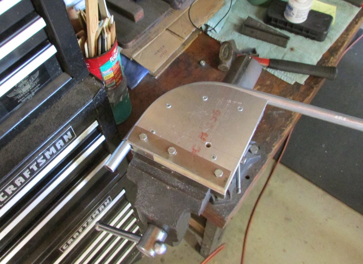

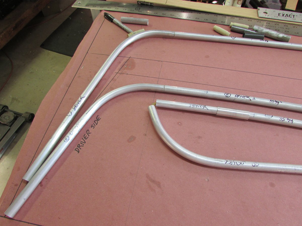

    There were a whole buncha secondary mechanical designs in this project. And if it were not for the help, observations and critiques of many others, this would not have turned out as elegantly as I expect it to be. It's been like "eating as elephant". ..one bite at a time.
    Also there has been several false starts where stuff didn't ,...or wouldn't work out.
    I wanted the header to "embrace" the top windshield frame in order that the crown did not add too much visual bulk. The section drawing indicates that goal. Further, after imagining the hinge on the bottom surface and finding there was no hardware, a friend sent me this "sewing machine hinge" which lead to the idea of hinging on the vertical surface.

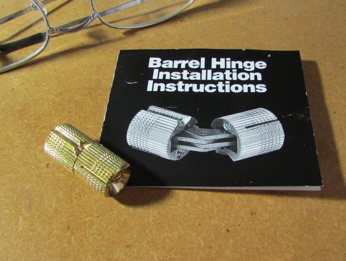

    The hinges were brazed/soldered together and beat upon for an antique look. Note the coloring on the wood and other hardware parts to augment the car's color statement.
    The header is upside-down in this view and had some modeling done to make it look less like a big slab of wood.

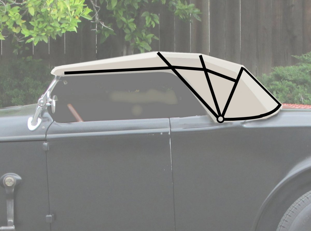

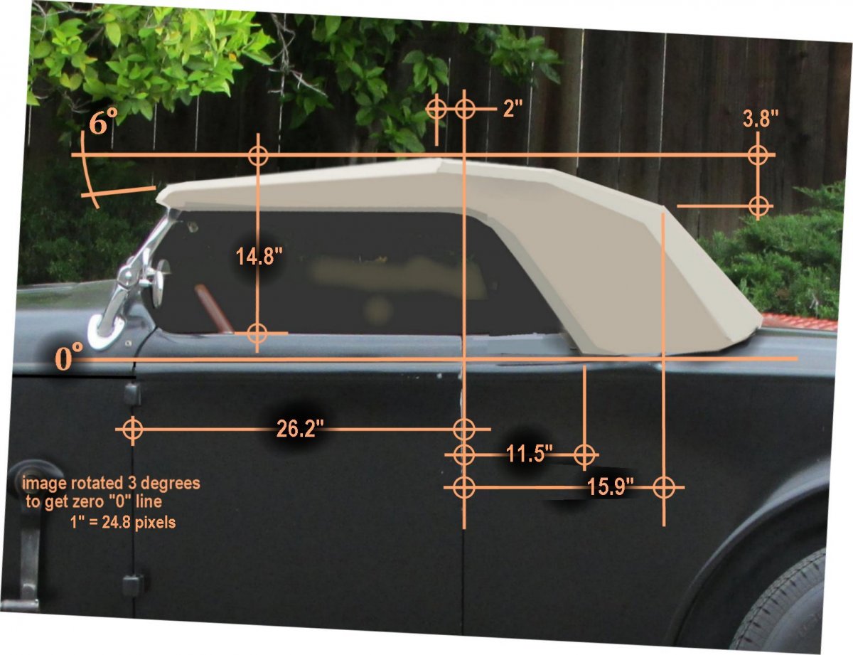

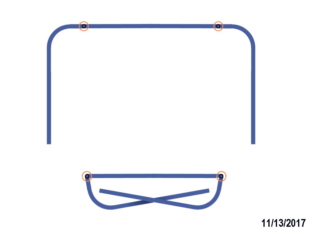

    Top frame sktch 3rev.jpg It took a fair amount of doodling to get the mechanism concept down to minimum number of parts. Especially to soft or attached parts that could be efficiently packaged. Refined from this cartoon, the strap that goes front to back, is now attached to the header and the Velcro loop is reversed at #1 bow and upon tensioning drives "stretcher #1a into the header receptacle.

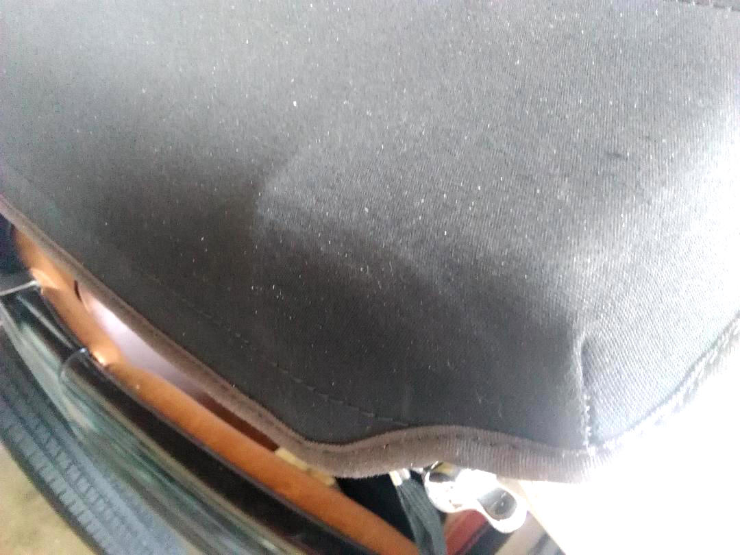

    it's two inches wide and could lift a house. Very inexpensive too.

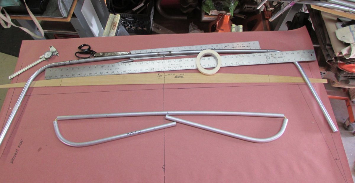

    Sooooo,.....the idea was to make an attachment to secure the bottom hoop to the deck. Had to be easily removable without tools. This is what I came up with. Works pretty well and serves several more purposes.
    the little cleat which you will see in following pics is not done yet. Ultimately will have some hand work and polishing. Still gotta figger a gaceful way to attach to the design line on the body.
    I get a loop to hook the tensioning strap to and the tube portion slips over that trick hinge, rigidizing the hoop as per the other folding bows. The added flange is for mounting the snaps for the fabric top.

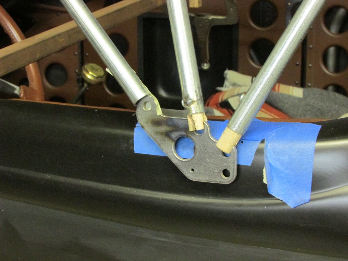

    Earlier on, like a coupla years ago, a tonneau cover allowed protection of contents in the p***enger seat, closure for overnight security and,....it looked cool in my opinion.
    I couldn't bring myself to drill holes in the body for snaps so a hoop was bent up to carry the snaps. The hoop plugged into a little slot in the center of the ****pit surround and attached via two bolts and a bracket by my elbow. Img_7629a.jpg IMG_7622.JPG
    That mounting point became the structural point for mounting the top as well.
    A second bracket was fabricated for each side for attaching the top bows. Couldn't find any suitable clevises for attaching the bows so I had to make them.
    The bows open from the folded configuration, the slip tubes moved over the hinges and then the bows are plugged into their respective clevises. Img_8093.jpg Img_8128.jpg Img_8199.jpg Img_8094.jpg

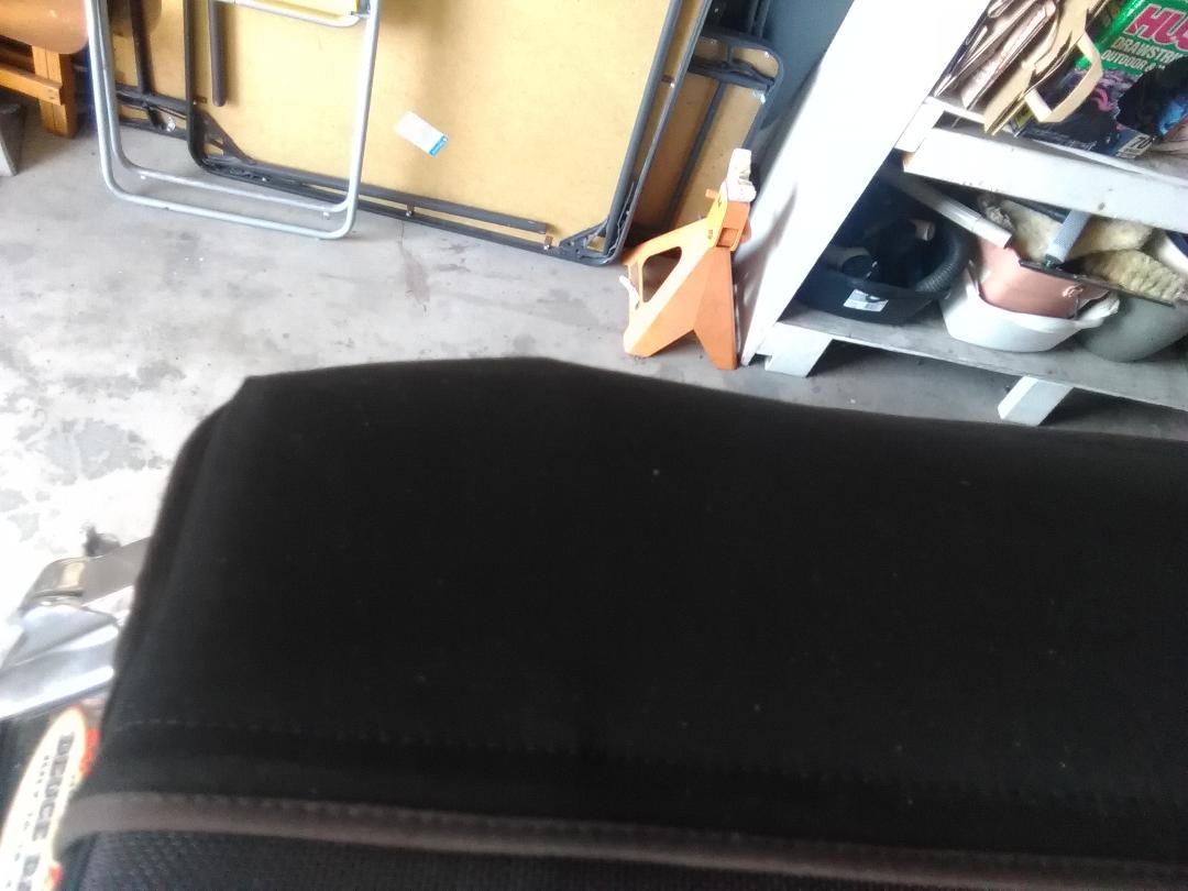

    Doah!!!!!!!!! ran into a bit of a snag, ****!!!!
    We're ****oning the thing up and an issue that drives me nuts pops up. When pulling the canvas tight to attach to the Velcro at the top of the window opening, the fabric caves-in between the header and the first bow. Something we worked on between the other bows. This was a surprise.
    Sooo,....we're going to take a few days off and do some head scratching. We're close and don't want to screw up what we've done.
    Gimme a coupla days.

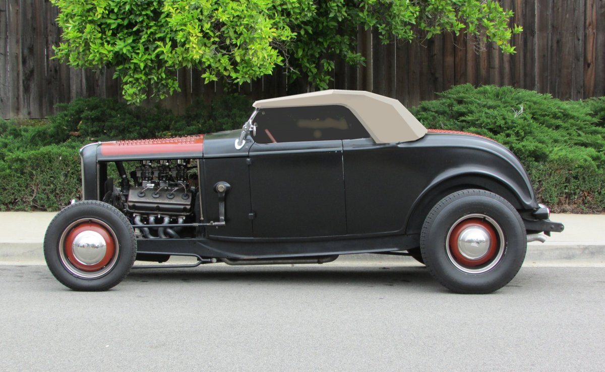

    First phase done. Top survived 80 mph on North bound I-5. It's noisy like a coupe with the windows rolled down 'tho the top seems really solid. Major goals met. Love the stealthy look! Profile worked out perfect in my opinion. new top 2.jpg new top 3.jpg
    The center, "storm cover" will be finished next week along with attending to a few bumps and warts that became apparent as all the fabric was tensioned.
    I will be taking a chisel to the knuckle on the header that pushes on the canvas above the windshield post. P***enger side shown.
