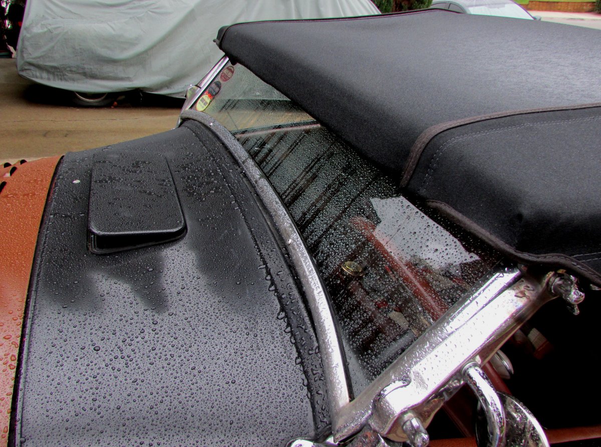

    Finally had an opportunity to test the zip-on storm cover. The only issues are the "rooster tail" that douches me on a slow left turn and the water that sneaks under the corner of the windshield. Nada big deal in the overall scheme.

    Did you tell us the type of mesh you used? Manufacturer and or name and brand?
    Another thing I’m wondering about is if you experience any water infiltration ( fancy word for leaks :D) from the zippers holding the storm cover resulting in cold water running down the back of your neck :eek: ?
    What type of zippers are they?
    I’m impressed overall, almost to the point of trying to have that style of top made ( the fabric portion) for my Rod Tops top on my 26 RPU.
    Larry

    There were only two manufactures I could find. www.twichellcorp.com and www.phifer.com They make fabrics for patio furniture and sun control. Neither had ever heard of an application such as mine so I believe I am the first. I went with Phifer's SunTex as they had the greatest number of colors and textures. They readily sent samples and purchase of minimal yardage from resellers was easy. And,...it was cheap! Bought enough to do the top in three colors because I could not decide. $65.00 incl shppg!
    Trim guy sourced the zipper. Standard convertible top hardware. I liked as it was br***. No leaks.

    Thanks, it really looks good. There appears to be some overlap at the zippers that would definitely help with not having leaks.
    If it had become a problem one could do like they do on waterproof motorcycle riding gear such as jackets and add a strip of Velcro to hold down the flap over the zipper.

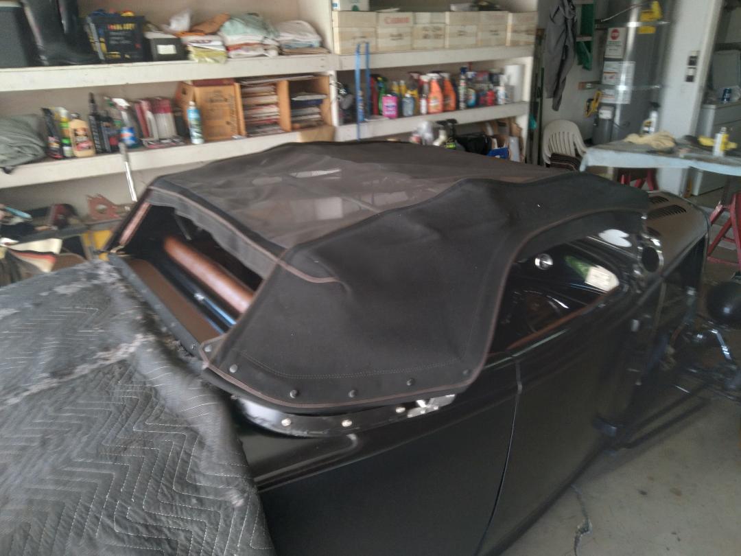

    Here be some thoughts. 'Tho the project went as planned,....can't leave well enough alone. Think I mentioned previously, "If I re-do, I'd seriously consider a rigid top (w/mesh) and suffer the inconvenience of leaving it home and wishing I had the protection and/or leaving it in a motel room and having to retrieve it. Breaking it down, stowing in the trunk and re-erecting,.... is a pain in the ***.
    However,....last coupla days I've had the top off to do a little maintenance and tuning. Discovered sans the header, the bows nest quite compact..ly. With the bows still attached at the sill, the remaining fabric and header are somewhat more easy to stow and take less room.
    Soooo,...if I were to re-do today, I'd probably save all the monkey motion and make the bows rigid (non folding) and make a little bikini cover for the bows when they're folded back.. IMG_1014.JPG Img_1017.jpg Img_1023.jpg

    Did the promised "*******" test and I'm a bit embarr***ed to say, the top is becoming permanent. In preparation of the Victoria event, I decided to do a little paint repair and detail cleaning which meant removing the top. It's been off for about 10 days. Great for fair weather evening cruising but not so much fun any more at 70 mph,...gets old hanging on to your hat, driving one handed and wind buffeting til your ears ring. I must be getting old!!!!!
    And,....putting the ****er back together was a major pain in the ***,...even more than I remembered. Yeah,.. it was a pretty successful project,... "Building a Foldable Stowable Top" but now I question why?????
    Here's what it looks like going back together, probably for the last time. Now I'll only have to suffer taking **** from all the guys who I busted for years for never taking the top offa their cars. What goes around, comes around, I guess :rolleyes:! Also confirmation that I prefer the appearance with the top in place. thumbnail (15).jpg thumbnail (16).jpg thumbnail (18).jpg thumbnail (21).jpg
