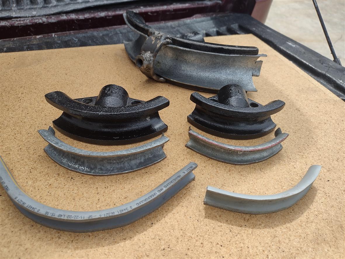

    Tried making tight tube bends with a HF hydraulic pipe bender, got kinks. Eventually made some decent hollow-tube bends by filling the tubing with sand and making bender shoe "inserts" cut from EMT or PVC 90 deg bends to take up the difference between pipe and tube sizes.
