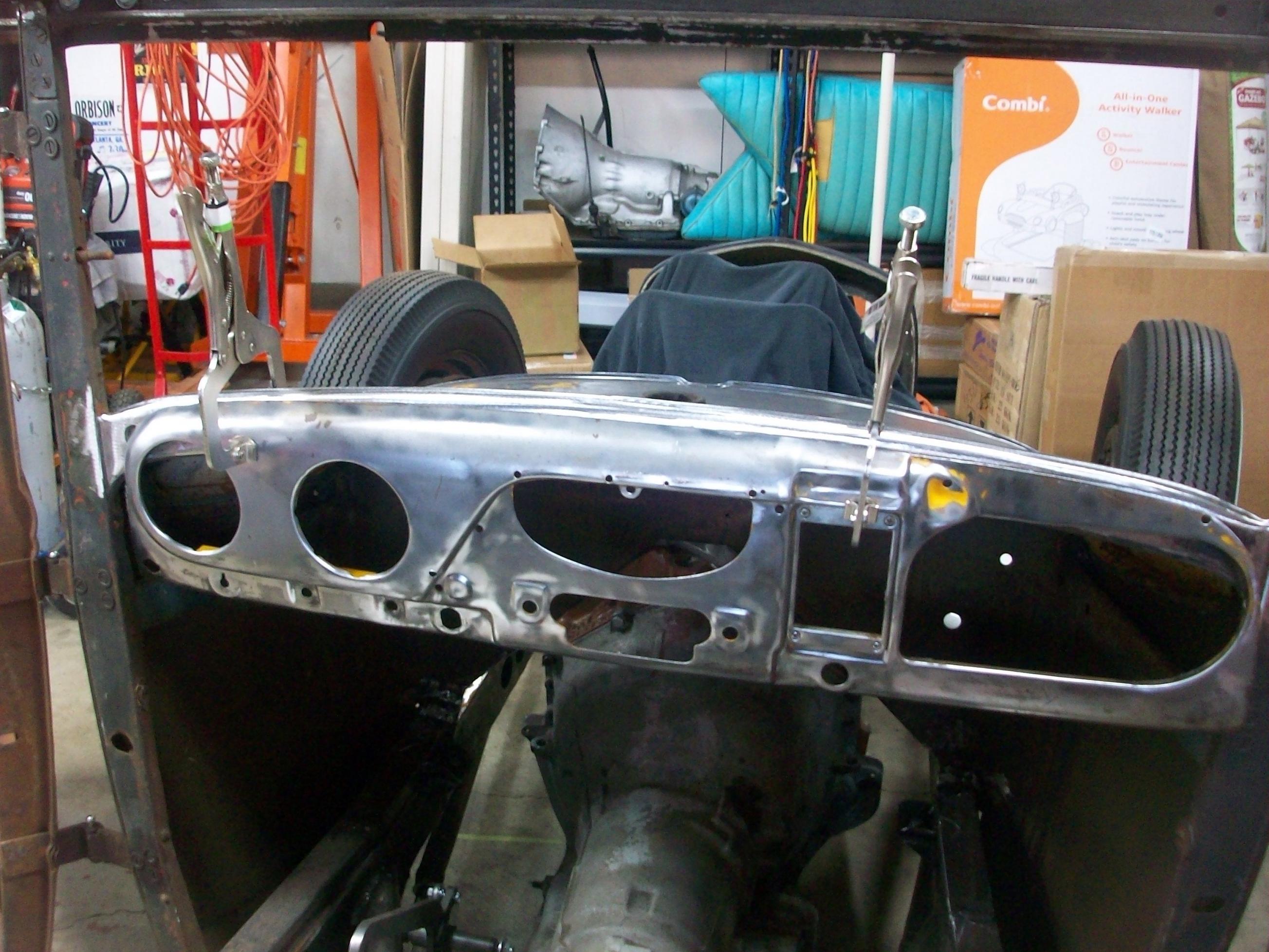

    So, yesterday we finished the body mounts. Also tried a few different dashes. Might go with a '49-50 Ford F1 after all. It's slimmed down, and will get painted or chromed, and get a complete set of knobs, ignition lock, gauges and all.
    It happened to show up very conviniently at a friends garage and would work out just fine!
    Today we'll try to get the brake pedal situation under control, then start with the steering!!
    Eager to drive this thing.....The neighbourhood is waay to quiet!

    Working on fitting in the F1 dash, it'll be a pretty good fit.

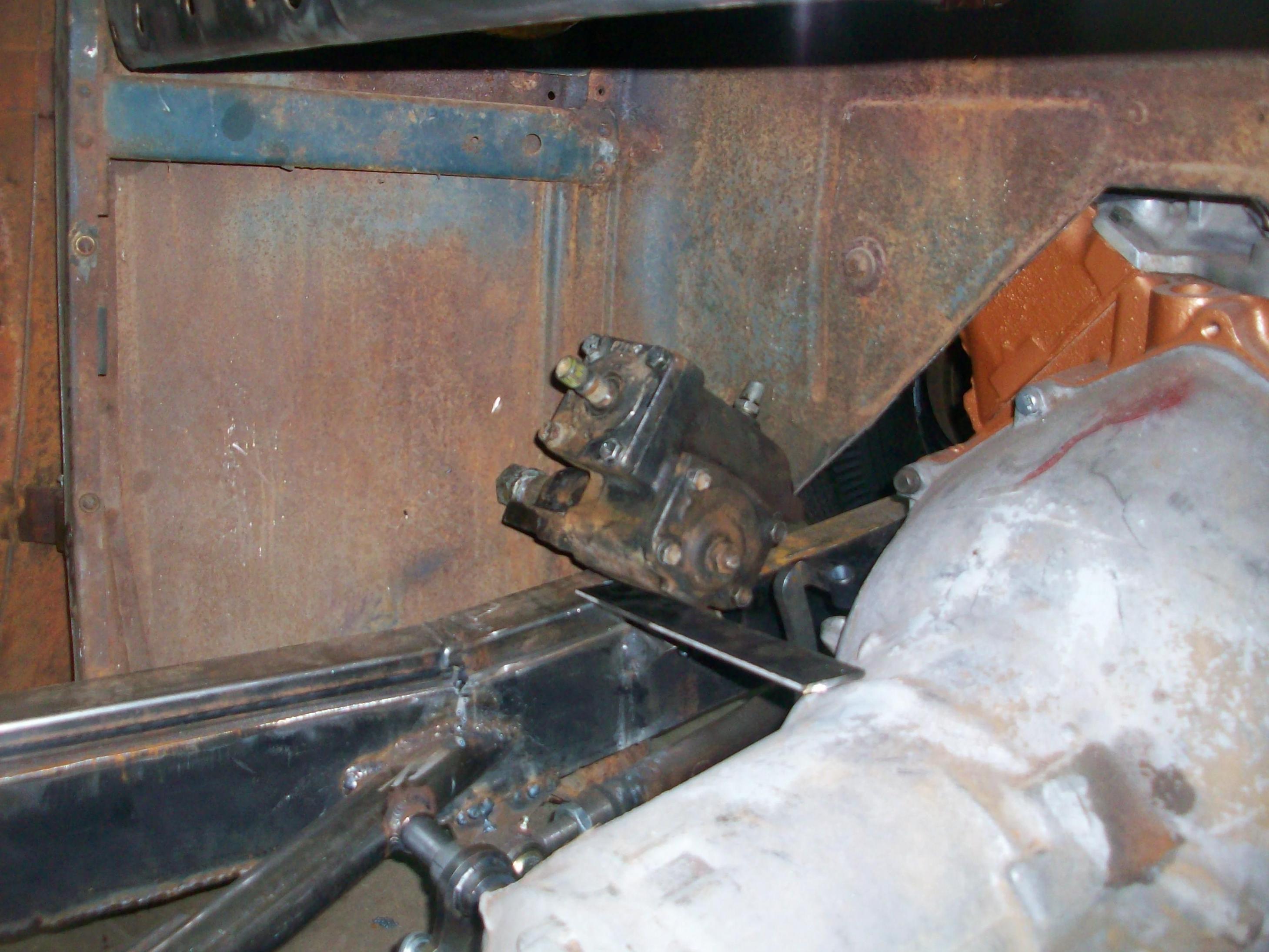

    Decided we don't like a steering box visible on top of the frame or under neath, so we are installing it inside the cab. It'll be a little tight to fit feets and legs, but it'll work.
    Getting the joints on Monday and will set everything up then.
    The pitman arm will be coming out of the side of the cowl. We're using a '79-85 Toyota 4 wd box. Almost identical to a F1 box but way better.
    Gotta build a "bucket" for our ***es, as we need every inch of leg room we can get.

    Just ordered u-joint for the steering, and am waiting for them now. Using a '47 Chevy truck column along with a '79-84 Toyota steering box.
    Started doing the sheet metal work on the truck bed.
    I hope to have the steering done within a week, then weld the dash on there, finish the bed.
    Next step will be doing the floor in the cab, with driveshaft tunnel.

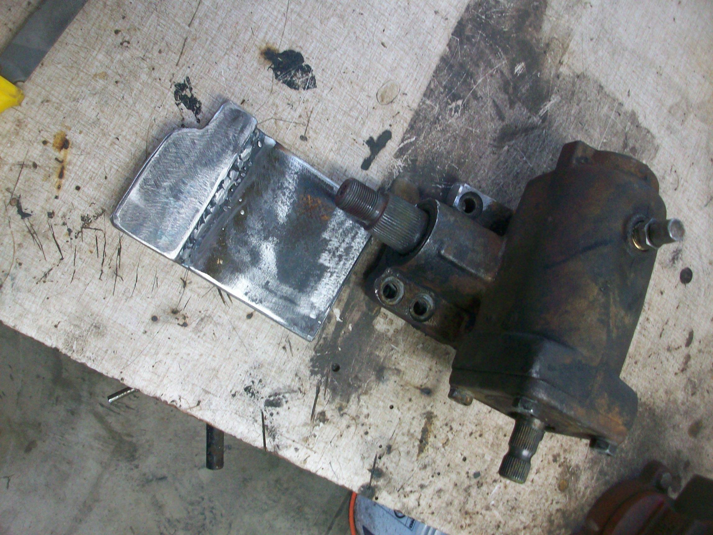

    Made a bracket and such for the shifter. Nuthin fancy but it'll work.....
    Floorpans being made this weekend!!
