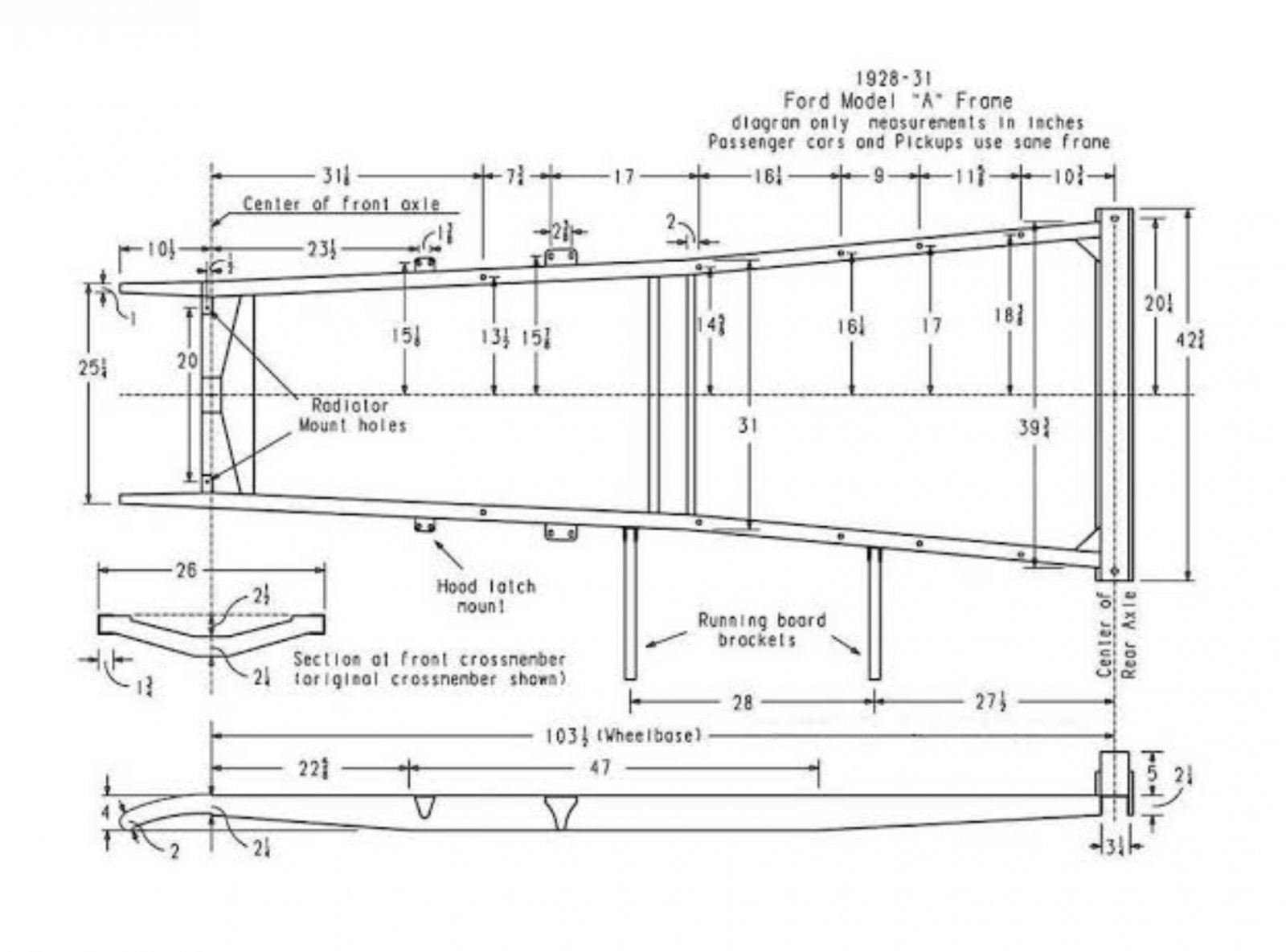

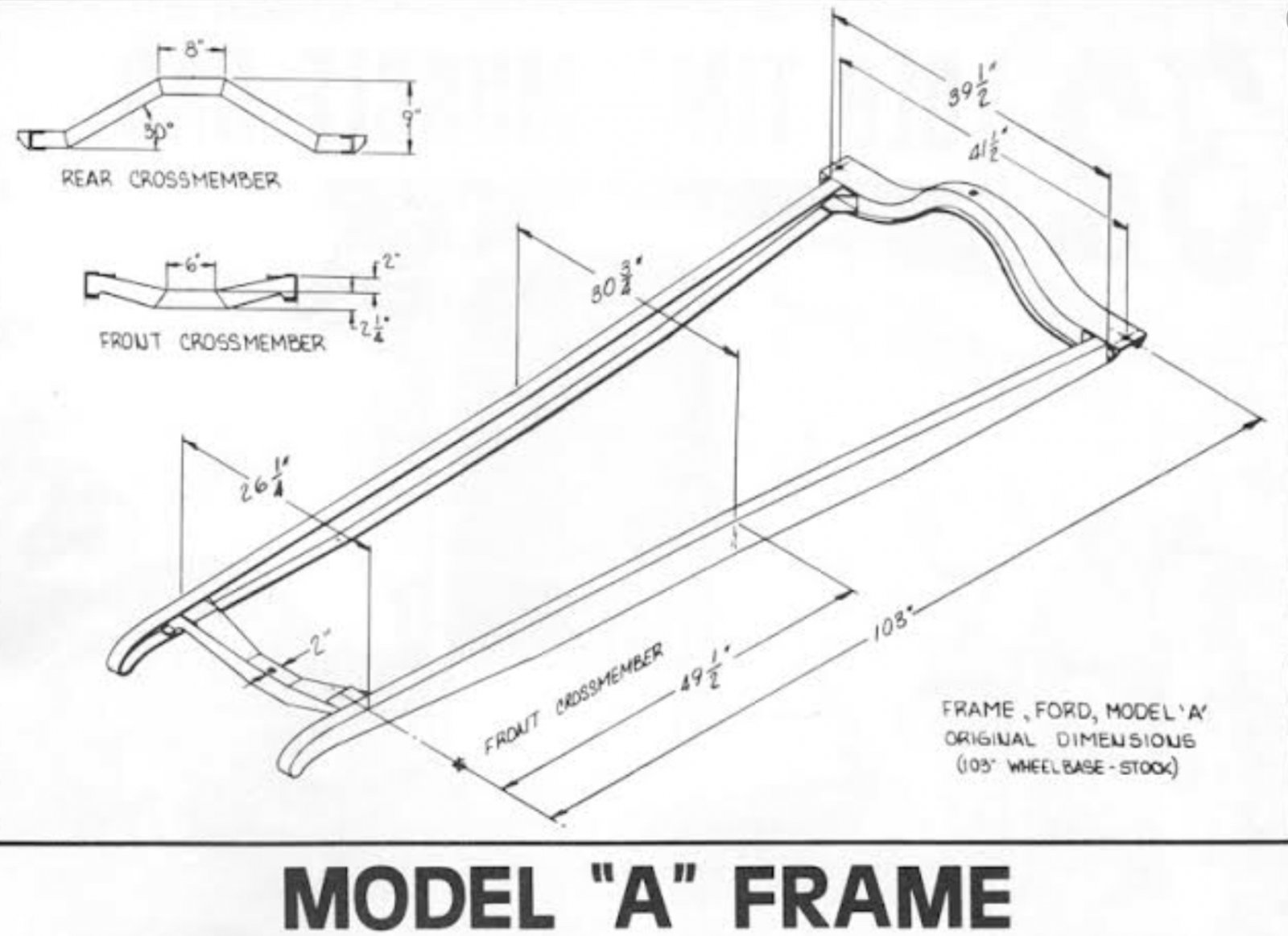

    Hey Guys.
    I am just wondering how many out there have built up their own Model A Frames.
    What kind of steel did you use ?
    How much did it cost ?
    How did you source the measurements, blue prints or from an original frame ?
    Did you build it stock style or with a stepped up rear ?
    Did you use a jig or rely on a level floor to get all the sections squared up ?
    Images below are for inspiration.
    2FAD9EA8-9863-456E-AA85-CADFC3B689B2.jpeg 848123B0-F868-4F7F-8F4C-67381F271FF2.jpeg 0FBB337E-732E-4A0B-86F6-C1CCF48DBC30.jpeg

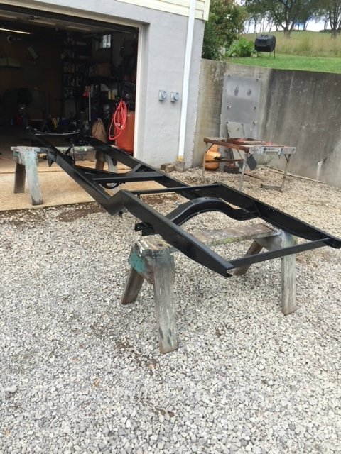

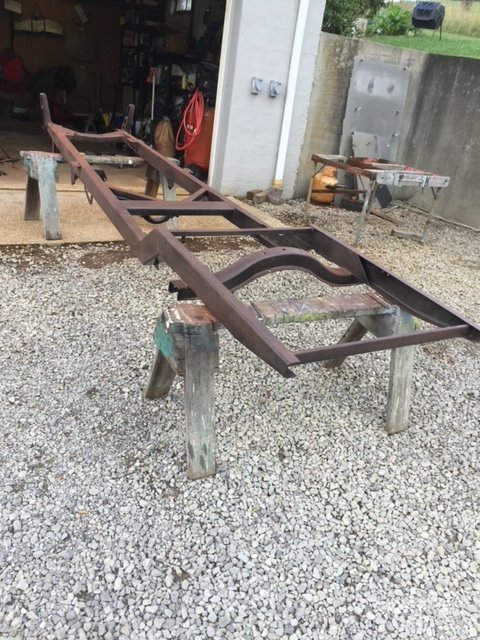

    Yeah, I made some. Start with 4 x 2 (100 x 50 x3mm) box tube and a repro front crossmember. Taper the rails where appropriate, put the kink in the right place, form the horns how they're supposed to be.
    Rear and middle crossmembers and kick up if any depending on the suspension and driveline.
    A flat floor, stringlines, keep everything square, level and held down.

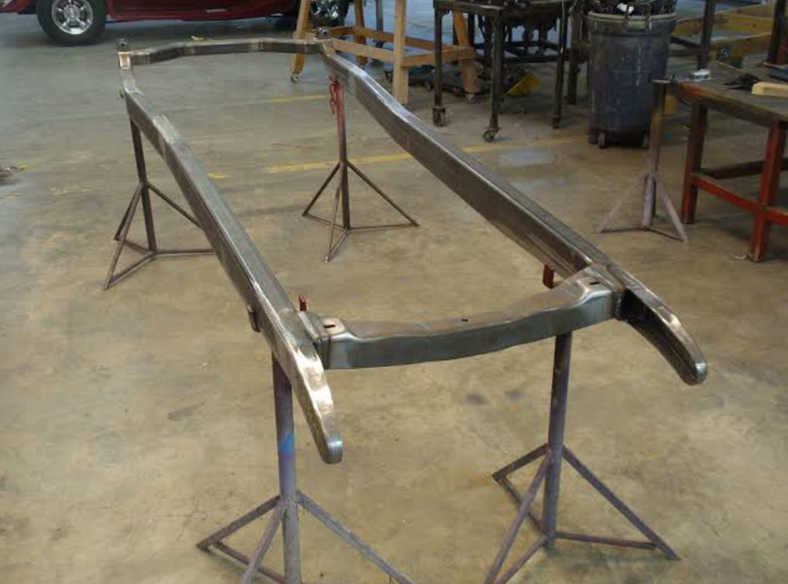

    This is one. The only pic I have handy.

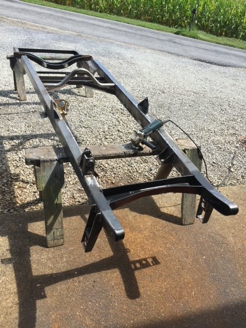

  3. RICH B
    Joined: Feb 7, 2007
    Posts: 5,956
    RICH B

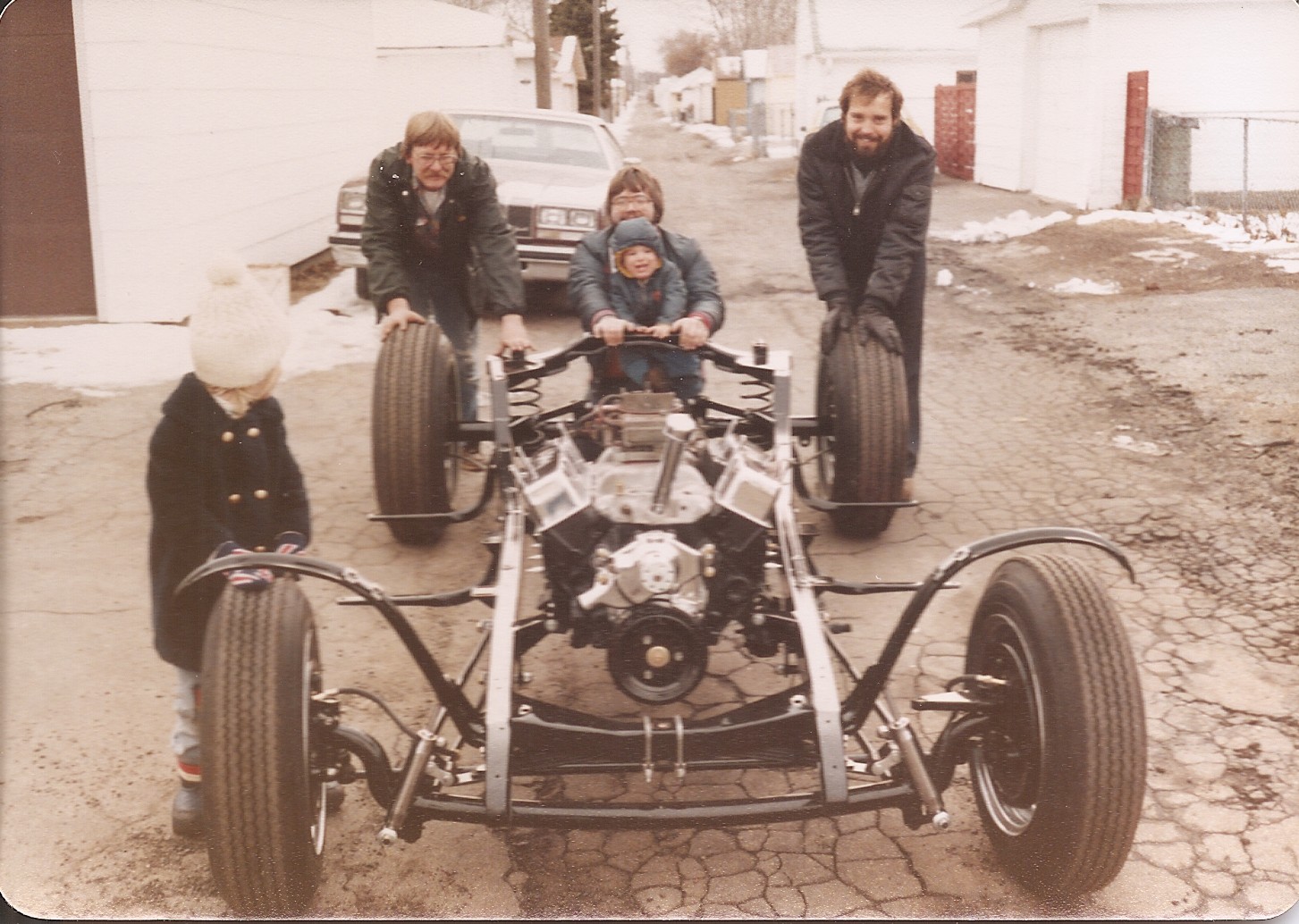

    Copied a bent Model A frame using 2x4 10 ga tube. Tapered the front and made the frame horns from flat stock. Made the front cross-member from three pieces of 1/4" flat, a center cross-member out of tube, and an A rear cross-member. I laid a 4'x8' 3/4" plate on a couple horses at work and built the frame on it. We built this for a fender car so it was set up for running board and fender braces. Steel was under $100 for everything; but it was 40 some years ago. Still have drawings and patterns. Last A's I've worked on, we used boxed stock frames.

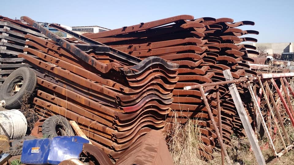

  16. RICH B
    Joined: Feb 7, 2007
    Posts: 5,956
    RICH B

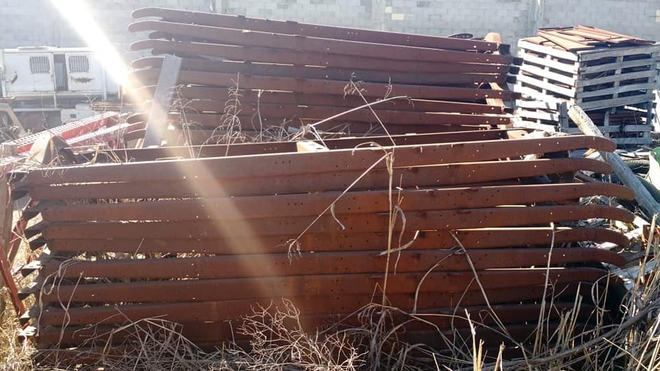

    Wonder if these piles of repop A frames are still down in Argentina. Kinda a neat Z on the one.

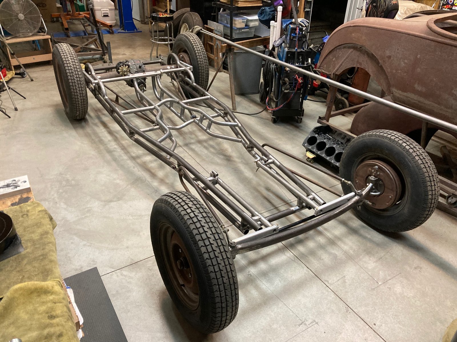

    Built this ch***is from scratch for a '29 roadster. Used similar spec sheets as to what you posted, drew up some dimensions on the shop floor, and went to work. Built a jig from those dimensions, then got to work bending the tubing. I don't think this is exactly what you were looking for, but thought it'd be a good example of what can be done on the shop floor with a little hot rod ingenuity.
