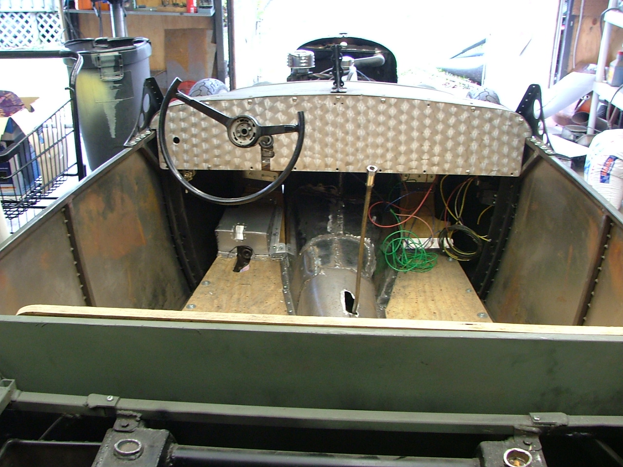

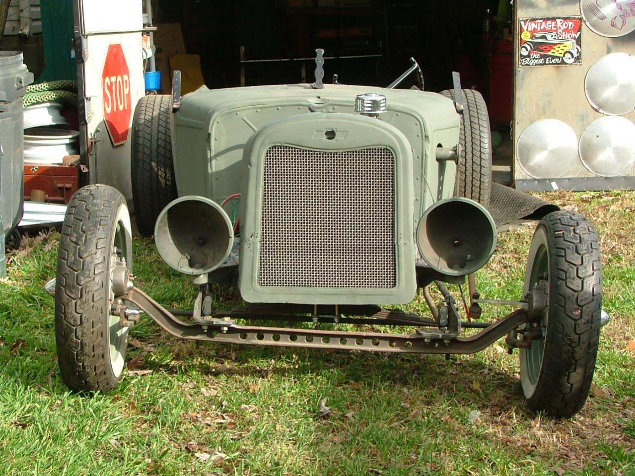

  27. the-rodster
    Joined: Jul 2, 2003
    Posts: 6,959
    the-rodster
    It's easy, just follow these 20 steps.....
  28. grainmaker
    Joined: Jan 18, 2010
    Posts: 29
    grainmaker
    Sweet! Thats likes a mans grocery list right there!!
  29. the-rodster
    Joined: Jul 2, 2003
    Posts: 6,959
    the-rodster
    And you end up with this....
