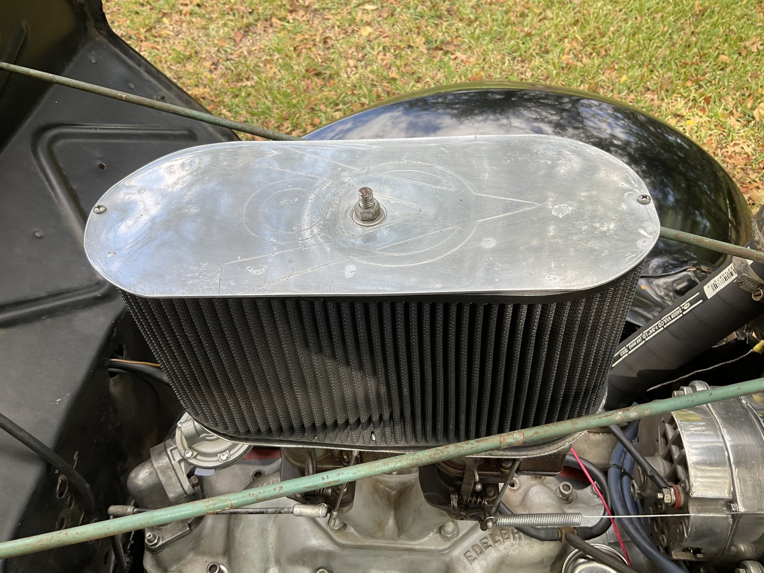

    As @tubman said, I feel the key is the balance between breathing and compression. When building a good reliable hotrod flatty, doing all the little things really adds up.
    Screenshot_20241111_012600_Amazon Shopping.jpg Screenshot_20241111_012714_Amazon Shopping.jpg
