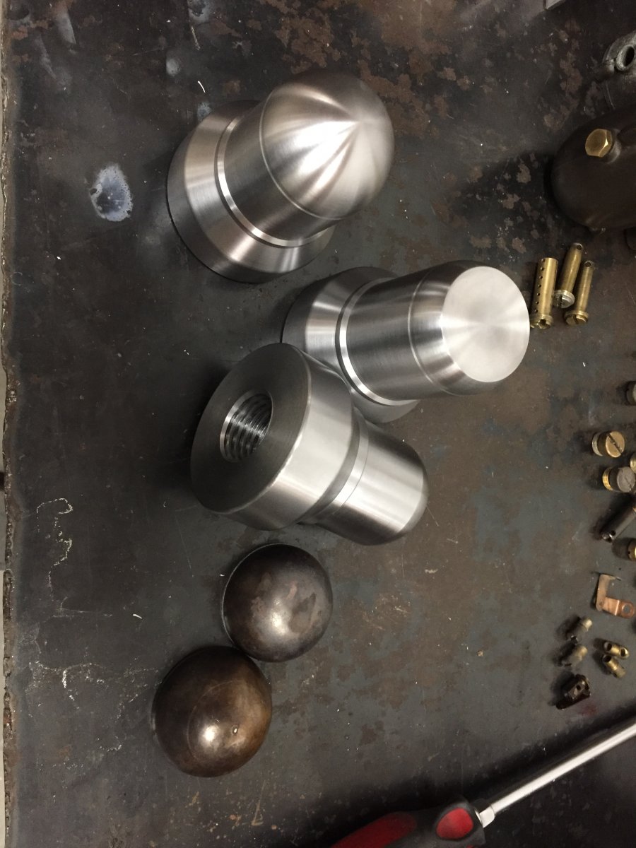

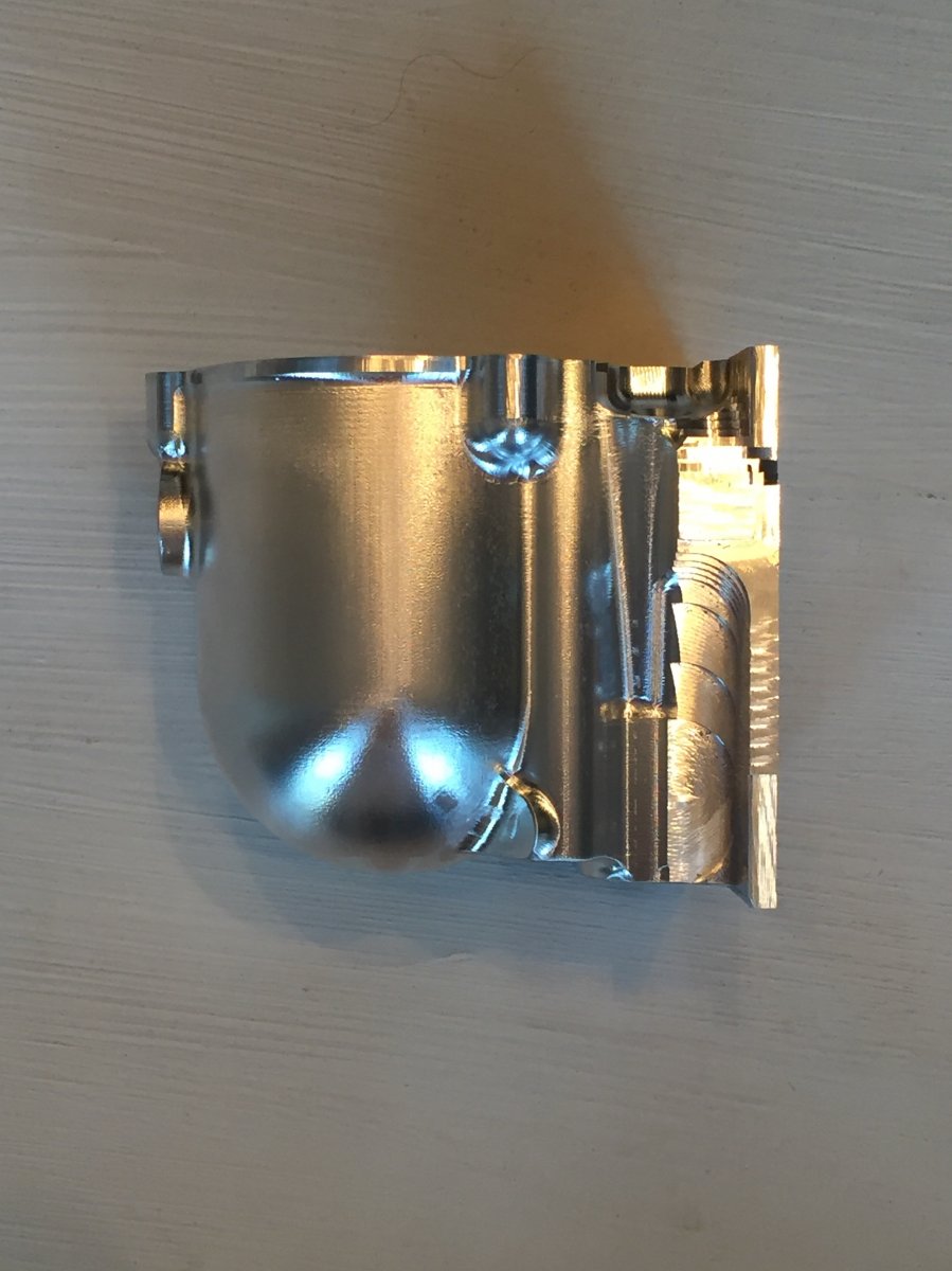

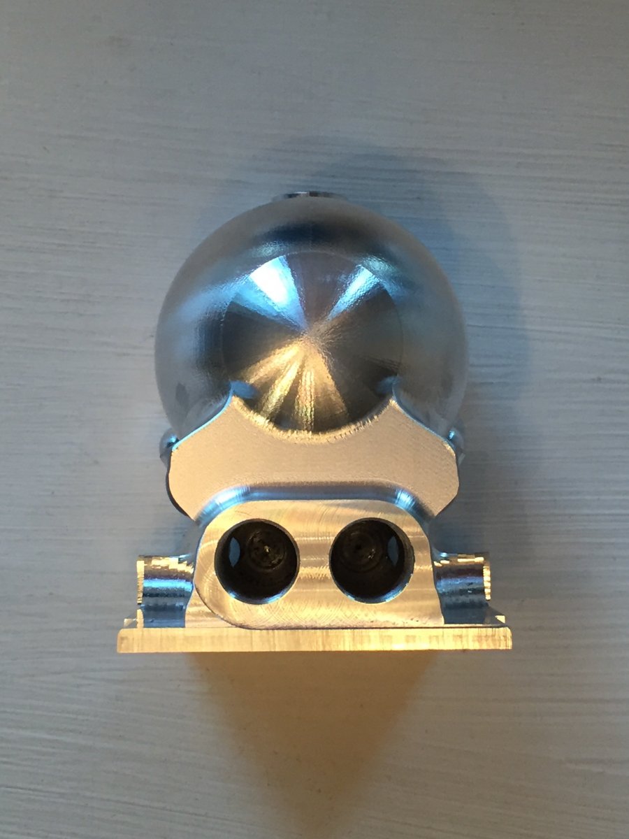

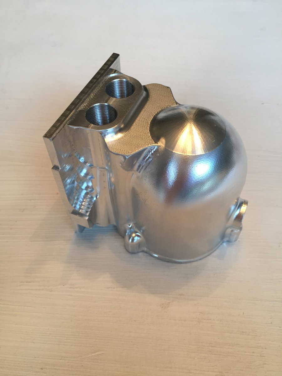

    So I was keeping an eye out for a enough parts to piece together a pair of Winfield S-B downdrafts... and basically found nothing worth paying money for. So I started building what I needed... I’ve already made the choke horns and V band clamps, as I figured that was as far as I would go. But after sifting thru a half a dozen cracked, stripped, and broken carbs bowls only to salvage a couple br*** pieces, I decided to go “all the way”! At least I’ll have a matching pair when I’m done!
    Here are a few pics of the progress so far...
    9E822420-CDF3-4A1C-B8C8-DACE07D60902.jpeg 51D5F9E9-A4B1-40AC-B8AD-E58A3C07071F.jpeg CE303324-A612-414A-B349-0C9FD99F16E7.jpeg 50F1CC34-AFF9-4CBC-9790-54BBEDC250AA.jpeg 3C4B0722-153F-4792-93DB-AC3E8810962D.jpeg

  13. Kevin Pharis
    Joined: Aug 22, 2020
    Posts: 751
    Kevin Pharis
    from Califunny
    Casting these would be great...! Would be a lot less work and could get the engraving just rite too. But have to weigh the cost of tooling against volume, not to mention the tooling charge to set up each run at the foundry... oh yeah, all the different pieces too...
    Billet will just have to work for now... especially with my budget

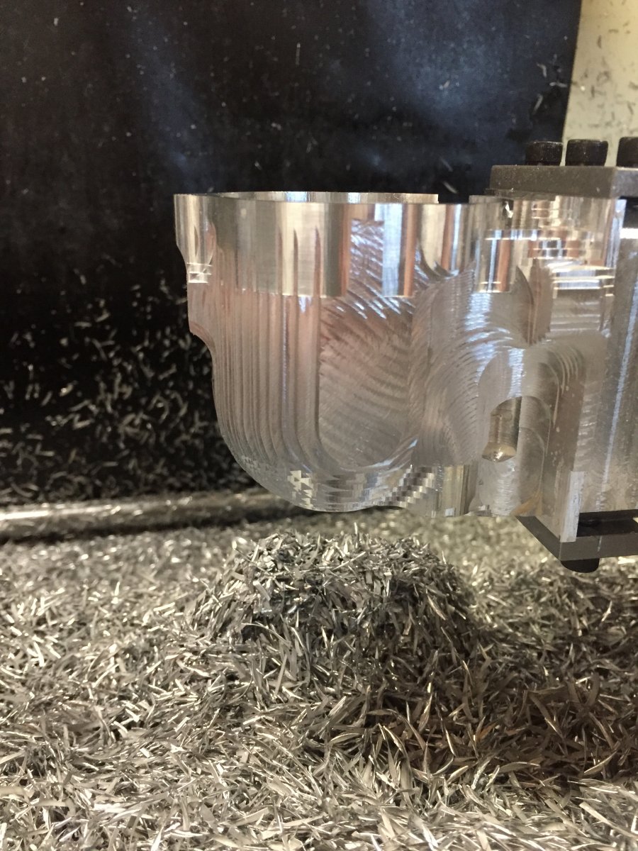

  14. The37Kid
    Joined: Apr 30, 2004
    Posts: 32,771
    The37Kid
    Only CNC stuff I know about is seen on TV, is this piece just a block that gets clamped in a fixture and everything we see is machined away without another setup? Bob

  16. cadillacoffin
    Joined: May 30, 2007
    Posts: 1,128
    cadillacoffin
  17. Kevin Pharis
    Posts: 751
    Kevin Pharis
    from Califunny
    Yup! Here’s an action shot...

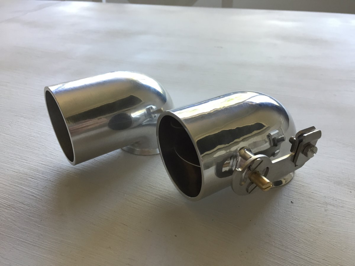

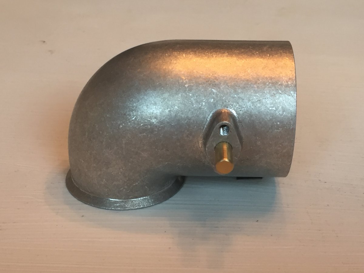

  24. I suppose you could go over the oblivious areas with a needle scaler to sort of give a somewhat cast appearance and make it less obvious that it was billet. Mr. Bill aka @wstory has used that technique with success on his project.
    Having said all that, I think you are doing amazing work!
  25. Kevin Pharis
    Posts: 751
    Kevin Pharis
    from Califunny

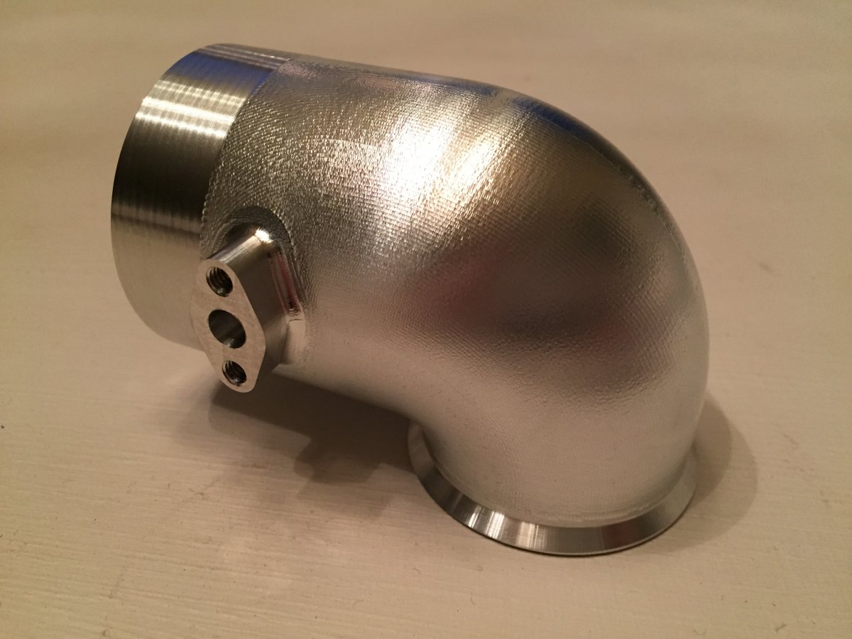

    The carb body will be blended and then tumbled to give a much less billet look... here is a couple shots of the choke horn before and after tumble, and also polished...

  26. I agree, it does look great after the blending and tumble!

    I want to build up a copper plating system to apply an original type finish.
    The tumbled finish is nice as it is basically 400 grit non directional sanding. Basically ready for painting or polishing... but I suspect would look pretty dull if I were to copper plate at this point. Would no doubt look great if the parts were polished prior to plating... but the originals definitely were plated right after casting. So will take some experimentation before I decide if copper plating is something I want to do for myself... or others.
