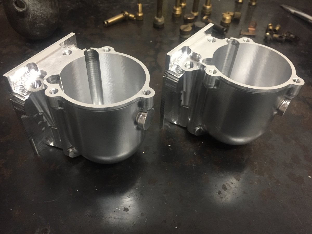

    With the float tooling in the hands of the metal spinner... I started designing the fixture to finish the float bowl. Hopefully will have some finished float bowl pics by this weekend

    Honestly, that tumbled finish has the look of a carb that has lost the factory plating.

    I feel the pain of a dozen aluminum splinters looking at that pile of shavings!!!

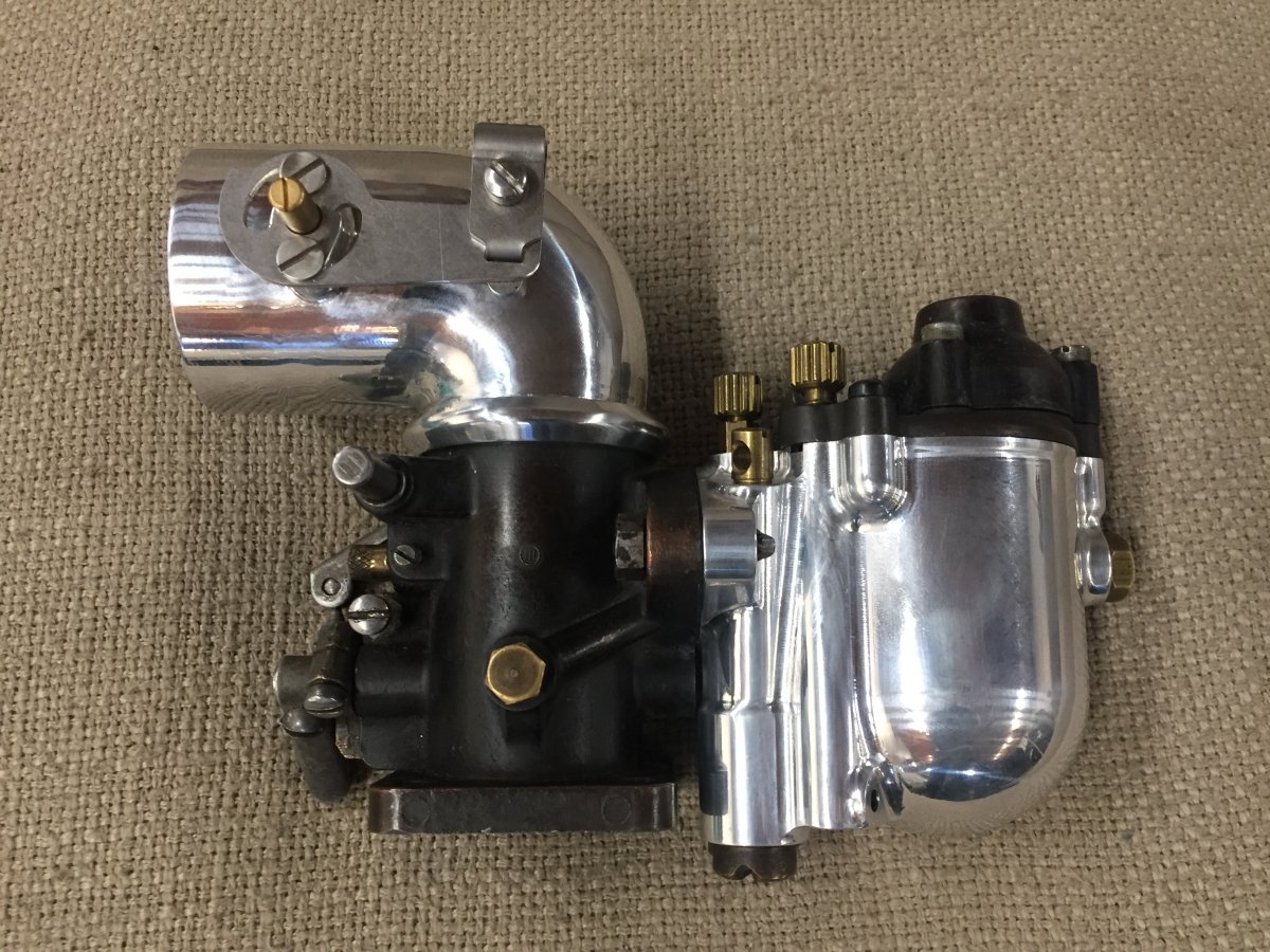

    Well... turns out the first one was no accident! Cuz the second one came out real nice

  6. Happydaze
    Joined: Aug 21, 2009
    Posts: 2,439
    Happydaze
    I'm searching for something for an intelligent and insightful comment. The best I can come up with right now is wow!! Or ****ing wow!!

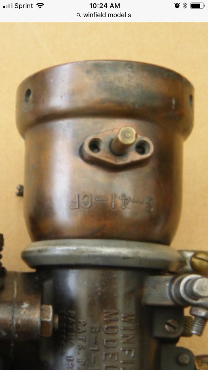

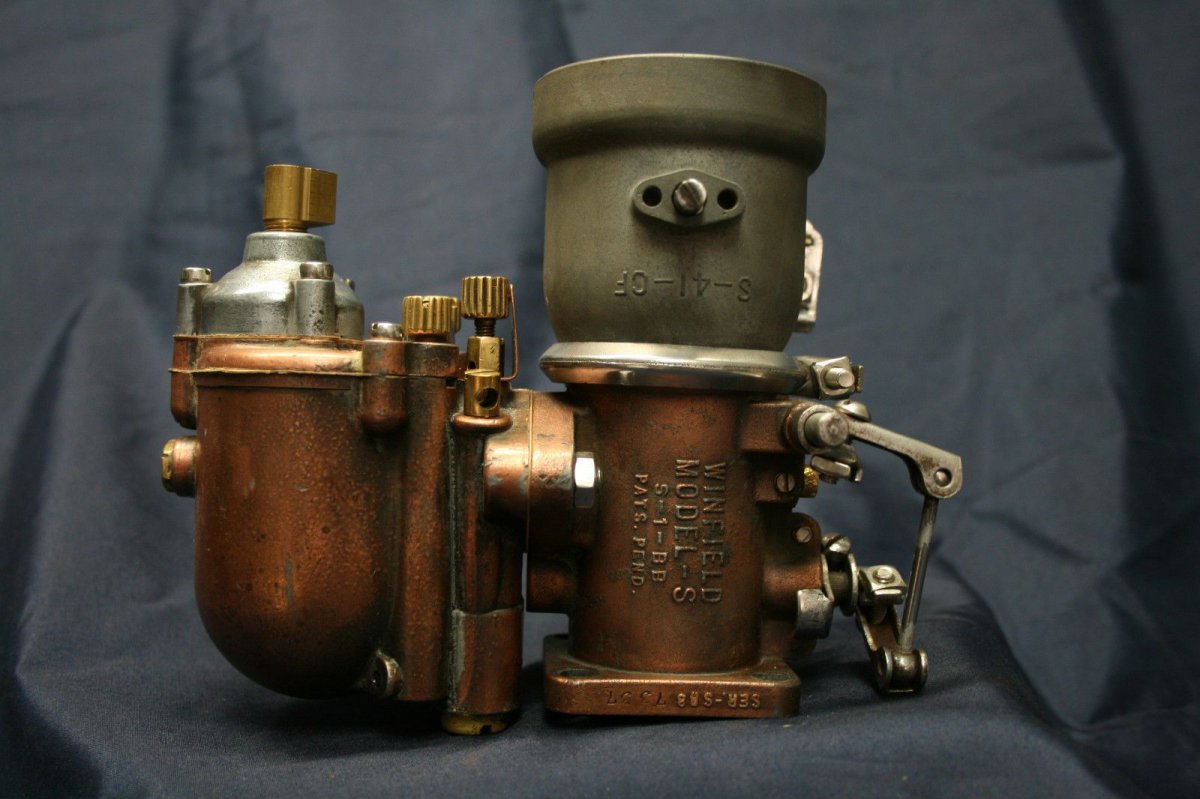

    Beautiful work. For reference, here's an original (I wasn't sure what they looked like).
    Outback, Lil'Alb, Stogy and 8 others like this.

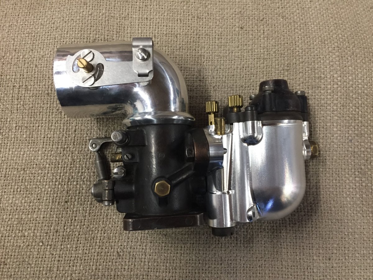

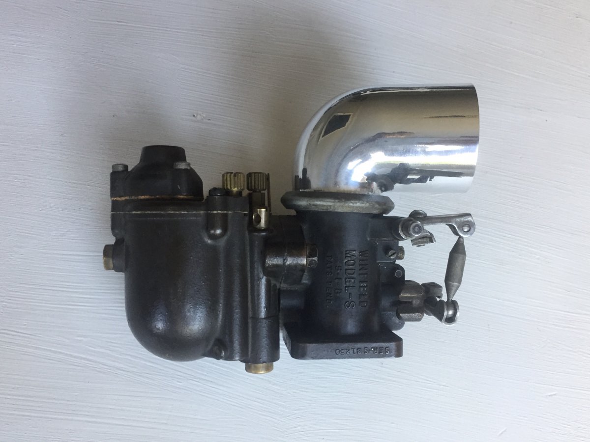

    I scored a S-B at a swap meet years ago and a SR-C years before that, both were as close to NOS as one could hope for. I made a promise to myself a while back that I would stop collecting other peoples junk, but I’m a few generations removed from buying “used” car parts. Here’s a pic of my B as it sits today, the one shown above has clearly had a vinegar bath to clean it up. The copper plating doesn’t stay bright very long...
    These carbs were plated as raw die castings, and are covered with texture and imperfections. They would have looked a lot like the carb shown above when new, but would have been a long way from the finish of a shiny new penny!

    Note, the carb above is shown with one of my new billet machined choke horns installed. The original choke horns appear to have been supplied as raw die cast, as I have not seen any signs of copper plating on the straight or elbow horns, or any signs of factory polishing.

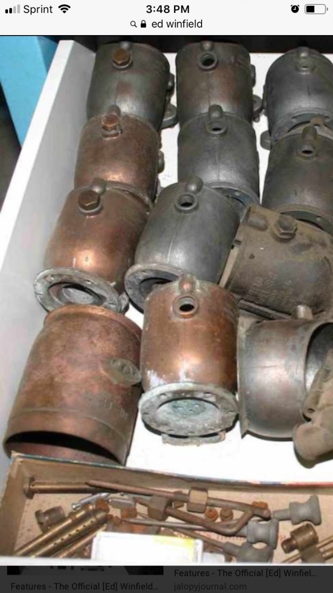

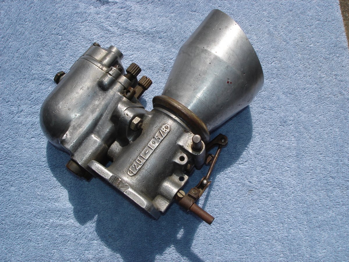

    I have seen a few pics of carbs that appear to have copper plated choke horns, but the color never matches the carb bodies and I suspect that the “copper color” is actually the zinc base metal tarnishing into a light brown color. Here is one such pic...

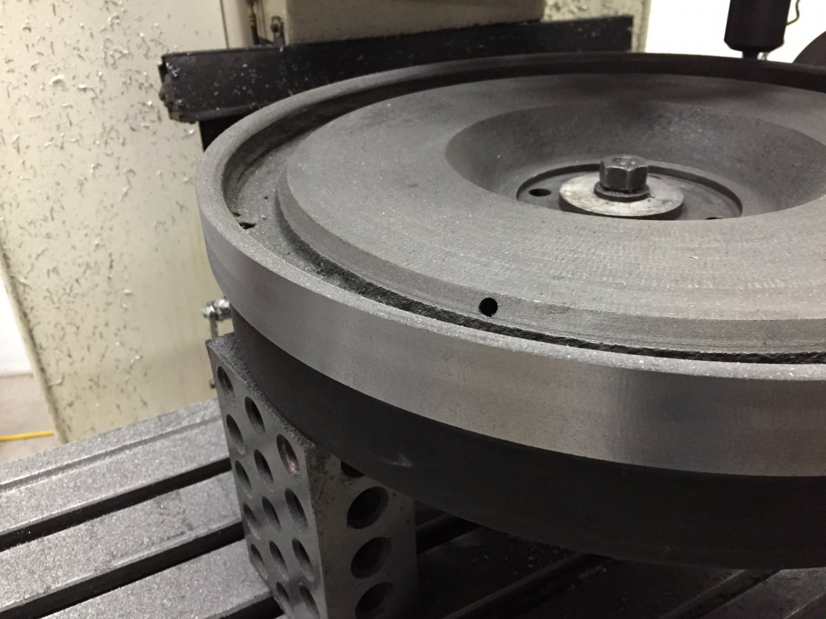

    A 1916 Overland flywheel with a few less ring gear teeth than intended. Machine off the original integral iron teeth, to make room for a new shrink fit ring gear... DUN!

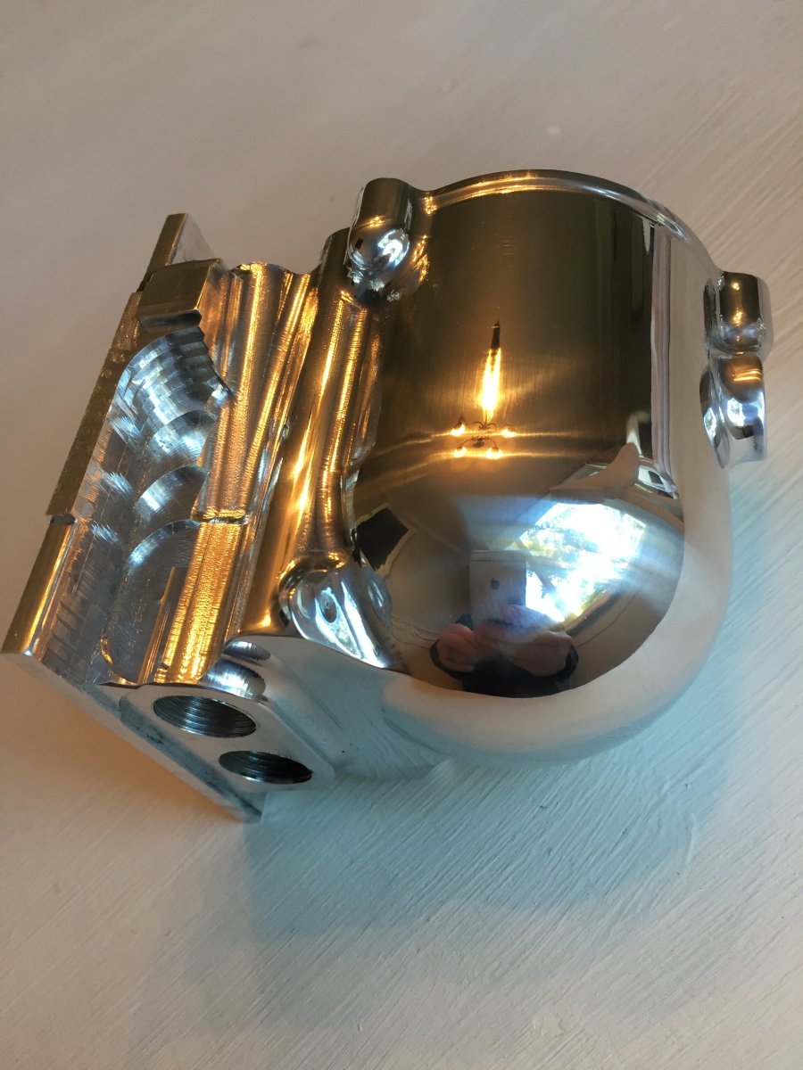

    Well... I musta done sumthin right!!!:D

    Here we are after a few minutes up against the buffing wheel.

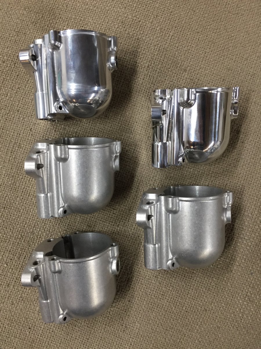

    Here’s all 5, deburred, tumbled, and cleaned. Now I can plug off the fuel p***age and these ******s are DUN!
    Not sure bout the rest yet... but the 2 polished ones are goin on my car!:cool:
