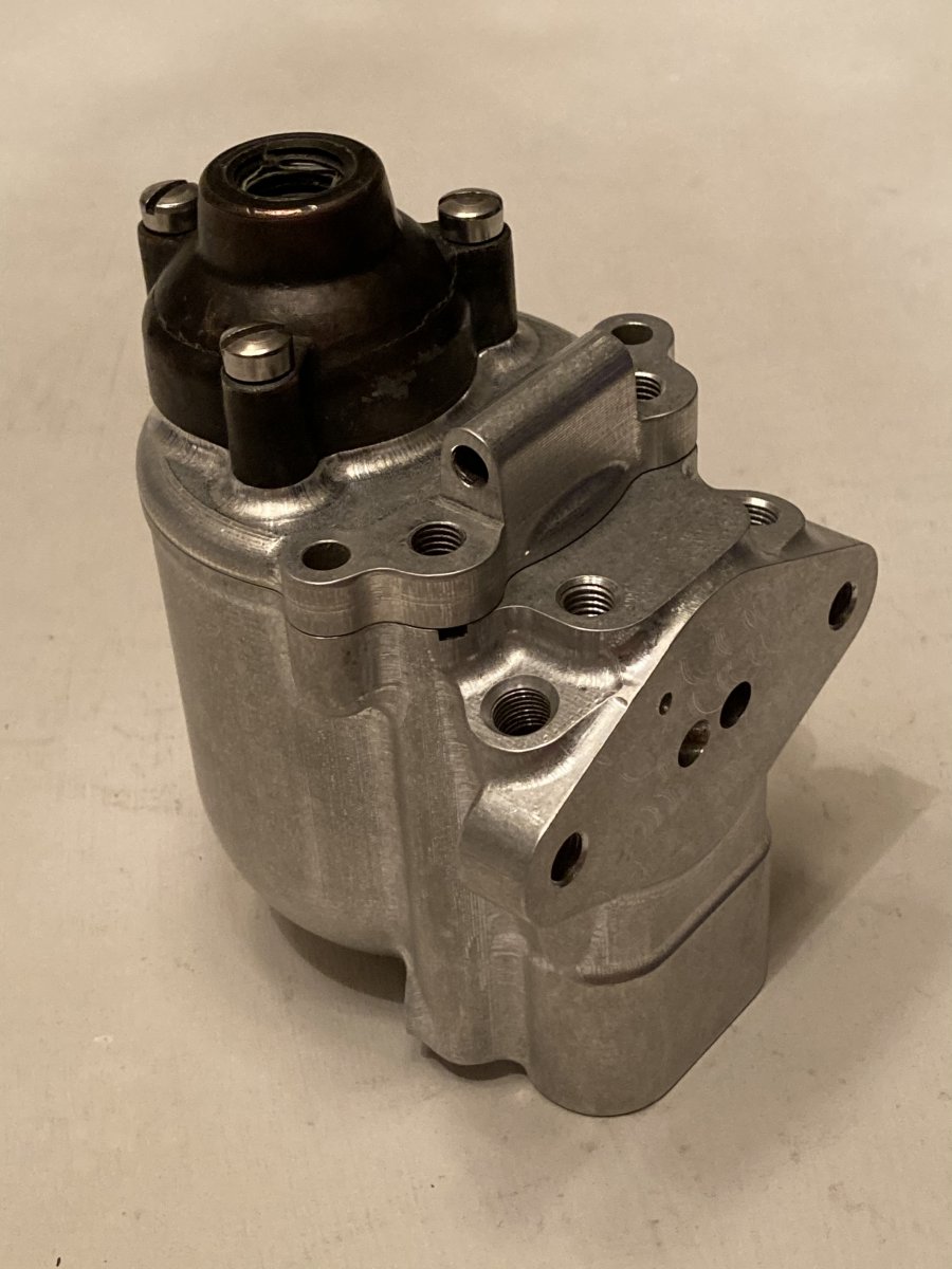

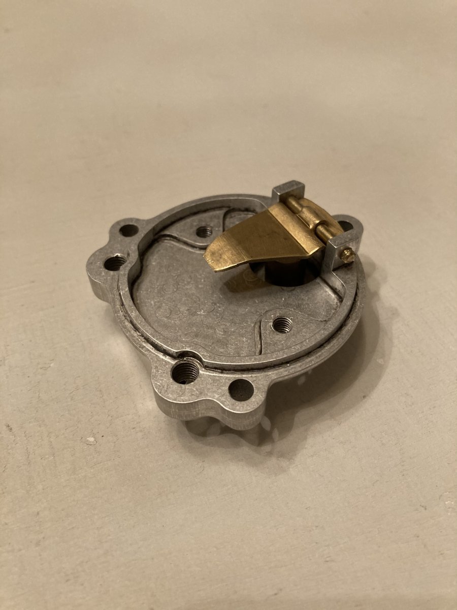

    Got these from the metal spinner today...
    We are reallllly close! Just a couple minor tweaks... and I’m ready to solder!

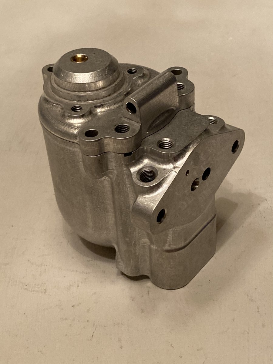

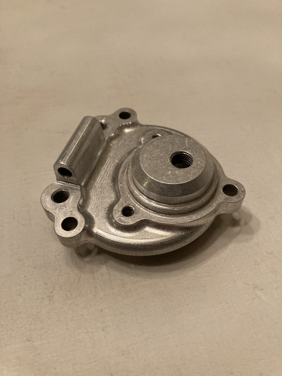

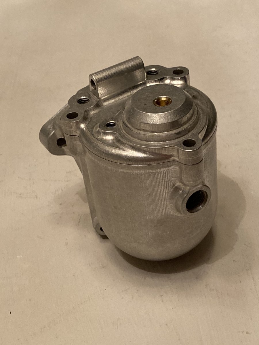

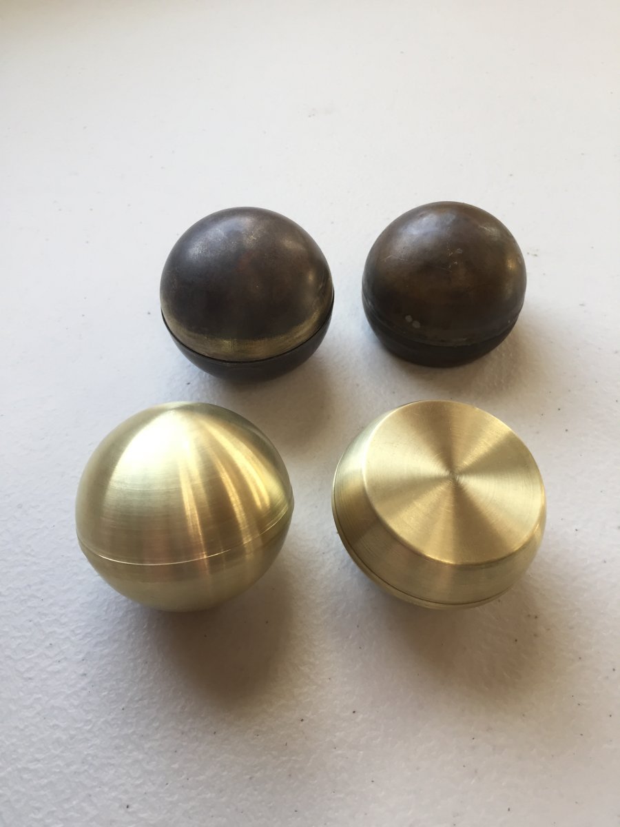

    As of last nite... float tweaks have been made, and a batch of S and SR floats are on order from the metal spinner. Should be soldering in no time!
    Also was able to get the float bowl cover finished up...
    BD3ED11F-0604-438A-930A-F27B99BC637B.jpeg CD8D1837-FD9A-46B0-BA56-F106A33D218C.jpeg
    The float bowl cover is slightly different than an original, as it was designed to incorporate a modern fuel valve with viton tipped needle. I was also able to retain interchangeability with all the original float hardware and fuel inlet block, so this float bowl cover can be directly interchanged with an original.
    E4BAD903-B669-489F-93E6-E5A9255AF98E.jpeg 10069F70-F9C8-4F33-BEAC-51B40C912A40.jpeg DB95F0B2-C95D-4975-B9EF-81C8E2842C94.jpeg
    Now just have to build a tool for crimping the cover to retain the detent balls. Already have the stainless springs and balls to install.

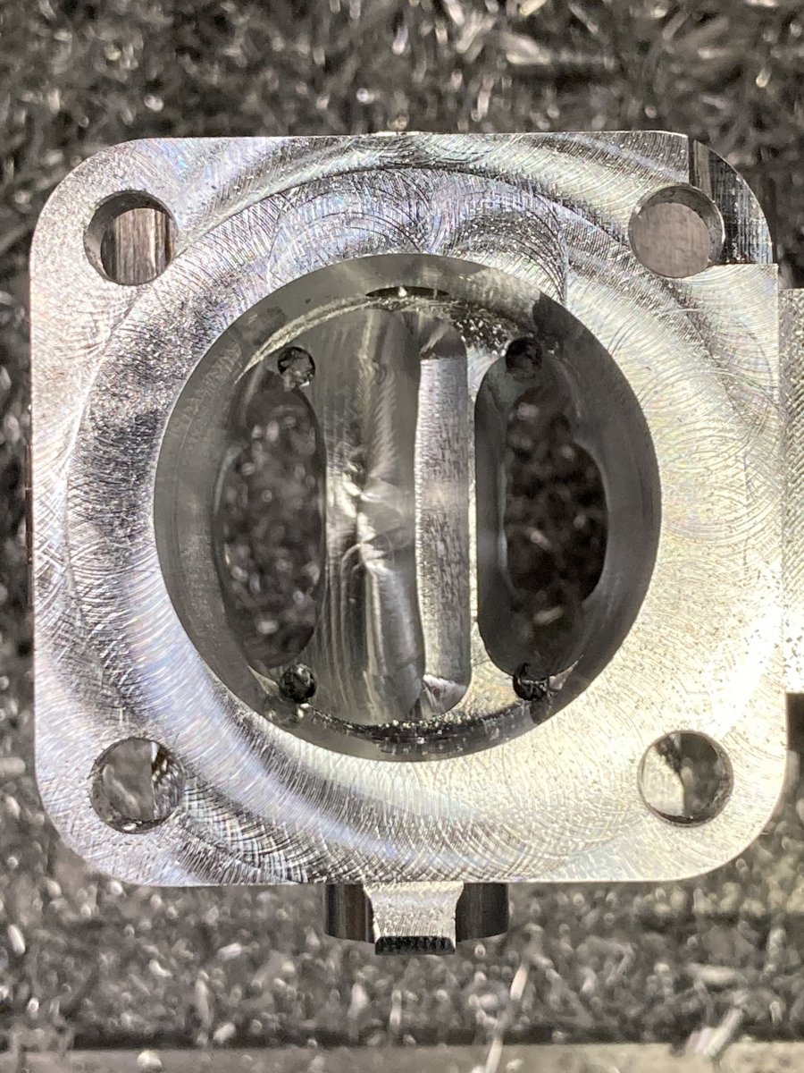

    Now on to the throttle barrel!

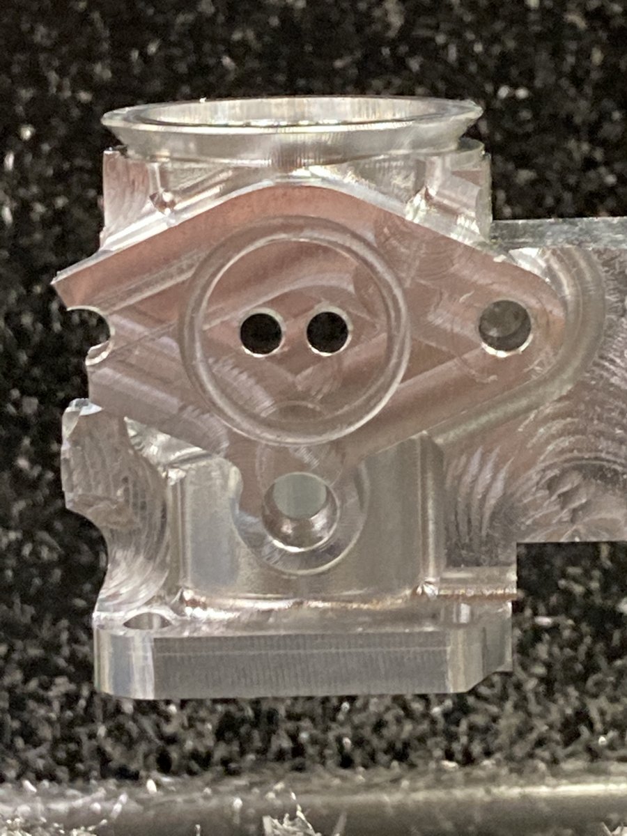

    It took a bit longer than expected... but I’m finally ready to make some real progress on the Winfield S-B throttle barrel! After probably 150 hours of design and programming, I hope to finally start cutting on a block of aluminum tonite.:eek:
    To be continued...

    Was able to spend the day in the shop today, and made some good progress on the first operation of the throttle barrel. This one won’t be perfect as there were a few small “oops” moments along the way... but should finish out good enough to test with if I can avoid any major mistakes before finishing. This is as far as I could go with the tools on hand, and won’t be able to finish the center bore till I order a few special tools next week

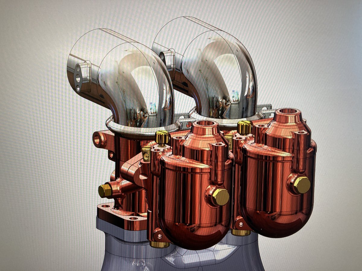

    The current plan is to produce the S-B downdraft carburetor in its entirety. I should be able to finish 5 complete carbs... then I’ll figure out if there is enough interest to make more... or maybe even other sizes...?

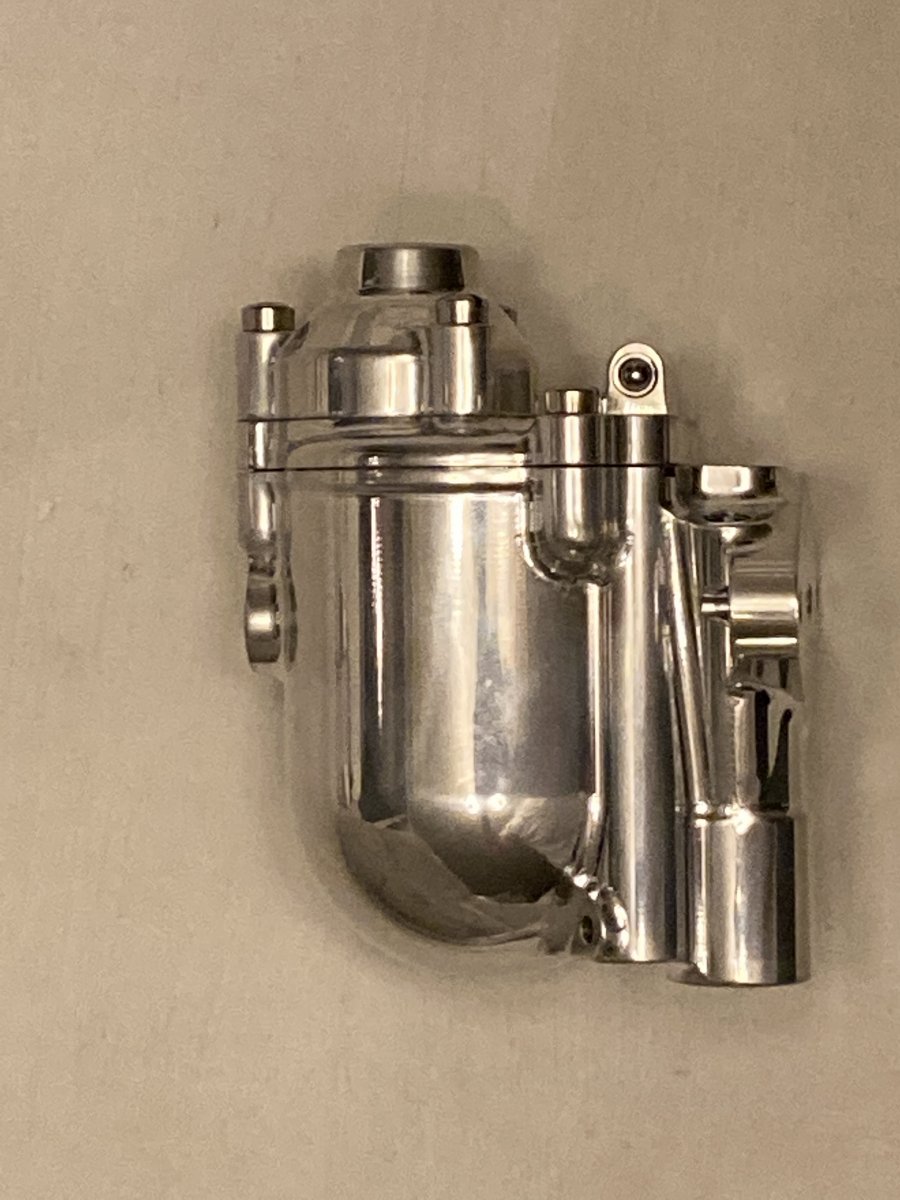

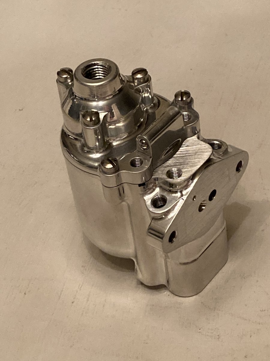

    I’m not exactly close to making this decision, but...
    Should I polish...?
    Or copper plate...?
    I’m thinkin copper plate!:D
