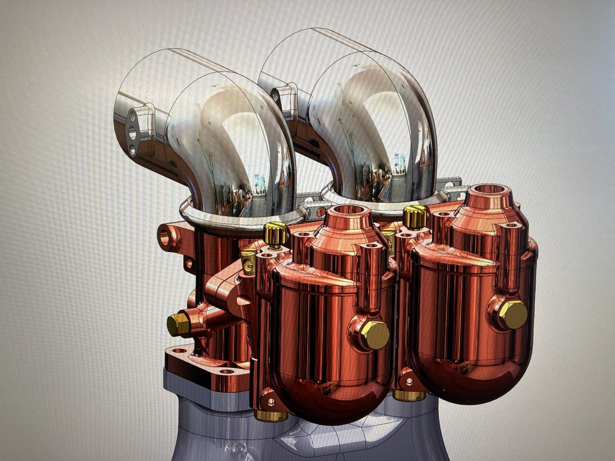

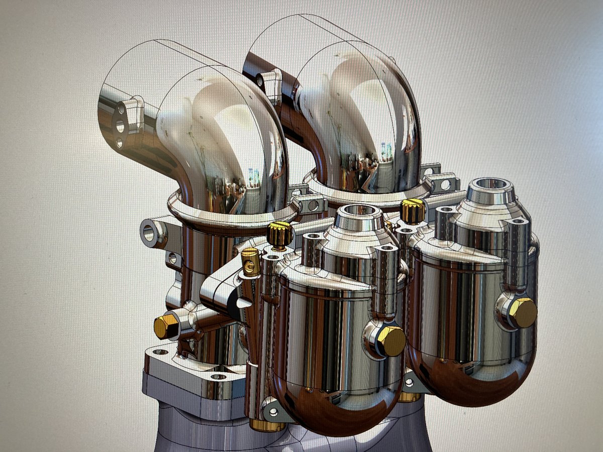

  1. I would say either fully polish, or fully copper plate.
    I'm a fan of the polish look myself.

    What CAD program did you model it in? Just curious.
    Stogy and loudbang like this.
  4. Kevin Pharis
    Joined: Aug 22, 2020
    Posts: 829
    Kevin Pharis
    from Califunny
    This was done in SolidWorks...

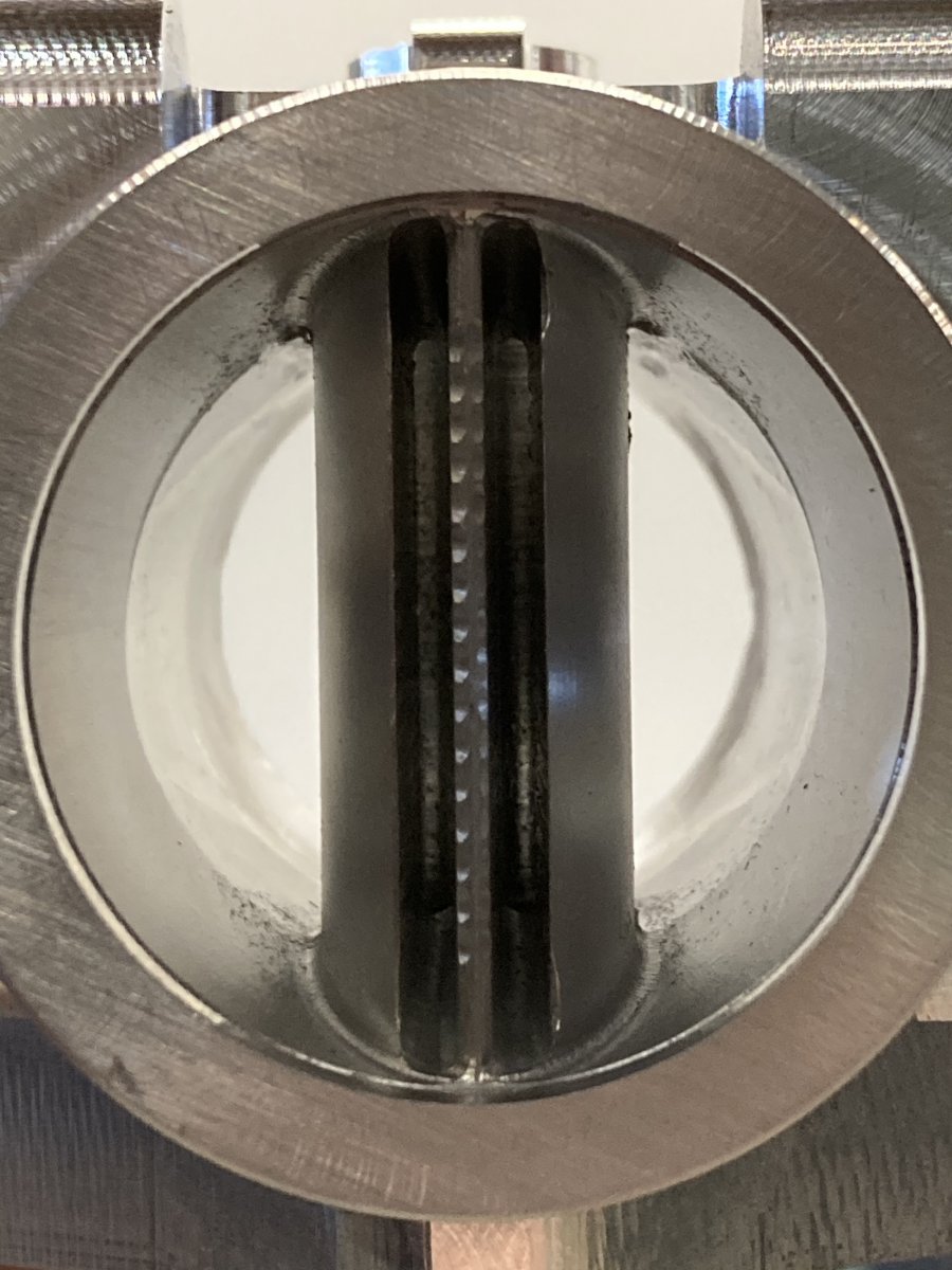

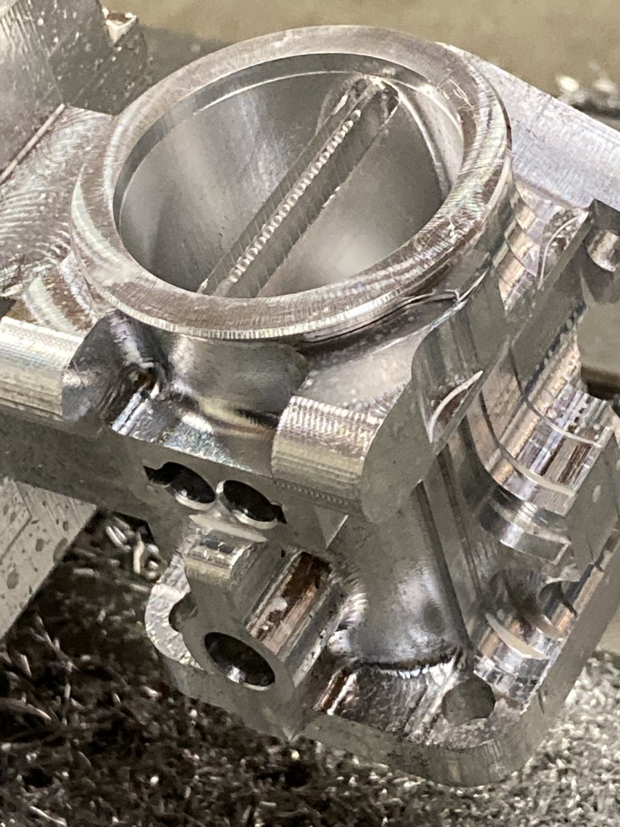

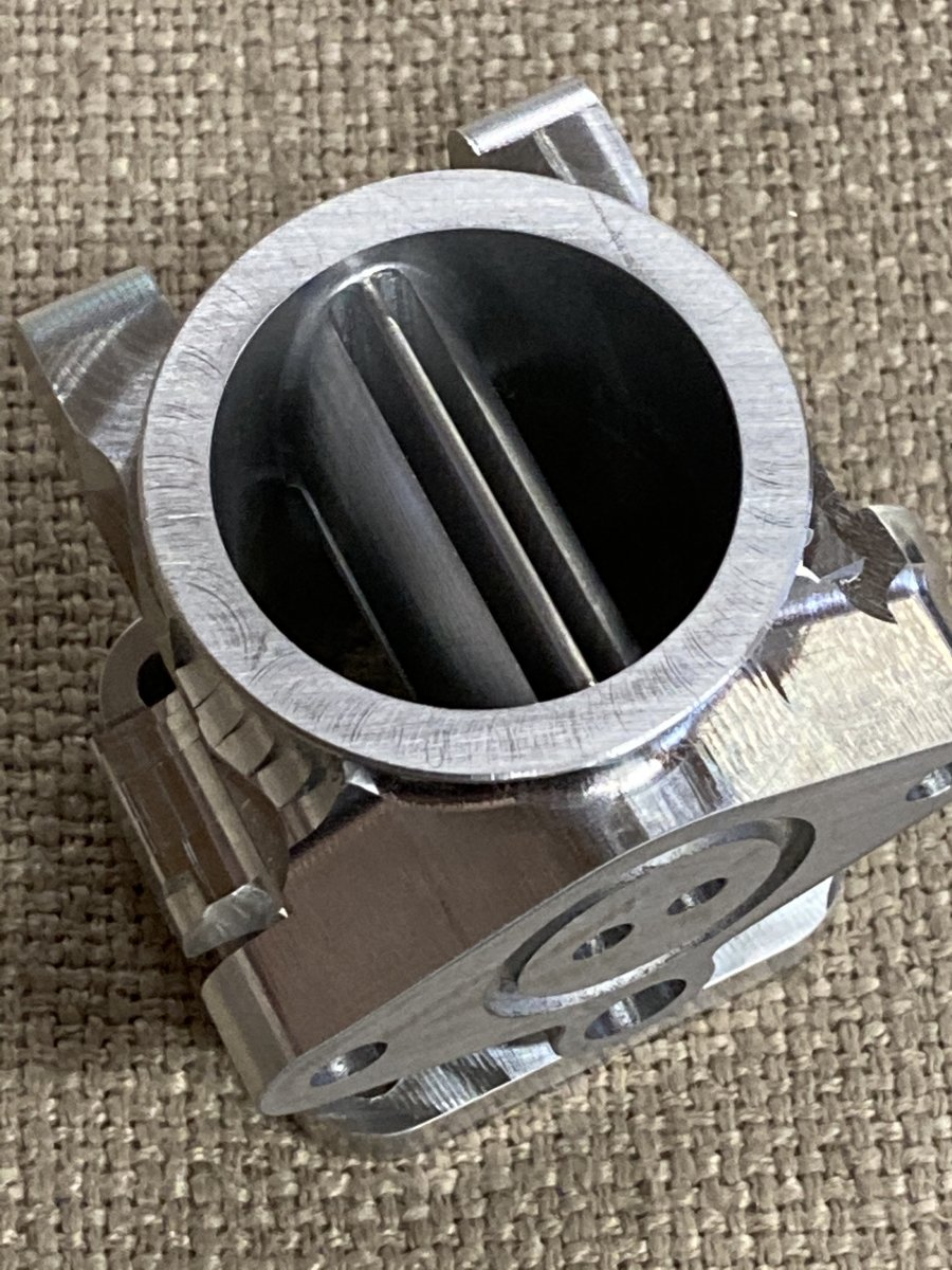

    Was able to get most of the throttle barrel internal section finished up yesterday. Ran into an unexpected clearance issue on the ****erfly side of the venturi, so am waiting for some new tools... again!:rolleyes:
    Here is a pic of the top half of the venturi and the spray bar air inlets
    Outback, Stogy, KiWinUS and 10 others like this.

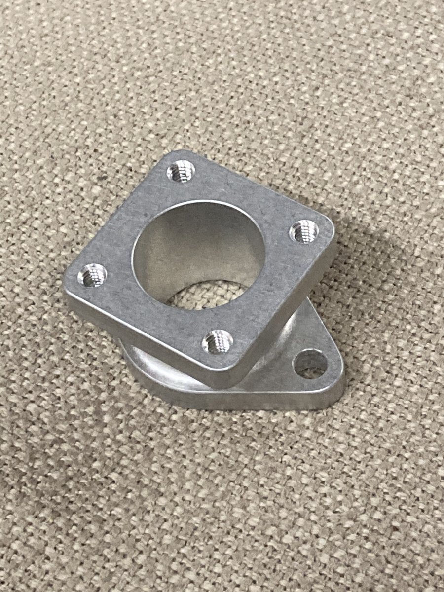

    While waiting for the special tools to finish the throttle barrel... I made some more fuel inlet blocks, and also some Winfield S-A to Model A manifold adapters

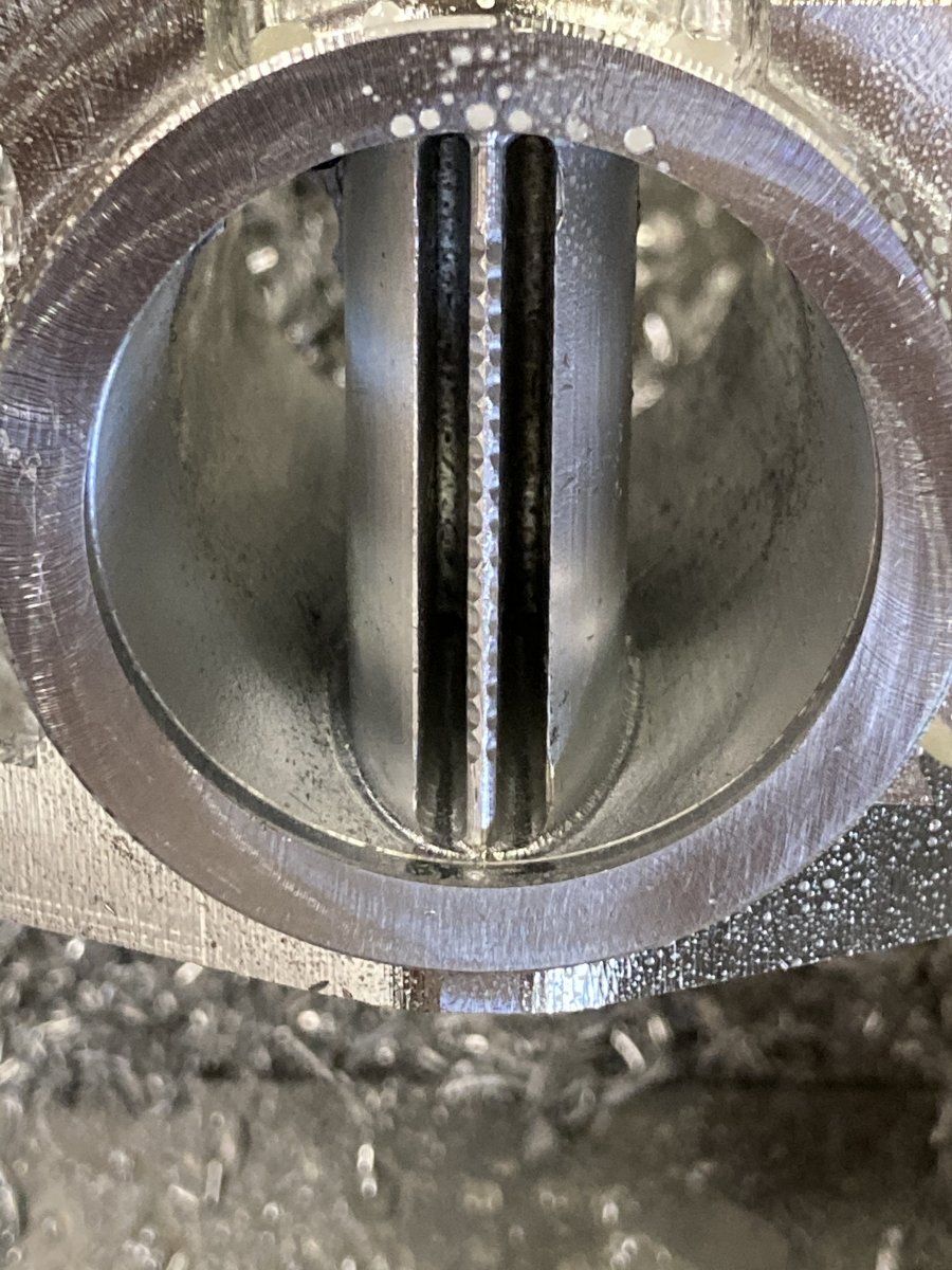

    Last weekend was dedicated to ironing out the issues of the first part... and it was no small task! Tooling was adjusted, fixturing was reworked, programs were reconfigured, and somehow I still found the time to run another part... but this time without the oops!
    As long as I can keep from screwing this one up during the next operation, this throttle barrel should finish into a good part!:eek:

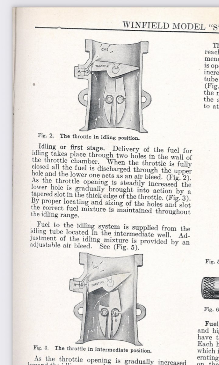

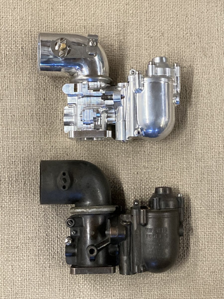

    Here is a shot of the original literature showing the throttle barrel in cross section during all 3 fuel circuits. Once I have 5 of these ******s to go along with my float bowls, it’s time for the throttle plates... and testing!!!:D

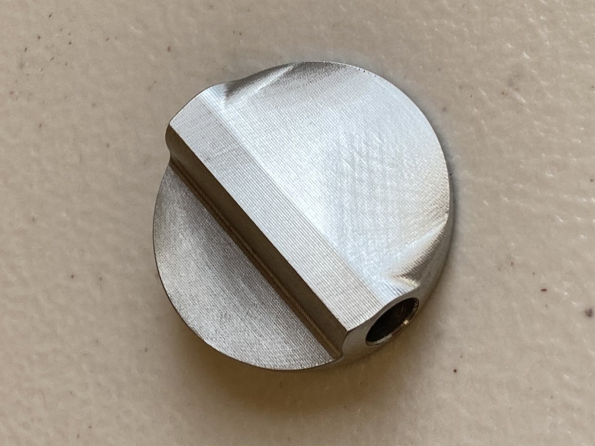

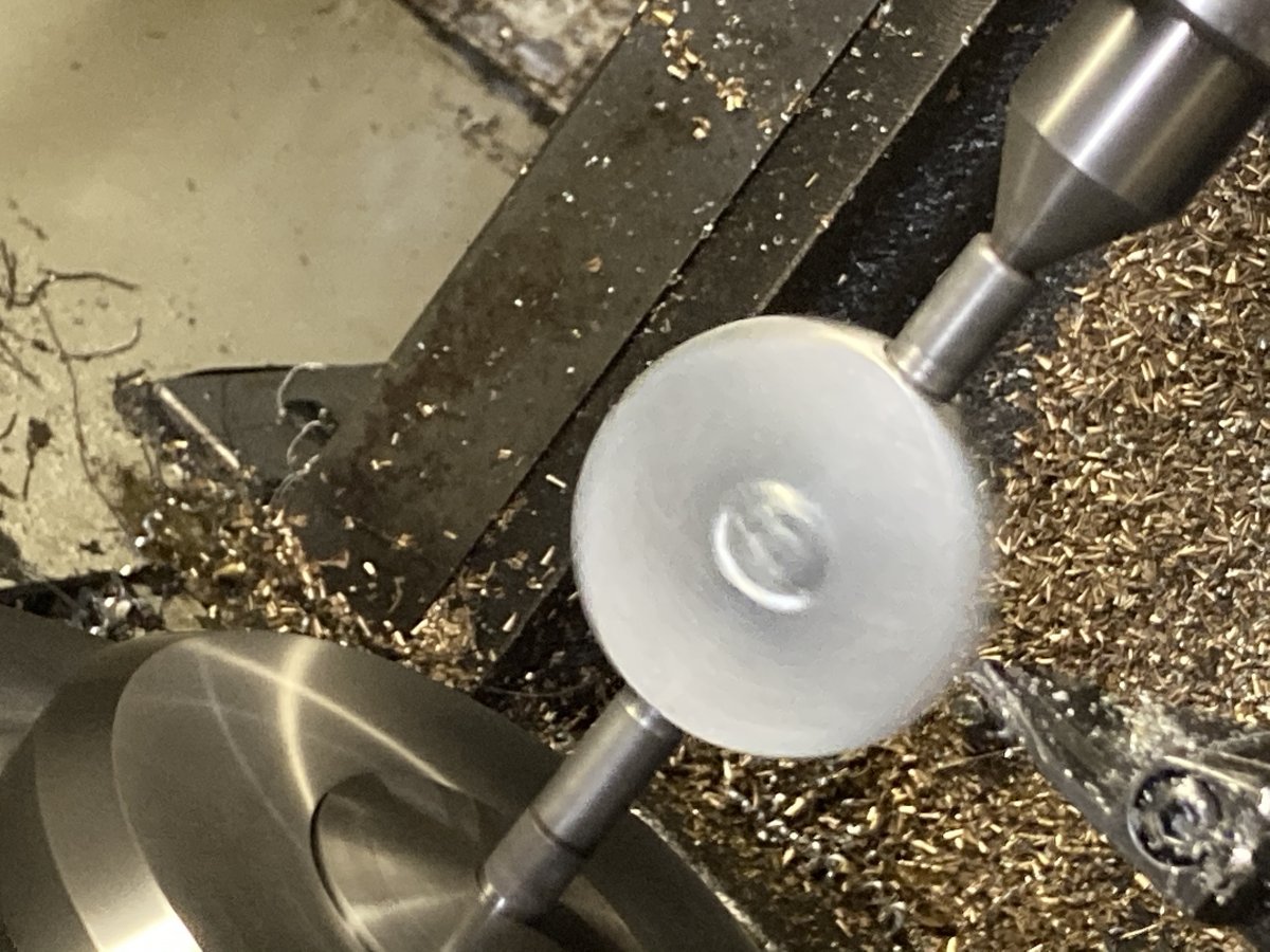

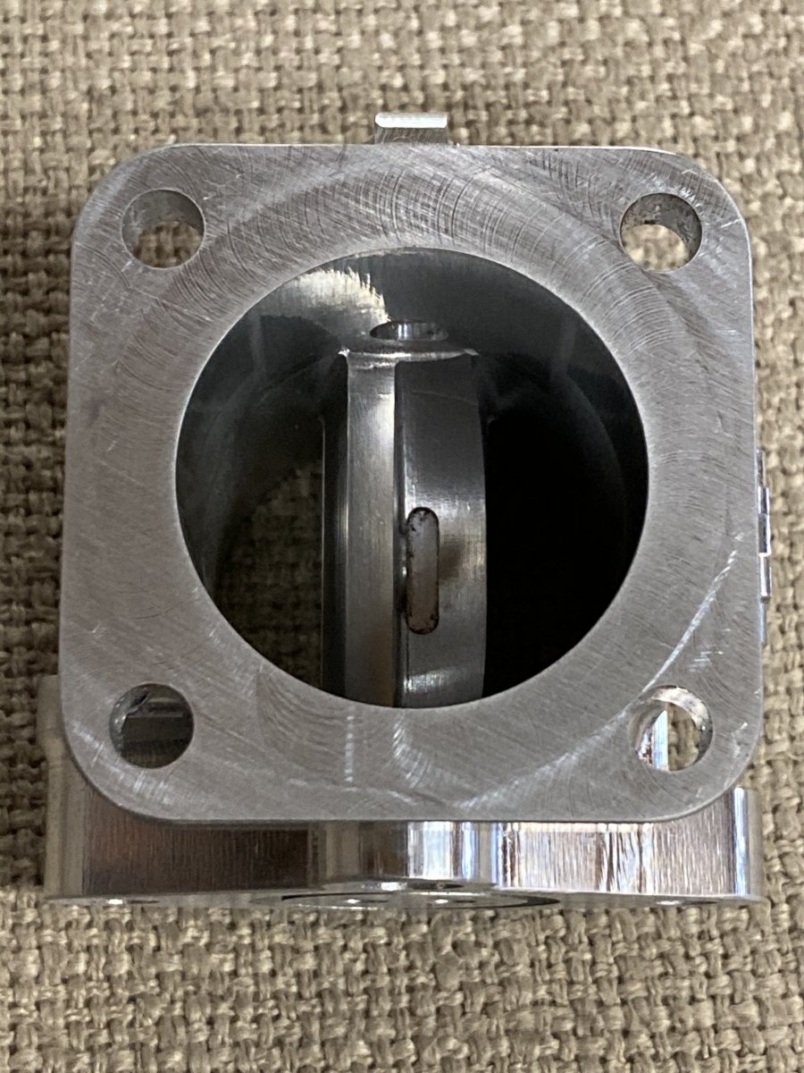

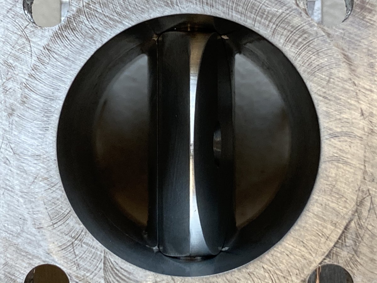

    Was at it again today... this time building throttle plates. Not near as simple as a conventional ****erfly plate, these are basically a segmented ball bearing. After a bit of head scratching, I was able to make some chips and now have a couple throttle plates that fit my new throttle barrels
    Here we are getting spherical
    And finished
    And installed
    Outback, Stogy, mvee33 and 11 others like this.

    Thanks fellas! This was a big relief to get these throttle plates done and installed... after spending 2+ months getting 5 throttle barrels made up, I finally feel like this is all going to work out...!:eek:

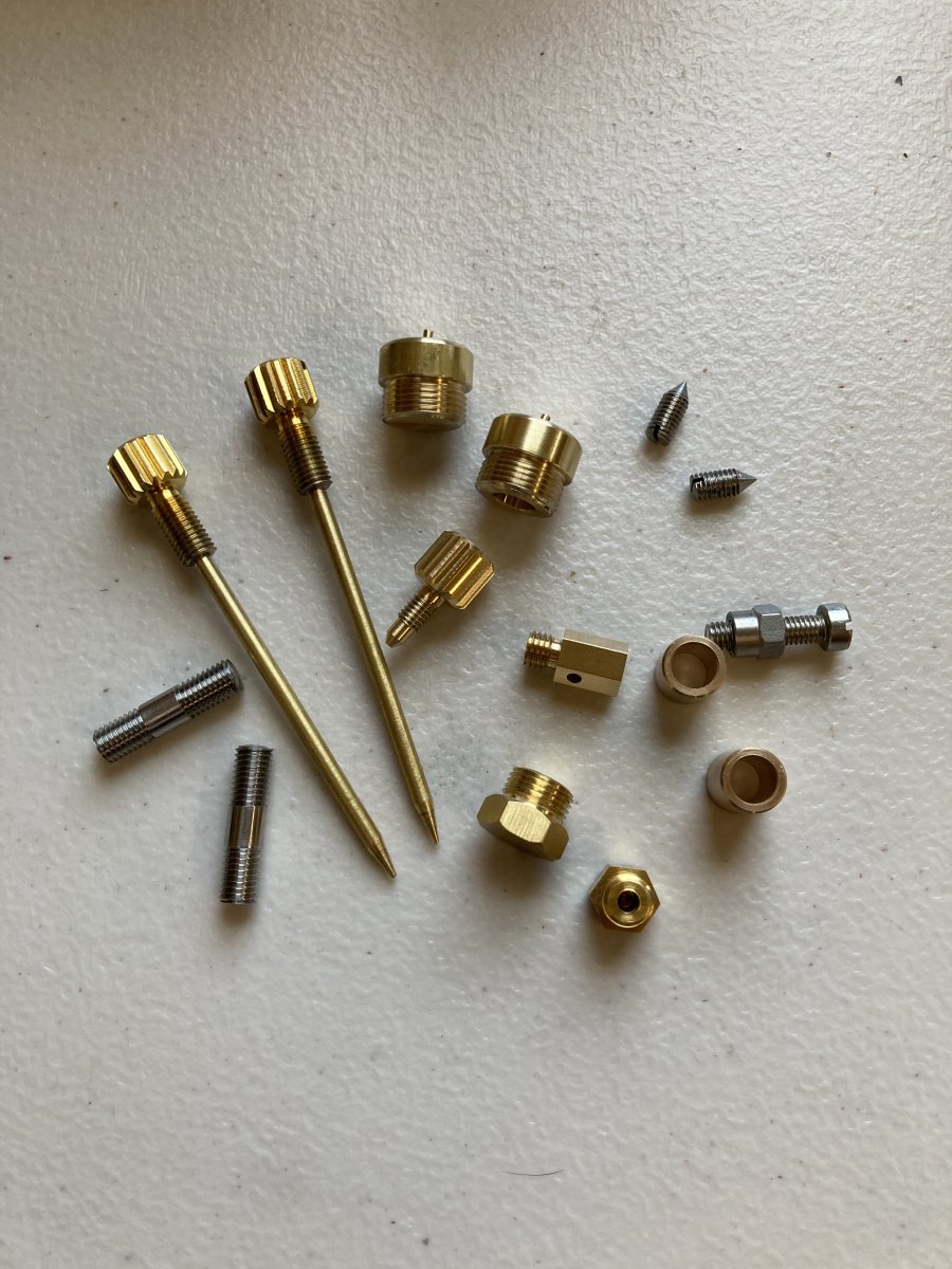

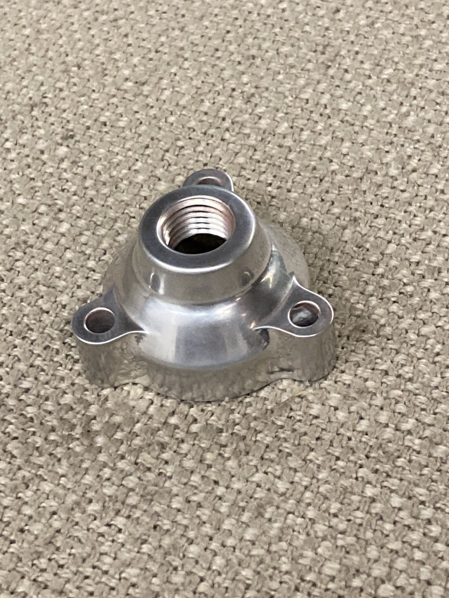

    Been having small successes lately... with small parts. Still have a few more pieces to go, but have made throttle bushings, idle byp*** plug, int/high speed adjusting needles, idle needle, idle needle seat, bowl to barrel studs, idle stop screw and jam nut, spray bar retaining screws, float level plug, and int/high speed accelerating well plugs.
