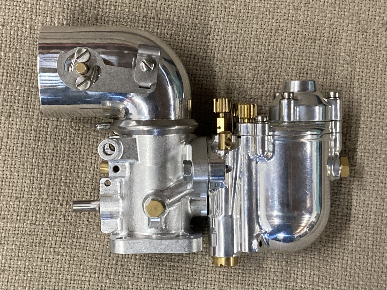

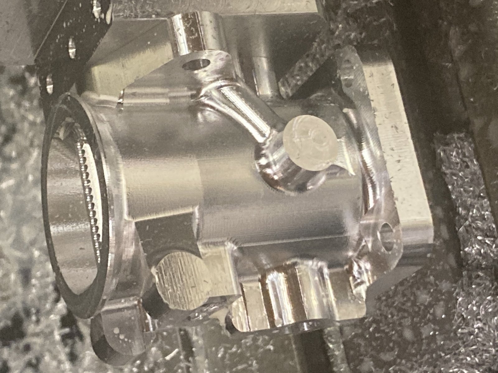

  4. Kevin Pharis
    Joined: Aug 22, 2020
    Posts: 829
    Kevin Pharis
    from Califunny

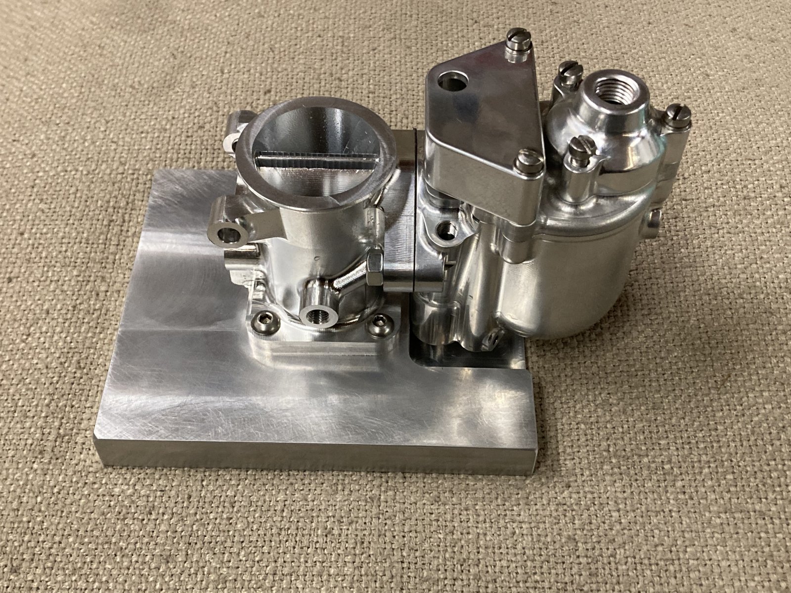

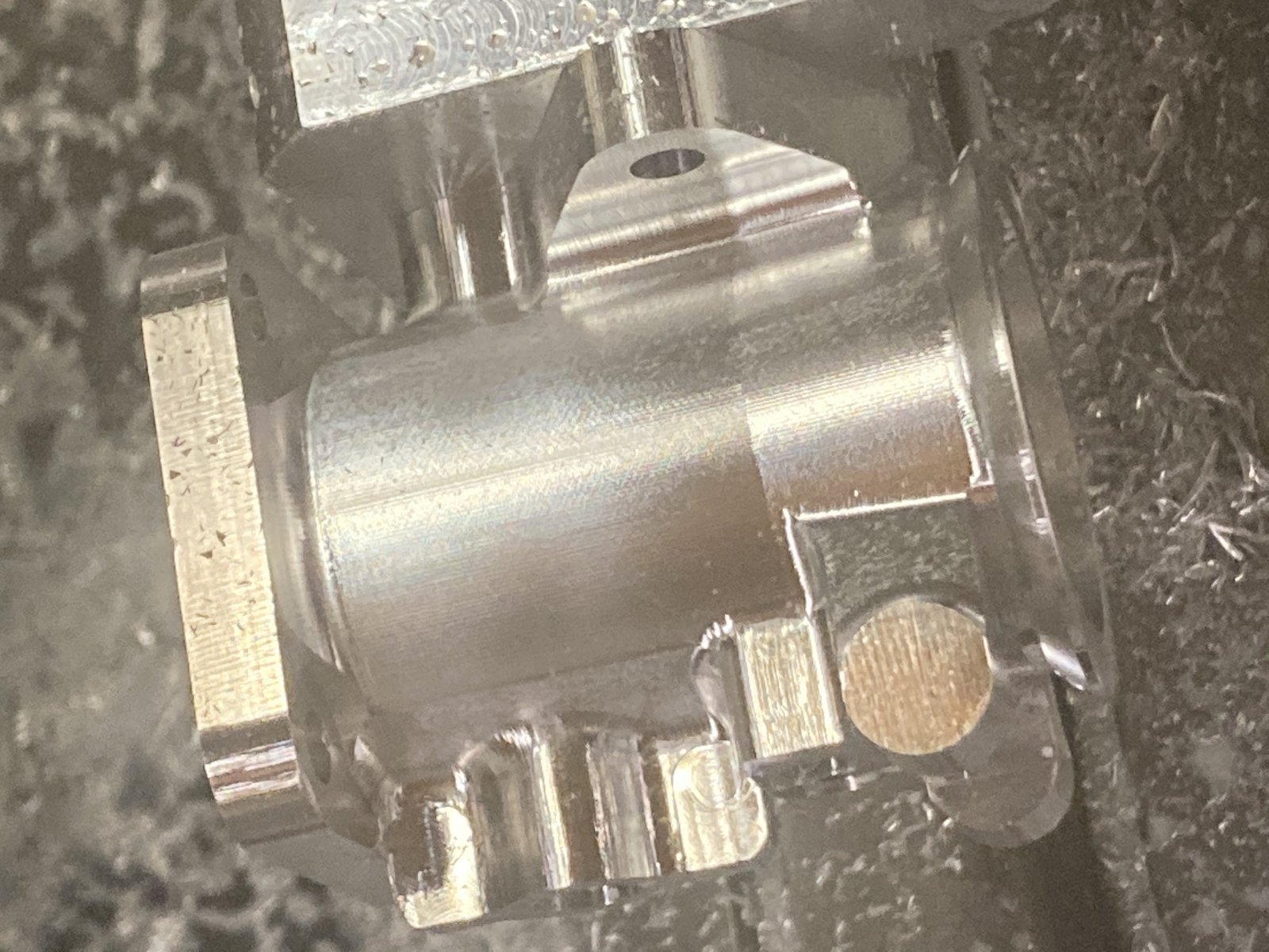

    Getting closer...
    CF768ED0-833E-4B88-A71C-8BF6F370C623.jpeg B63664CC-0836-4AFF-A2AB-9A868C1CFB50.jpeg
    I hope to have one of these throttle barrels finished and able to run by the end of the weekend...:D

  6. Kevin Pharis
    Posts: 829
    Kevin Pharis
    from Califunny

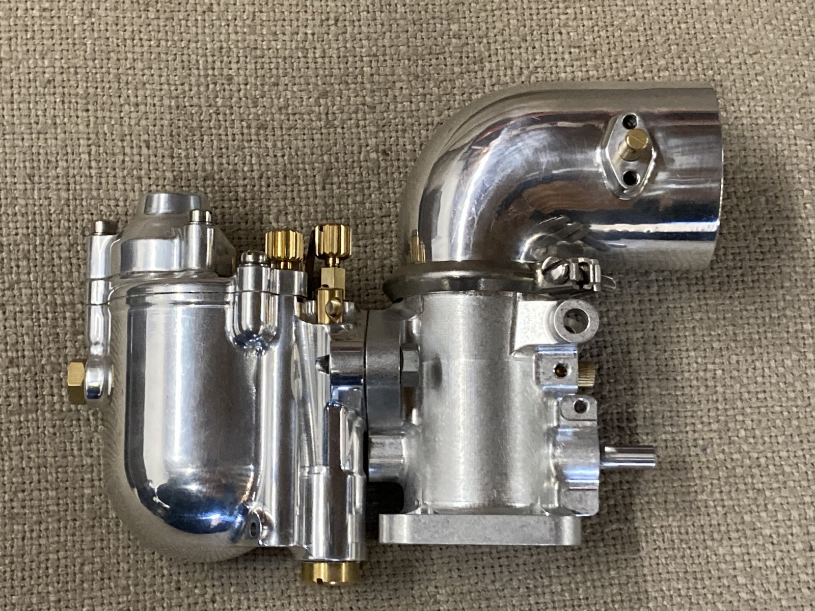

    Can almost hear it runnin!:D

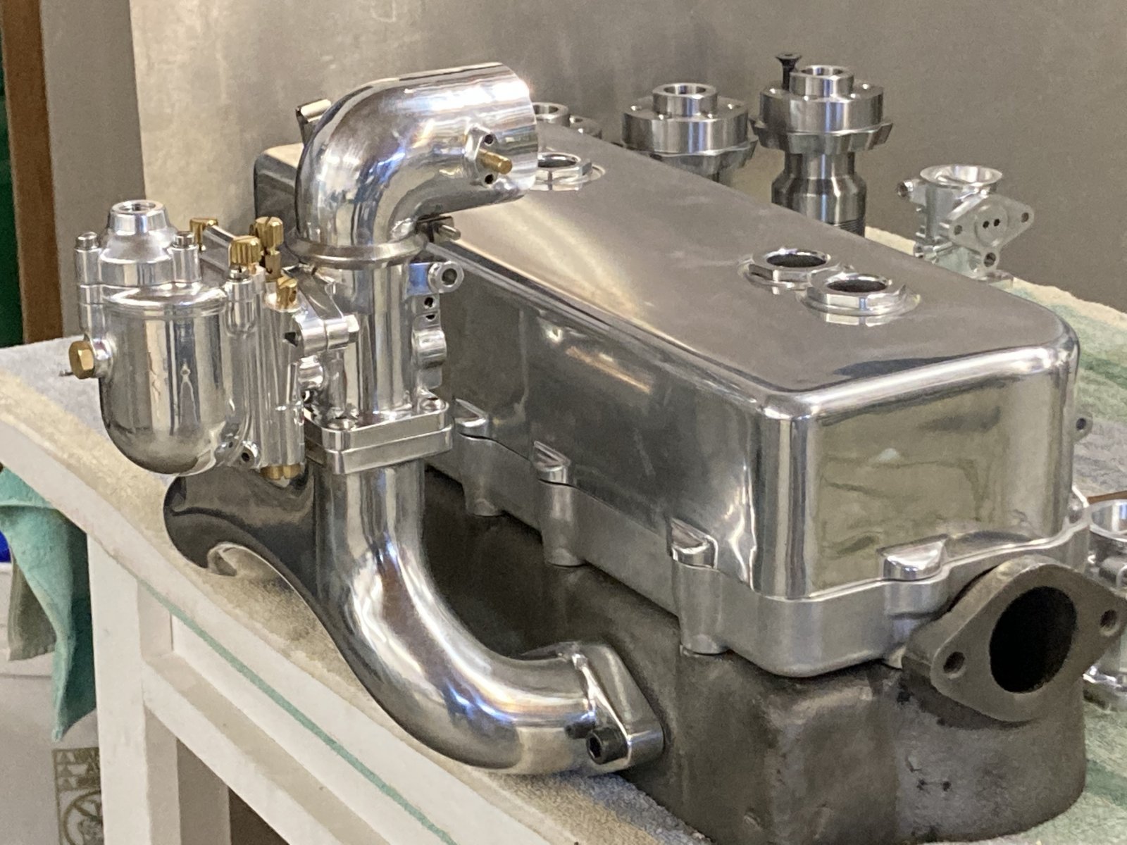

  7. Kevin Pharis
    Posts: 829
    Kevin Pharis
    from Califunny
    DD37DAD6-FF8F-4B6B-AF74-45AEA5AB4026.jpeg 21AD4201-BBAF-498A-B304-02BE67C1A9A9.jpeg
    Running good! Will finish the linkage and do some road testing later this weekend...:D:D:D

  11. Kevin Pharis
    Posts: 829
    Kevin Pharis
    from Califunny

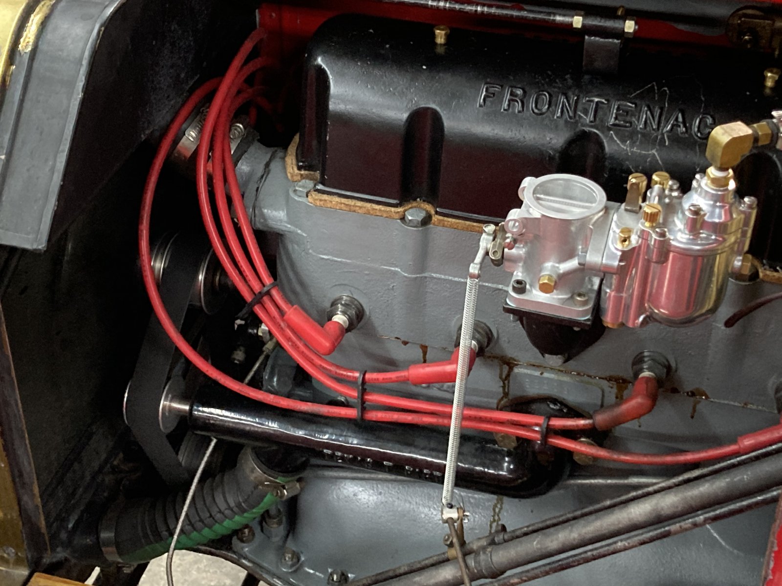

    This was the best Christmas present ever!!!!
    It took a few tries to get the cold motor warmed up and idling, then a few more tries to ensure that I was idling on the idle circuit. Then after a bit of intermediate circuit adjustment, the motor was responsive and smooth. The spray bars were distributing fuel across their full length, and the accelerator wells were obviously dumping fuel as designed.
    I am one happy grinch!!

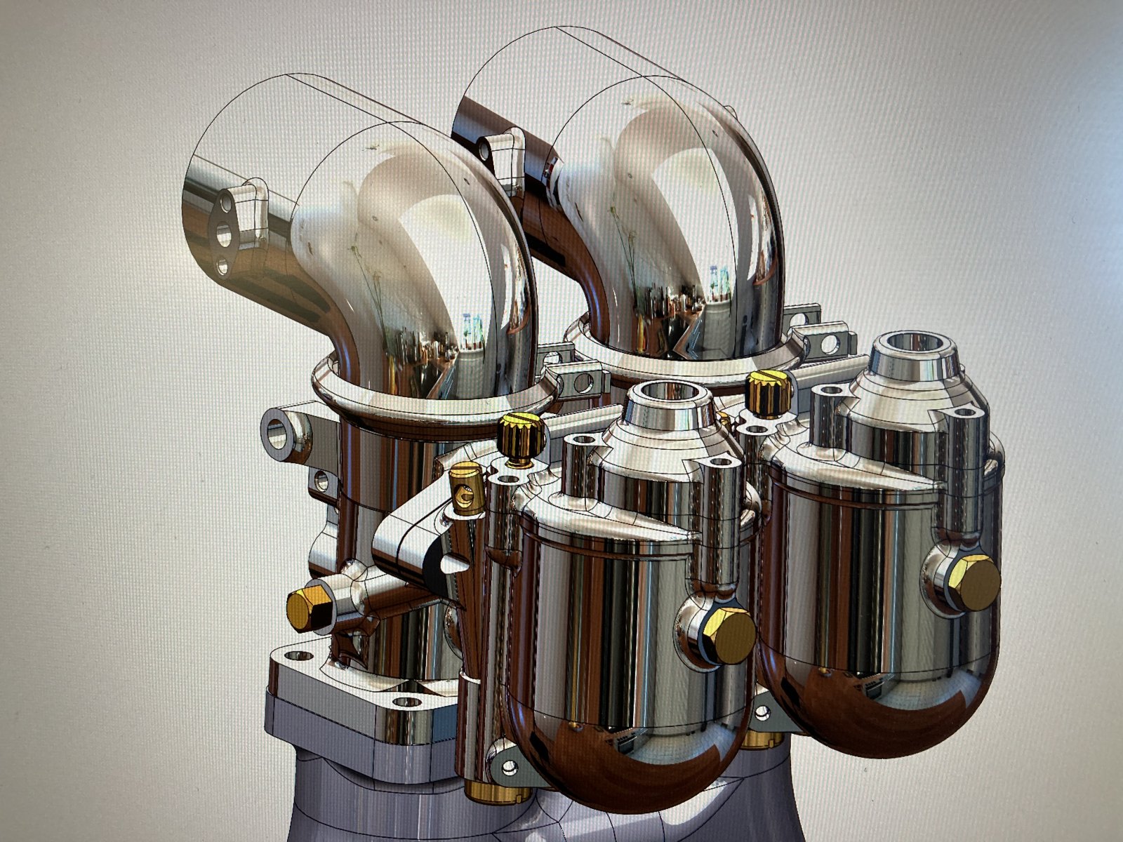

    The way I understand the manufacturing of the parts you had to build a CAD file of each part & do an ***embly of those files to ensure each piece fit-right?
  19. Kevin Pharis
    Posts: 829
    Kevin Pharis
    from Califunny
    Oooooooh yeah.... many many hours of design, and countless fit checks prior to starting any machine work

  22. Kevin Pharis
    Posts: 829
    Kevin Pharis
    from Califunny
    A few laps around the block and a few adjustments to the high speed needle, and the Fronty T is runnin just fine!
    Now it’s time to make the flow bench adapter and get some real data...:D

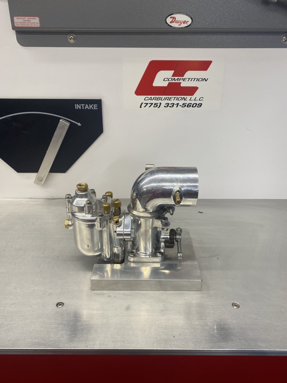

    Flow bench adapter... DUN!!!

    153 cfm!!!
    Bout the same size as a Stromberg 97

    In all honesty... I was expecting bout 100 cfm. Now I’m beginning to wonder if my T can handle 2 of em...?! Oh well, I can always keep em from opening all the way;)

    Did you flow it at 3 in. hg. depression?
    loudbang and Carter like this.
  30. Kevin Pharis
    Posts: 829
    Kevin Pharis
    from Califunny
    Sure did! Well I didn’t... Bob at CC did;)
