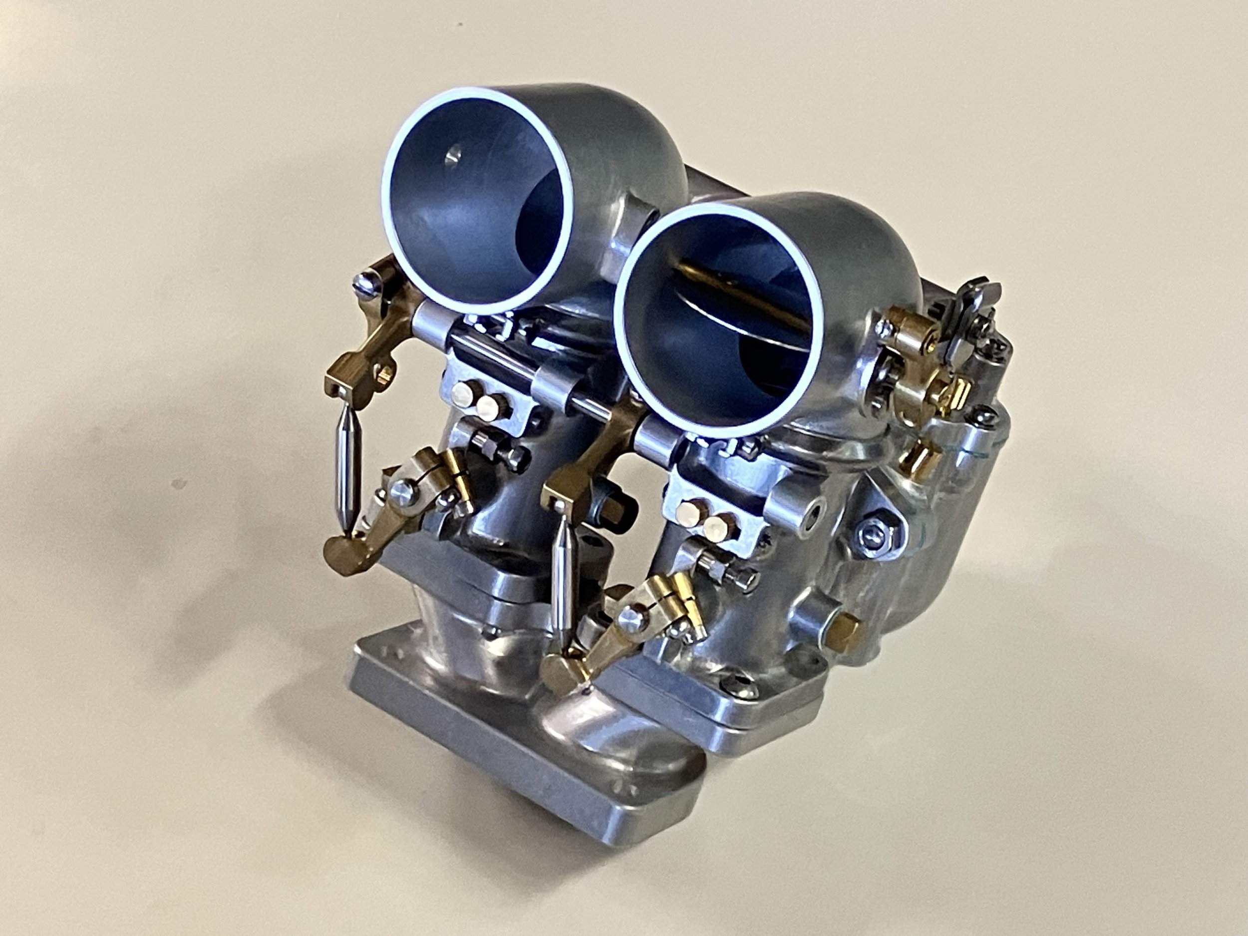

    Workin on a dual Winfield setup and missing one of these… not anymore!:D

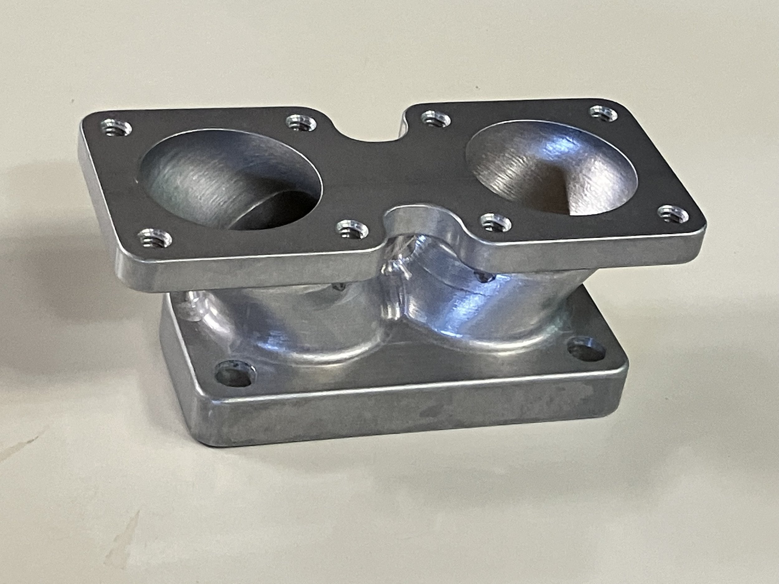

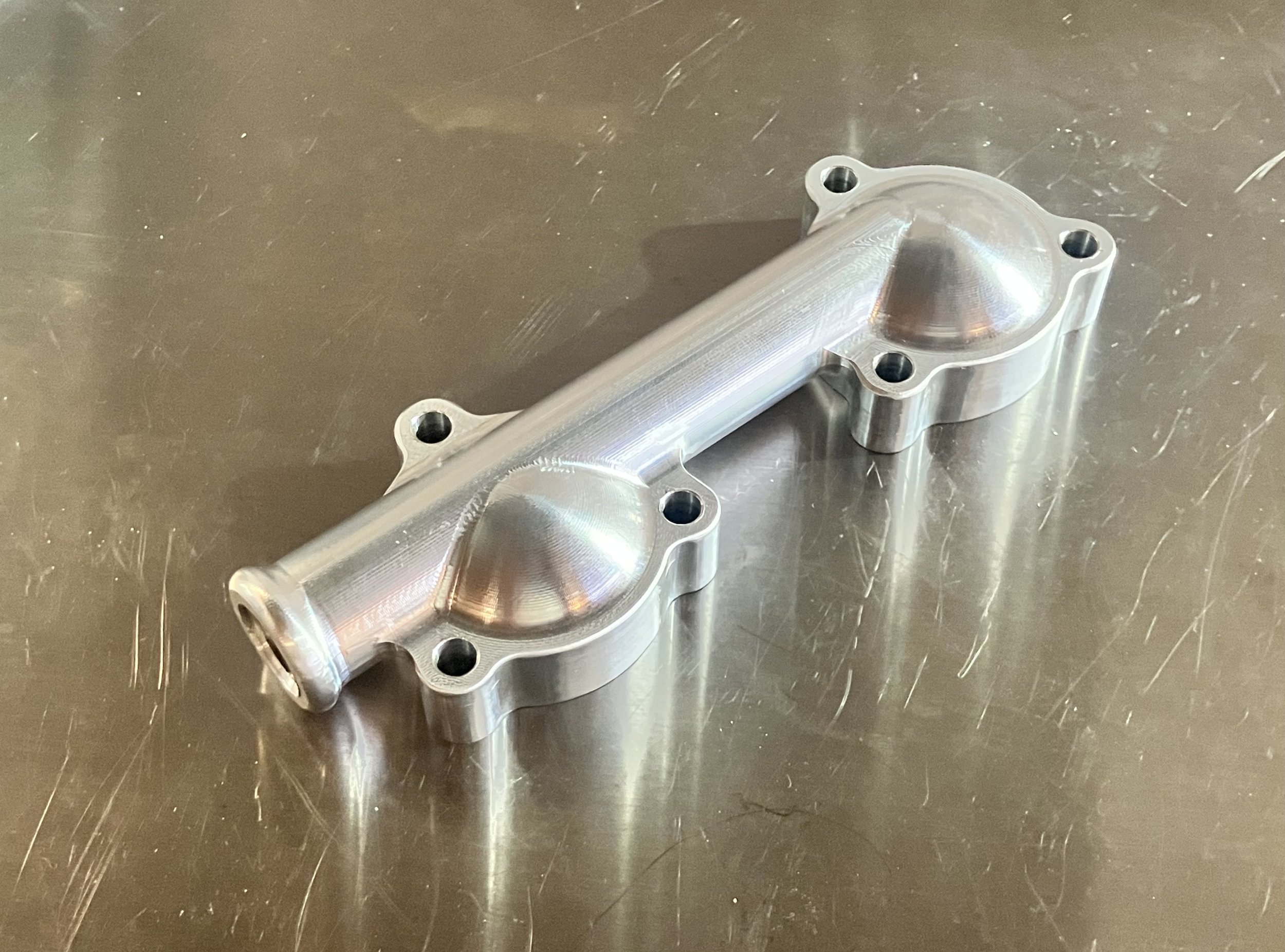

  2. Kevin Pharis

  3. Excellent work Kevin! Your attention to detail is always so inspiring!
    BigRRR, Sharpone, winduptoy and 2 others like this.
