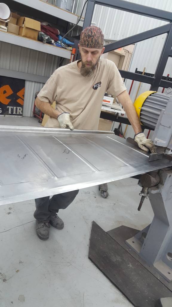

    Laying our ribs.
    Ready ro rock...
    Josh making a hand.
    Fitting to tail gate.
    More on Monday.

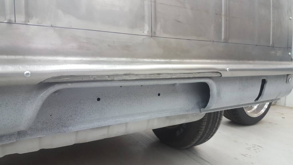

    New skin had to be modified to clear tag surround body line. Now opens all the way without contact.

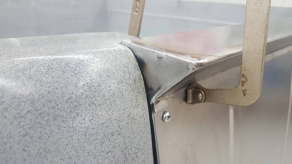

    After some work with the shrinker it now lays flush all the way around. Top rail on it was beat so puting a little spoiler/ top cap on it.[​IMG]
