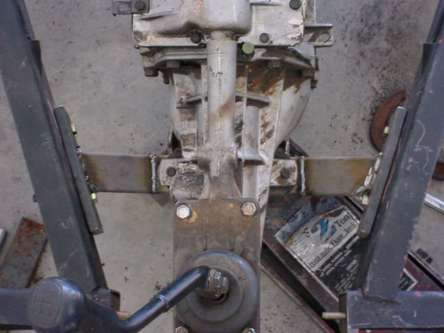

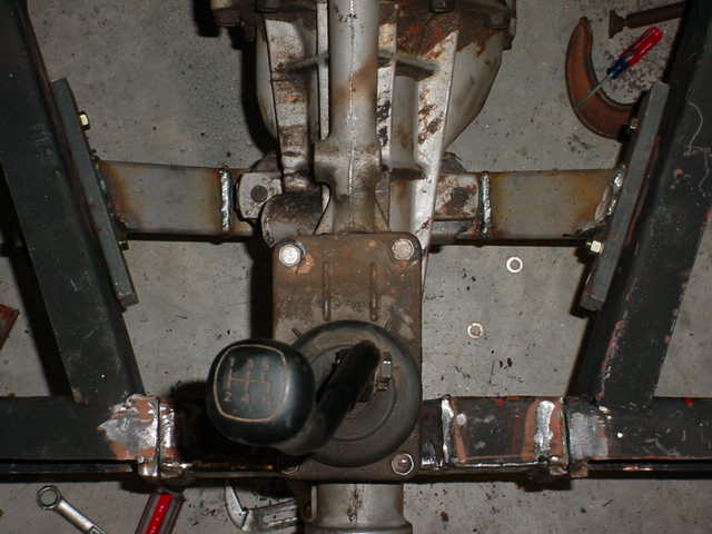

    drop out center in my A
  3. I think you can make it structurally sound but keep in mind that the width of the dropout has allow you to pull the tranny all the way out of the bell-housing. However, a 1 piece fully removeable crossmember might be easire and cleaner.

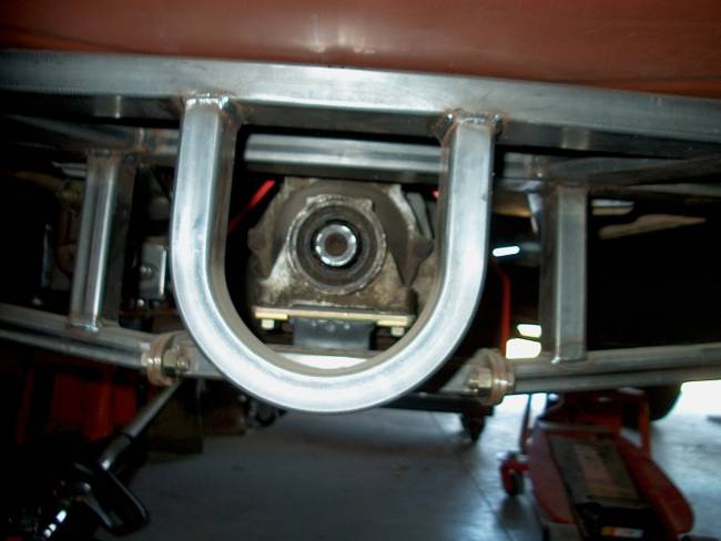

    I do like being able to remove the crossmember.
    Mine is like this... :D

    I am adding another tube that goes threw the cross member to take some of the stress away from the bolts. right now there are 5 counter sunk bolts in each side of it

    Instead of making only the middle section drop out, I'd think that it would be far easier to make the entire crossmember removable. That way you will free up room if and/or when you need to swing and engine and trans in and out at the same time.
    Take some burly angle iron, weld it to the sides of the inside of the frame rails. The just make a crossmember that has the correct bends you need, and it can sit on top of the angle iron stantions. Drill holes vertically in the angle iron, and corresponding holes in the crossmember, and slip a bolt straight through. Easy and effective.

  16. Here's the one in my 31 on 32 rails roadster.
    Similar to Deuce Roadster's.
    Making the complete crossmember dropout works well.
    Makes for plenty of room.
    Even so, I like this style because I usually have exhaust tubing hangers and other stuff bolted to it.
    The trans doesn't have to come back very far so make sure you do have room for it to go down through the opening once the drop-out is out.
    7/16" bolts and 3/16" plates are adequate although I used 1/2" bolts here.
