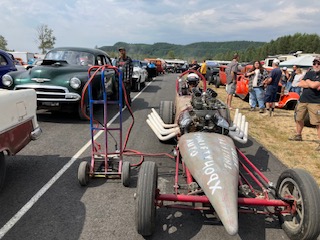

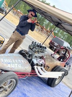

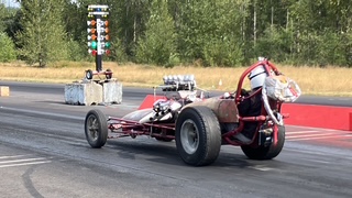

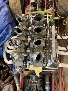

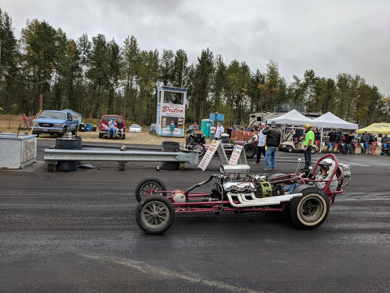

    I have been building this 8 two-barrel manifold in my head for 6 years now. Three years ago, I started collecting a few parts and building a cardboard template. Last year I had an aluminum welder weld up my idea. Then I built the linkage and fuel lines. I did it mostly for the novelty, but the 409 engine really liked the extra air and it has run faster than it has ever gone before. Here are a few pictures of the 409 in the Thrifty Auto Dragster at Toutle Washington, now called Toutle Motorsports Park (formally called Riverdale Raceway), that is put on by the Estranged car club.

    This was written last year on the," 348/409 Forum"
    I have been building this 8-carb manifold in my head for the past 5 years. I have a 6 carb manifold, but I don't like the way it is set up. Two years ago I started making a cardboard template. I bought a piece of 3/8th" of aluminum, as a base plate. This year I took my cardboard template to a local boat shop that does aluminum welding, and they created my plenum. I made the plenum small, to maintain air velocity. The plenum is cool to touch when the engine is running, I believe that is due to high air/gas velocity through the plenum. The engine ran the best it has ever ran, 113 PH with a 6.6 sec ET. The previous duel four barrels flowed total of 1200 CFM. The eight Stromberg 97s flow 1240 CFM, I don't believe that extra 40 made a big difference. I do believe 8 accelerator pumps did help. I believe the air /fuel mixing in plenum and cooling the incoming charge did help.

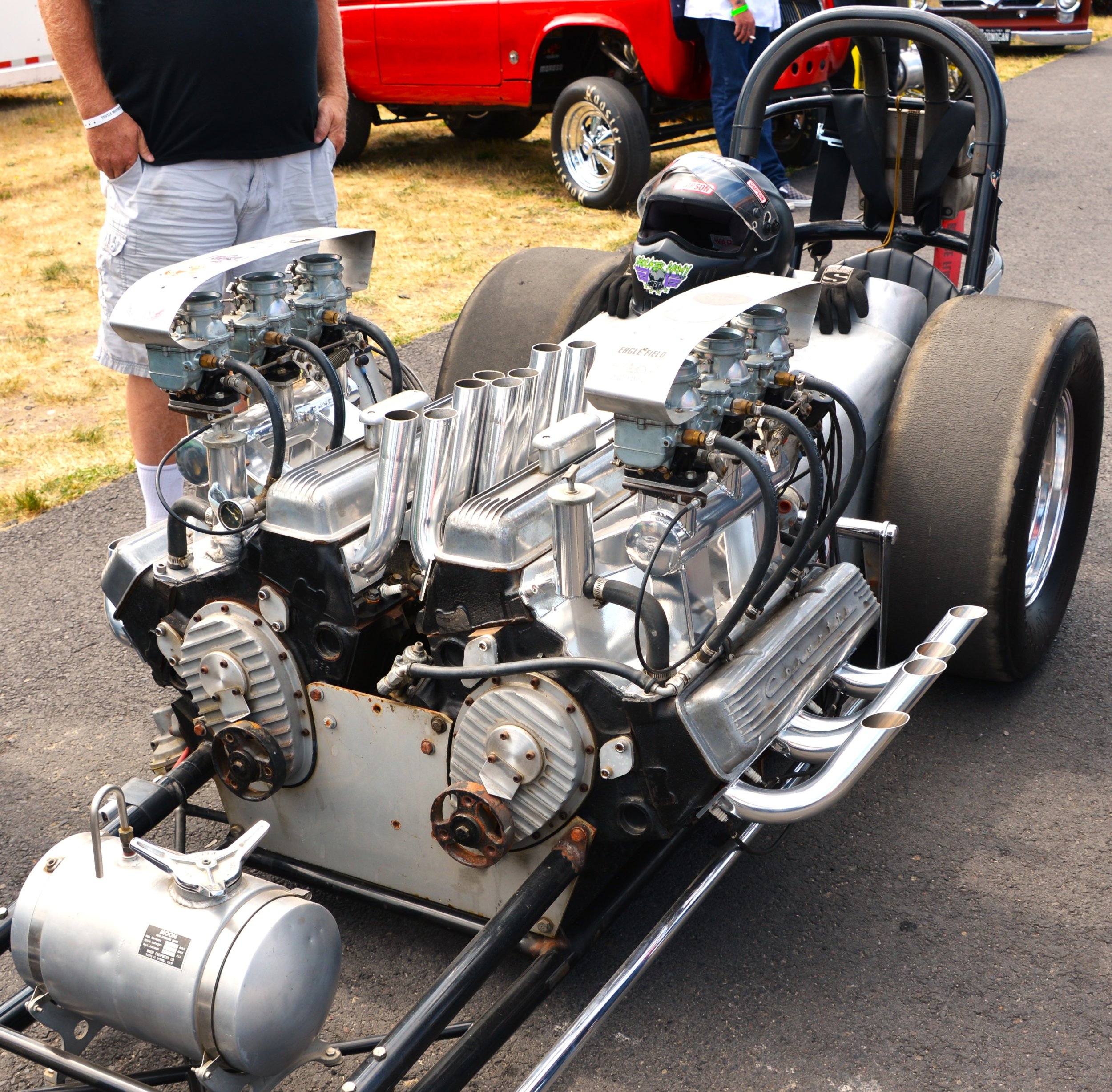

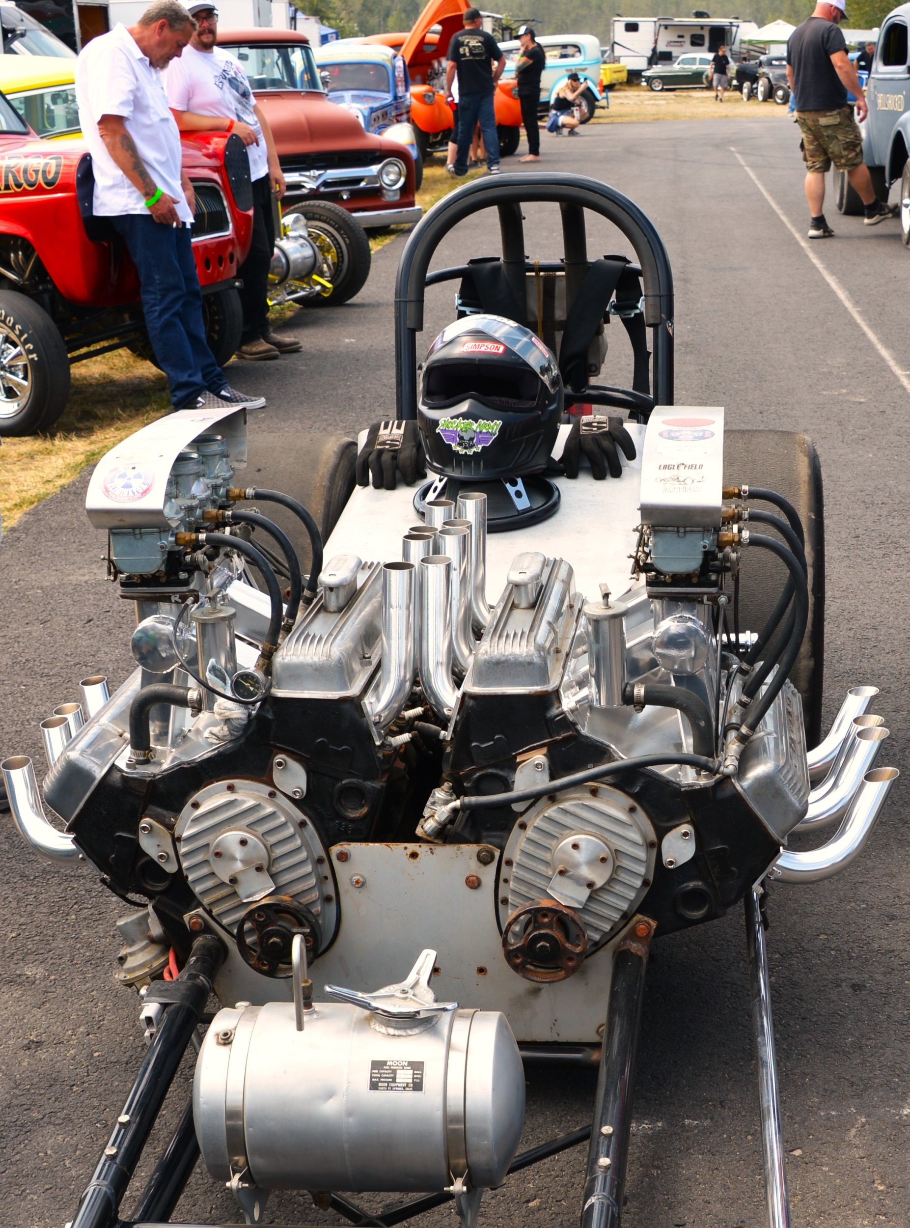

    That would be great fun. I will be looking forward for that day. I have raced Rocky in his Evil Twin dragster,. He tows up from Eagle Field in California. And Scotty Cochran in his "Scotty Muffler Special", made in 1957, has a blown CSB and runs 35% Nitro. And we were started with a "flag drop". A lot of cool stuff happens at the Toutle drags.

    Is this the evil twin dragster that you mentioned?
    I ***ume that it is, because when you zoom into the picture, the words "Eagle Field" are visible on the cover over the carburetors !

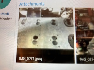

    This is the cardboard template, and the 3/8th aluminum plate mock up.
