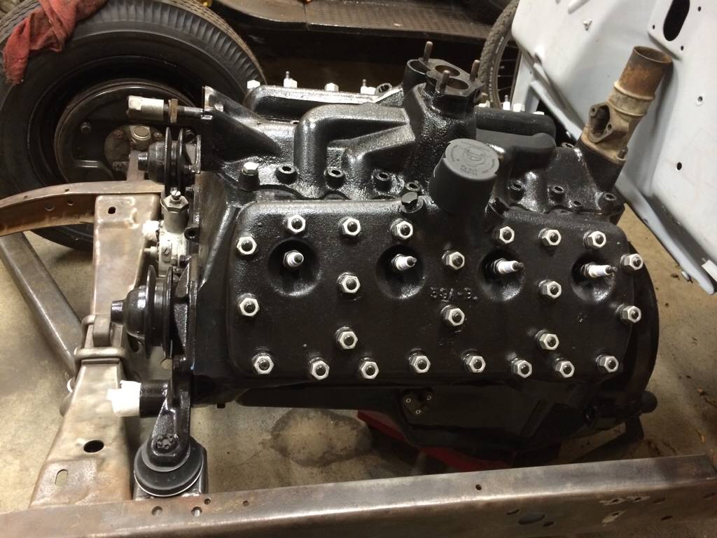

    39 trans bolted up. Need to figure out a crossmember now

    Can you fit a fan on that engine? I'd suggest figuring that stuff out before you weld up any crossmembers.

    The hood would need work but it's a decent fit

    The generator I am using is a 39 with the fan mounted on the front of it. Perfect clearance. It is being converted to 12v now. I'll post a pic when back from shop

    Generator rebuilt and mounted with fan

    Getting the F1 crossmember fitted ImageUploadedByH.A.M.B.1425443240.786098.jpg

    And as fate would have it my engine needs to go back another 1/2"!!!!!

    just a note please cover the holes in the manifold don't want any loose objects going down them.
