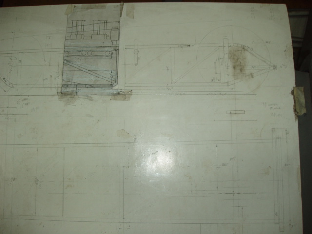

    I eliminated the under loops by designing the lower rail to run 2-3" off the track. I eliminated the bend in the top rail going down in front of the engine. Instead of this upper rail butting into the torsion bar tubes it passes over them. Good place to install the bumper. Different than my drawing I used the Edmunds type truss. I eliminated the bend at the rear of the lower rail by making that section removable. I like the #5 paint job. I like the Hyder Hawk generation one tail. I like the Greg Weld early 60's sprint car. 2024-08-09 08.20.49-1.jpg 2024-08-07 21.51.35-2.jpg 2024-08-09 08.20.49-2.jpg 2024-08-09 08.20.49-3.jpg 2024-08-09 08.20.49-5.jpg 2024-08-09 08.20.49-7.jpg 796C9157-DDC0-4ECA-968D-527636534E91.jpeg nice body.jpg 52633384099_7fa072f6f0_k.jpg

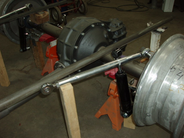

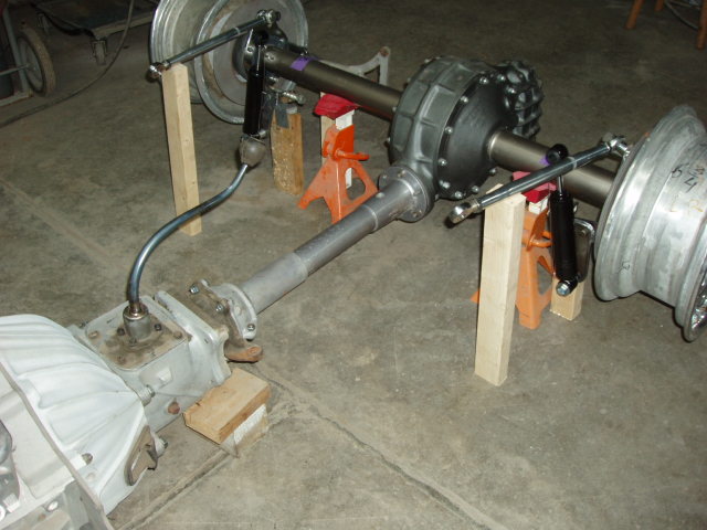

    Forgot to mention that's an X-Shift 3 speed transmission. Will have a hand clutch. 2020-08-13 18.52.14-1.jpg 2020-08-13 18.52.14-19.jpg 2020-08-13 18.52.14-21.jpg The 350 engine is ready. I have 6 Ken's Equipment Hawthorne, CA aluminum wheels.

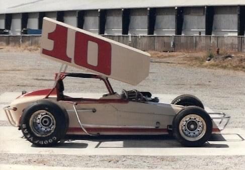

    Offset supermodified roadster I built in 1971. Wedge body. Had a USAC legal cage at first. Changed it to an I R A legal 1.750" OD cage when I sold the car to 6' 4" img121.jpg img122.jpg Gene Coleman. Coleman Machine Race Products.

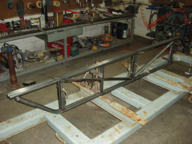

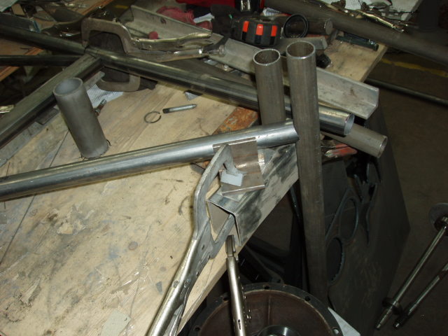

    Finished welding the right side. 29 lbs. Lots of angle irons clamped to the board to duplicate the left side. 2024-08-13 22.50.19-1.jpg 2024-08-13 22.50.19-2.jpg

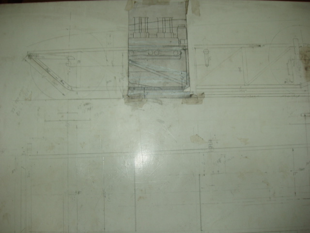

    I set 2 tubes in place just to see if I can match the dimensions of my drawing. Checks out perfect. The 1/4" thick magnesium engine plates are something I used years ago in my super late model dirt cars. I think I will try to purchase a 1/2 sheet of 3/16" thick magnesium to do the full engine mounting plates. 2024-08-14 21.19.46-1.jpg 2024-08-14 21.19.46-2.jpg 2024-08-14 21.19.46-3.jpg

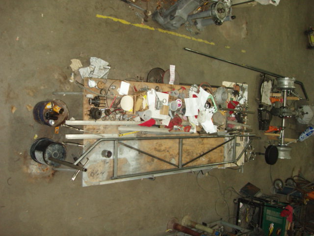

    Checking fuel injection pump clearance. Will fit inside 2024-08-16 09.49.42-1.jpg 2024-08-16 09.49.42-2.jpg body side panels. Figuring out Ross steering mount. Eliminating left tube. Mounting box it self to the torque plate. Finished left frame rail. Will move the rails to the frame jig now to install the cross members.

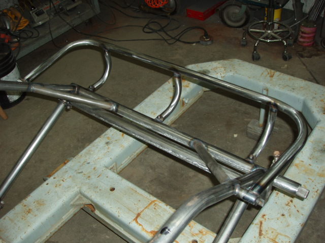

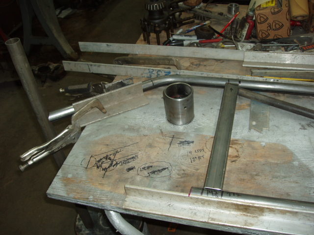

    Punch marks in the upper rails to measure crisscross to square up the rails. Installing the torsion bar tube cross members next. 2024-08-19 18.31.01-1.jpg 2024-08-19 18.31.01-2.jpg

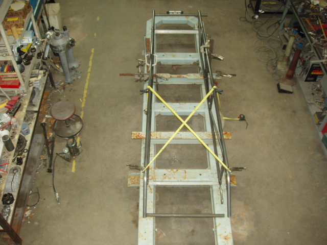

    No jig. Lots of vise grips and lots of measuring and re-measuring. All the notching for the torsion bar tubes was done before hand with a Port-O- Band. Left outer rail notch needs a little grinding. Ready to install torsion bar cross members. 2024-08-19 23.05.41-1.jpg 2024-08-19 23.05.41-4.jpg

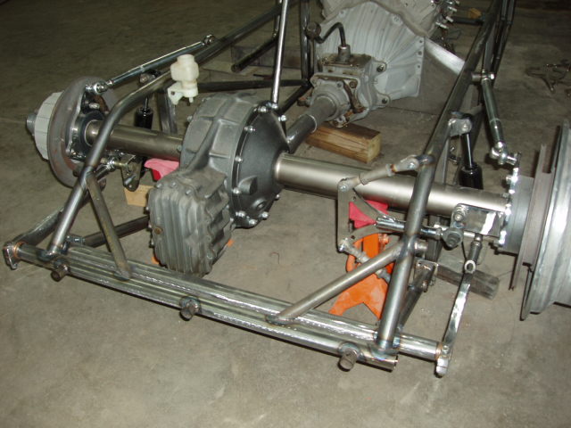

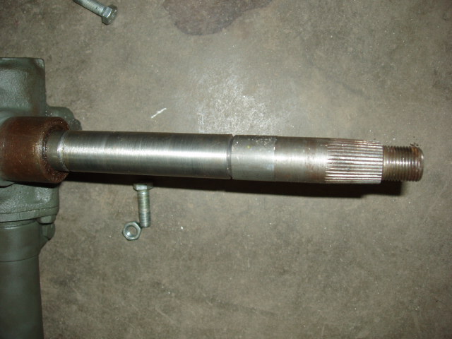

    2024-08-18 12.18.41-1.jpg 2024-08-25 19.44.11-1.jpg 2024-08-25 19.44.11-2.jpg Shortened the steering side shaft. Will mount box to the torque plate. Built front bumper. Fabricated right rear bolt in tube section. Left side tomorrow.

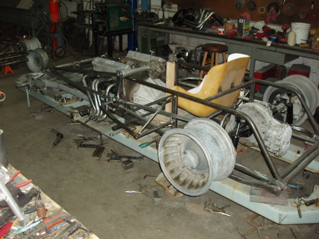

    9-8-24. Hand clutch/hydrallic throw out bearing. Battery box. Cross member for seat and seat belt brackets. 2024-09-08 23.38.17-1.jpg 2024-09-08 23.38.17-2.jpg 2024-09-08 23.38.17-5.jpg 2024-09-08 23.38.17-6.jpg

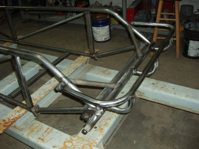

    Built headers. A sprint car header kit but required LOTS of time to fit perfectly. Header plates have oval holes and tubes go in at a pretty good angle. Sanded with 320 grit to get rid of imperfections. WANTED; One Kens Equipment 6pin 15 X 8 aluminum wheel. 2024-09-15 12.35.23-1.jpg

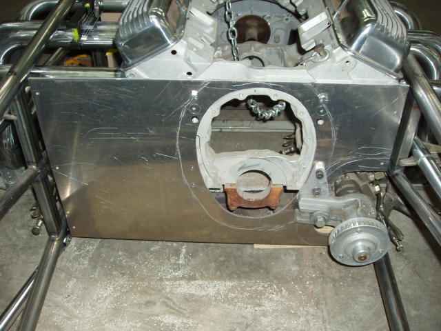

    Made a new mount for the injection pump. Made the front torque plate, 3/16" thick 5052 aluminum. 2024-09-16 21.54.20.jpg

    do you beef up the curved edge of the cutout for the pump?
    Sharpone and porkshop like this.
  22. Frames
    Joined: Apr 24, 2012
    Posts: 5,262
    Frames
    No. This front engine mounting plate is about 10 times stronger than the front engine mounting plates on WOO sprint cars today.

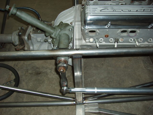

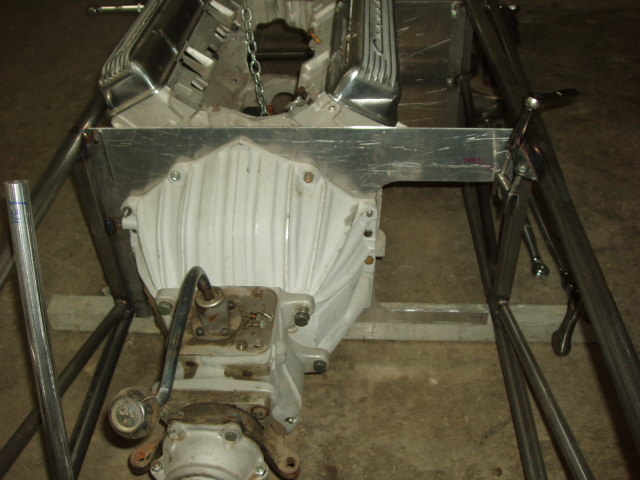

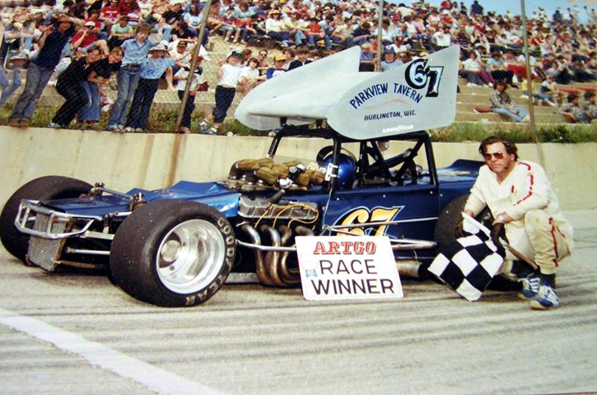

    Made the rear torque plate. Shortened the steering shaft. Lengthened Pittman arm to 5" & 2015-03-18 20.16.41.jpg 2024-09-22 13.14.21-1.jpg 2024-09-22 13.14.21-2.jpg 2024-09-22 13.14.21-3.jpg 2024-09-22 13.14.21-4.jpg 6". I built 2 offset supermodifieds in 1972. #67 built for owner/driver Ron Marish with a S B C. I asked Ron if he had to take any chances winning races. He said " Anyone could win driving that car" Independent front suspension! 1973 I installed a B B C engine. I had to rotate the engine to the left to make room for the drivers feet. Right side headers now horizontal. This was way before the radical Oswego supers of today. 1974 Ron sold car to Bill Klien pictured here.

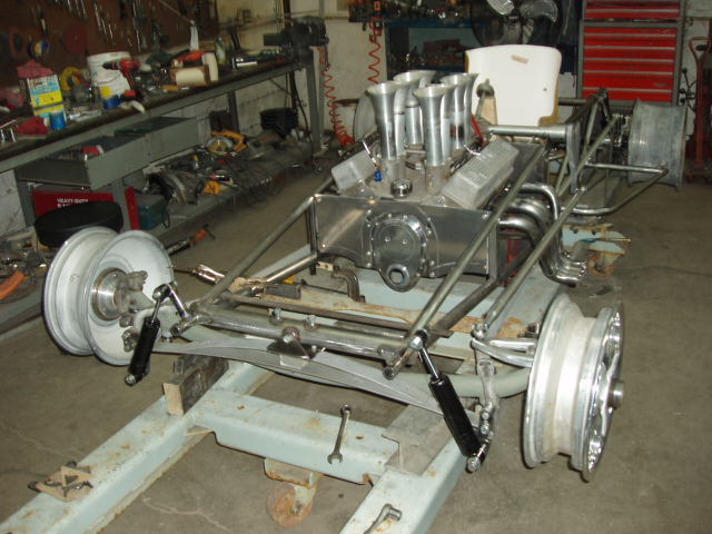

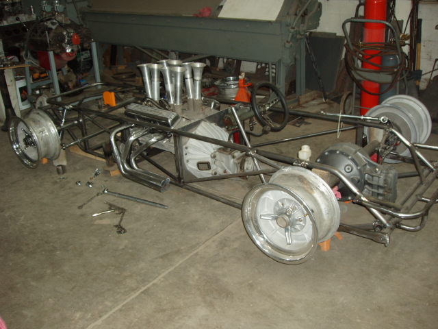

    Having trouble finding one 5 degree K P inclination F 150 spindle to finish the offset sprint car roadster roller so I thought I would throw a vintage dirt supermodifid chassis together while waiting for an F 150 spindle to show up. I had all the major components in stock for the supermodified. 2024-11-02 21.48.06.jpg

    Another picture of the offset sprint roadster and another picture of the supermodified. Have you ever seen a wide 5 wheel like the left rear? 2024-11-06 12.38.07-1.jpg 2024-11-06 12.38.07-2.jpg
