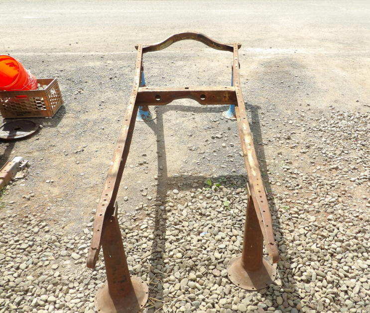

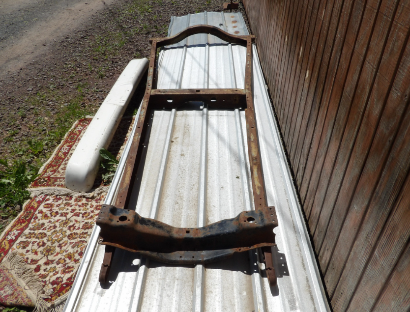

  1. So, I did some Black Friday shopping and picked up a nice clean model A frame less front crossmember.
    I my first thought was to keep it in case I ever need to clip my racecar, but I realized I already have a pair of A rails for that, plus this is a very nice frame and with my parts inventory I could put together a upstate NY style track roadster pretty easy.
    All I need is to finish my current racecar project get it dialed in and work a 45 plus hour week job.

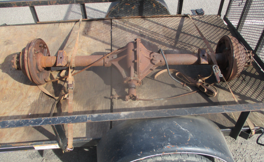

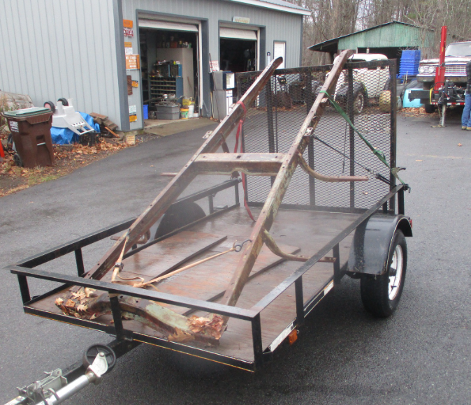

  7. I need to convince my buddy he really doesn't need this old home built Quick Change!
  8. nrgwizard
    Joined: Aug 18, 2006
    Posts: 3,028
    nrgwizard
    from Minn. uSA
    Now that QC is interesting. But my lwr back is flamin' just at the thought of moving it around, much less lifting it into some position.
    More details/pics?
    TIA.
    Marcus...

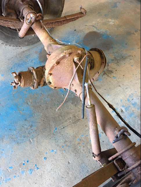

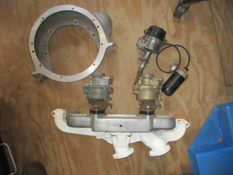

  11. New plan on the front axle!
    I bought this yesterday. it came from a friend and club mate who just passed collection of vintage oval track parts.
    I was happy to help the family and they were happy it was going to be put to use in an oval track car.
    IMG_5574.JPG IMG_5573.JPG upload_2023-1-1_8-47-32.png upload_2023-1-1_8-48-18.png upload_2023-1-1_8-52-46.png
    God Speed Patrick "Tex" Gorden!
    upload_2023-1-1_9-5-33.png upload_2023-1-1_9-8-42.png upload_2023-1-1_9-7-13.png upload_2023-1-1_9-9-32.png
    tb33anda3rd, alanp561, hfh and 4 others like this.

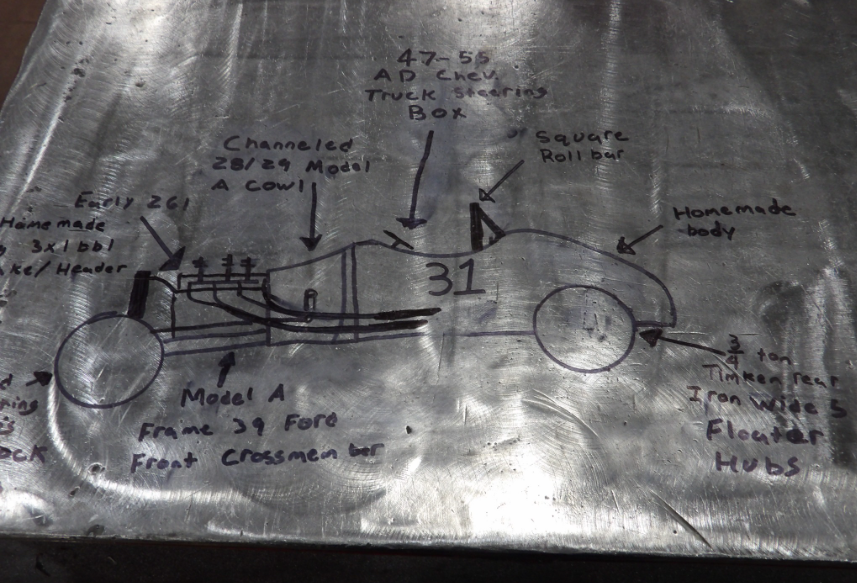

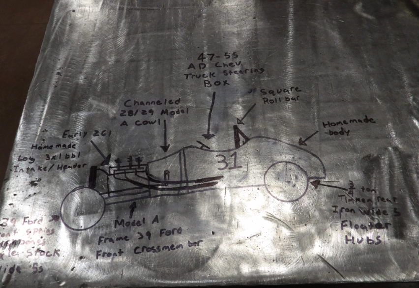

  13. I laid out my plan for the track roadster during lunch at work the other day.

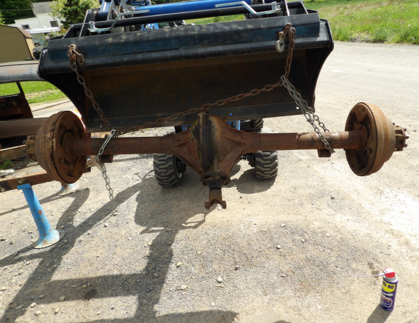

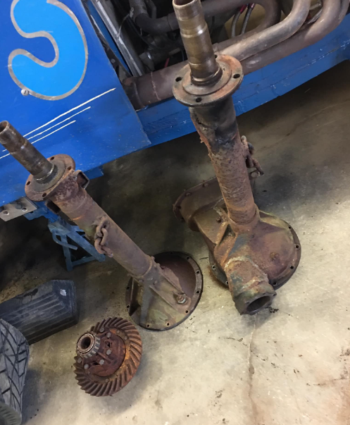

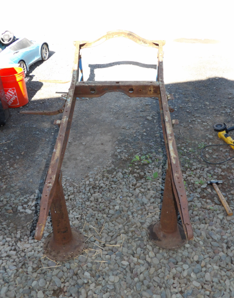

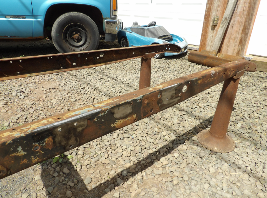

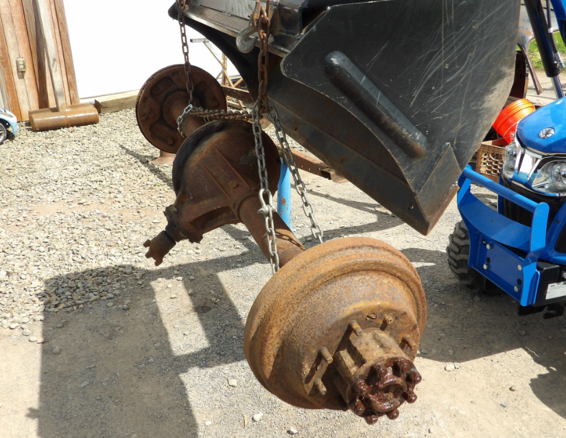

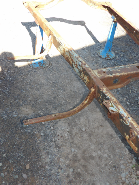

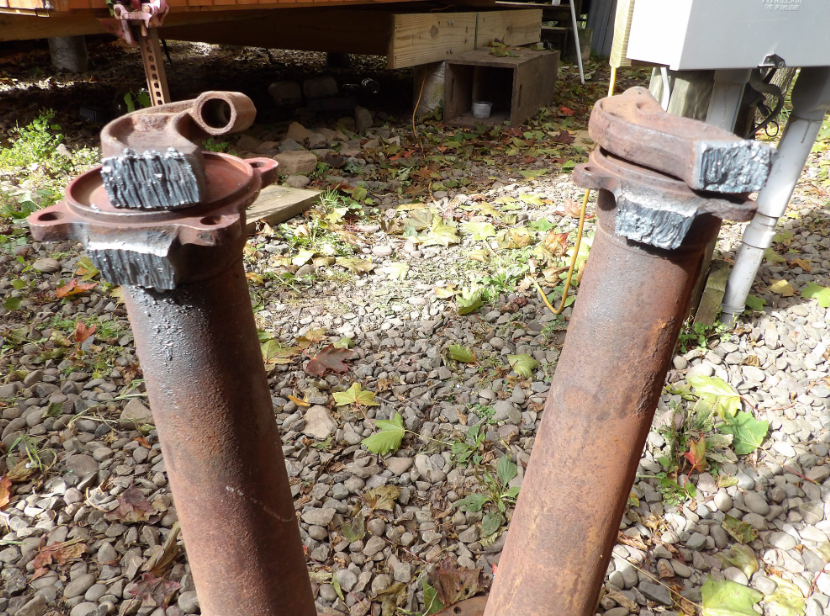

    I had plans to work in the garage last Sunday, however my plans changed (very long story) and I decided it was better to work outside.
    I prepared the Model A frame for the track roadster removed all unnecessary bracketry, dug out the Timken rear, and cut the spring mounts off a pair of banjo rear side bells.
    upload_2024-5-26_8-3-9.png upload_2024-5-26_8-3-42.png upload_2024-5-26_8-4-3.png upload_2024-5-26_8-4-38.png upload_2024-5-26_8-5-3.png upload_2024-5-26_8-5-39.png upload_2024-5-26_8-6-13.png upload_2024-5-26_8-6-34.png

  14. Dave G in Gansevoort
    Joined: Mar 28, 2019
    Posts: 3,664
    from Upstate NY
    Progress! Oof, those floater rears are heavy!
    alanp561 likes this.
  15. Especially after I add the stock iron wide 5 hubs!

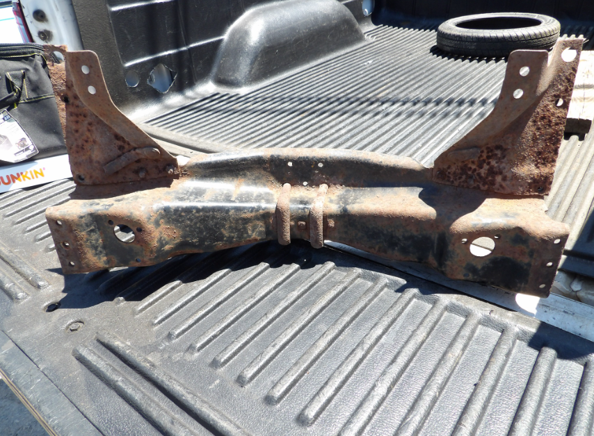

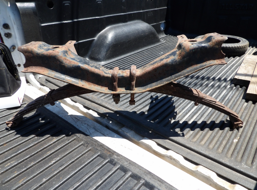

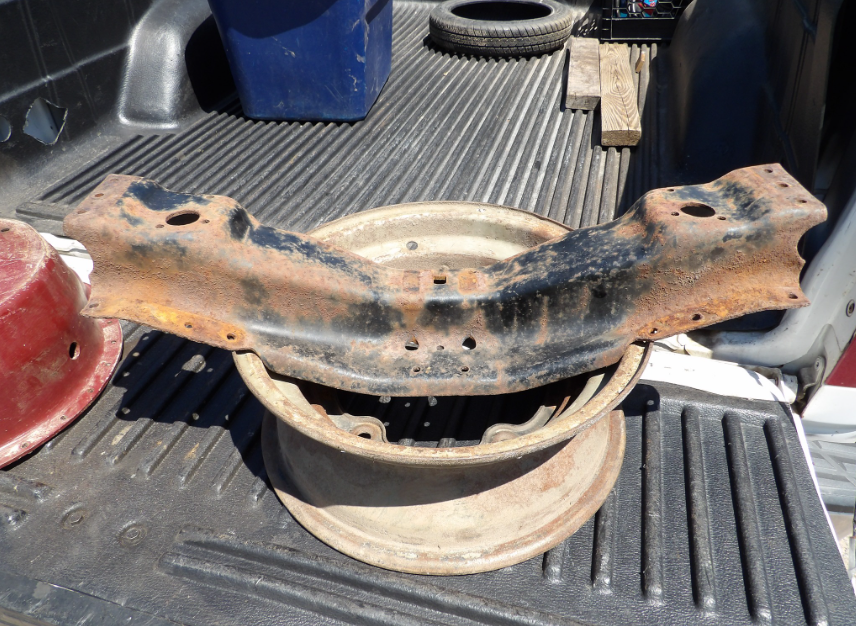

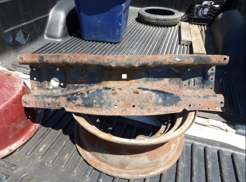

  16. Scored another piece for the track roadster today thanks to Dan Hanke, a 40 Ford front crossmember. I cut the u bolts, ground the bolt heads and removed the spring and gussets.
    A little trimming and welding and I'll back set to go, I already have the axle and split the wishbones.
    upload_2024-6-1_17-10-41.png upload_2024-6-1_17-11-2.png upload_2024-6-1_17-11-35.png upload_2024-6-1_17-12-1.png upload_2024-6-1_17-12-28.png upload_2024-6-1_17-12-54.png
    tb33anda3rd likes this.
  17. Dave G in Gansevoort
    Posts: 3,664
    from Upstate NY
    Just remember why it's called wedge. I'm expecting to see a block of oak or maple under that front spring...
    Robert J. Palmer likes this.
  18. I am going to build adjustable shackles for this one, maybe a jack bolt on the R.R. track roadsters didn't make it very long around here. I think into very early 50s at the latest.

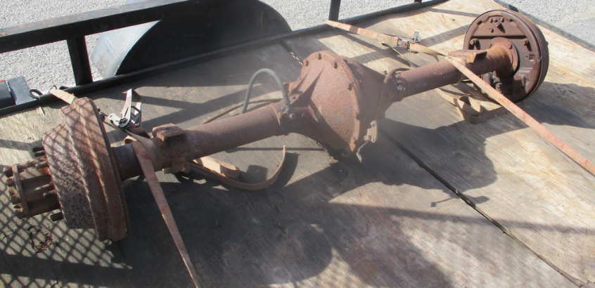

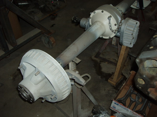

    I removed the spring mount and took the rear apart (picked up a 12 spline spool) 4:89 ratio
    I am on the hunt for a pair of iron wide five hubs with good machinable drums.
    I also changed plans on the axle, I am going to run a 37-40 (41?) Ford the same one I have under the stock car, plus I have two back ups!
    I picked this one up with the spring (for set up) at Rhinebeck, the 33-36 was pick up for a friend who runs that style under his vintage car.

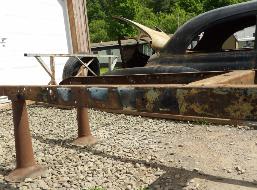

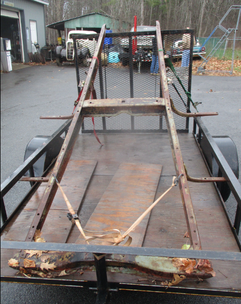

    I dragged this home for parts today!
    It's 1935 Ford chassis and what is left of the fenders. I am after the rear wishbones and driveshaft for this project!
