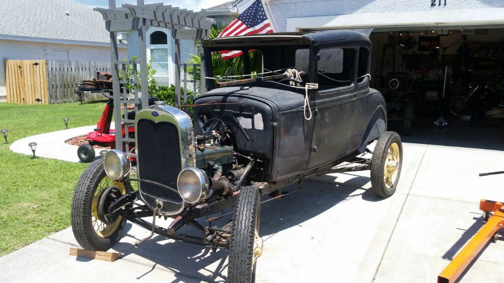

    So I've been dreaming of racing in TROG for years now...ever since I heard of it. I recently got back from a deployment, was browsing craigslist and came across a 46-48 flathead. The perfect start...one might think. Great motor, some stuck valves, zero cracks visible. Slowly dis***embling and dreaming of the day I find a good candidate to put the motor in. Browsing craigslist again, I find a '31 rolling ch***is with a 'rebuilt' 4 cylinder (a banger? Is that what you guys call it on here?). I say 'rebuilt because that's what the guy said and he hadn't run it in about a year, since he bought it. Missing a few things to prove that it runs (coil, ignition switch, the junction box thing that I keep forgetting the name of, etc...), I thought it to be beautiful, straight, and the right time, right place sort of thing. Home she went.
    Now, with a rolling ch***is that is only a few parts and a day or so away from running, a half torn apart flathead with 10 stuck and sheared off head bolts/studs, and some time to think....I started leaning toward the 4 cylinder as it wouldn't totally molest the near perfect frame I found (with what I think might be original paint?). But how do I make a 4 cylinder model A motor from 1930 compe***ive at TROG? My first thought was a head with higher compression ratio, maybe a different carb? I want to stay period correct, which I understand is difficult, but man, is it possible?
    ALSO, I'd like to do the Tardel step....are there any videos that show it done step by step? I have the book, but I'm not seeing enough pictures. I have the rear end marked at 4 inches but I'm hesitant to start cutting.
    Anybody have experience that can be p***ed? An old thread that I should read? I'm new here, I'm horrible with computers, but I'm slowly figuring this out.
    I also need an all steel body and am looking for a mor drop or dago axle.....preferably one that will ship as I imagine finding one in Panama City Beach during spring break is like finding ***s on a bull. Anybody have some good places to look other than eBay, Craigslist, places that want to charge me way too much for something useless?
    I know I won't be racing this year, maybe not even next year. But someday, my wife has promised to wear the booty short Harley coveralls and wave my flag. If any of you guys can offer some advice, I'd be forever grateful.
    Looking forward to reading more on here. A lot of you guys are geniuses as far as I'm concerned.

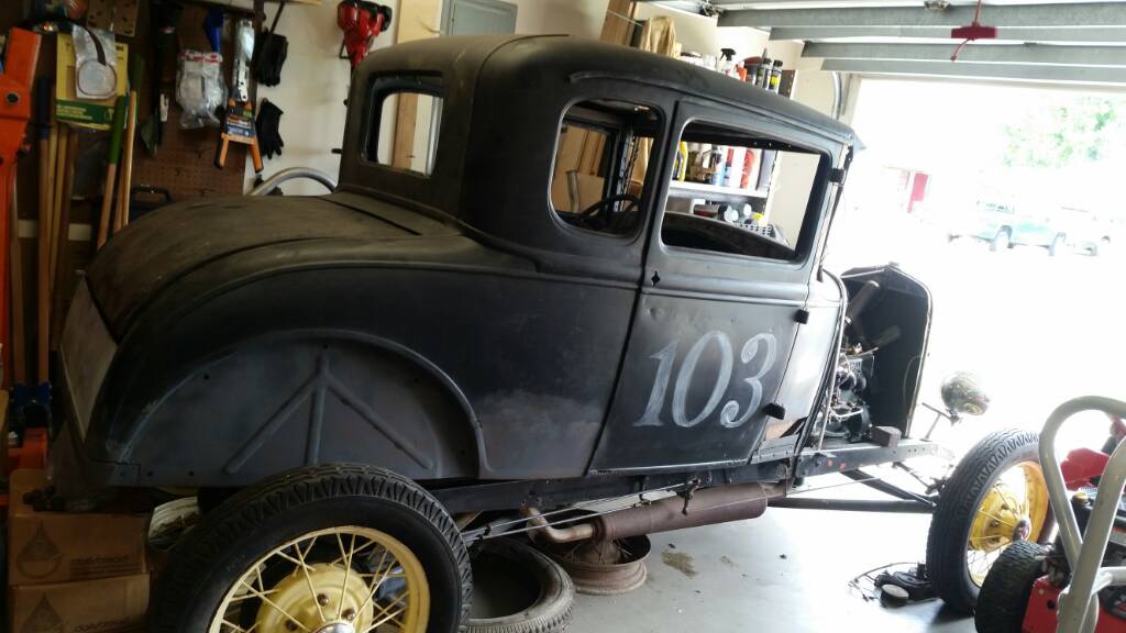

  4. This reads good. I like Young Guns. Being past 70 and reading what you want to do makes me wish I could help. Maybe I can with motivation. Here are a couple photos of "stuff" just cause I only type with 2 fingers. This has been my Life forever, you should have been there.
    20180404_153408.jpg Hot Rod Banger with B-Ville history.
    20151023_094150.jpg Honest, I'm going to work on it again soon. Well I hope to.

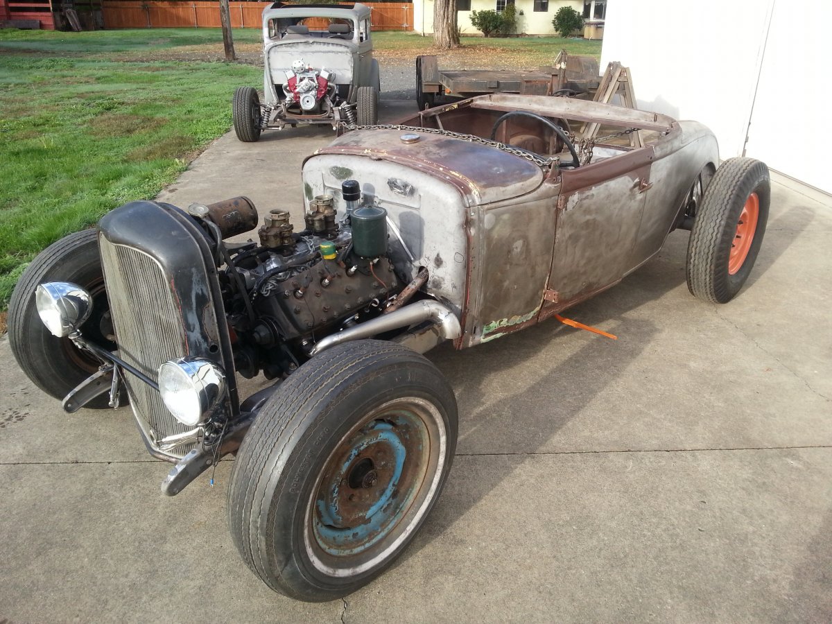

    This is the 29 I sold the first part of this year... good driving banger car, complete survivor couldn't bring myself to strip it down to do what I wanted so sold her to a good home. … If you hop up the lil banger motor man it runs pretty dang good... It can put the hurting on a stocker flatty v8 for sure...

    This is where I'm at so far. Still need to do some channeling, acquire some original hardware to keep all the sheet metal together, wire her up (I'm terrible at wiring so if anybody has a good diagram, I'd be grateful), get a fuel guage, fill her up and go! 20190804_133007.jpeg 20190803_134434.jpeg

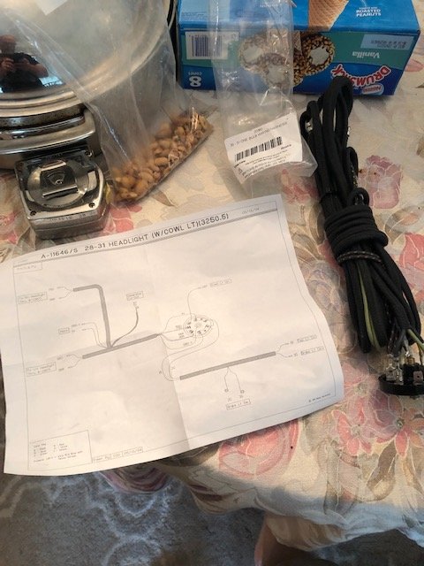

    I've got all the wires...just missing the diagram. Bought them from battlefield model a parts on E-pay. Supposed to be all like original, fabric coated, same colors. Now that I have the body, should be much easier as well.

  26. hotrodA
    Joined: Sep 12, 2002
    Posts: 7,346
    hotrodA
    When I had my A pickup I found a wiring diagram with Google search.
    Think I tried "Model A wiring diagram"
    Of course I got rid of it when I traded the truck off.
