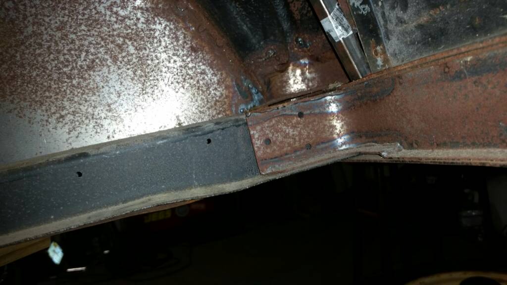

    So this is the part where I insert the question in the hopes that somebody has wisdom far beyond my years to extend the helping hand that this site has done so many times thus far. The body is propped up on the frame by wood blocks (not the mounting blocks) so that I could get to the step and make my welds/cuts. I have an idea where the front mounting bolts go.....but there's a 2-hole tab sticking off the frame just aft of that front mounting bolt hole that looks like it needs to line up with a 2-hole section of the body....but only the back hole lines up to the forward hole of the bracket....or so it seems it would. I don't have it completely lined up in the following picture, but you get the idea.
    Is there an existing document that shows which mounting blocks line up to which holes on the frame? When I line the body up with the forward most mounting hole (the firewall to body rail part...I don't really know what to call it), there isn't too much room between the motor and the firewall and that seems correct to me. If I slid it back, there'd be no putting the pedal to the metal. I read that there's only supposed to be a rubber spacer on that forward most hole and it lines up great with a hole in the frame that's basically the same size.
    All of this is why I didn't make my cuts yesterday....well that and it was about 175 degrees in the garage. This morning is a little cooler, but I've got to get groceries for the week and then the Patriots are going to put on a clinic against the Dolphins at Noon (my time), so I gotta watch that. You'd think that since I live in Florida, they'd televise the Miami game....but no, Jacksonville is playing at the same time. We had to swindle some weird stuff on the line to make it work on the tv. Oh well.
    Ok, well, again, if anybody has any insight on alignment with those holes, I'd be forever grateful and it'll help me figure out where I need to cut this body to set her down once and for all!!!!
    Thanks to all in advance. I look forward to witnessing the greatness that many of you already have. Someday, maybe I'll have it.
  8. Been to long since I actually bolted a stock A Body to a stock frame but even way back then I would have set the Body on the Frame then stood back and put the center of the rear fender opening dead center of the rear crossmember if I was using a stock location Model A rear spring. Then just go with the holes that line up. If you happen to have the stock inner fender panel still in place it has what I call a Chicken foot pattern stamped in it. The vertical line is center of the fender and should be center to the spring crossmember.

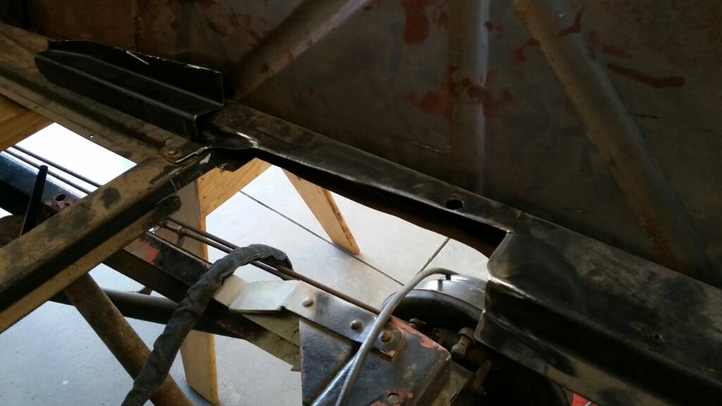

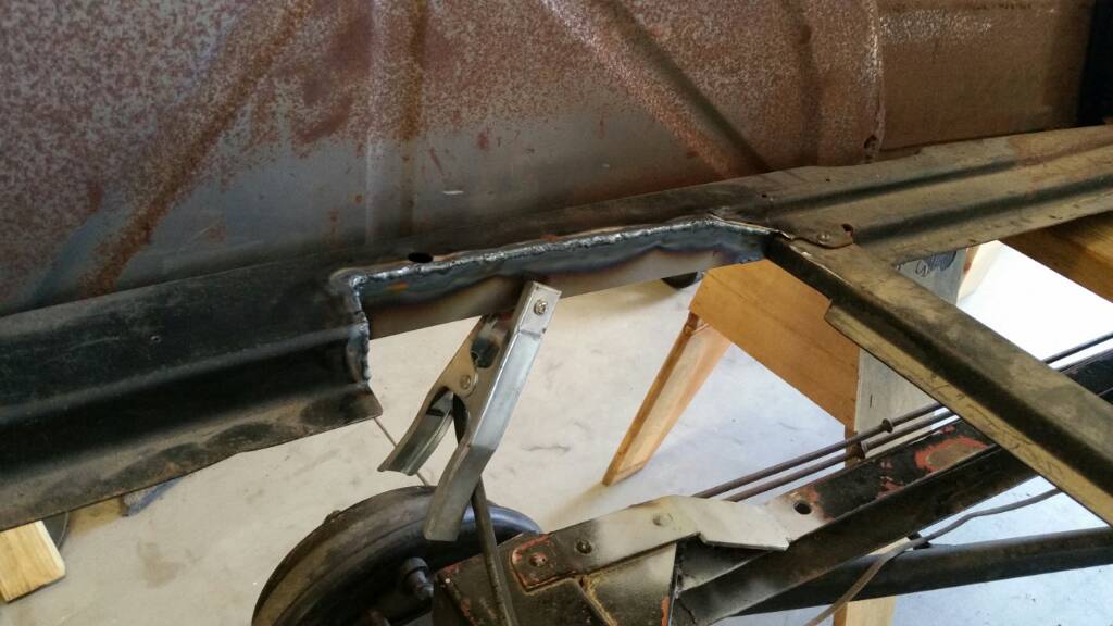

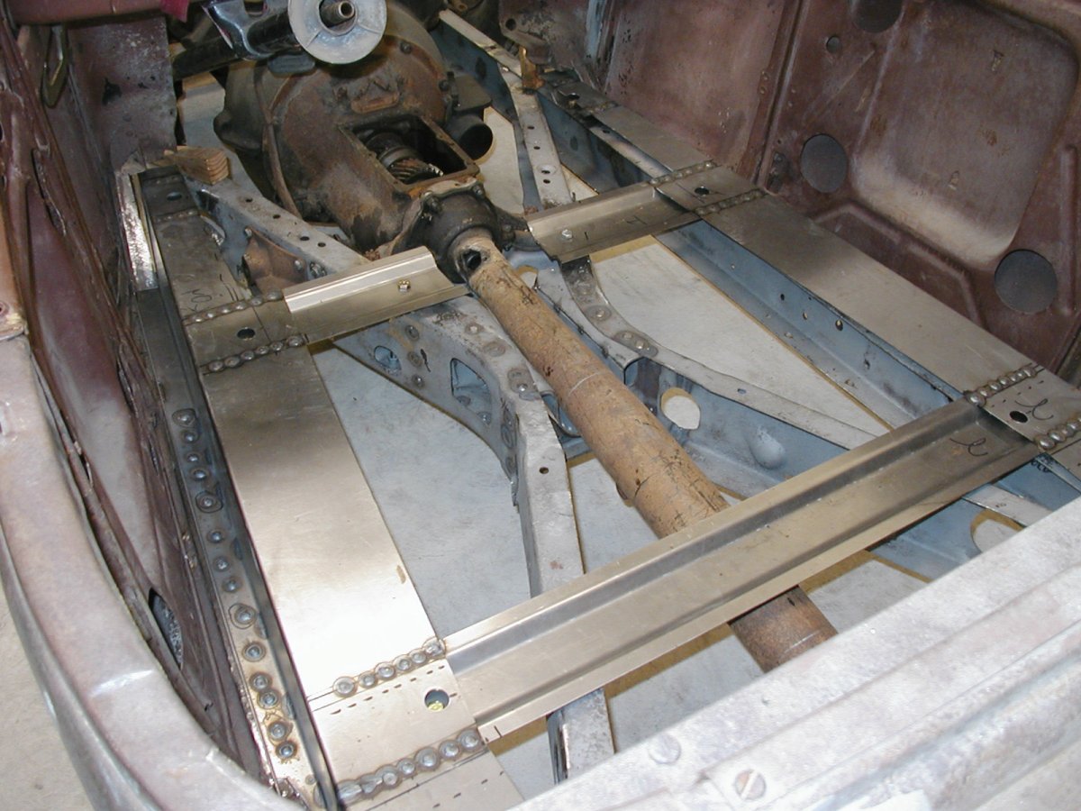

  11. Are your subrails in good shape? If so I wouldn't cut anything just yet. I actually built off them when channeling my Roadster. It worked grate being I had no real alignment issues at all. I actually built up with the step (drop) on top of what was there. Then trimmed the excess off underneath. Worked pretty good and what I built and added made things pretty Ridged. You can see how I plug welded the new to the old and then built new cross pieces with recessed body mount bolts. If you'd like I can get you some photos of the drops of the new piece so you can see the profile and maybe use some of what I did on your project.
    phelan9251 likes this.
  12. Here's a few more. If you look close at the last photo you will notice a vertical flange folded on the floor pieces in the Cowell aria. That is a stop and a place to fasten the Kick Panels to. I also did that from the B post all the way to the rear, again for upholstery. You will also notice this floor is flat from firewall to trunk lid. My
    30 roadster floorboards 001.jpg 30 roadster floorboards 003.jpg 30 roadster floorboards 006.jpg I actually started with a Frame kick in the rear but didn't like the issues it brought with it. In this photo is the actual metal I folded for the kicked frame and you can see the profile of the side pieces somewhat. It's all old photos and if you want I can get a couple that show more exact and why I did things the way I did. Also the step in at the doors is I believe only about 2" and leaves room for door upholstery and carpet along with a Kustom sill plate to anchor the carpet. I've seen Channeled cars before with the floor all the way to the door panel and abbreviated door panels and didn't like what I saw. Fixed that.

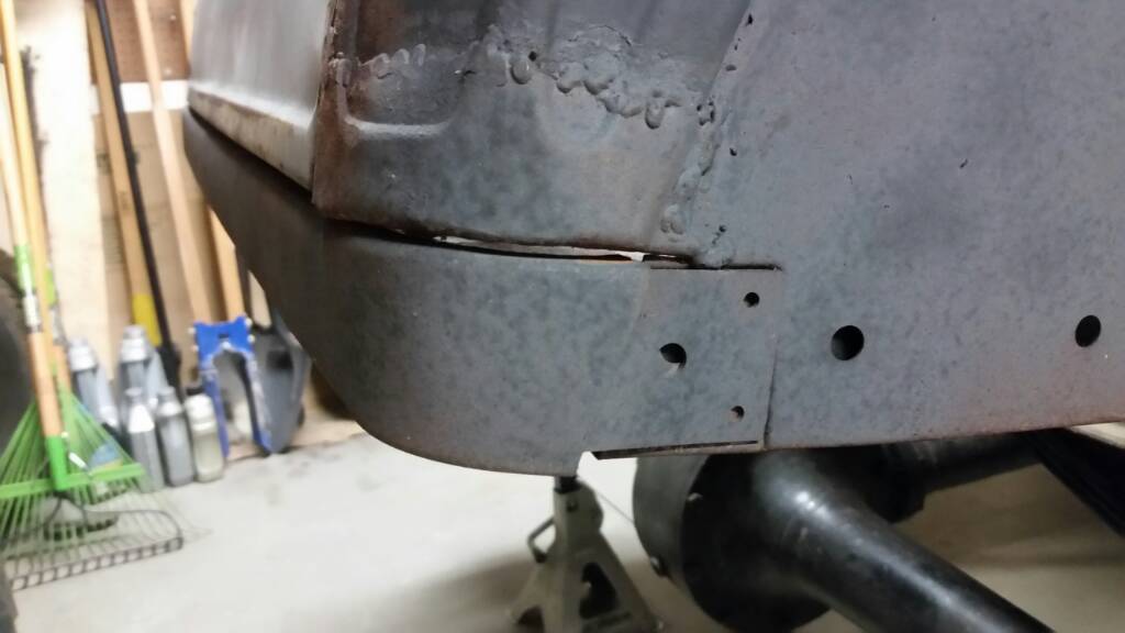

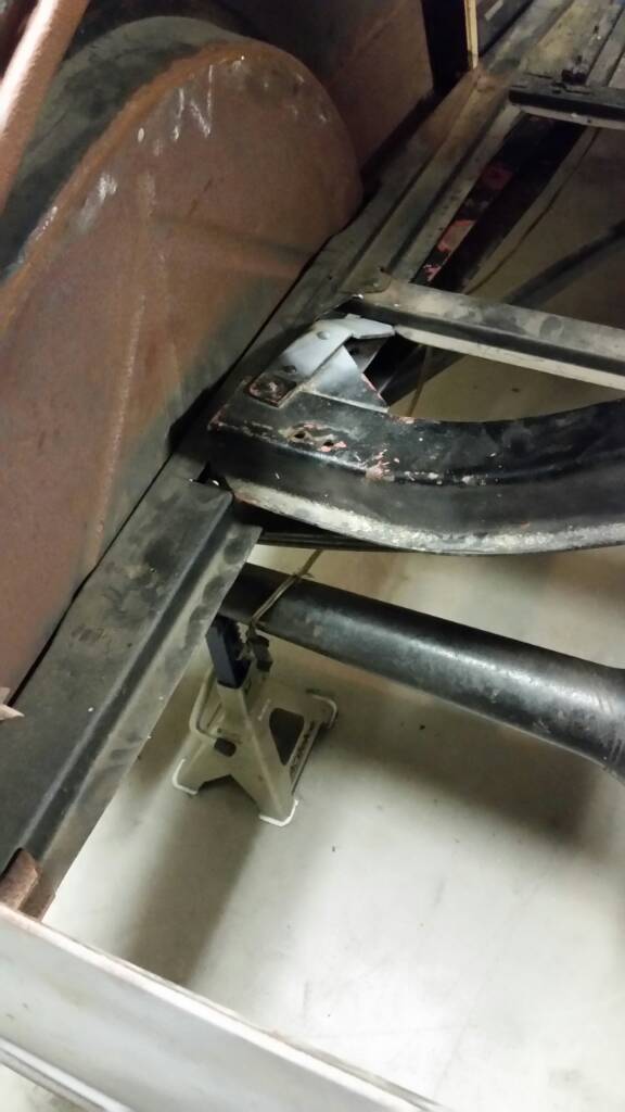

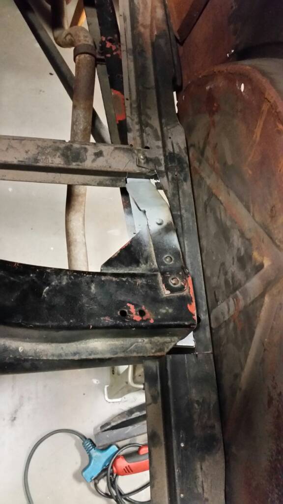

    Ok, to expand on what's above...first photo, great subframe. Second and third, unattached rear body piece....and some crappy old welds. I'm not good....but I think I could do better than that.
    Last photo, just because she looks so damn good in the garage. Can't wait to see it on the road and on the beach! 20190916_190517.jpeg 20190916_190540.jpeg 20190916_190613.jpeg 20190914_111035.jpeg

  24. Looks like you removed the very end of the Crossmember where the body to frame bolt would have gone. Given that and how solid things look in the photos I'd take my 4" cutoff disc and nip just enough of the inner flange and top rail to get the body down in place. Once there I'd support the back of the Body and double check the Deck Lid fit then build what it takes to remount the last body to frame mount. I see what you mean about the corner patch work. Prime example of,; Just because you own a Welder don't make you one! That's a re do for sure.
  25. NbdyHome2
    Joined: Feb 26, 2019
    Posts: 100
    NbdyHome2
    Yeah, I followed the Tardel book as close as possible. I think next time I might do things a tad different but so far so good. I'm not complaining yet. I also picked up a 39 transmission, so I'm looking forward to rebuilding that. Still gotta snag the Van Pelt book. That will come later though. When I get the body snugged down, I'll wire it up and see if she'll fire up. Been dying to do that. If I can run it around my neighborhood to test the motor, that's a win, then I'm looking into a higher compression head and a downdraft intake with my stromberg carb. It needs rebuilding but is in REALLY good shape as is. Shortly after, I'll pick up a new/old exhaust manifold. It's got an old heater manifold now but this Florida heat warrants removing that and selling it off ASAP. Then some re-gearing of the rear end and all signs point to being race ready. It almost seems like there's light at the end of the tunnel. So close, yet so far away.

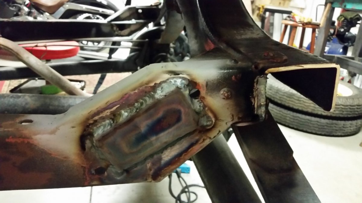

    Well folks, it's been a hot minute. The 31 coupe has been sitting dormant while I was getting drilled for surface supplied air diving supervisor over the last couple weeks.
    I made some measurements though, made some cuts, broke out the plasma, made some supports, and notched the body and welded in the supports. See photos below. It was such a weird and uncomfortable angle that the welds came out funky, but nothing a flap disc can't take care of.
    Body fits over the rear cross member nicely. I have some grinding to do still but all looks well thus far.
    I ordered some parts to get the deck lid secured and closable....but having a hard time finding how to installation of said parts should go. Anybody have pictures of the latch, striker, and bumpers of a non-rumble lid???
    Next up is installing body blocks and finally securing it to the frame so I can start the seat rebuild as well as the motor improvements. Until next time... 20191005_125918.jpeg 20191005_125912.jpeg 20190922_163334.jpeg 20190922_163313.jpeg

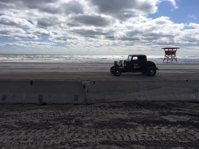

    Here are some photos from my cell phone from TROG 2019 sorry for less that perfect shots

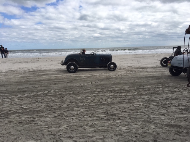

    Some more shots from TROG '19
