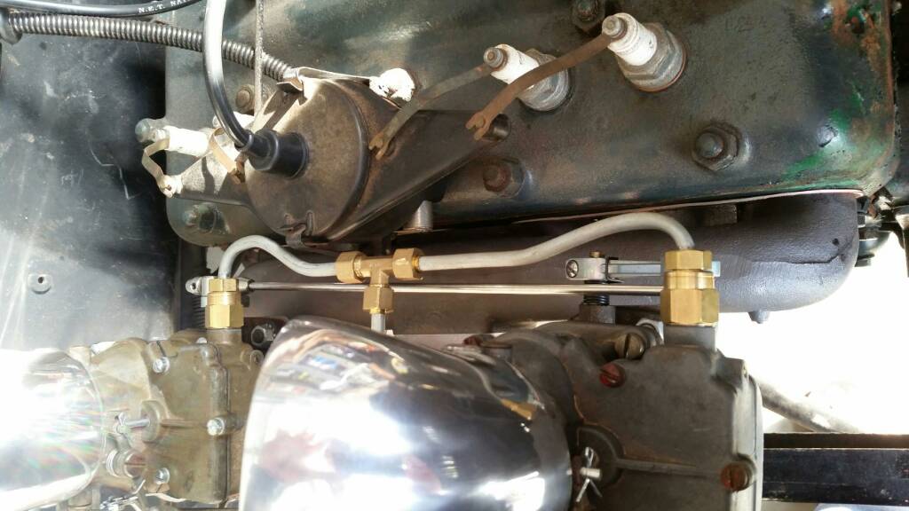

    Mocked up the intake and new exhaust today. Grabbed and bent up some copper tubing, but have steel lines on order along with some brass fittings. I have a feeling somebody will tell me that I need to run a fuel pump and regulator, but man I don't want to unless somebody can draw up a wiring diagram for me. I'm terrible at electrical.
    The forward carb is the only one that will be in operation, the back carb is blanked off. I'd like to make a mock line going to it for aesthetic purposes, but we'll see how that goes.
    I willingly accept any and all ideas. Let me know what you think. Any pictures out there of similar setups? 20191208_143229.jpeg 20191208_143220.jpeg

  5. I have no idea why you would need an electric pump or regulator with a Gravity feed system and both carbs below the bottom of the tank. I'd just make sure the shut off valve is in good shape and turn it off when parked.

    Eh, I've read horror stories about people having a very difficult time with gravity fed strombergs on bangers. Only one or two success stories. But were fuel pumps around in pre-war hot rods??? You think the dual intake with the back carb blanked off is too much? I'm having a bit of buyers remorse thinking I should have gone with a single downdraft. I've also read that .043 jets and a 70 power valve is the best combo, so I have those on order also. Once I get the fuel system buttoned up again I can do some playing around to see what works.

    Oh yeah, and I already rebuilt the fuel shutoff. It's pretty tight but holds great.
  8. If your in doubt about the Gravity feed volume determine what kind of G.P.H. you need at full throttle. Next fill the tank and disconnect the line at the Carb. Put a rubber hose on it and drop it into an empty fuel can. Next open the fuel shut off valve and let it run for 60 seconds. Measure that volume and times it by 60. If it's same as or more than the needed G.P.H. it's gotta work.

    I like the setup, I have no personal experience with it, but am curious why you bought a dual carb manifold if your not going to use the second carb? You could have just bought a single downdraft carb intake...plus its better distribution than what your attempting to do.
    I would not use a fuel pump either, I wish I could use gravity feed on my T engine with the overhead conversion planned. If your terrible with wiring, find someone who isn't. I personally like doing wiring, But I also have a set rate I charge to do it because it is tedious generally and I'm usually trying to hide what I'm wiring in a car so it can't be seen.

    I'm strictly going after vintage speed equipment and this popped up before I read into it deeply...impulse buy...then read some cases of bad luck. My hope is that I don't have similar experiences. I'd much rather use both carbs but I'm fearful that it will send too much fuel. Honestly, I really don't know. I'm going to try with one and then both. Whichever works better is what I'll go with. This is a work in progress. It's obviously got a ways to go. Patience. If it doesn't work, I'll sell it and search for a single downdraft. Million ways to skin this cat.

    Ummmm....ok I completely understand the fuel running into the fuel can for 60 seconds and multiplying by 60 to get the flow rate....but how do I find GPH at full throttle without measuring how much I burn with the carb setup and without driving it for a set amount of time to find how much fuel I went through?
  12. Now that's a grate question. Wish I had a strait forward answer with a formula to give ya. There might actually be one out there involving C.I. of motor and R.P.M. range with a few variables in it but I'm not aware of it. I'm very fortunate to have an ace machinist on my A list with a Dyno. A little run time and some mid range Cam run in time as well as how much fuel was burned can give you a ball park and that's about it.

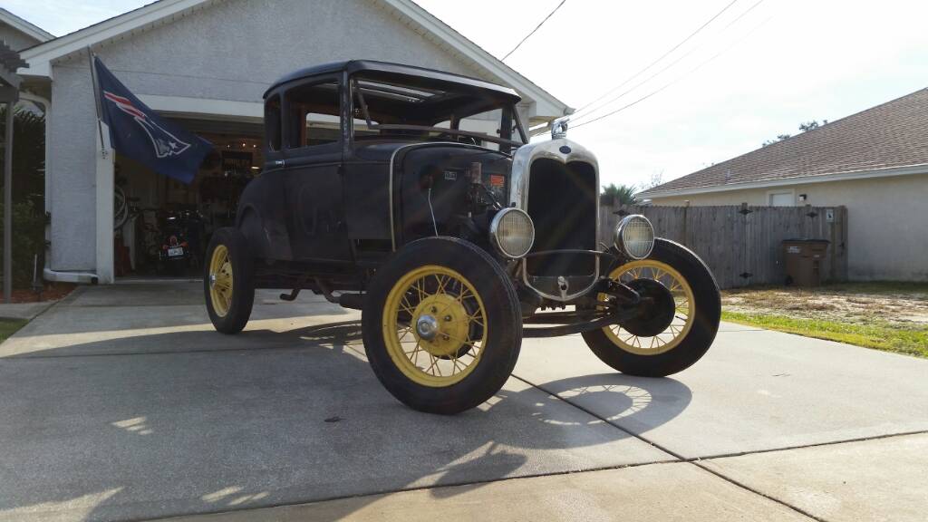

    Ok, did a few things here. First off, happy holidays everybody. Now on to the meat and potatoes...
    I've installed and did a rough tune of the dual 97 setup...no blank, both supplying fuel. Had to bend some new steel lines, had a couple leaks, fixed...I think. By rough tune, I set the mixture screws to a full turn out...each. My linkage was a little rough upon initial install but I've got it working pretty smooth now and I feel like I got lucky when it didn't hit the fuel lines. I also just got the frog scoops in and randomly had some set screws leftover from a hand-shifted, foot clutched sportster, so they're on to stay and the look, in my opinion, is incredible.
    I fired it up and it runs awesome...needs final tuning. At first I had the mixture screws 1.5 turns out each but read on the banger thread that a 3/4 turn was more beneficial/realistic. With that 1.5 turns, it ran, idled, but smelled super rich. After the 1 turn out, it smelled less rich...more normal. I've read how to tune them by disconnecting the linkage and turning each screw in until rough idle then out again until it smooths out. I was about to start that process...but noticed it was running pretty hot. My little thermo-quail told me. Now, I know, it's not moving and it can/will get hot without airflow through the radiator. But it just seemed quick to me. I could pull it in the garage forward and run the barn fan to give more air flow perhaps.
    I ran it around the block prior to this after noticing it was getting hot in 50ish degree weather (again with the dual setup), and it cooled down pretty quick...which was great....but is that normal? I'm probably not giving enough info....any thoughts, ideas? Or am I just getting too protective and worried over nothing?
    It is Florida. It's in the 70s today. But man when it gets hot here, it gets HOT. 90+ with 90+% humidity...should I just not drive it when it's that hot?
    I also got some smoothie wheels in and have been contemplating tire size and tread...I need traction in sand...I like the big to little look and I was thinking if I go real small up front, it will give me more fuel pressure...my lack of experience may show there. Is that true, or am I dreaming? Lower drop = more gravity feed = more head pressure? I'm still trying to get away with not running a fuel pump.
    I still have to rebuild my 39 trans. and get seat springs and covers, install floors...among other things. The list goes on but the major stuff is sitting pretty. 20191226_145255.jpeg 20191226_150722.jpeg 1577395851353.jpeg 1577396223715.jpeg
