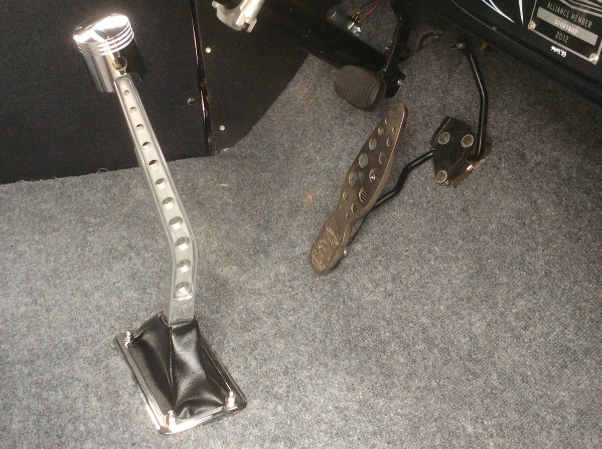

    I used a chrome motorcycle license plate frame to make a bezel for the shifter boot in the ‘35 Chevy. And a drum pedal for the gas pedal.

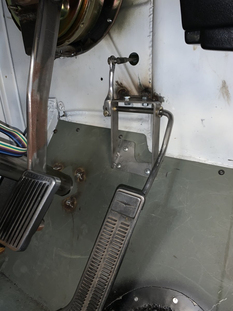

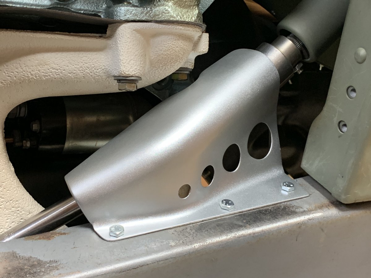

    I used a (formerly) chrome tailpipe extension for the steering column to toe board mount and the steering universal stone guard was fabricated from a curved section of exhaust pipe.
    Brake pedal is from a ‘55 Cadillac, gas pedal is ‘59 Pontiac, accelerator linkage was formed from sections of a frame for a folding lawn chair and brass bushings from a ’31 Chevy hinge pin repair kit.
