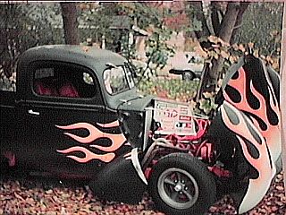

    The vacuum wipers on my wagon didn’t work so I made my own electric wiper conversion using a rear wiper motor from an ‘80’s ford minivan. Same vehicle as we use coil springs from in our 50’s ford.

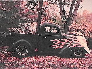

    After I got the wagon on the road everyone would ask where my surfboard is.
    I found a set of vintage roof rack brackets online, but needed the cross bars.
    1” aluminum closet bars from home depot worked perfectly.
    Then fortune struck again. A friends kid had insisted that his parents get him surfing lessons for his birthday, and a surfboard. The kid quit after one lesson. I happened to stop by when my friend, the kids dad, was cleaning out the garage and wanted the surfboard out of his way.

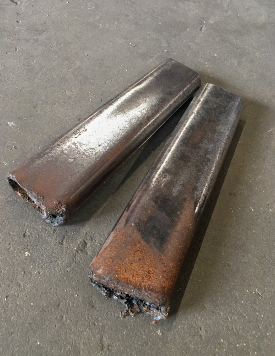

    Sometimes you have to see the part you need in pieces sitting in the pile of scrap you have:
    These are Tri-5 body mounts.

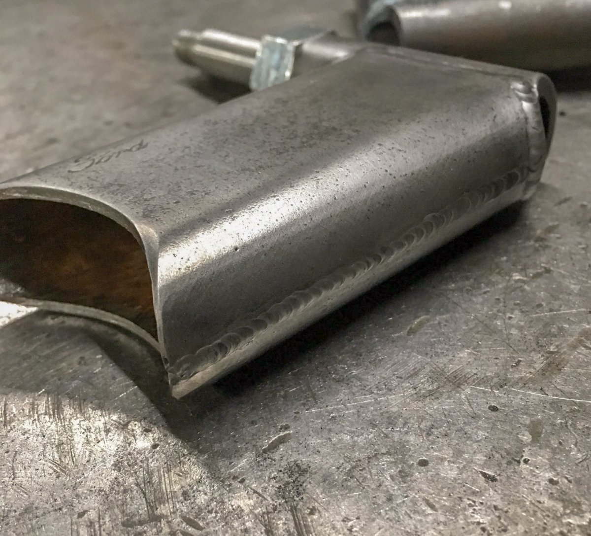

    We needed something to cover my access hole to the front body mounting bolts on my coupe (the firewall is reversed).
    Here it is, trimmed out, with some shape hammered in so it sits in place.

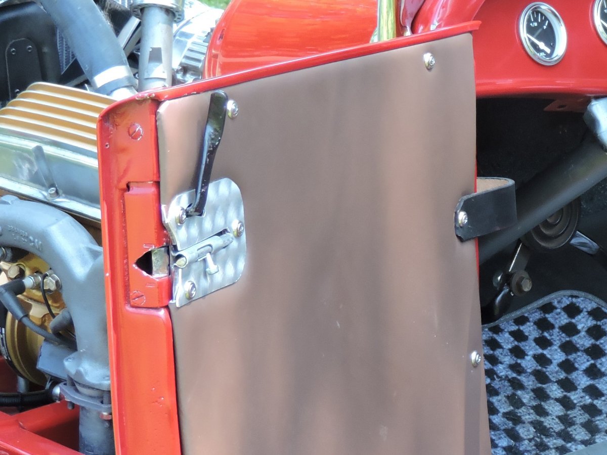

    Datsun hood latches mounted in my fender drops to latch my tilt frontend on my Austin gasser.
    3/4" EMT used to make the framework for my tilt frontend on my '63 Falcon gasser. And Ford Ranger tailgate cables to hold the frontend open.
    Pickup canopy tailgate latch modified to work on my '39 Chev trunk lid.
