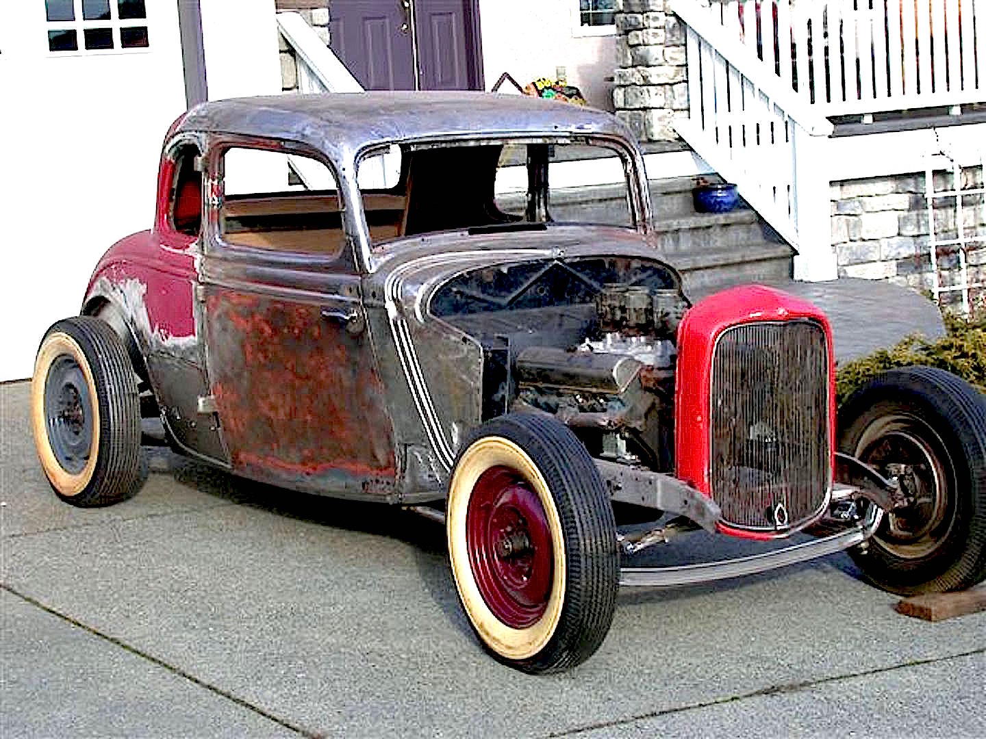

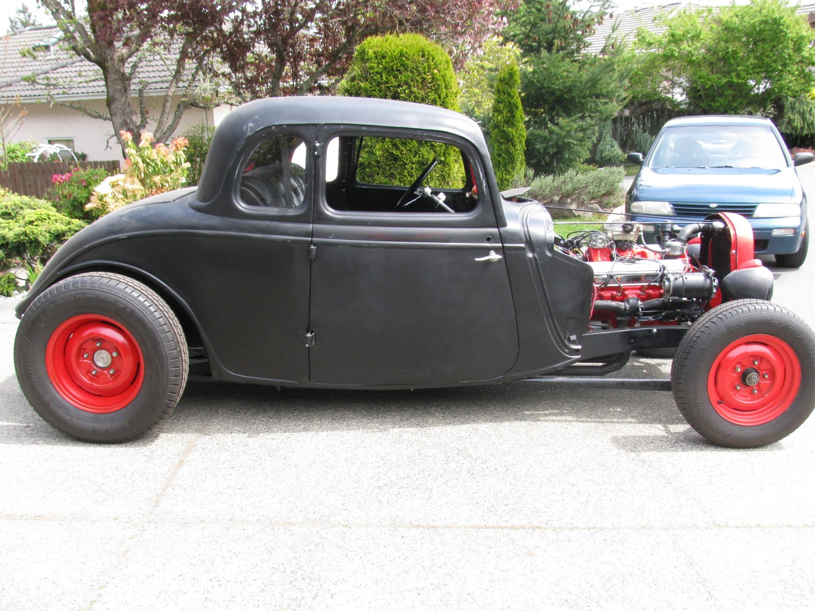

    My 33 coupe - from old race car to channeled hot rod. Untitled-2.jpg 33_Ford_Coupe_013.jpg IMG_2860.jpg

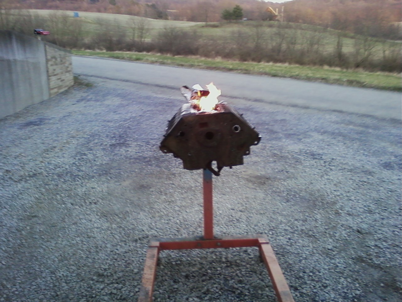

    Ok, I am going to shed some light on rough powerplants for building with. I have not finished this one yet but.... as it goes... I had a guy who worked for me. He worked closely with me at times and when he found out about me building a Hot Rod, He offered up his deceased Dad's 57 dodge 325 Hemi for free. His Dad was an Salesman and he wrecked his Dodge when it had about 65,000 miles on it. The car ended up parked at the edge of his field when it was about 4 years old. By the time I rediscovered it, it was about 50 feet into the woods. I cut a path through saplings to extract it and had to cut the ch***is apart to handle getting it out. hemi0001.jpg It had apparently had animals living in it. No carb, no oil cap and stuck beyond stuck. I tried many concoctions to break the pistons loose but no luck until I used charcoal to heat things up. 5 came out hard on the first treatment. The remainder the second time. I left it cool before hammering them out. jimpopper4.jpg jimpopper3.jpg I lined the lifter cavity with aluminum foil each time. The various penetrants didn't seep very far into the pistons from what I could tell. Even a Hemi for free isn't a bargain some times but I keep thinking it will all work out. I was doing electrolysis on the heads in the background. They and the rocker stands have been dis***embled, reconditioned and stored.

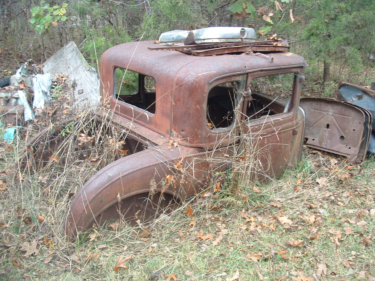

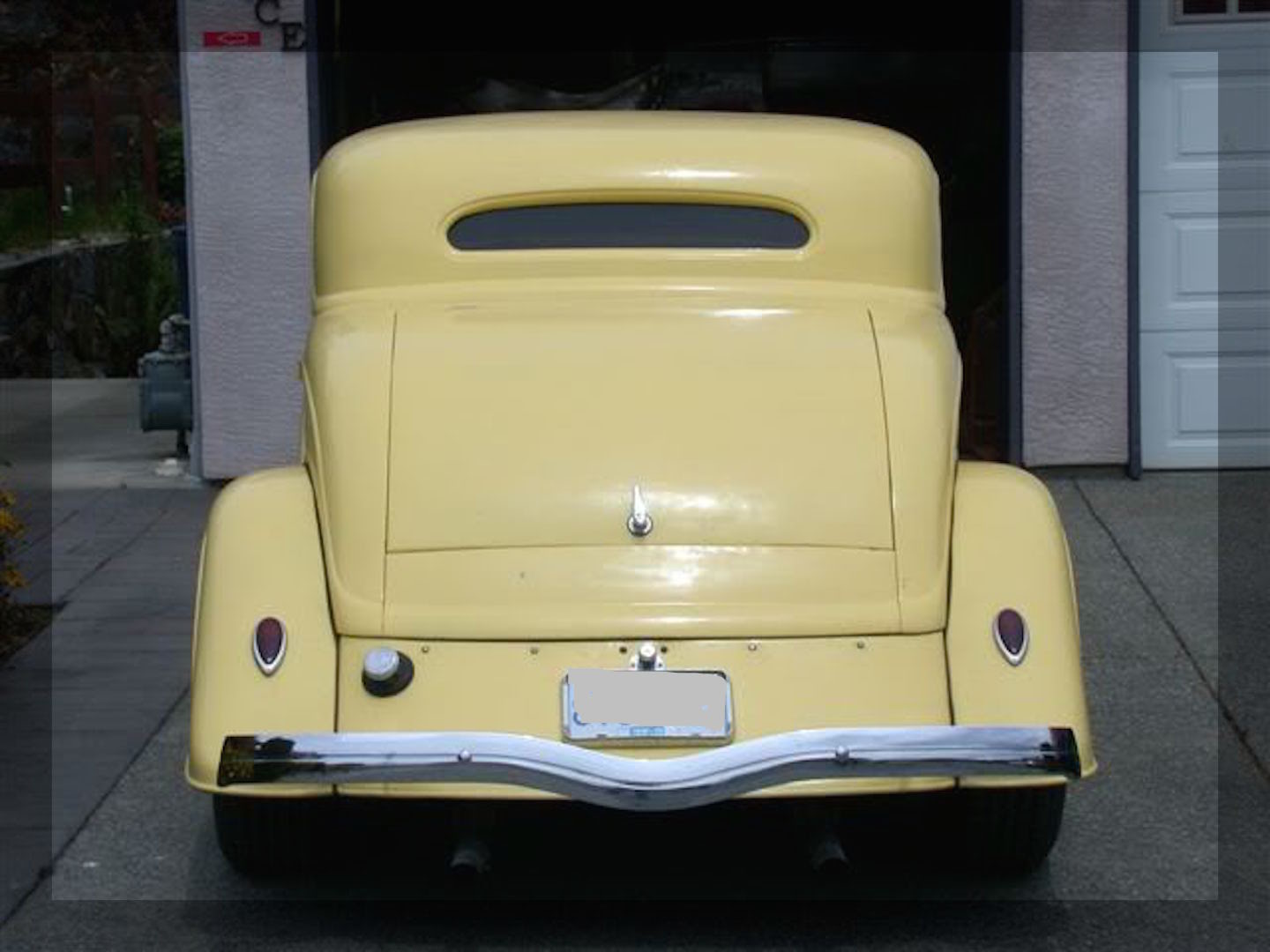

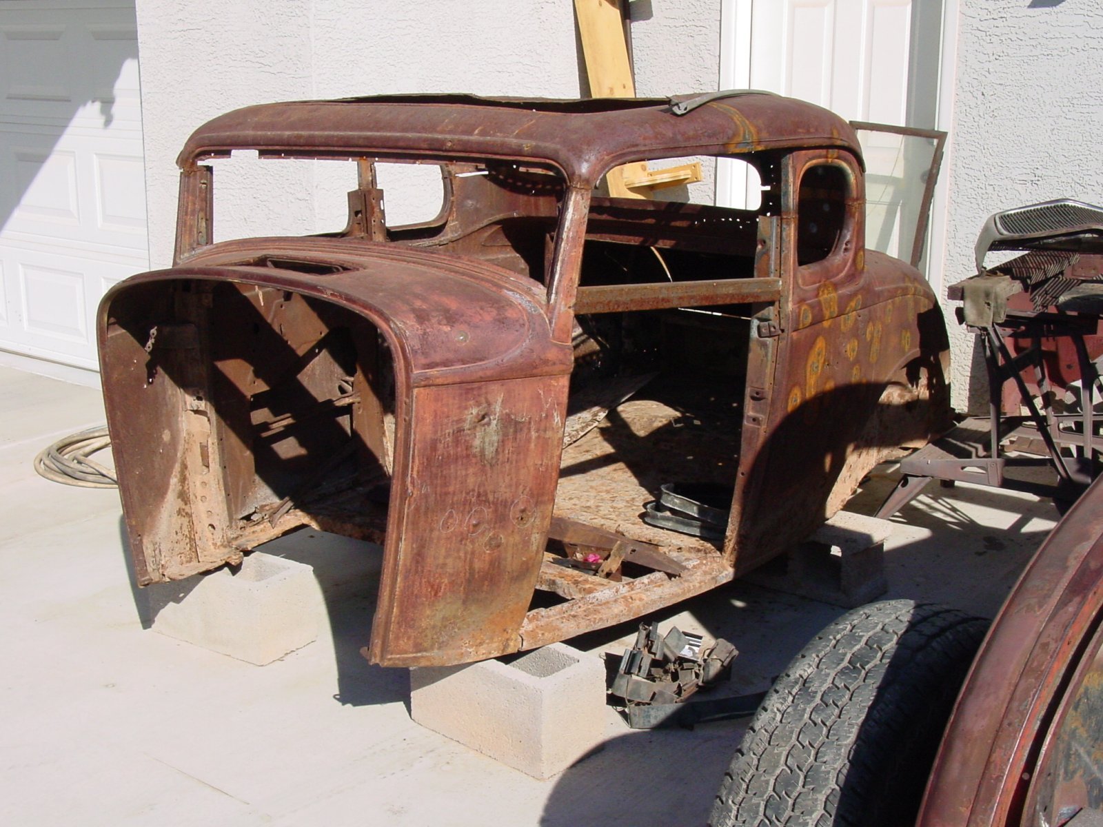

    34 three window I built in the 90's and sold in 2013. First pic is the day the coupe body showed up in my garage. Second picture is the finished product. back copy.jpeg oldcar_023.jpg

    -I honestly think that my wife would have either left me or had me committed if I dragged that home.

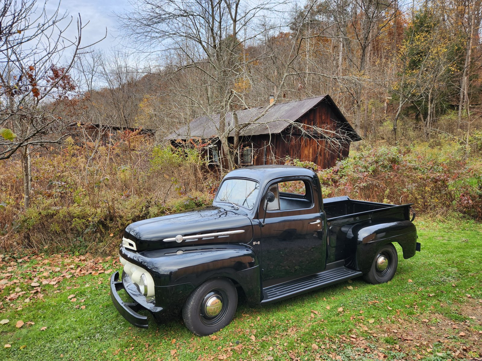

    A few of mine...
    Before
    Before
    After
    314894715_683250066701113_3295755905639522225_n.jpg 20221030_164123.jpg 20221030_133741.jpg

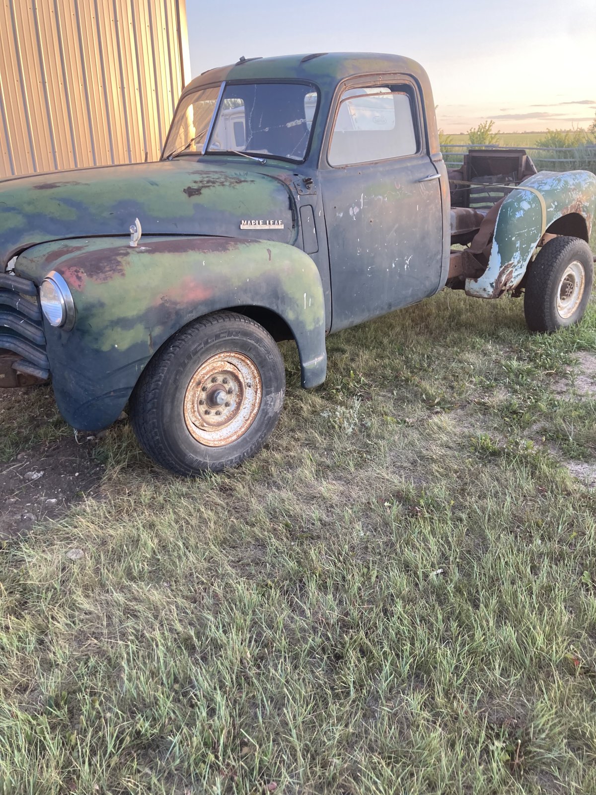

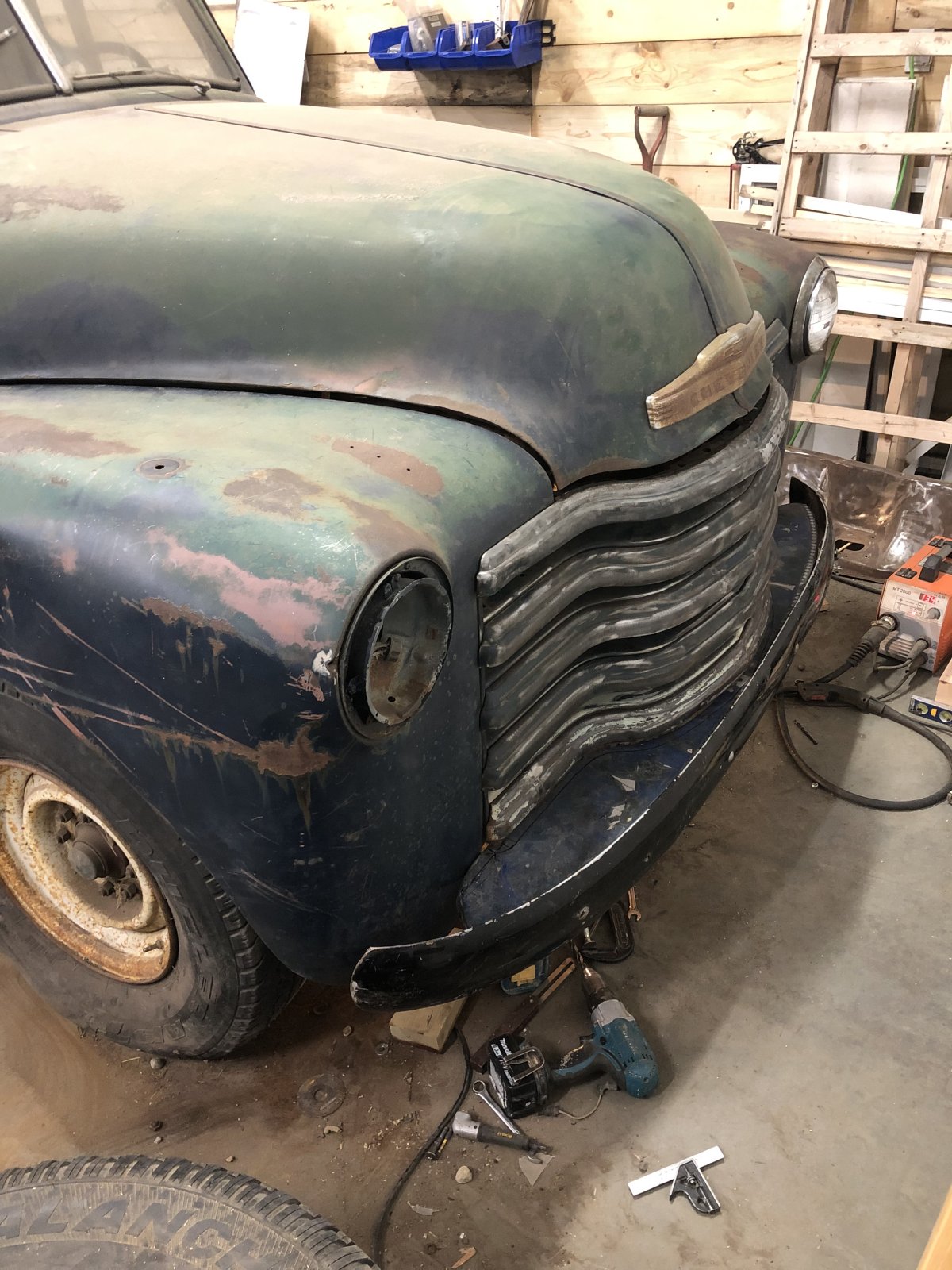

    3608B8DF-FB5A-4685-AE43-822B7F63BA99.jpeg 9FD3850C-8EE1-4EDA-8F31-CCF3EA4E2227.jpeg
    I picked up this cab sitting loosely on a frame, with a spare set of fenders (unfortunately a different size). I’ve built cab/fender/ bumper mounts. Stretched inner fenders as previous owner disposed of them. Rebuilt the grill. Still in the process of polishing! This thread gives me hope to keep on. Thanks guys.
