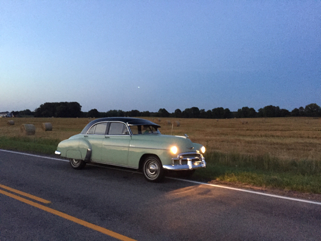

    In the fall of 2013, at a service garage near my house, I noticed a 1950 Chevy. It was far from the road but stood out in bright green. Once the snow started falling on it, I called and asked if it was for sale. They weren't very kind and let me know it was not for sale and not my business. That was November. After few more similar calls, in February 2014, they finally gave my the owners number. He said that his life was changing and he didn't have time for it anymore. He allowed me to go mess around with it, and even with my unfamiliarity with manual chokes and carburetion (my background was more modern stuff) and having sat for months, the 6 volt starter fired the car right up. A week later when he was back in town, he came over on a snowy mid February afternoon and we counted cash. He drove me over to the car 1/2 mile away at the service garage, and I drove the car home in a 5:00pm rush to my small-town home. The car had 40,030 miles on it and was bone stock. Shade tree restored in the 70's with a 235cid (also 1950) crate motor and 3.55:1 rear end. 3 on the tree.
    From the dry/clear days of February 2014 to November 2015, my wife and I put 5,100 miles on the car, driving it every chance we got and weather permitted. In November of 2015, tune ups were becoming more frequent while cold idling was becoming almost impossible. The jiggle in the vacuum gauge was much worse, so I pulled the head. #5 was burned badly and upon disassembly of the head, it needed to be completely rebuilt.
    I spent the next 3 weeks thinking constantly about what I wanted to do. I decided confidently that I was keeping the car stock for the wrong reasons, and I wanted a street rod. That's a decision I stand bye. I plan to always keep the car, and am sure one day there will be a small amount of regret that I didn't keep it as I found it, but I am also sure that it will be overshadowed buy gladness that I still have my first rod.
    I have been working on this through winter 2015/2016 in a one car garage with no heat. An overwhelming amount of parts have been free blessings from guys who just appreciate my ambition. It's going to be a 73 nova 350/camel hump 194 heads. Th350 with a 1957 rear end @ 3.08:1. 3" rear 2.5" front drop via posie leafs and Fatman uprights.
    This is the story of my build. I'm going to try to catch up to where I am today quickly, and will keep the post as updated as I can thereafter. ImageUploadedByH.A.M.B.1457925837.980108.jpg

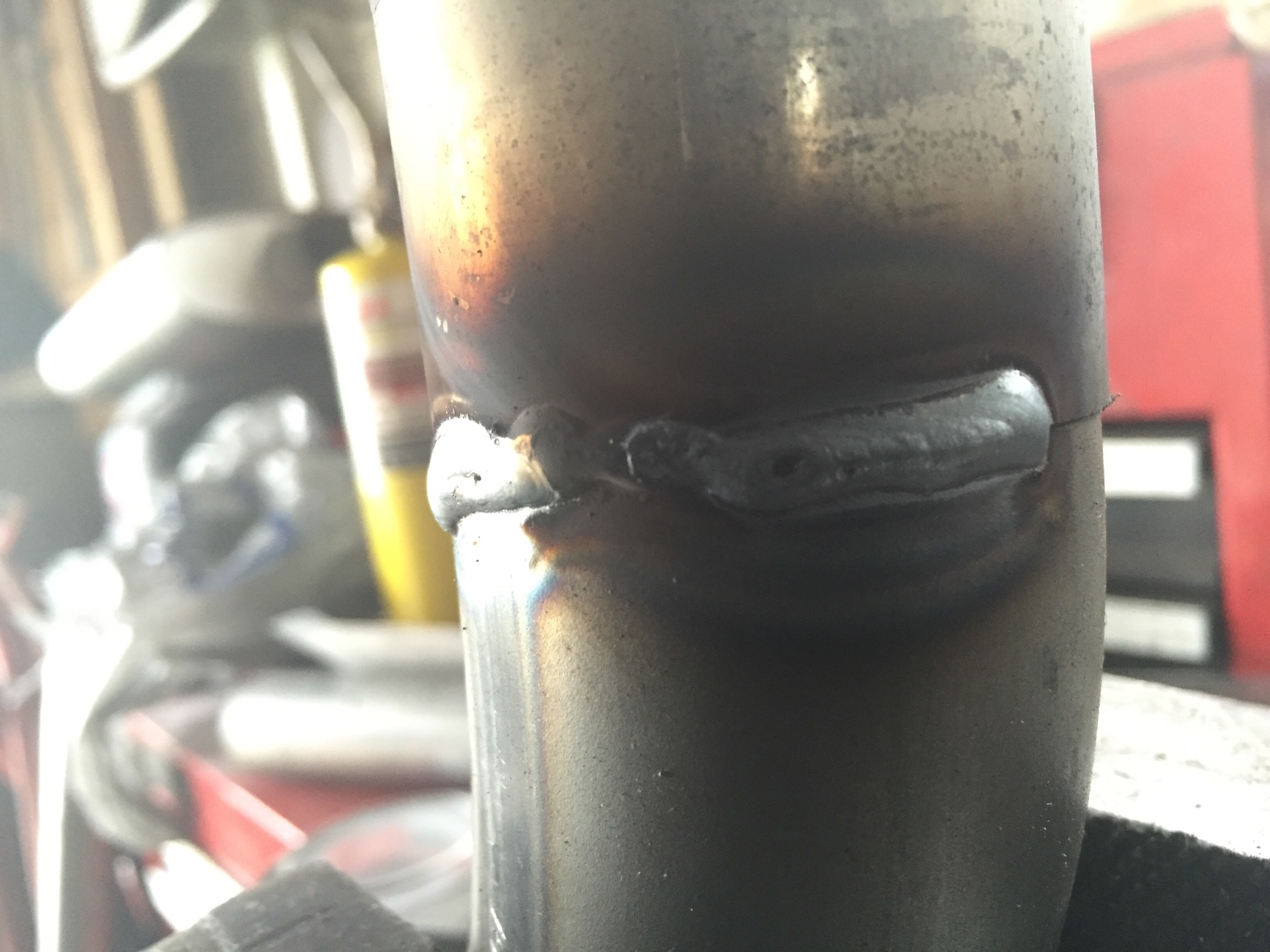

    I have been having a nightmare finding flanges and flared pipe for the manifolds (90's vortec) I chose to use. That can be seen here
    http://www.jalopyjournal.com/forum/threads/late-1990s-vortec-exhaust-flanges.1012111/#post-11439953
    the only source was $125/side. like many other things on my build that I couldn't afford to buy, i just decided to take my best shot at making a solution.
    I used a MAP torch to heat the pipe edge and used a crescent wrench to flair the edge out. This made a bulge in, which I used a 1 7/8 (can't find my 2") trailer ball and a hammer to fix. Using the ball in the pipe and the base off the ball, and a stirring motion, that smoothed out the flare.
    As for the flanges, the 2 1/4 ones I have on hand fit the flare nicely. I added metal to the outside edge of the holes for the studs with my welder and will "move" the holes by bringing outward and filling with weld on the inside.
    I am thinking I want to use a length of pipe inside the donut that is as long as the donut is thick, that way exhaust goes THROUGH the donut and is less likely to burn it or find a tiny imperfection in my (less than perfect) home made parts. ImageUploadedByH.A.M.B.1458406823.044924.jpg ImageUploadedByH.A.M.B.1458406836.919301.jpg

    Any exhaust shop can make those pieces for you, and should't be anywhere near $125.00 for BOTH. Shop around. My DD, OT truck, for some reason, breaks the header pipe within the swedging that helps to seal the donut ring. Happens every 5 years or so, and it cost very little for my exhaust guy to cut out the old, make the new, and weld it in. I have header waiting for the next time it happens, and it's about due. Advertise on Craigs List what you want used, someone may have what you need having installed headers. There's nothing special about your manifolds, other than possibly metric studs. I am Butch/56sedandelivery.

    Trouble is they are 3" center to center (the studs). The only ones I found like that - I didn't even find them, someone else did on the thread about the topic I posted above - were wicked pricey. The flares I made seem up to the task. What do you think?

    Butch ImageUploadedByH.A.M.B.1458476898.535645.jpg i don't think there is enough "flat" contact. These things have a huge bevel. Here is s photo. Disregard the way the pipe is in there that was for measurement sake
