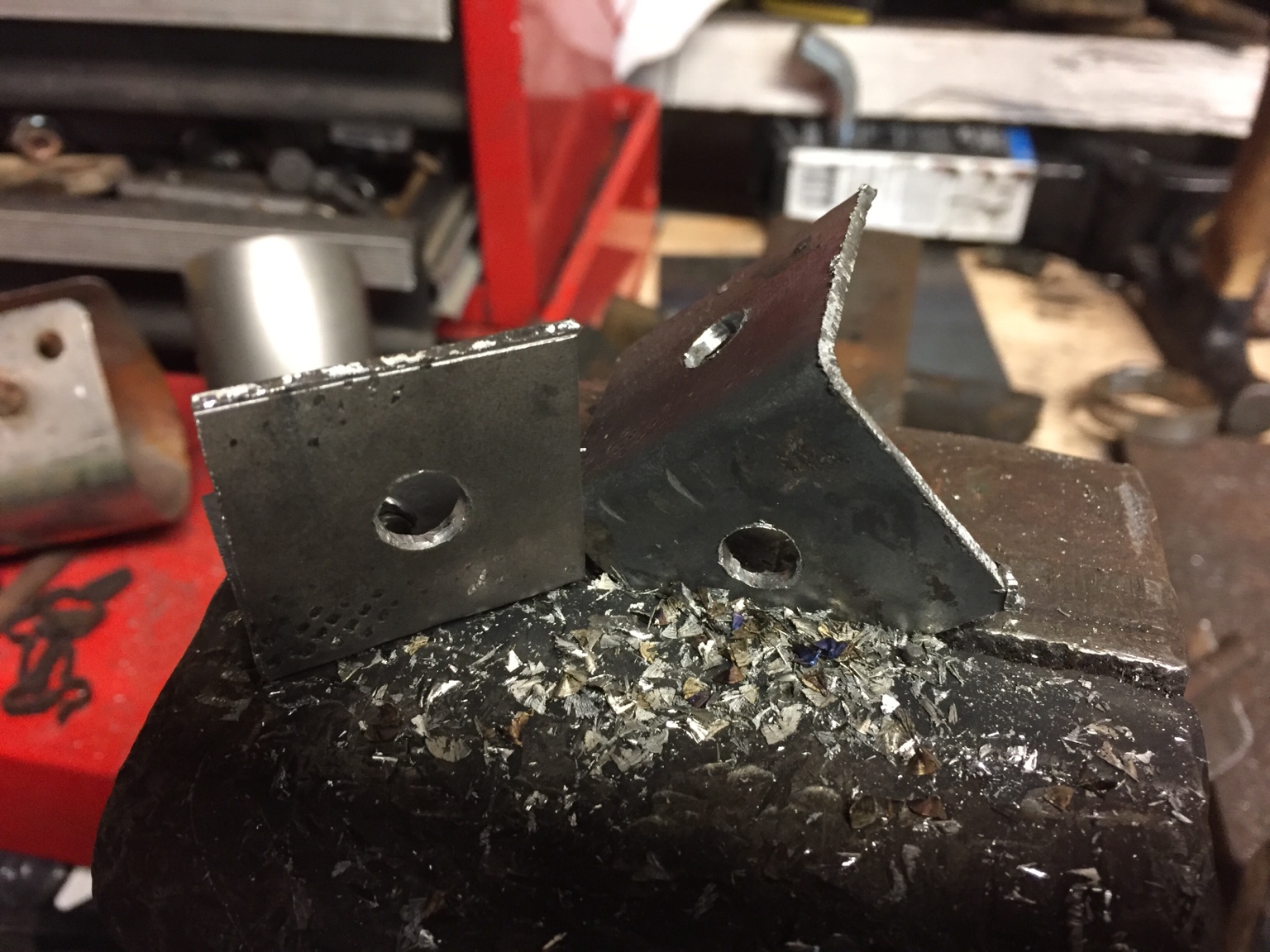

    More work on the exhaust. Made these brackets. The stock one on the drivers side was to low with the suspension being dropped. I've worked hard to keep ground clearance. [​IMG]these 90° brackets I made are for the exhaust hanger strap so it's not bent where t connects to the underbody.

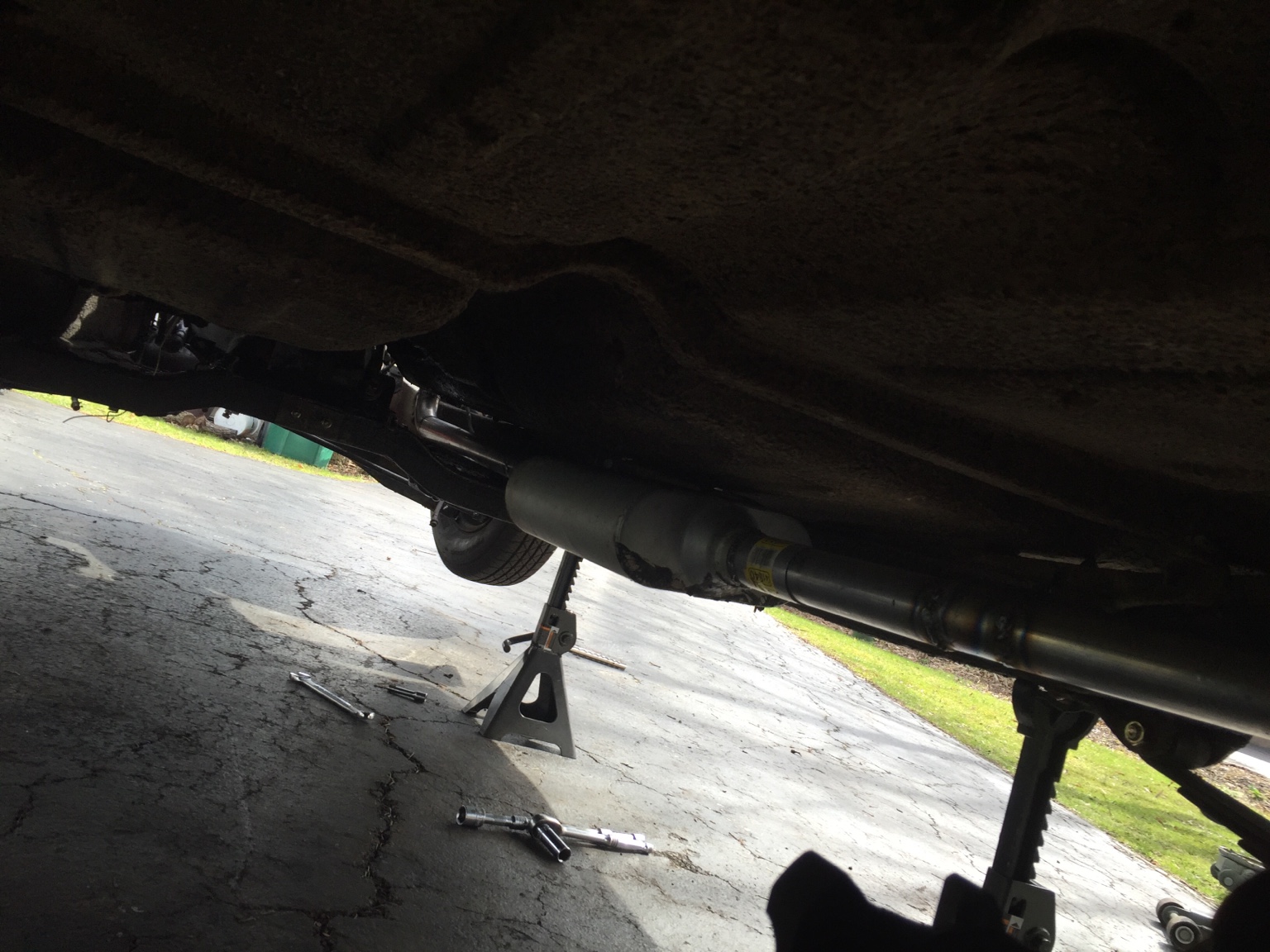

    The passenger side is totally finished. It's
    Tough to see cause of the lighting but the pipe from the manifold to the muffler is almost exactly centered between the transmission crossmember and floor, slightly favoring the crossmember side, which is exactly what I wanted.
    The muffler ended up a little closer to the read floor pan than I wanted which makes me nervous because of the oil/dirt undercoating bit there is about 3/4" clearance and I know much air goes under there and it would take over 200° to ignite that floor coating. I *may* drop them a bit by lengthening the down pipe and one of the curves of the axel arch to get more like 2" but I haven't decided if I care yet.
    I also am 50/50 on taking some brake cleaner and a scuffing pad and cleaning the exhaust up and painting with high heat paint but I am thinking with no snow and avoiding rain, if certainly won't rust through from the outside… Any rust through will happen from condensation on the inside. I don't care if it gets surface rust underneath…

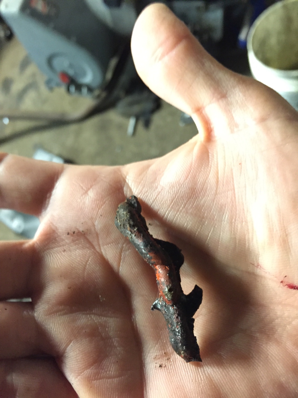

    Another update. I am kind of embarrassed to admit this but pride is no good anyway. I dropped a 1/4" thick 2 1/2" long RTV silicon goober in the distributor whole and in trying to get it out, it fell down in on the starter/fuel pump side. This was with the intake manifold off. I drained the oil hoping it would come out. It didn't. I got a new oil pan gasket because I didn't like the one the guy used when he built the motor and I'll just drop the pan and retrieve it
  4. One of the true advantageous of having an exhaust system custom "fitted" is the fact that the straight pipes do not have to be continuously straight.
    The pipe bending machine can "tweek" the pipe, make slight or not so slight bends, to follow floor or frame contours.
    My '51 went to the exhaust shop with its headers attached to the 235.. I supplied the mufflers.
    Pipes were fit like a factory installation, but more than looks alone, my clearances from floor pans and fuel tanks and lines are good.
    Flanges were used, going through the system, so sections of the exhaust system could easily be removed, without affecting remaining parts of exhaust system.
    I spent $175 for my exhaust work at the pipe bending shop.
    When I calculate what I would have spent for materials alone, I believe I did the right thing, for me.
    Drew, 3/4" of clearance from muffler to floor is close, real close.
    Excessive heat, vibration or a possible fire has to be considered, and I know you have.
    Keep the wheels turning on your project.

    Drew, you could ovalize the exhaust pipe in a vise between 2x4's. That might help lower the muffler and give you some floorboard clearance.

    Tommy, I can persuade it down a bit if I have to but I think it's going to be ok. The ovalize thing came in handy with the down pipe yesterday. These 1990's vortec manifolds stick WWAAYYY out and I have about 7/16" between the pipe and the frame!

    So tonight I got the massive RTV goober that fell in the distributor hole out of the engine.

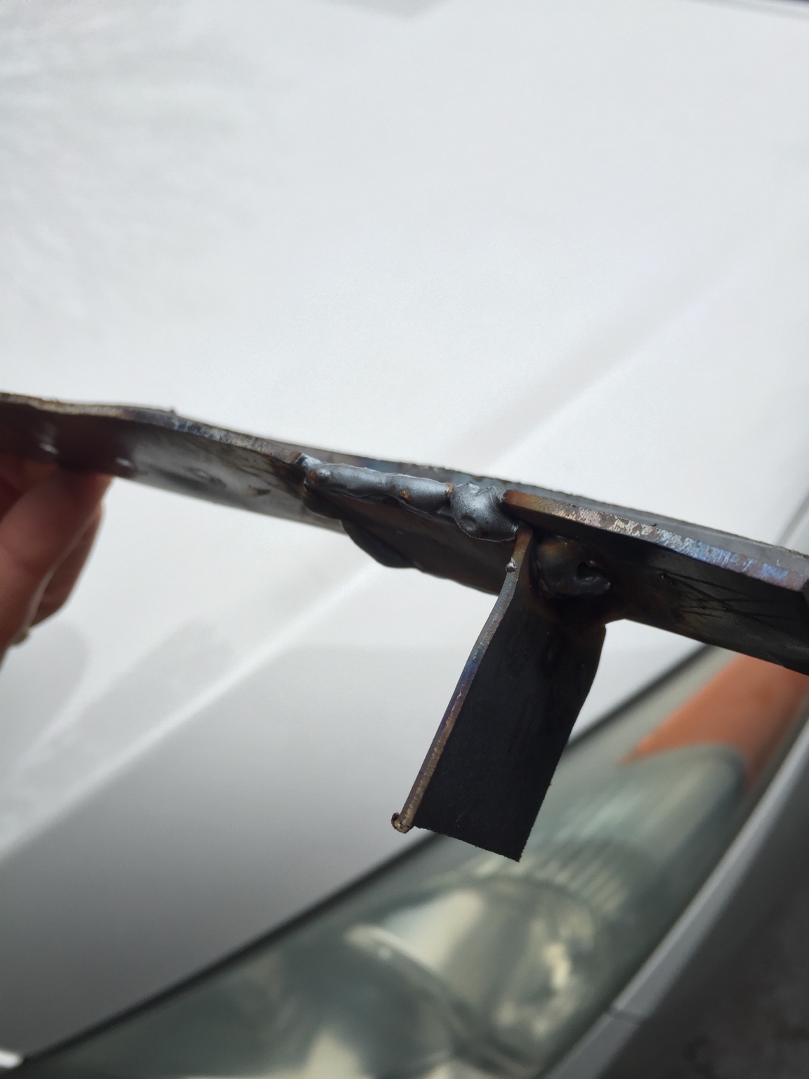

    Worked on the brakes and gas pedal tonight. The Clevis for the power booster shaft to pedal arm was actually too long so I made one from a nut and plate steel. My whole pedal assembly is home made

    Moving right along. Drew, but I think you might want to consider doing a little finishing work on your fabrication. It compliments all your hard work and hones your skills.

    I made these. One mounts to the intake manifold and holds a OEM 73 nova kickdown cable in the "correct place" and the other is a 3 sided box that goes over the corner of the carb and is held in place by the carb. This is a custom bracket to accept the OEM accelerator cable from the pedal I was given. Not sure of the donor car, the kind gentleman who gave it to me may comment if he doesn't wish to remain anonymous[​IMG][​IMG]
