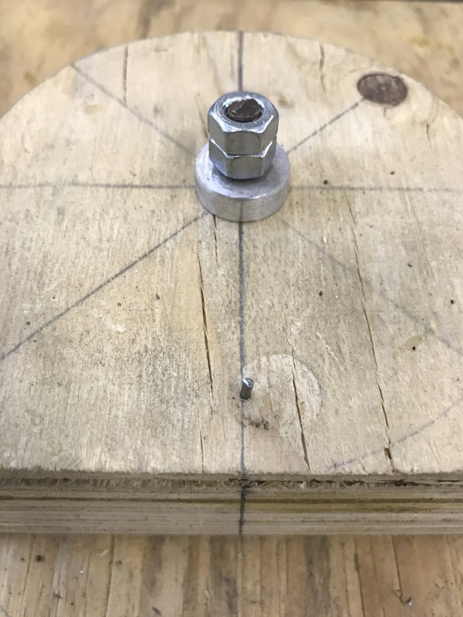

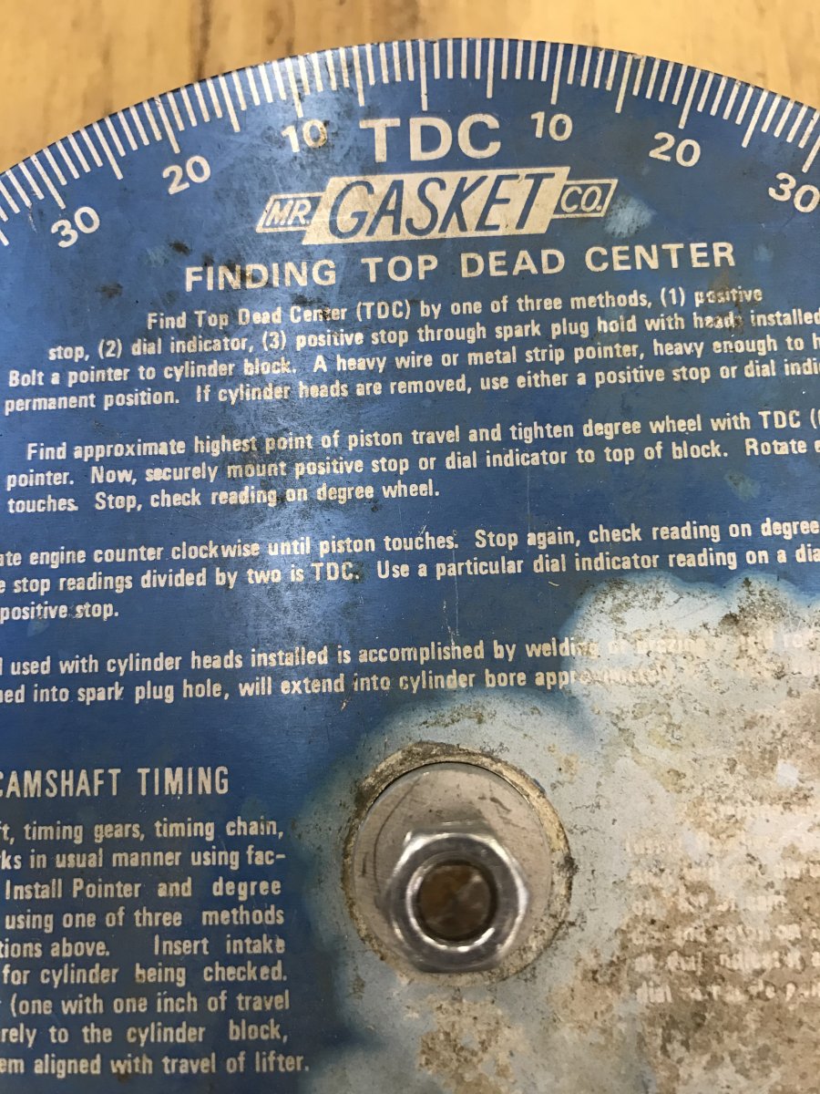

    Something I made to help keep the cuts on a true radius line. Also lets you keep track of the number of degrees in case you have to make ab 'S' bend with the legs parallel.
    As you can see, the large radius bend locates on the outside of the fixture. The small one is located by the inner block. The intermediate one requires shimming from the sides to keep it centered.
    The degree wheel is centered and has a pin to locate it radially (clocked).
    This one is dedicated to 2 1/4" pipe. Would't be too hard to make one for multiple sizes.
    IMG_0202.JPG IMG_0201.JPG IMG_0206.JPG IMG_0207.JPG IMG_0208.JPG IMG_0209.JPG IMG_0203.JPG IMG_0204.JPG IMG_0205.JPG
    brad2v and King ford like this.

    I just cut the tubing off with either my chop saw or a hacksaw, and wiggle and grind until it fits. The degree wheel, etc are neat ideas.
