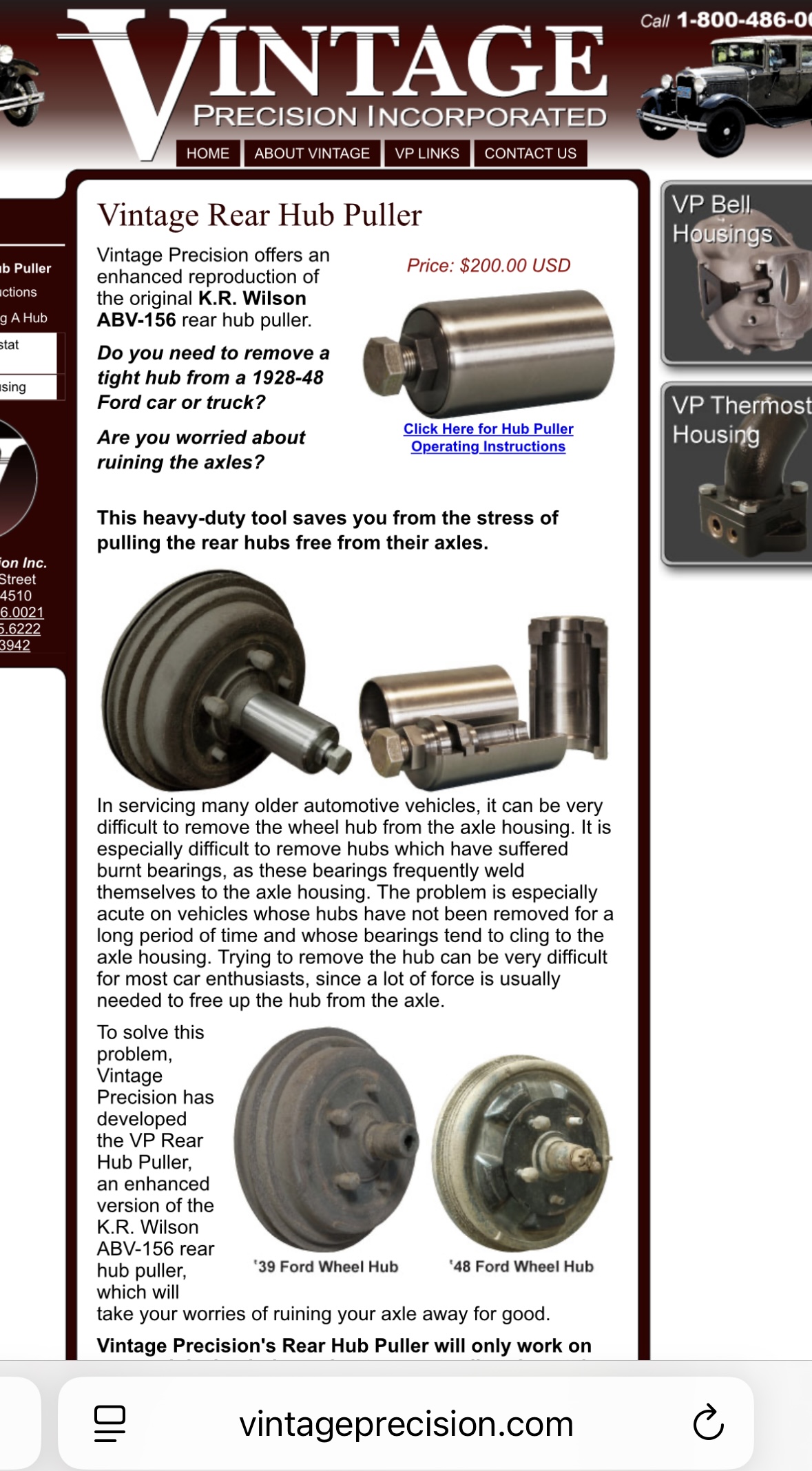

  1. I’ve got the repro KR puller like the one shown from Mac’s and it has served me well.

    Years back, I bit the bullet and bought the Vintage Precision unit after missing out on a few KR Wilson units on eBay. Spendy, but worth the money in my opinion. Never had an issue pulling a rear hub. I did end up finding a KR Wilson (ABV-156 is the model you want), but I like the Vintage Precision one more.

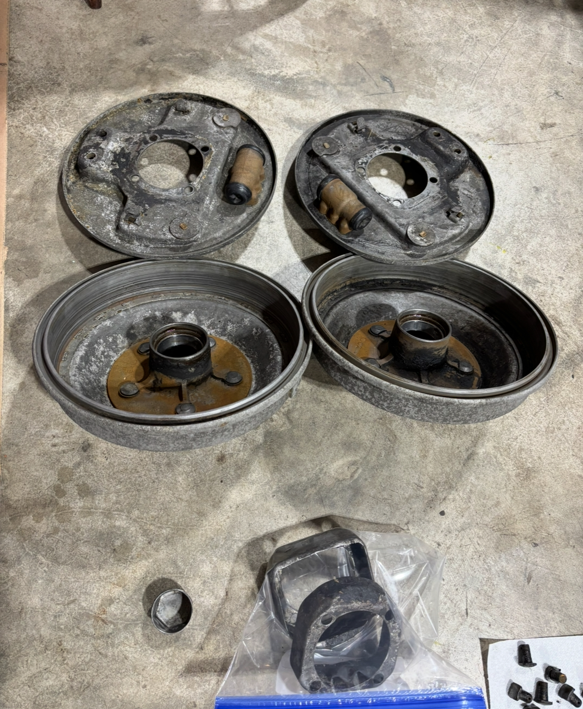

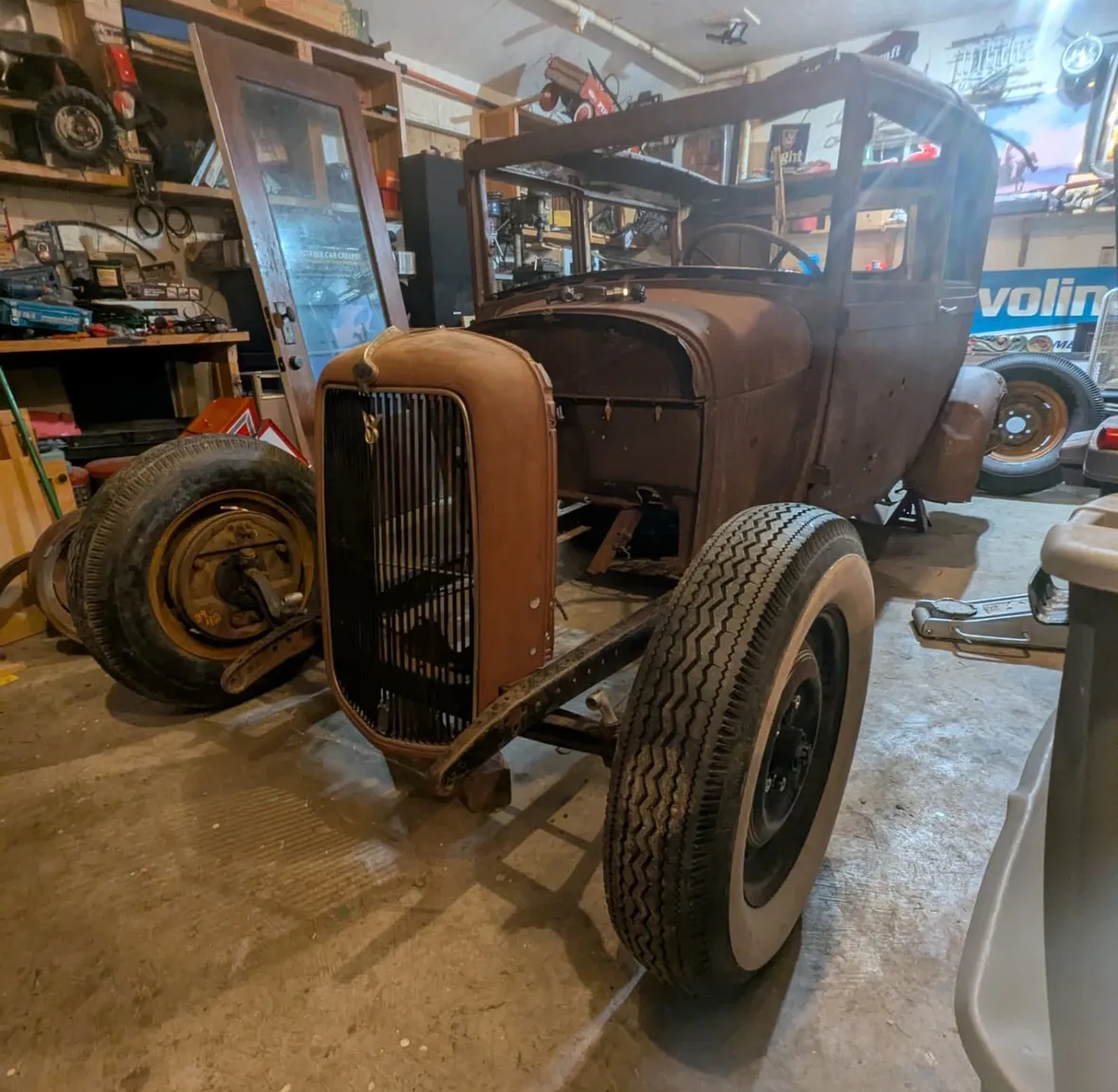

    Cleaning hubs, drums, backing plates and hardware this morning off the 41 IMG_1391.jpeg @Austin kays and @BigJoeArt working on the 34 also getting parts off the 41 IMG_1382.jpeg and Davies A also getting parts from the 41! IMG_1390.jpeg making good use of all that old ford!

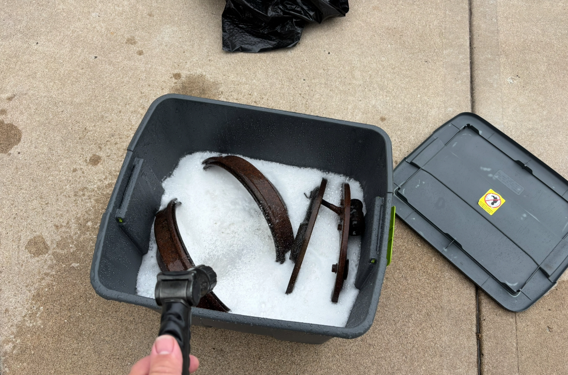

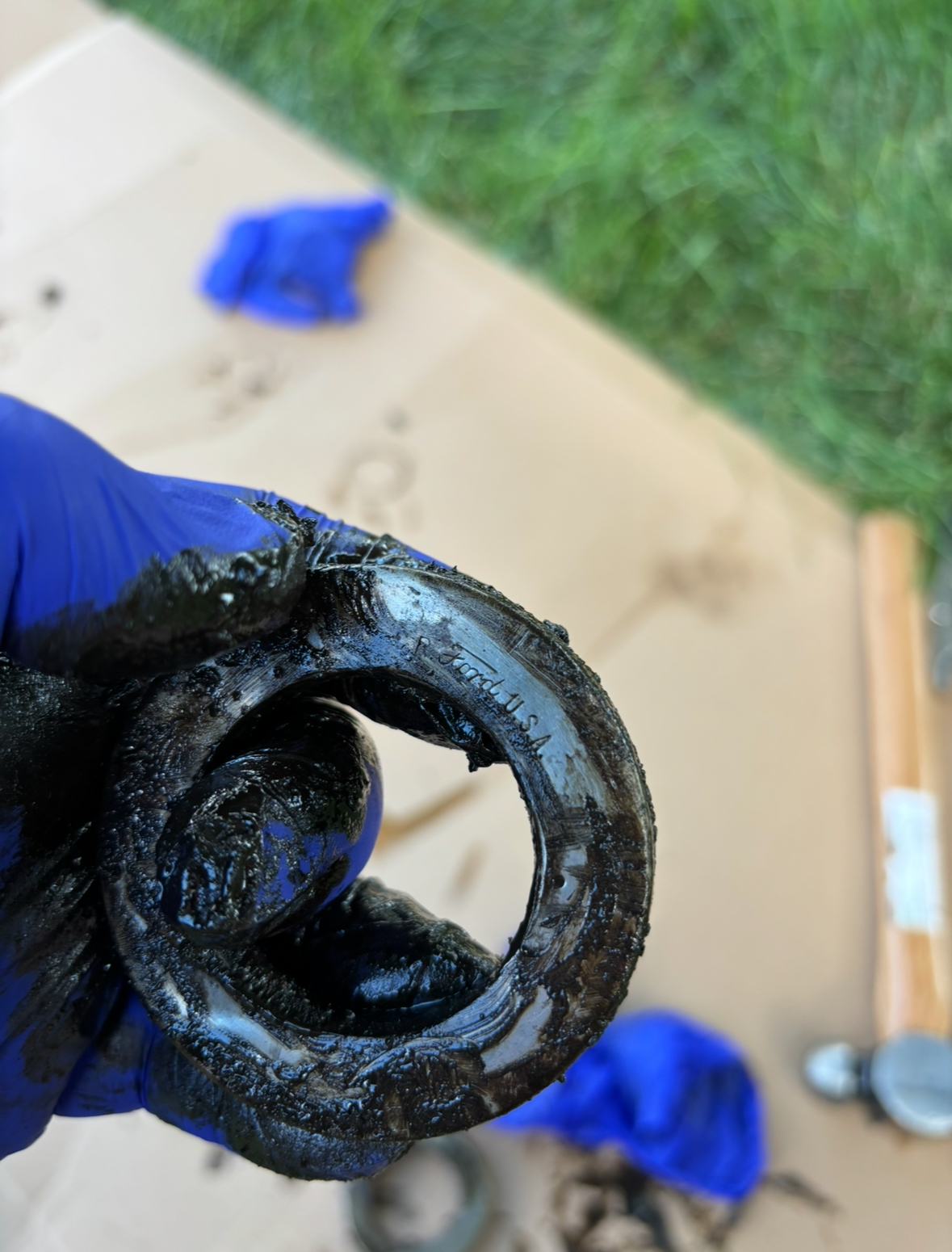

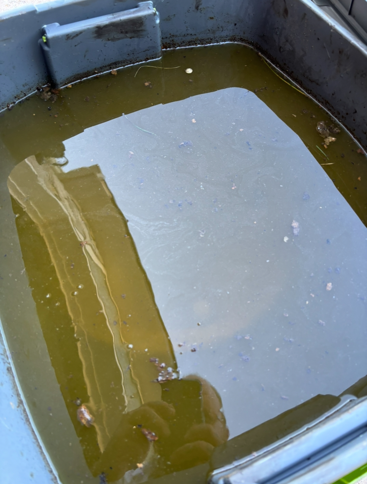

    Couple of dawn dish soap baths and I popped the seals and bearings out and dunked them into the acid bath.
    IMG_1400.jpeg IMG_1401.jpeg IMG_1402.jpeg Everything under the grease has looked great. I’m always happier with greasy parts over really rusty ones. There’s still some grease and gunk here and there especially in the grease cups but after the acid bath I should be able to see what’s left to clean a lot better. Might take a trip to a heated power washer for some of this stubborn stuff.

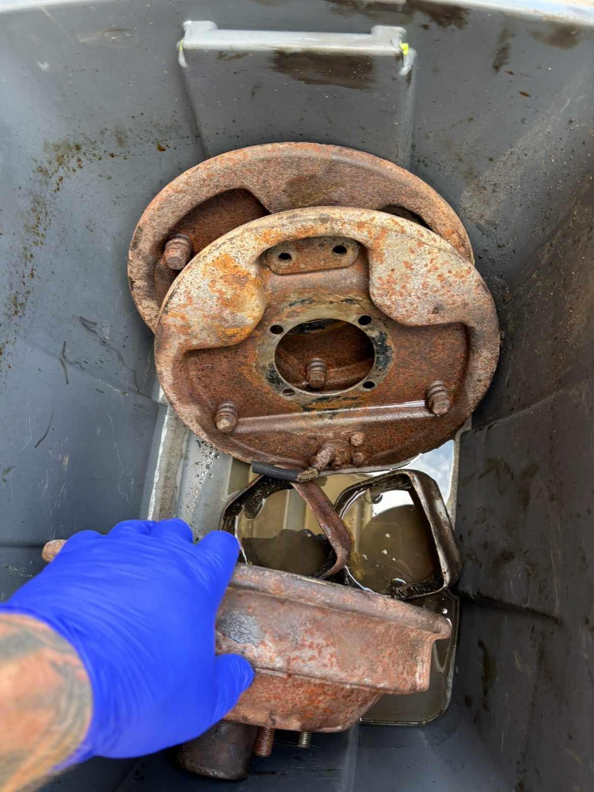

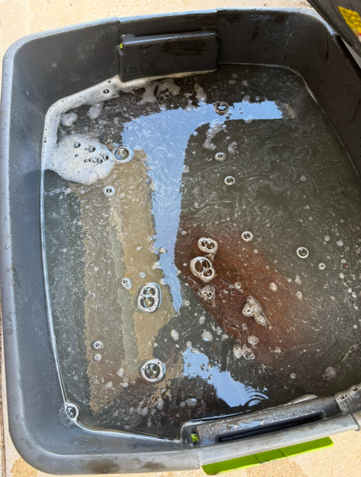

    Checked on it last night IMG_1427.jpeg pretty nasty! I think the color is coming from all the grease. The drums/hubs are looking really
    Good and the backing plates are getting there. I think it’s all gonna have a date with a heated power washer with de greaser and then back into a fresh acid bath. But still feeling good about how they lol.

    Whatcha got in the tub? The liquid that is? You mention acid. Is that it? That's certainly not the acid I remember from the 60's.
    Tim likes this.
  18. Six Ball
    Joined: Oct 8, 2007
    Posts: 6,962
    Six Ball
    from Nevada
    Citric acid doesn't clean grease much. I don't know why the citric hand cleaner works. But the acid bath is great on rust.
  19. Tim
    Joined: Mar 2, 2001
    Posts: 20,293
    Tim
    from KCMO
    Yeah it’s citric acid. I know it won’t get rid of the grease but I figured it would let me see what I am working on a little clearer
  20. Six Ball
    Joined: Oct 8, 2007
    Posts: 6,962
    Six Ball
    from Nevada
    It turns dark from †he rust but it still works. It is good to let it st for a while and brush & rinse it. Put it back in there is still rust. It will eventually get it all.

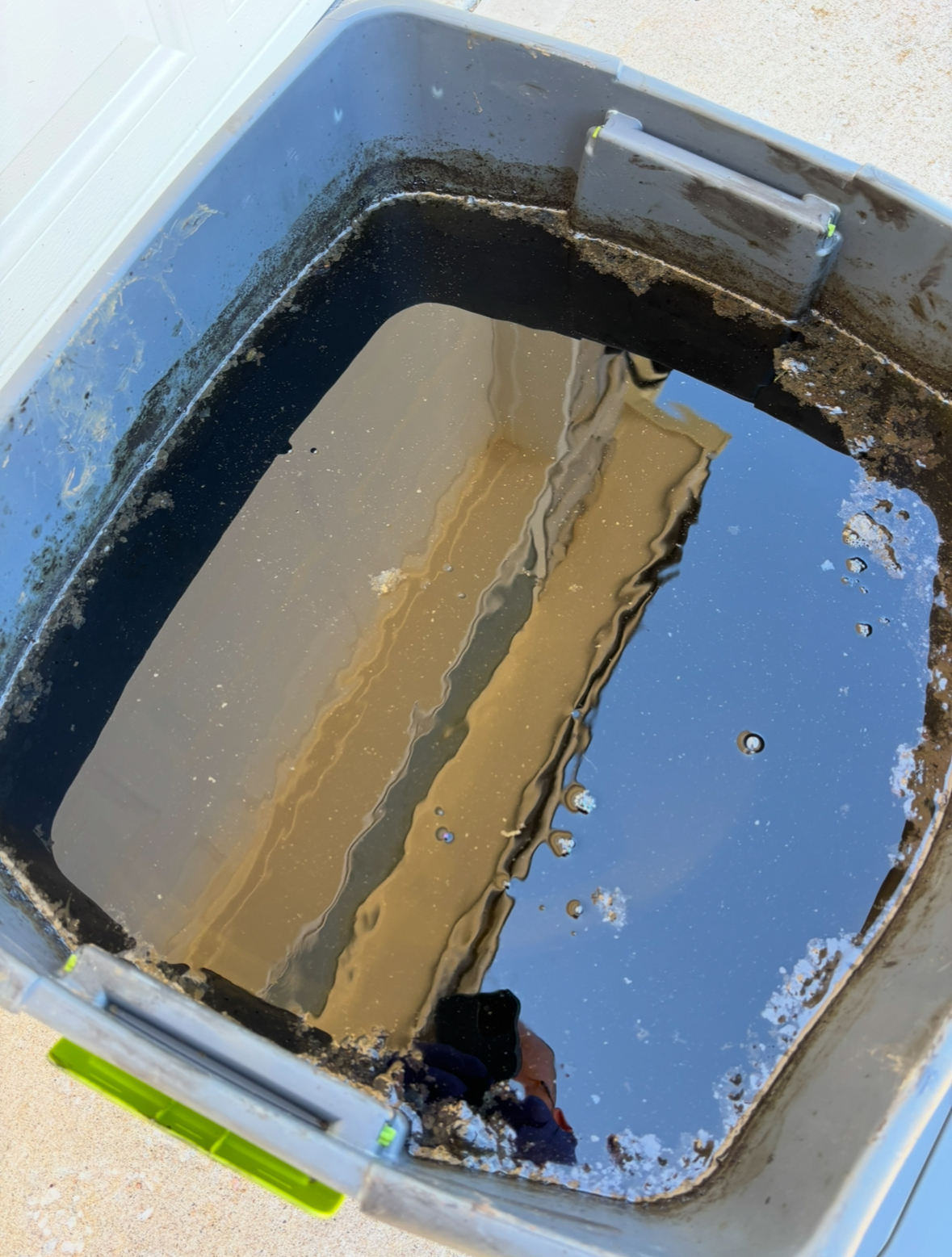

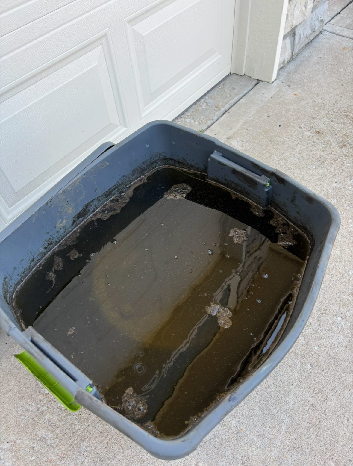

    IMG_1438.jpeg It’s looking groooooss but the backing plates are showing black paint across most the outside and the drums look like they were painted black at one point as well. Thankfully the acid is getting the rust under the paint and when the paint skiffs off the greasy mess stuck to it is going with it!

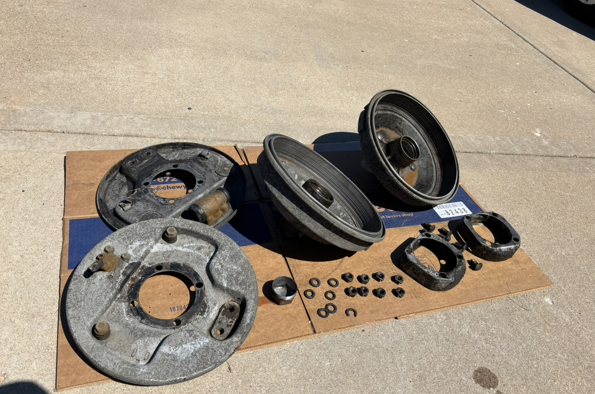

    Alright! Time to finish this up for now. IMG_1475.jpeg solid black murk! IMG_1476.jpeg rinsed, towel dried and set in the sun IMG_1477.jpeg inside and in front of a fan
    need some grease removed yet but good enough to sit on the shelf til I need them. I’ll get a rag and wipe out the old grease in the hubs and rub some
    New grease on it to keep the races and etc good
    got some grooves in the drums but seems to my un educated eye like enough meat to lathe it down

    They cleaned up pretty well. If you just put on new shoes and leave the grooves when †hey wear in they'll have more surface contact.
    justabeater37 likes this.
  24. atch
    Joined: Sep 3, 2002
    Posts: 6,402
    atch
    My thoughts exactly.
  25. Tim
    Joined: Mar 2, 2001
    Posts: 20,293
    Tim
    from KCMO
    I’ve got a buddy with a brake lathe but I guess that works too! Never would have thought about that
  26. Six Ball
    Joined: Oct 8, 2007
    Posts: 6,962
    Six Ball
    from Nevada
    They may wear quicker and one side may have more surface than the other so it may pull to one side but you can handle that with a bigger steering wheel.

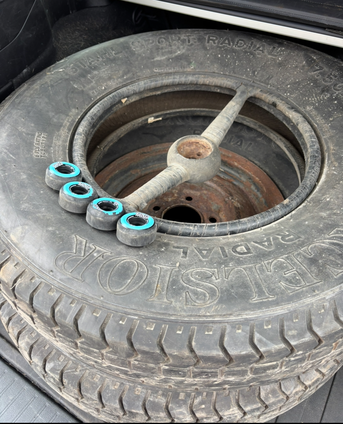

    Not to much of an update. I’ve been messing with the 46 ch***ing down some issues and trying to figure out and adjust to my new “kids in school” schedule. But I did meet up with Austin today and get some roller 750’s that will let both the roadster and A have the right height tires mocked up once I swap wheels into them.
    also traded him steering wheels. Now I’ve got a 40’ to put on the roadster and he’s got the 41-8 wheel for the horn ring he had for the Kay’s coupe. :)I’ve got parts in the mail once they show up and I clean up a few things I should be able to mock this back into a rolling steering frame. Well, almost I’m still short a pitman arm. But not like I’m going anywhere right now lol. IMG_1557.jpeg

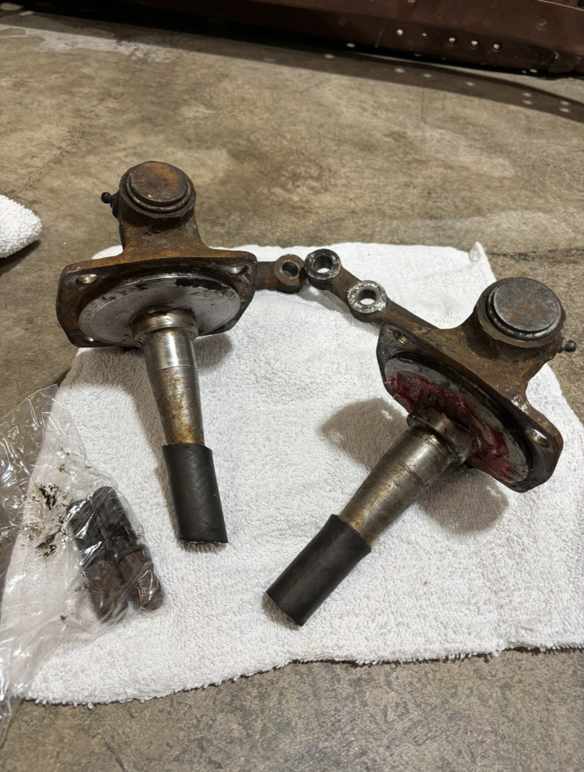

    IMG_1622.jpeg Spindles, king pins and swedge bolts ready to go!
    some front spring hangers and a pitman arm and I could have a rolling steering ch***is! I’m planning on mocking it all back up next week. Is that I’ve got the space back.

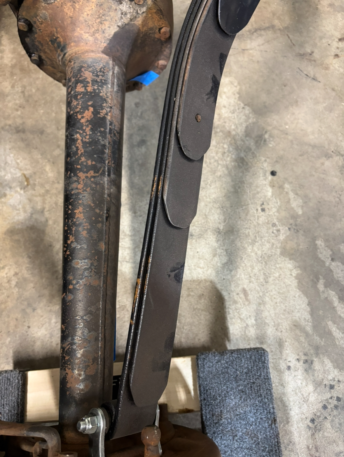

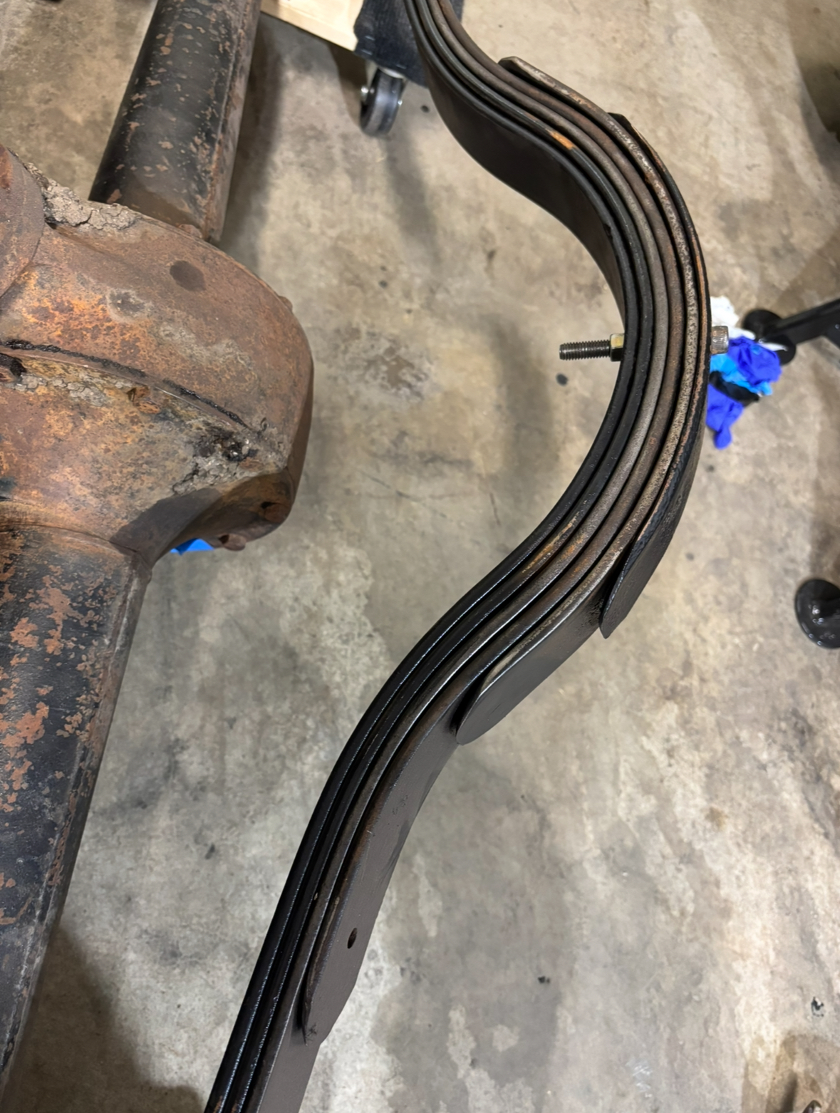

    But I just pulled the banjo from the A and this cleaned up/ worked over T spring will go on the roadster ch***is so figured I’d add a teeny update. IMG_1917.jpeg IMG_1918.jpeg IMG_1915.jpeg need to sell the nice A banjo banjo and get it out of the way now lol
